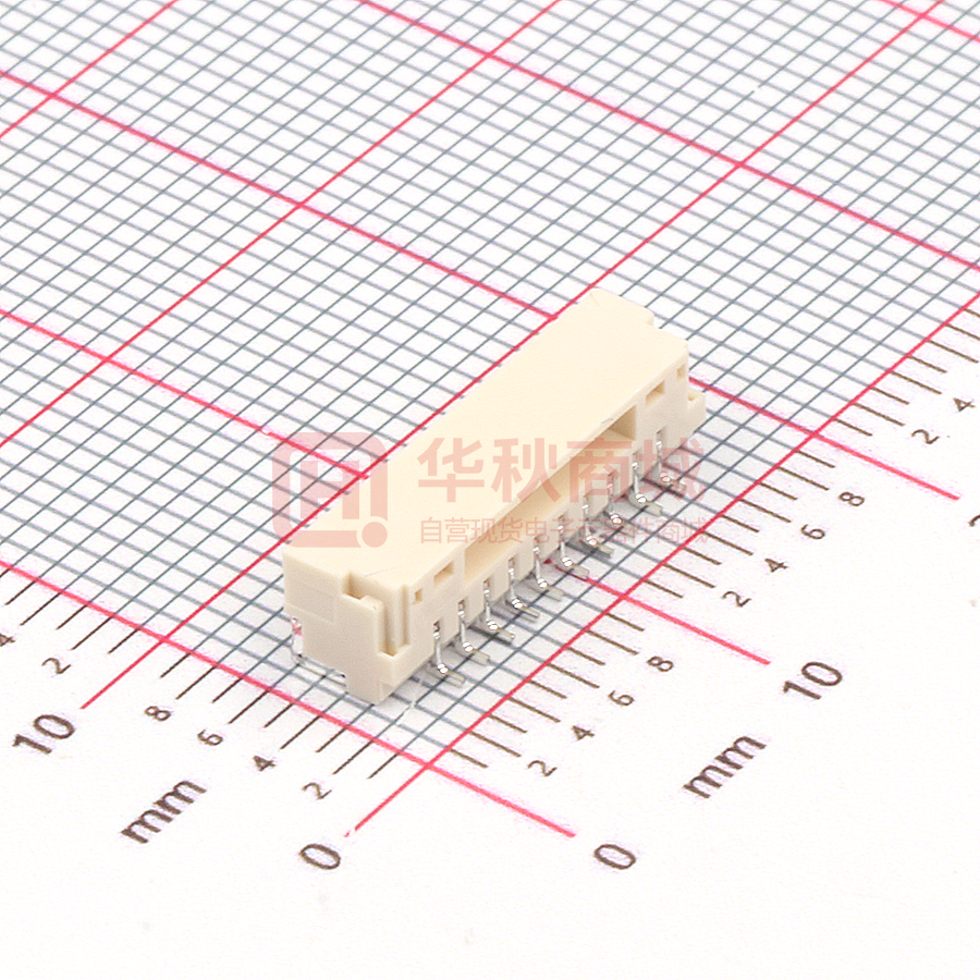

GH CONNECTOR Emboss Tape 1.25 mm pitch/Disconnectable Crimp style connectors GH CONNECTOR Specifications Developed for PDP, LCD or small electronics equipment. This low insertion force type connector realizes easier mating operation. The basic concept of the contact part of this connector is equivalent to the performance proven SHL connector. ® ● ● ● ● Secure locking structure Contact lock structure Prevention of contact deformation Clear engagement click sounds • Current rating: 1.0 A AC/DC (AWG #26) • Voltage rating: 50 V AC/DC • Temperature range: -25℃ to +85℃ (including temperature rise in applying electrical current) • Contact resistance: Initial value/ 30 mΩ max. After environmental tests/ 50 mΩ max. • Insulation resistance: 100 MΩ min. • Withstanding voltage: 500 VAC/minute • Applicable wire: Conductor size/ AWG #30 to #26 Insulation O.D./ 0.76 to 1.0 mm * In using the products,refer to "Handling Precautions for Terminals and Connectors" described on our website (Technical documents of Product information page). * RoHS2 compliance * Dimensional unit: mm * Contact JST for details. ® ® Standards ®   ® Recognized E60389 PC board layout and Assembly layout Top entry type Side entry type 0.6±0.05 4.25 1.25±0.05 0.6±0.05 1.25 ±0.05 Header outline 1 ±0.1 1 ±0.1 Header outline 4.35 5.4±0.1 2.7±0.1 3.7±0.1 1.35 ±0.1 0.3±0.1 ±0.1 1.35 0.25 ±0.1 2.8±0.1 (7.3) 3.9±0.1 5.6±0.1 (7.15) Note: 1 . The above figure is the figure viewed from the connector mounting side. 2. T  olerances are non-cumulative: ± 0.05 mm for all centers. 3. The dimensions above should serve as a guideline. Contact JST for details. Contact Applicable wire AWG # mm2 Model No. SSHL-002T-P0.2 2.3 0.8 0.4 35,000 RoHS2 compliance Note: 1. Contact JST for gold-plated product. 2. T  his contact can be applied only for the GH connector. SSHL-003( )-P0.2 cannot be applied for the GH connector. Contact Crimping machine Crimp applicator SSHL-002T-P0.2 AP-K2N 1 0.76~1.0 Phosphor bronze, tin-plated (reflow treatment) 2.1 0.85 30~26 Q'ty/reel Material and Finish 4.8 0.6 0.05~0.13 Insulation O.D. (mm) MKS-L-10-3 Applicator Dies Crimp applicator with dies MK/SSHL-002-02 APLMK SSHL002-02 Note: Contact JST for fully automatic crimping applicator. GH CONNECTOR Housing No. of Circuits GHR-02V-S GHR-03V-S GHR-04V-S GHR-05V-S GHR-06V-S GHR-07V-S GHR-08V-S GHR-09V-S GHR-10V-S GHR-11V-S GHR-12V-S GHR-13V-S GHR-14V-S GHR-15V-S 2 3 5 6 7 8 9 5.7 10 11 12 13 Circuit No.1 1.25 14 2.65 15 A Q'ty/ bag 1.25 3.75 3,000 2.50 5.00 3,000 3.75 6.25 3,000 5.00 7.50 3,000 6.25 8.75 3,000 7.50 10.00 3,000 8.75 11.25 3,000 10.00 12.50 3,000 11.25 13.75 3,000 12.50 15.00 3,000 13.75 16.25 3,000 15.00 17.50 3,000 16.25 18.75 3,000 17.50 20.00 3,000 GH CONNECTOR 4 4.15 Dimensions (mm) A B Model No. Material and Finish B PBT, UL94V-0, natural (white) RoHS2 compliance As the color identification, the following alphabet shall be put in the underlined part. For availability, delivery and minimum order quantity, contact JST. ex. GHR-04V-SS...natural (white) LE...light blue TR...tomato red K...black E...blue O...orange L...lemon yellow MG...moss green DPK...dark pink DP...dark purple Shrouded header No. of circuits Top entry type 4.25 2 0.7 3 4 4.05 5 1.25 0.2 6 7 8 Circuit No.1 A 9 B 10 11 12 Side entry type 13 4.05 0.8 14 15 Model No. Top entry type Side entry type BM02B-GHS-TBT BM03B-GHS-TBT BM04B-GHS-TBT BM05B-GHS-TBT BM06B-GHS-TBT BM07B-GHS-TBT BM08B-GHS-TBT BM09B-GHS-TBT BM10B-GHS-TBT BM11B-GHS-TBT BM12B-GHS-TBT BM13B-GHS-TBT BM14B-GHS-TBT BM15B-GHS-TBT SM02B-GHS-TB SM03B-GHS-TB SM04B-GHS-TB SM05B-GHS-TB SM06B-GHS-TB SM07B-GHS-TB SM08B-GHS-TB SM09B-GHS-TB SM10B-GHS-TB SM11B-GHS-TB SM12B-GHS-TB SM13B-GHS-TB SM14B-GHS-TB SM15B-GHS-TB Dimensions (mm) Q'ty/ reel B A 1.25 5.75 2,500 2.50 7.00 2,500 3.75 8.25 2,500 5.00 9.50 2,500 6.25 10.75 2,500 7.50 12.00 2,500 8.75 13.25 2,500 10.00 14.50 2,500 11.25 15.75 2,500 12.50 17.00 2,500 13.75 18.25 2,500 15.00 19.50 2,500 16.25 20.75 2,500 17.50 22.00 2,500 Material and Finish 4.25 Contact: Phosphor bronze, copper-undercoated, tin-plated (reflow treatment) Housing: PA 9T, UL94V-0, natural (ivory) Reinforcement: Brass, copper-undercoated, tin-plated Circuit No.1 1.25 0.2 1.75 A B RoHS2 compliance This product displays (LF)(SN) on a label. Note: Contact JST for gold-plated product. As the color identification, the following alphabet shall be put in the underlined part. For availability, delivery and minimum order quantity, contact JST. ex. BM04B-GHS-TBTS...natural (ivory) LE...light blue TR...tomato red K...black E...blue O...orange L...lemon yellow MG...moss green DPK...dark pink DP...dark purple 2 GH CONNECTOR Housing (Keying pattern A) 4.15 No. of circuits Model No. 2 GHR-02V-2P GHR-04V-2P GHR-05V-2P 4 5.7 5 Dimensions (mm) A B Q'ty/ bag 1.25 3.75 3,000 3.75 6.25 3,000 5.00 7.50 3,000 Material and Finish PBT, UL94V-0, purple RoHS2 compliance 2.95 B As the color identification, the following alphabet shall be put in the underlined part. For availability, delivery and minimum order quantity, contact JST. ex. GHR-04V-2PP...purple (for keying pattern A) HD...dark gray (for keying pattern B) 1.25 Circuit No.1 A Header (Keying pattern A) No. of circuits Top entry type 2 4 A 1.25 5 Circuit No.1 0.2 Model No. Top entry type Side entry type BM02B-GHP-A-TBT BM04B-GHP-A-TBT BM05B-GHP-A-TBT SM02B-GHP-A-TB SM04B-GHP-A-TB SM05B-GHP-A-TB Dimensions (mm) Q'ty/ reel A B 1.25 5.75 2,500 3.75 8.25 2,500 5.00 9.50 2,500 Material and Finish Contact: Phosphor bronze, copper-undercoated, tin-plated (reflow treatment) Housing: PA 9T, UL94V-0, purple Reinforcement: Brass, copper-undercoated, tin-plated RoHS2 compliance This product displays (LF)(SN) on a label. 4.25 0.7 As the color identification, the following alphabet shall be put in the underlined part. For availability, delivery and minimum order quantity, contact JST. ex. 4.05 P...purple (for keying pattern A) HD...dark gray (for keying pattern B) B Side entry type 4.05 Circuit No.1 1.25 0.2 A B 3 1.75 BM04B-GHP-A-TBT- 0.8 GH CONNECTOR Housing (Keying pattern B) No. of circuits 4.15 Model No. GHR-02V-3HD GHR-04V-3HD GHR-05V-3HD 2 4 5.7 5 Dimensions (mm) A B Q'ty/ bag 1.25 3.75 3,000 3.75 6.25 3,000 5.00 7.50 3,000 Material and Finish PBT, UL94V-0, dark gray RoHS2 compliance 2.95 B As the color identification, the following alphabet shall be put in the underlined part. For availability, delivery and minimum order quantity, contact JST. ex. GHR-02V-3HDP...purple (for keying pattern A) HD...dark gray (for keying pattern B) Circuit No.1 1.25 A Header (Keying pattern B) No. of circuits Top entry type 2 A 1.25 0.2 4 Circuit No.1 5 Model No. Side entry type Top entry type BM02B-GHHD-B-TBT SM02B-GHHD-B-TB BM04B-GHHD-B-TBT SM04B-GHHD-B-TB BM05B-GHHD-B-TBT SM05B-GHHD-B-TB Dimensions (mm) Q'ty/ reel A B 1.25 5.75 2,500 3.75 8.25 2,500 5.00 9.50 2,500 Material and Finish Contact: Phosphor bronze, copper-undercoated, tin-plated (reflow treatment) Housing: PA 9T, UL94V-0, dark gray Reinforcement: Brass, copper-undercoated, tin-plated 4.25 0.7 RoHS2 compliance This product displays (LF)(SN) on a label. Note: Contact JST for gold-plated products. As the color identification, the following alphabet shall be put in the underlined part. For availability, delivery and minimum order quantity, contact JST. 4.05 ex. BM04B-GHHD-B-TBTP...purple (for keying pattern A) HD...dark gray (for keying pattern B) B Side entry type 0.8 4.25 4.05 Circuit No.1 1.25 0.2 1.75 A B 4

物料型号: - GH CONNECTOR - SSHL-002T-P0.2 - GHR-02V-S, GHR-03V-S, GHR-04V-S, GHR-05V-S, GHR-06V-S, GHR-07V-S, GHR-08V-S, GHR-09V-S, GHR-10V-S, GHR-11V-S, GHR-12V-S, GHR-13V-S, GHR-14V-S, GHR-15V-S - BMO2B-GHS-TBT, SM02B-GHS-TB, BM03B-GHS-TBT, SM03B-GHS-TB, 等等
器件简介: - 适用于PDP、LCD或小型电子设备的低插入力连接器,便于操作。 - 接触部分的基本理念与性能经过验证的SHL连接器相当。
引脚分配: - 1.25毫米间距的可断开压接式连接器。
参数特性: - 电流额定值:1.0 A AC/DC(AWG #26) - 电压额定值:50 V AC/DC - 温度范围:-25℃至+85℃ - 接触电阻:初始值/最大30 mΩ,环境测试后/最大50 mΩ - 绝缘电阻:最小100 MΩ - 耐电压:500 VAC/分钟 - 适用电线:导体尺寸AWG #30至#26,绝缘外径0.76至1.0毫米
功能详解: - 安全锁定结构,防止接触变形,清晰啮合点击声。
应用信息: - 用于PDU、LCD或小型电子设备。
封装信息: - 包括顶入式和侧入式两种类型,提供了详细的尺寸和引脚布局。
材料和表面处理: - 接触材料:铍青铜,镀锡(回流处理) - 外壳材料:PBT,UL94V-0,自然色(白色)或象牙色 - 符合RoHS2标准。
注意: - 产品标签上显示(LF)(SN)。 - 有关颜色标识,文档提供了参考字母以供识别。
