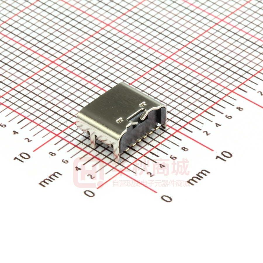

    USB连接器 Type-C 6P 卧贴 端口数:1 额定电流:3A 额定电压:48V 工作温度:-30℃~+85℃
USB4125-GF-A 数据手册
5.50 3.04 1.00 4x 1.70 4x 1.20 1.20 2x0.70 2x 0.76 2x 0.80 0.68 B12 B9 A5 B5 A9 A12 2.60 F 4x 0.60 4x 1.10 8.94 Pin Signal Mating Sequence A5 CC1 Second A9 VBUS First A12 GND First B5 CC2 Second B9 VBUS First B12 GND First SHELL Specifications GND Solder Area Component Outline A12 0.10 B12 B9 B5 8.64±0.15 2.56±0.04 2.60±0.15 3.00A collectively for VBUS pins 4.25A collectively for GND pins 1.25A for B5 pin 0.25A for A5 pin Voltage Rating: 20V DC Contact Resistance: 40mΩ max initial. 50mΩ max after test Dielectric Withstanding Voltage: 100V AC Insulation Resistance 100MΩ min 3.80±0.15 6.65 3.75 Mechanical & Environmental Operating Temperature: -30°C to +85°C Mating Force: 5 to 20 N. Unmated Force: 6 to 20 N after test Durability: 20,000 cycles 5.60 6.78 1.85 1.00 C Electrical Current Rating: 4x 0.80±0.10 Ordering Grid Plug D 1.20±0.05 3.16 A9 S±0.25 Tolerance: ±0.05mm 8.34+0.06 -0.02 A5 Plating Contact Contact Area: Gold Flash Solder Tails: 80u" min. Matte Tin over Nickel Shell: 50µ" min. Nickel 8.64 Recommended PCB Layout Thickness 1.00±0.10mm E Material Insulator: LCP, UL 94V-0, Black Contact: Copper Alloy Shell: Stainless Steel (1.00mm stake shown) 6.80±0.15 G 3.80 H XX USB4125 A Contact Plating GF = Gold Flash B 2x 0.60±0.05 2x 0.56±0.05 2x 0.50±0.05 1.00±0.10 3.04±0.10 A Packing Options A = Tape & Reel (1000 per reel) Plug and Receptacle Mating View Product Description USB4125 Type C Receptacle, Horizontal, SMT, For Power Charging Only Drawing Date 28th September 2020 By 2 Detail 3 4 Revision Date 5 CC Drawing Release A2 30/04/21 Tolerances (Except as Noted) Length Angle X.X ± 0.30 X.XX ± 0.25 X.XXX ± 0.10 - Units: Metric (mm) C 3rd Angle Projection 6 Request Samples and Quotation Shell Stake Length "S" Blank = 1.00mm 0190 = 1.90mm Part Number 5.50±0.10 1 XXXX 7 This drawing is confidential and copyright of Global Connector Technology, Ltd (GCT). This drawing must not be copied or disclosed without written consent. E & OE www.gct.co Not to Scale Drawn By CC 8 Sheet No. 1/2 Folder Paper Board H Unloaded Section (16 Pockets) 1000 PCS Unloaded Section (16 Pockets) Paper Board G Direction of Unreeling Peeling Angle F Vacuum Bag 165°~180° Reel and Tape Direction of Unreeling Ø330 E Carton Reel and Tape Ø13 D 320 W+0.5 Label Direction of Unreeling 34 0 0 34 C 4.00 5.40 Paper Board 16.00 7.50 2.00 Ø1 .5 0 12.00 B Pcs / Reel 1000 Product Description USB4125 Type C Receptacle, Horizontal, SMT, For Power Charging Only 28th September 2020 By Detail Revision Date 1 2 3 4 Total Quantity 13,000 pcs Part Number Drawing Date A Reels / Carton 13 5 CC Drawing Release A2 30/04/21 Tolerances (Except as Noted) Length Angle Units: Metric (mm) - - C 3rd Angle Projection 6 7 This drawing is confidential and copyright of Global Connector Technology, Ltd (GCT). This drawing must not be copied or disclosed without written consent. E & OE www.gct.co Not to Scale Drawn By CC 8 Sheet No. 2/2
