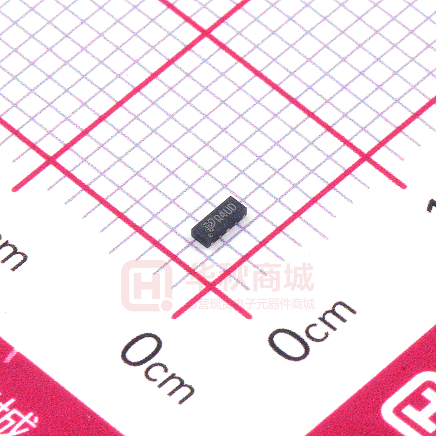

    ESD抑制器/TVS二极管 4通道 VRWM=5V VBR(Min)=6.4V VC=13V@IPP=5A
TPESD05R4UD 数据手册
TPESD05R4UD 4-Line Uni-directional TVS Diode www.sot23.com.tw Features Mechanical Characteristics u 70 Watts Peak Pulse Power ( 8/20μs ) u Package: DFN2510-10 (2.5×1.0×0.5mm) u Protects two or four I/O lines u Ultra low leakage: nA level u Low capacitance: 0.3 pF typical (I/O to I/O) u Case Material: “Green” Molding Compound. u Low operating voltage: 5V u UL Flammability Classification Rating 94V-0 u RoHS Compliant u Moisture Sensitivity: Level 3 per J-STD-020 u IEC61000-4-2 (ESD) ±20kV (air), ±15kV (contact) u Terminal Connections: See Diagram Below u IEC61000-4-4 (EFT) 40A (5/50ηs) u IEC61000-4-5 (Lightning) 5A(8/20μs) Applications Ordering Information Part Number TPESD05R4UD Qty per Reel 3000 Reel Size 7” u High Definition Multimedia Interface (HDMI) u Digital Visual Interface (DVI) u Unified Display Interface (UDI) u MDDI Ports u PCI Express u Serial ATA Dimensions and Pin Configuration NC 10 NC GND NC 9 8 7 NC 6 www.kxw-esd.com 1 2 3 4 Pin 1 Pin 2 Pin 4 Pin 5 5 I/O1 I/O2 GND I/O3 I/O4 Pin Description (Top View) 3,8 Device Schematic Pin # 1, 2, 4, 5 6, 7, 9, 10 3, 8 Description I/O No Connection GND Marking: R4UD 1 WWW.TECHPUBLIC.COM.TW TPESD05R4UD 4-Line Uni-directional TVS Diode www.sot23.com.tw Absolute Maximum Ratings (Tamb=25°C unless otherwise specified) Parameter www.kxw-esd.com Peak Pulse Power (8/20µs) Symbol Value Unit Ppk 70 W www.kxw-esd.com www.kxw-esd.com ESD per IEC 61000−4−2 (Air) ±20 VESD ESD per IEC 61000−4−2 (Contact) kV ±15 www.kxw-esd.com TJ −55 to +125 °C Storage Temperature Range www.kxw-esd.com Tstg −55 to +150 °C IC Operating Temperature Range Reverse Working Voltage Breakdown Voltage Max Unit 5 V Any I/O pin to ground 9.2 V IT = 1mA, any I/O pin to ground 0.05 µA VRWM = 5V, any I/O pin to ground VC 10 V VC 13 V VRWM VBR Reverse Leakage Current Clamping Voltage IR TE www.kxw-esd.com Clamping Voltage Symbol Min Typ PU www.kxw-esd.com 6.4 7.5 0.01 CH Parameter BL Electrical Characteristics (TA=25°C unless otherwise specified) Junction Capacitance CJ 0.3 Junction Capacitance CJ 0.6 0.8 Test Condition IPP = 1 A (8 x 20µs pulse), any I/O pin to ground IPP = 5 A (8 x 20µs pulse), any I/O pin to ground pF VR = 0V, f = 1MHz, between I/O pins pF VR = 0V, f = 1MHz, any I/O pin to ground WWW.TECHPUBLIC.COM.TW 2 TPESD05R4UD 4-Line Uni-directional TVS Diode www.sot23.com.tw Characteristic Curves 8/20μs Pulse Waveform Fig2. ESD Pulse Waveform (according to IEC 61000-4-2) tr 100 Peak Value IPP 80 100% TEST WAVEFORM PARAMETERS tr=8μs td=20μs Percent of Peak Pulse Current % 60 40 td=t IPP/2 20 0 0 5 10 15 20 25 www.kxw-esd.com tr = 0.7~1ns Time (ns) 60ns Non - Repetitive Peak Pulse Power vs. Pulse Time CH 10 1 0.1 TE Peak Pulse Power - PPK (kW) 10% PU Fig3. www.kxw-esd.com 30ns 30 t - Time (μs) www.kxw-esd.com 90% BL IPP - Peak Pulse Current - % of IPP 120 IC Fig1. 0.01 0.1 1 10 100 1000 Pulse Duration - tp (μs) 3 WWW.TECHPUBLIC.COM.TW TPESD05R4UD 4-Line Uni-directional TVS Diode www.sot23.com.tw Application Information   1 2 3 GND 8 TPESD05R4UD 4 5 1 IC www.kxw-esd.com 2 3 GND 8 TPESD05R4UD 4 BL 5 IC 1 2 3 8 TPESD05R4UD PU GND 4 5 TE CH     ESD protection for HDMI port     TMDS_D2+ TMDS_D2_   TMDS_GND   TMDS_D1+   TMDS_D1_   TMDS_D0+   TMDS_D0_   TMDS_GND TMDS_CK+   TMDS_CK_   CE_REMOTE   DDC_CLK     DDC_DAT   HOTPLUG_DET       4 WWW.TECHPUBLIC.COM.TW TPESD05R4UD 4-Line Uni-directional TVS Diode www.sot23.com.tw Outline Drawing - DFN2510-10 D B DIM www.kxw-esd.com E A SEATING PLANE aaa C A2 b1xN bbb R0.125 1 2 C A B PU E/2 C A1 A A1 A2 b b1 D E e L N aaa bbb BL PIN 1 INDICATOR (LASER MARK) DIMENSIONS INCHES MILLIMETERS MIN NOM MAX MIN NOM MAX .020 .023 .026 0.50 0.58 0.65 0.00 .001 .002 0.00 0.03 0.05 (.005) (0.13) .006 .008 .010 0.15 0.20 0.25 .014 .016 .018 0.35 0.40 0.45 .094 .098 .102 2.40 2.50 2.60 .035 .039 .043 0.90 1.00 1.10 .020 BSC 0.50 BSC .012 .015 .017 0.30 0.38 0.425 8 8 0.08 .003 0.10 .004 IC A LxN 2X R0.075 7 PLACES CH N bxN e bbb C A B TE D/2 Land Pattern - DFN2510-10 P1 P DIMENSIONS DIM C G P P1 X X1 Y Y1 Z Y Z (C) (Y1) G X X1 5 INCHES (.034) .008 .020 .039 .008 .016 .027 (.061) .061 MILLIMETERS (0.875) 0.20 0.50 1.00 0.20 0.40 0.675 (1.55) 1.55 WWW.TECHPUBLIC.COM.TW
