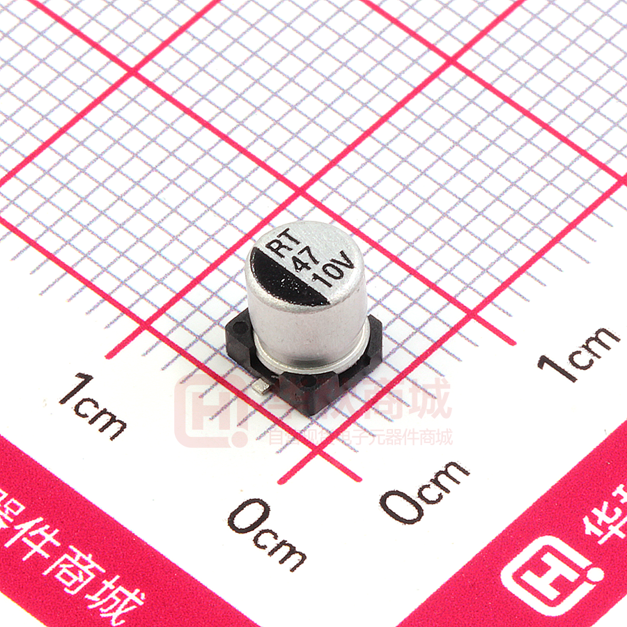

    SMD,D5xL5.4mm
    贴片铝电解电容 SMD,D5xL5.4mm 47µF ±20% 10V 2000Hrs@105℃
RT1A470M0505 数据手册
客户 MESSRS 深圳市立创电子商务有限公司 承认书 SPECIFICATIONS FOR APPROVAL ROQANG 发行日期 Release Date: 2018 年 8 月 30 日 ROQANG Issue 发行编号: NO: RQ20180801-001 制品名 贴片型铝电解电容器 PRODUCT NAME: V-chip Aluminum Electrolytic Capacitors ROQANG 系列: RT SERIES: 规格 DESCRIPTION Series, 105C, 20%, Standard 料号: (详见电气参数及料号) Material NO:(See electrical parameters and material number) 客户承认栏 APPROVAL COLUMN 审核 CHECKED BY 发行确认栏 APPROVED BY 确认 APPROVED BY 审核 CHECKED BY 确认 APPROVED BY 章江峰 范君兰 签认后, 敬请惠返一份, 多谢! Please chop, sign and return to us a copy after approval. Thank you! 1 RT SERIES V-chip Aluminum Electrolytic Capacitors 二、物料清单 NO 1 2 3 4 5 6 7 8 9 10 11 12 13 14 15 16 17 18 19 20 21 22 23 24 25 26 27 28 29 30 31 32 33 34 Seri es RT RT RT RT RT RT RT RT RT RT RT RT RT RT RT RT RT RT RT RT RT RT RT RT RT RT RT RT RT RT RT RT RT RT 料号 WV Cap. (V) (uF) Cap. DF LC tol. (%) (uA) (%) 120Hz (2min) 120Hz 20℃ ≤ 20℃ ≤ DΦ* L E RT1V101M0607 35 100 ±20 16 35 6.3*7.7 2.2 RT1C221M0607 16 220 ±20 20 35.2 6.3*7.7 2.2 RT1J220M0607 63 22 ±20 12 13.8 6.3*7.7 2.2 RT1E101M0607 25 100 ±20 18 25 6.3*7.7 2.2 RT1H470M0607 50 47 ±20 14 23.5 6.3*7.7 2.2 RT1H220M0605 50 22 ±20 14 11 6.3*5.4 2.2 RT1A221M0605 10 220 ±20 24 22 6.3*5.4 2.2 RT1J100M0605 63 10 ±20 12 6.3 6.3*5.4 2.2 20 16 6.3*5.4 2.2 RT1C101M0605 16 100 ±20 RT1A101M0605 10 100 ±20 24 10 6.3*5.4 2.2 16 16.45 6.3*5.4 2.2 RT1V470M0605 35 47 ±20 RT1E470M0605 25 47 ±20 18 11.75 6.3*5.4 2.2 RT1A101M0505 10 100 ±20 24 10 5*5.4 1.3 RT1C470M0505 16 47 20 7.5 5*5.4 1.3 RT0J101M0505 6.3 100 ±20 30 6.3 5*5.4 1.3 RT1H100M0505 50 10 ±20 14 5 5*5.4 1.3 RT1A470M0505 10 47 ±20 24 4.7 5*5.4 1.3 RT1V100M0505 35 10 ±20 16 3.5 5*5.4 1.3 18 2.5 5*5.4 1.3 ±20 RT1E100M0505 25 10 ±20 RT1C471M0810 16 470 ±20 20 75.2 8*10.2 3.1 RT1V221M0810 35 220 ±20 16 77 8*10.2 3.1 RT1E221M0810 25 220 ±20 18 55 8*10.2 3.1 RT1H101M0810 50 100 ±20 14 50 8*10.2 3.1 30 63 8*10.2 3.1 RT0J102M0810 6.3 1000 ±20 RT1A102M0810 10 1000 ±20 24 100 8*10.2 3.1 RT1A471M0810 10 470 ±20 24 47 8*10.2 3.1 20 160 10*10.2 4.2 RT1C102M1010 16 1000 ±20 RT1A102M1010 10 1000 ±20 20 100 10*10.2 4.2 RT1H221M1010 50 220 ±20 14 110 10*10.2 4.2 RT1V331M1010 35 330 ±20 16 115 10*10.2 4.2 RT1E471M1010 25 470 ±20 18 117 10*10.2 4.2 16 165 10*10.2 4.2 12 63 63 10*10.2 4.2 RT1V471M1010 35 470 ±20 RT1J101M1010 63 100 ±20 Remarks ±0.5 2 RT SERIES V-chip Aluminum Electrolytic Capacitors 产品承认书目录 一、承认书封面 …………………………………………………………………第 1 页 二、物料清单 …………………………………………………………………第 2 页 三、承认书目录 …………………………………………………………………第 3 页 四、工艺流程 …………………………………………………………………第 4 页 五、承认书内容 1.范围 ………………………………………………………第 5 页 2.参考标准 ………………………………………………………第 5 页 3.环境保护标准 ………………………………………………………第 5 页 4.使用温度范围 ………………………………………………………第 5 页 5.电压范围 ………………………………………………………第 5 页 6.容量范围 ………………………………………………………第 5 页 7.容量偏差范围 ………………………………………………………第 5 页 8.漏电流 ………………………………………………………第 5 页 9.损耗角 ………………………………………………………第 5 页 10.低温特性 ………………………………………………………第 5 页 11.耐久性 ………………………………………………………第 6 页 12.高温储存 ………………………………………………………第 6 页 13.耐焊接热 ………………………………………………………第 6 页 14.产品标识 ………………………………………………………第 7 页 15.产品图样 ………………………………………………………第 7 页 16.产品尺寸 ………………………………………………………第 8 页 17.编带说明 ………………………………………………………第 8 页 18.无铅回流焊接 ………………………………………………………第 11 页 19.引线原材料 ………………………………………………………第 12 页 20.电容器代码标志 ………………………………………………………第 12 页 21.电容器结构 ………………………………………………………第 13 页 22.纹波电流的频率系数……………………………………………………第 13 页 23.电气参数及料号 ……………………………………………………第 13 页 24.片式铝电解电容器一般使用注意事项…………………………………第 14 页 A.电路设计 ………………………………………第 14 页 B.安装 ………………………………………第 16 页 C.安装后 ………………………………………第 17 页 D.维护和检验 ………………………………………第 18 页 E.紧急情况 ………………………………………第 18 页 F.储存 ………………………………………第 18 页 G.处置 ………………………………………第 19 页 3 RT SERIES V-chip Aluminum Electrolytic Capacitors 4 RT 1.范围: SERIES V-chip Aluminum Electrolytic Capacitors Scope 适用“RT 系列”立式片式铝电解电容器 This specification covers “RVT Series” V-chip aluminum electrolytic capacitors. 2.参考标准: Reference Standard 国际标准 IEC 60384 与日本工业标准 JIS C-5101 The international standard IEC 60384 and Japanese industrial standard JIS C-5101. 3.环境保护标准: Environmental Protection Standard 遵照欧盟指令 2002/95/EC. Comply with the EU directive 2002/95/EC. 4.使用温度范围: Operating Temperature Range -40C ~ +105C 5.电压范围: Voltage Range DC: 4 ~ 100V 6.容量范围: Capacitance Range CAP: 0.1~ 6800F 7.容量偏差范围: Capacitance Tolerance 20% at 120Hz, +20C 8.漏电流: Leakage Current Ф4~Ф10 Ф12.5~Ф16 2 分钟后读数 I ≤ 0.01 CV or 3 (A) whichever is greater (After 2 minutes of reading) 1 分钟后读数 I ≤ 0.03 CV or 4 (A) whichever is greater (After 1 minutes of reading) 9.损耗角: Tan  测试频率:120Hz,温度:20℃ Measurement frequency: 120Hz, Temperature: 20C Rated Voltage (V) 4 6.3 10 16 25 35 Ф4~Ф10 0.35 0.32 0.24 0.20 0.18 0.16 Tan (max.) Ф12.5~Ф16 0.40 0.38 0.34 0.30 0.26 0.22 注:容量超过 1,000uF 者,每增加 1,000uF 则 tanδ设定增加 0.02. 50 0.14 0.18 63 0.14 0.14 100 0.14 0.14 10.低温特性: Stability at Low Temperature 测试频率:120Hz (Measurement frequency: 120Hz) Low Temperature Stability Impedance Ratio (MAX)120Hz Rated Voltage (V) Z-25C/Z+20C Ф4~Ф10 Z-40℃/Z+20℃ Z-25C/Z+20C Ф12.5~Ф16 Z-40℃/Z+20℃ 4 7 17 7 17 6.3 4 10 5 12 10 3 8 4 10 16 2 6 3 8 25 2 4 2 5 35 2 3 2 4 50 2 3 2 3 63 2 3 2 3 100 3 4 2 3 5 RT V-chip Aluminum Electrolytic Capacitors SERIES 11.耐久性: Load Life 在 105℃环境中,按照规定时间连续加载额定电压后,待温度恢复到 25℃进行测量时,应满足以下 要求. The following specifications shall be satisfied when the capacitors are restored to 25℃ after the rated voltage is applied for the specifiedperiod of time at 105℃, Should meet the following requirements 尺寸代码 Size code 规定时间 Time 容量变化率 Capacitance Change 损耗角正切值 Dissipation Factor 漏电流 Leakage Current 4*5.4~6.3*5.4L 2000 小时(2,000 hours) ±30%初始值内 Within 30% of initial value ≤300%初始规定值 Not more than 200% of the specified value ≤初始规定值 Not more than the specified value 6.3*7.7~10*13.5L 2000 小时 (2,000 hours) ±25%初始值内 Within 25% of initial value ≤300%初始规定值 Not more than 200% of the specified value ≤初始规定值 Not more than the specified value 12.5*13.5~16*16.5L 2000 小时(2,000 hours) ±20%初始值内 Within 20% of initial value ≤200%初始规定值 Not more than 200% of the specified value ≤初始规定值 Not more than the specified value 12.高温储存: Shelf Life 在 105℃环境中,无负荷放置 1,000 小时(Ф4*5.4~Ф6.3*5.4L:500 小时)后待温度恢复到 25℃, 进行试验前处理 (JIS C 5101-4 4.1 项) 后进行测量时,应满足上述耐久性的标准值. The following specifications shall be satisfied when the capacitors are restored to 25℃ after exposing them for 1,000 hours (500 hours for Ф4*5.4 toФ6.3*5.4L size) at 105℃ without voltage applied. Before the measurement, the capacitor shall be preconditioned by applying voltage according to Item 4.1 of JIS C 5101-4,Should meet the above durability of the standard value. 13.耐焊接热:Resistance to Soldering Heat 在 250℃的条件下,电容器在热板上保持 30 秒,然后从热板上取下电容器,让其在室温下恢复,电 容器应满足以下要求: The capacitors shall be kept on then hot plate maintained at 250℃ for 30 seconds.After removing from the hot plate and restored at room temperature, they meet the following requirement : 容量变化率 Capacitance Change 损耗角正切值 Dissipation Factor 漏电流 Leakage Current ±10%初始值内 Within ±10% of the initial value ≤初始规定值 Not more than the specified value ≤初始规定值 Not more than the specified value 6 RT V-chip Aluminum Electrolytic Capacitors SERIES 14.标识: Marking 电容器标识内容如下: Capacitors shall be legibly marked with the following: 1) 产品系列: Manufacture’s mark 2) 额定电压和标称容量: Rated voltage and nominal capacitance 3) 负极标识: Negative polarity ≥ 系列名称 负极标识 标称容量 额定电压 15.图样: Drawing (Unit: mm) (4~6.3)端子代码:A 型 RT 470 35V 系列名称 负极标识 标称容量 额定电压 RT 470 50V 标称容量 额定电压 Positive Plastic platefom B±0.2 E±0.2 P A±0.2 E±0.2 0.3max. D±0.5 系列名称 C±0.2 RT 100 16V 0.4Max. 负极标示 Negative L±0.3 W (8,~ 10) 端子代码:A 型 C±0.2 P E0.2 D±0.5 A±0.2 E0.2 B±0.2 0.3max. 0.4Max. Positive Plastic platform Negative L0.5 W 7 RT SERIES V-chip Aluminum Electrolytic Capacitors (8,~ 16) 端子代码:G 型 B±0.2 C±0.2 E0.2 P (b) D±0.5 A±0.2 E0.2 0.3max. 0.4Max. Positive Plastic platform (a) L0.5 Negative W 16.尺寸:Dimensions (Unit: mm) Size A B C P L W Ф4×5.4 4.3 4.3 5.1 1.0 5.4 Size A B C P L (a) (b) W Ф8×10.2 8.3 8.3 9.2 3.1 10.2 0.5 1.8 17.编带说明: Ф5×5.4 5.3 5.3 6.1 1.3 5.4 Ф6.3×5.4 Ф6.3×7.7 6.6 6.6 6.6 6.6 7.4 7.4 2.2 2.2 5.4 7.7 0.5 ~ 0.8 Ф10×10.2 10.3 10.3 11.2 4.5 10.2 0.5 2.1 0.7 ~ 1.1 Ф10×13.5 10.3 10.3 11.2 4.5 13.5 0.5 2.1 Ф8×6.5 8.3 8.3 9.2 3.1(2.2) 6.5 Ф12.5×13.5 13.0 13.0 13.8 4.5 13.5 1.3 3.0 Ф12.5×16 13.0 13.0 13.8 4.5 16.0 1.3 3.0 1.0 ~ 1.3 Ф16×16.5 17.0 17.0 18.0 6.5 16.5 2.0 3.0 Taping Specifications 符合标准 JIS C0806 与 IEC 602863.(Applicable standard JIS C0806 and IEC 60286) 17.1.盒带图样尺寸与包装 Cassette pattern size and packaging Fig.1 (4 ~ 10) 8 RT V-chip Aluminum Electrolytic Capacitors SERIES 尺寸 Size W P F A0 B0 T2 (MM) (MM) (MM) (MM) (MM) (MM) Φ4*5.4 12 8 5.5 4.7 4.7 5.8 -- Φ5*5.4 12 12 5.5 6.0 6.0 5.8 -- Φ6.3*5.4 16 12 7.5 7.0 7.0 5.8 -- Φ6.3*7.7 16 12 7.5 7.0 7.0 8.3 -- Φ8*6.5 16 12 7.5 8.7 8.7 7.0 -- Φ8*10.2 24 16 11.5 8.7 8.7 11.0 -- Φ10*10.2 24 16 11.5 10.7 10.7 11.0 -- Φ10*13.5 24 16 11.5 10.7 10.7 14.1 -- S 形状 Applicabl e Fig.1 Fig.2 (Φ12 以上产品) W P F A0 B0 T2 (MM) (MM) (MM) (MM) (MM) (MM) Φ12.5*13.5 32 24 14.2 14.0 14.0 14.1 28.4 Φ12.5*16 32 24 14.2 14.0 14.0 16.4 28.4 Φ16*16.5 44 28 20.2 17.5 17.5 16.9 40.4 尺寸 Size S 形状 Applicabl e Fig.2 9 RT V-chip Aluminum Electrolytic Capacitors SERIES 17.2.卷盘 : Reel 2 130.5  D Max. 50 Min. 23 2.0 A 17.3. 包装数量: Package quantity 规格 Specification 卷装数量 Quantity/Reel 盒装数量 Quantity/Bag A±0.3 (MM) D±2 (MM) Φ4*5.4 2000 pcs 20000 pcs 14 382 Φ5*5.4 1000 pcs 10000 pcs 14 382 Φ6.3*5.4 1000 pcs 10000 pcs 18 382 Φ6.3*7.7 1000 pcs 10000 pcs 18 382 Φ8*6.5 1000 pcs 10000 pcs 18 382 Φ8*10.2 500 pcs 5000 pcs 26 382 Φ10*10.2 500 pcs 5000 pcs 26 382 Φ10*13.5 300 pcs 3000 pcs 26 382 Φ12.5*13.5 200 pcs 600 pcs 34 332 Φ12.5*16 150 pcs 450 pcs 34 332 Φ16*16.5 125 pcs 250 pcs 46 332 17.4. 托盘: Tray 10 RT SERIES V-chip Aluminum Electrolytic Capacitors 17.5. 包装数量: Package quantity 规格 Specification H(mm) W1(mm) H1(mm) 托盘数量 Quantity/ Tray 盒装数量 Quantity/Bag Ф12.5*13.5 21.0 284 18.4 120 600 Ф12.5*16 21.0 284 24.0 120 600 Ф16*16.5 28.0 284 24.0 80 400 18. 无铅回流焊接:Lead-free Reflow Soldering Condition A. 回流焊条件推荐:Recommended Conditions for Reflow Soldering: (1)应采用红外线及热风回流焊接,不宜采用汽相加热回流焊接; A thermal condition system such as infrared radiation (IR) or hot blast should be adopted, and vapor heat transfer systems (VPS) are not recommended. (2)推荐回流焊只进行一次,回流焊次数如果需要二次,必须相隔 60 分钟以上; Reflow soldering should be performed one time. If the capacitor has to be reflowed twice, 60 minutes must be layout between each time. (3)无铅回流焊,请符合下述条件: For lead-free type reflow soldering, please observe proper conditions below: a)从 150℃至 180℃的预热时间<120 秒以内; The time of preheating from 150°C to 180°C shall be within maximum 120 seconds; b)电容器顶部温度超过 217℃的焊接时间不超过 tL 时间; The time of soldering temperature at 217°C measured on capacitors' top shall not exceed tL (second); c)电容器顶部温度超过 230℃的焊接时间不超过 td 时间; The time of soldering temperature at 230°C measured on capacitors' top shall not exceed td (second); d)电容器顶部尖峰温度不超过 Tp℃,在 5℃范围内的实际尖峰温度时间不超过 tp 时间 The peak temperature on capacitors' top shall not exceed Tp(°C), and the time within 5°C of actual peak temperature shall not exceed tp (second). B.回流焊曲线图: Classification Reflow Profile: 11 RT V-chip Aluminum Electrolytic Capacitors SERIES C. 尖峰温度允许范围:Allowable Range of Peak Temperature Thickness (mm) 2.5 2.5 2.5 3.0 Size 4~6.3*7.7L 8*6.5L 8/1013.5L 12.5~16 Tp(°C) tL (second) td (second) tp (second) 250±0 240±0 235±0 230±0 ≤60 ≤30 ≤40 ≤20 ≤20 ≤10 ≤10 -- ≤5 ≤5 ≤5 ≤3 D.表面安装推荐尺寸: Recommended Land Size (Unit: mm) 尺寸 Size Φ4 Φ5 Φ6.3 Φ8 Φ10 Φ12.5 Φ16 X 1.6 1.6 1.6 2.5 2.5 3.0 3.5 Y 2.6 3.0 3.5 3.5 4.0 5.7 6.5 a 1.0 1.4 1.9 3.0 4.0 4.0 6.0 19.引线原材料: The Raw Materials of Lead Wire Name Material Fe Cu Sn TPCS Percentage 71.35% 20% 8.65% 20.电容器代码标志: Explanation of Part Number 1 2 3 Series 4 5 6 Voltage (WV) 7 8 Capacitance (F) 9 1R0 M 11 - Cap. Tol. (%) 范例: Example: RT 1H 10 12 13 Case Size 0405 外壳尺寸 Case Size (4*5.4mm) 电容量允许偏差 Capacitance Tolerance (20%) 电容量 Capacitance (1F) 电压 Voltage (50V) 系列 Series (RT) 额定电压 R.W.Voltage (V) 代 号 Code 4 6.3 10 16 25 35 50 63 100 200 250 400 450 500 0G 0J 1A 1C 1E 1V 1H 1J 2A 1D 2E 2G 2W 2H 12 RT V-chip Aluminum Electrolytic Capacitors SERIES 21. 结构:Construction 铝壳 Aluminum case 电解纸 Electrolytic paper 铝箔 (阳极和阴极) Aluminum foil (Anode & cathode foil) 电解液 Electrolytic 封口胶粒 Rubber seal 底座 Base plate 引出线 Lead wire 22. 额定纹波电流的频率导数 :Frequency Coefficient of Allowable Ripple Current 尺寸代码 4*5.4~ 10*13.5 12.5*13.5~ 16*16.5 频率(Hz) 静电容量(UF) 0.1~100 150~3300 47~68 100~680 1000~6800 120Hz 1KHz 10KHz 100KHz 1.00 1.00 1.00 1.00 1.00 1.30 1.05 1.57 1.30 1.05 1.40 1.08 2.00 1.40 1.08 1.50 1.08 2.00 1.50 1.08 ※ 铝电解电容器由于在纹波电流叠加时自我发热,温度上升而老化,每升温 5℃寿命减少一半, 要想保持长寿命请在使用过程中降低纹波电流. 23. 电气参数及料号:Electric parameter and Material number 电气参数:Electric parameter NO Series Name (WV / uF) ΦD * L Cap. tol. (%) 120Hz 20℃ 1 2 3 4 5 6 7 8 9 10 11 12 RT RT RT RT RT RT RT RT RT RT RT RT 35V-100UF 16V-22UF 63V-22UF 25V-100UF 50V-47UF 50V-22UF 10V-220UF 63V-10UF 16V-100UF 10V-100UF 35V-47UF 25V-47UF 6.3*7.7 6.3*7.7 6.3*7.7 6.3*7.7 6.3*7.7 6.3*5.4 6.3*5.4 6.3*5.4 6.3*5.4 6.3*5.4 6.3*5.4 6.3*5.4 ±20% ±20% ±20% ±20% ±20% ±20% ±20% ±20% ±20% ±20% ±20% ±20% DF (%) 120Hz P ±0.5 Allowable ripple current (mA rms) at 105C, 120Hz 1.3 1.3 1.3 1.3 1.3 1.3 1.3 1.3 1.3 1.3 1.3 1.3 87 110 53 93 66 43 69 26 63 55 54 49 LC (uA) 20℃ (2min) ≤ ≤ 16 20 12 18 14 14 24 12 20 24 16 18 35 35.2 13.80 25 23.5 11 22 6.3 16 10 16.45 11.75 ESR 100KHz (Ω) 20℃ ≤ Remarks 13 RT SERIES V-chip Aluminum Electrolytic Capacitors 料号:Material Number NO 1 2 3 4 5 6 7 8 9 10 11 12 Serie RT s RT RT RT RT RT RT RT RT RT RT RT Name 100UF/35V 220UF/16V 22UF/63V 22UF/50V 220UF/10V 10UF/63V 100UF/16V 100UF/10V 100UF/25V 47UF/35V 47UF/25V 47UF/50V ΦD * L 6.3*7.7 6.3*7.7 6.3*7.7 6.3*5.4 6.3*5.4 6.3*5.4 6.3*5.4 6.3*5.4 6.3*7.7 6.3*5.4 6.3*5.4 6.3*7.7 Material number RT1V101M0607 RT1C221M0607 RT1J220M0607 RT1H220M0605 RT1A221M0605 RT1J100M0605 RT1C101M0605 RT1A101M0605 RT1E101M0607 RT1V470M0605 RT1E470M0605 RT1H470M0607 Remarks 24. 片式铝电解电容器一般使用注意事项 Application guideline for V-CHIP aluminum electolytic capacitors A) 电路设计: Circuit Design 1) 充分考虑电容器使用和安装条件在产品目录的规定范围内. Please make sure the environmental and mounting conditions to which the capacitor will be exposed are within the conditions specified in catalogue. 2) 工作温度和施加的纹波电流应在产品目录的规定范围内. Operating temperature and applied ripple shall be within specification. 3) 在设计电路时,应选择符合寿命要求的产品. Appropriate capacitors which comply with the life requirement of the products should be selected when designing the circuit. 4) 铝电解电容器是有极性的,不应加反向电压或交流电压。对可能出现反向电压的电路,应选择双极 性电容器。注意:即使双极性电容器,也不能直接用于纯交流电路. Aluminum electrolytic capacitors are polar. Make sure that no reverse voltage or AC voltage is applied to the capacitors. Please use bi-polar capacitors for a circuit that can possibly see reversed polarity. Note: Even bi-polar capacitors cannot be used for AC voltage application. 5)对需要快速和频繁充放电的电路,不应使用铝电解电容器而应选择特别设计的具有长寿命的电容器. Do not use aluminum electrolytic capacitors in a circuit that requires rapid and very frequent charge / discharge. In this type of circuit, it is necessary to use a special design capacitor with extended life characteristics. 6)不应使用过载电压.Do not apply excess voltage. 1 直流电压与纹波电压叠加后的峰值电压不应超过额定工作电压. Please pay attention to that the peak voltage, which is DC voltage overlapped by ripple current, will not exceed the rated voltage. 14 RT V-chip Aluminum Electrolytic Capacitors SERIES 若 2 个以上电容器串联,应确保施加电压低于额定值,而且要并联一个平衡电阻,以使每个电 容器所加电压相等. In the case where more than 2 aluminum electrolytic capacitors are used in series, please make sure that applied voltage will be lower than rated voltage and the voltage will be applied to each capacitor equally by using a balancing resistor in parallel with the capacitor 7)电容器不能应用于下述环境条件下: Aluminum electrolytic capacitors shall not be used under the following environmental conditions: ①(a) 电容器被暴露于水(包括浓缩液)、盐水或油中. Capacitors will be exposed to water (including condensation), brine or oil. 2 (b) 周围环境中有氢化硫、亚硫酸、亚硝酸、氯气、溴气、溴化甲烷、氨气等有毒气体. Ambient conditions that include toxic gases such as hydrogen sulfide, sulfurous acid, nitrous acid, chlorine, bromine, methyl bromide, ammonium, etc. (c) 周围环境中有臭氧、紫外线及辐射。 Ambient conditions that expose the capacitor to ozone, ultraviolet ray and radiation. 2 严重的振动及机械冲击超过产品目录的规定范围. Severe vibration and physical shock conditions that exceed specification. 振动的测试条件如下 Vibration test condition: 振动频率范围 : 10-55-10Hz vibration frequency range : 10~55~10Hz 扫描频率 : 10-55-10Hz/分钟 sweep rate : 10~55~10Hz/minute 扫描方式 : 对数 sweep method : logarithmic 振幅或加速度 :1.5mm (最大加速度为 10G) amplitude or acceleration : 1.5mm (max. acceleration is 10G) 振动方向 : X、Y、Z 方向 direction of vibration : X, Y, Z direction 测试时间:每个方向 2 小时 testing time: 2 hours per each direction 冲击一般不适用. Shock is not applicable normally. 如有特殊要求,请与我们销售部门联系. If a particular condition is required, please contact our sales office. 8) 电解液主要化学溶剂及电解纸为易燃物,且电解液导电。当电解液与 PC 板接触时,可能会腐蚀 PC 板上的线路,或造成短路,以致产生烟或着火。因此在电容器封口下端不应有任何线路. The main chemical solution of the electrolyte and the separator paper used in the capacitors are combustible. The electrolyte is conductive. When it comes in contact with the PC board, there is a possibility of pattern corrosion or short circuit between the circuit pattern, which could result in smoking or catching fire. Do not locate any circuit pattern beneath the capacitor end seal. 9) 设计线路板时应确保发热元器件不靠近铝电解电容器或 PC 板的另一面,避免其正好在电容器下面. Do not design a circuit board that the heat generating components are placed near the aluminum electrolytic capacitor or on the reverse side of PC board, if that just under the capacitor. 15 RT SERIES V-chip Aluminum Electrolytic Capacitors 10) 设计线路板时应考虑到电容器的电性能可能随温度和频率的变化而变化. Electrical characteristics may vary depending on changes in temperature and frequency. Please consider this variation when you design circuits. 11) 当 2 个以上电容器并联时,应考虑到通过这些电容器的电流平衡。 When you install more than 2 capacitors in parallel, please consider the balance of current flowing into the capacitors. 12) 在双面线路板上安装电容器时,电容器的安装位置应避开多余的基板孔和过孔。 While mounting capacitors on double-side PC board, the capacitors should be away from those unnecessary base plate holes and connection holes. B)安装:Mounting 1) 一旦电容器经过安装及加载,不要再试图用于其他线路板或其他用途. Once a capacitor has been assembled in the set and power applied, do not attempt to re-use the capacitor in other circuits or application. 2) 贮存超过 2 年的电容器,其漏电流可能增大。若漏电流增大,请使用 1KΩ电阻做充电处理. Leakage current of the capacitors that have been stored for more than 2 years may increase. When leakage current has increased, please perform a voltage treatment using a 1kΩ resistor. 3) 在将电容器安装在 PC 板之前,请确认其规格和极性. Please confirm specifications and polarity before installing capacitors on the PC board. 4) 不要将电容器掉在地上,或不要使用掉在地上的电容器. Do not drop capacitors on the floor, nor use a capacitor that was dropped. 5) 安装时请不要损伤电容器. Do not deform the capacitor during installation. 6) 请注意贴片机的吸头、产品检测夹具或对中装置对电容器的机械冲击. Please pay attention to the mechanical shock to the capacitor by suction nozzle of the automatic insertion machine or automatic mounter, or by product checker, or by centering mechanism. 7) 回流焊: Reflow soldering 1 请遵守产品目录中的回流焊条件. Please follow “Reflow Soldering Conditions” in catalogue. 当使用红外线加热时,请注意加热程度,因为红外线吸收率会随着电容器颜色和大小的不同而 改变. When an infrared heater is used, please pay attention to the extent of heating since the absorption rate of infrared will vary due to difference in the color and size of the capacitor. 8) 将电容器焊接在 PC 板后,不要倾斜或扭动电容器. Do not tilt lay down or twist the capacitor body after the capacitor are soldered to the PC board. 2 9) 不要抓住焊接后的电容器搬动 PC 板. Do not carry the PC board by grasping the soldered capacitor. 10)不要让任何物品接触焊接后的电容器,如果 PC 板堆放储存,请确保 PC 板或其他零部件不触到电容器. Please do not allow anything to touch the capacitor after soldering. If PC boards are stored in stack, please make sure the PC board or other components away from the capacitor. 16 RT SERIES V-chip Aluminum Electrolytic Capacitors 11)焊接后的电容器不应受到任何已焊接 PC 板或其他元器件热辐射的影响. The capacitors shall not be effected by any radiated heat from the soldered PC board or other components after soldering. 12)清洗: Cleaning ①不能用卤化清洗剂清洗电容器。如必须使用卤化清洗剂,请与我们销售部门联系. Do not clean capacitors with halogenated cleaning agent. However, if it is necessary to clean with halogenated cleaning agent, please contact our sales office. ②推荐清洗方法: Recommended cleaning method 使用范围:任何类型及规格 Applicable : Any type, any ratings 清洗方法:浸泡、超声波或其他方法的总清洗时间应在 2 分钟内。清洗剂温度应在 40℃以下。 清洗后,应将电容器与 PC 板一起用热风吹至少 10 分钟。热风温度应低于电容器工作温度。水洗 后若不充分吹干,可能导致外观不良,如座板发胀等。 Cleaning conditions : Total cleaning time shall be within 2 minutes by immersion, ultrasonic or other methods. Temperature of the cleaning agents shall be 40℃ or below. After cleaning, capacitors should be dried by using hot air for the minimum 10 minutes along with the PC board mounted. Hot air temperature should be within the maximum operating temperature of the capacitor. Insufficient dryness after water rinse may cause appearance problems, such as bottom-plate bulge and etc. 3 避免使用破坏臭氧层的清洗剂以保护环境. Avoid using ozone destructive substances as cleaning agents for protecting global environment. C)安装后 In the Equipment 1)不要直接用手接触电容器正负极. Do not directly touch terminal by hand. 2)不要在正负极之间用导体连接,也不要在电容器及其附近溅撒导电液体,如酸碱溶液等. Do not link positive terminal and negative terminal by conductor, nor spill conductible liquid such as alkaline or acidic solution on or near the capacitor. 3)在使用环境中应避免溅上水或油,避免阳光直射、紫外线照射、辐射、有毒气体、振动或机械冲 击. Please make sure that the ambient conditions where the set is installed are free from spilling water or oil, direct sunlight, ultraviolet rays, radiation, poisonous gases, vibration or mechanical shock. 17 RT SERIES V-chip Aluminum Electrolytic Capacitors D) 维护和检验 Maintenance and Inspection 请定期检测安装在工业设备上的电容器。检测项目如下: Please periodically inspect the aluminum capacitors that are installed in industrial equipment. The following items should be checked: 外观:明显缺陷,如防爆阀打开、电解液泄露等. Appearance: remarkable abnormality such as pressure relief vent opening, electrolyte leaking, etc. 电性能:电容量、损耗角正切、漏电流等,具体数据参见产品目录和相关产品规格书. Electrical characteristics: capacitance, dielectric loss tangent, leakage current and etc., which are specified in catalogue or alternate product specification. E)紧急情况 In an Emergency 1)若看见因防爆阀动作而产生的烟气,请关闭主开关或拔开离合器. If you see smoke due to operation of safety vent, please turn off the main switch or pull out the plug from the outlet. 2)若吸入气体或咽下电解液,应立即用水清洗口腔和喉咙. If you breathe the gas or ingest the electrolyte, please wash out your mouth and throat with water immediately. 3)若皮肤沾上电解液,请用肥皂和水清洗干净. If your skin is exposed to the electrolyte, please wash it away using soap and water. F) 储存 Storage 1) 不要将电容器储存在温度和湿度高的地方,储存环境应为温度:5℃-35℃,相对湿度:
