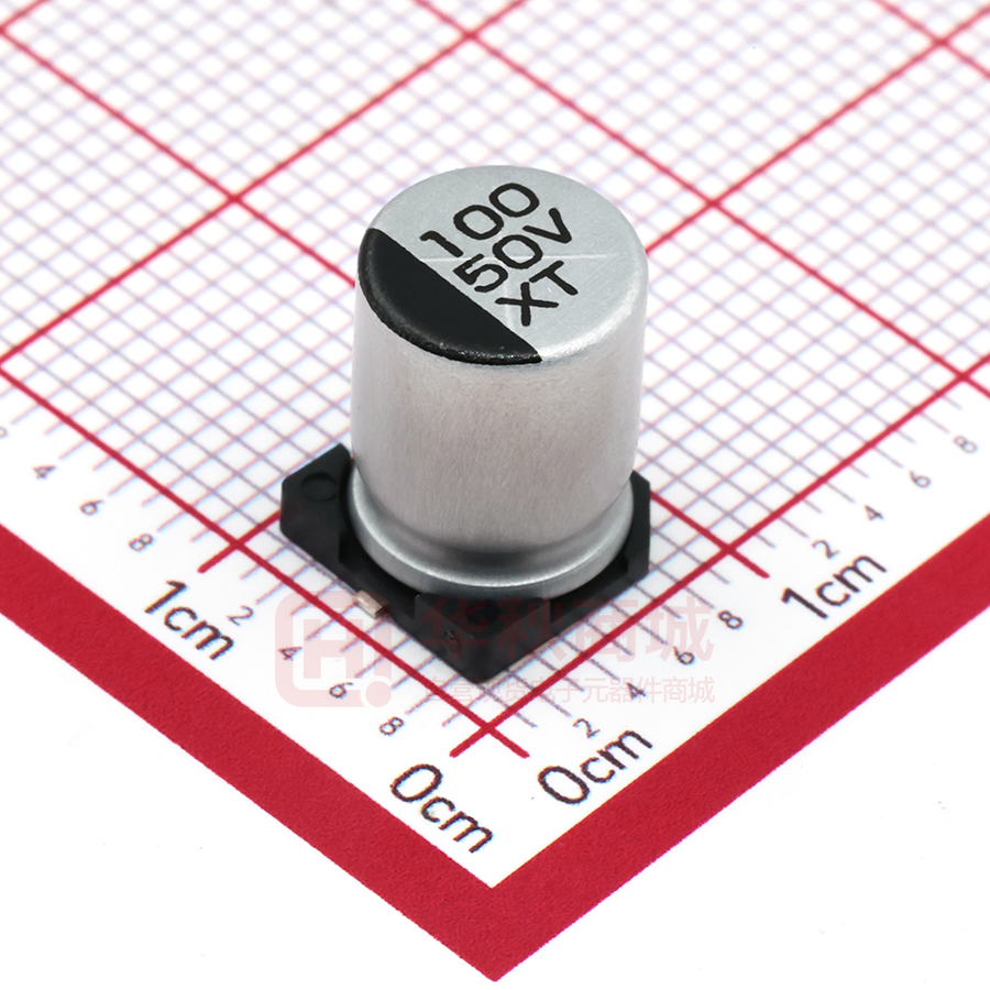

    SMD,D8xL10.5mm
    贴片铝电解电容 SMD,D8xL10.5mm 100μF ±20% 50V
XT100UF50V90RV0067 数据手册
规格承认书 Specification for approval 客户名称: (Customer Name) 贴片铝电解电容器 产品名称: SMD Aluminum Electrolytic Capacitor (Product Name) 客户料号: (Customer part number) 科尼盛料号: XT100UF50V90RV0067 (KNSCHA number) XT 100UF50V 8*10.5mm 型号规格: (Specifications) 拟 制 XT 100UF50V 8*10.5mm 制 造 (Manufacture) 客 户 (Customer) Approval Approval 核 准 (Fiction) 审 核 (Chief) (Approval) 刘淑芬 刘军军 徐贵南 检 验 (Inspect) 东莞市科尼盛电子有限公司 DONG GUAN KNSCHA ELECTRONICS CO.,LTD. No. The 8th Floor, A3 Building, R&D Center (Phase I), Songshan Lake Intelligent Valley, Liaobu Town, Dongguan City. TEL:0769-83698067 81035570 FAX: 0769-83861559 Email:sales@knscha.com Website: http://www.knscha.com 审 核 (Chief) 核 准 (Approval) Product Dimensions Unit: mm 8 Ф L 10.5±0.4 A 8.3 B 8.3 9.2 C Items W 0.7~1.2 P 3.1±0.2 Performance Category Temperature Range -55℃~105℃ Rated Voltage VR Capacitance CR Capacitance Tolerance Surge Voltage VS 50 V 100 µF (120Hz,20℃) ± 20 % (120Hz,20℃) 63 VDC ILEAK ≤ 63 µA ≤ 0.14 Leakage Current (20℃) Tan δ After 2 minutes (120Hz,20℃) Impedance max. ≤ / Ω (100KHz,20℃) Ripple Current (IAC, R / rms) 160mA (120Hz,105℃) Low Temperature Impedance ratio Characteristics at 120 Hz Z(-25℃) / Z(+20℃) 2 3 Z(-55℃) / Z(+20℃) Ripple Current (A) and Frequency (Hz) 50,60 120 1K 10k up Frequency Multipliers Multiplier 0.85 1.00 1.10 1.20 Endurance and Shelf Life Test Items Endurance Shelf Life Test Test Time 2,000 Hrs at 105℃; VR 1,000 Hrs at 105℃ Cap. Change Within ±25 % of initial value Within ±25 % of initial value Tan δ Less than 300% of specified value Less than 300% of specified value Leakage Current Within specified value Within specified value Standards JIS C 5101-1, -18, IEC 60384-4 Remarks RoHS Compliance, Halogen-free Marking: Each capacitor shall be marked with the following information. Marking color: Black D≥ 12.5mm D≤10mm Negative polarity 220 35V XT Rated cap Negative Rated polarity voltage Series code 560 35V XT Rated cap Rated voltage Series code Please refer to “Precautions and Guidelines for Aluminum Electrolytic Capacitors” section in catalog for further details. XT SERIES V-chip Aluminum Electrolytic Capacitors 1 Diagram of Dimensions (※)For 4~6.3Ф is 0.4 max. Unit:mm D ±0.5 4 4 4 8 P ±0.2 Fig.No. 1 4.3 4.3 5.1 0.5to0.8 1.0 1 ±0.4 4.3 4.3 5.1 0.5to0.8 1.0 1 ±0.4 5.3 5.3 6.1 0.5to0.8 1.3 1 ±0.4 5.3 5.3 6.1 0.5to0.8 1.3 1 ±0.4 5.3 5.3 6.1 0.5to0.8 1.3 1 ±0.4 6.6 6.6 7.2 0.5to0.8 2.2 1 ±0.4 6.6 6.6 7.2 0.5to0.8 2.2 1 ±0.4 6.6 6.6 7.2 0.5to0.8 2.2 1 ±0.4 6.6 6.6 7.2 0.5to0.8 2.2 1 ±0.5 8.3 8.3 9.2 0.7to1.2 3.1 1 ±0.5 5.8 7.0 7.0 5.4 5.8 7.7 6.5 8 w 1.0 7.9 8 ±0.2 0.5to0.8 8 8 C 5.1 6.3 8 ±0.2 4.3 5.8 6.3 B 4.3 5.4 6.3 ±0.2 ±0.4 5.4 5 6.3 A ±0.4 5 5 7.9 8.3 8.3 9.2 0.7to1.2 3.1 1 10.5 ±0.5 8.3 8.3 9.2 0.7to1.2 3.1 1 11.5 ±0.5 8.3 8.3 9.2 0.7to1.2 3.1 1 12.5 ±0.5 8.3 8.3 9.2 0.7to1.2 3.1 1 13.5 ±0.5 8.3 8.3 9.2 0.7to1.2 3.1 1 ±0.5 10 7.7 10.3 10.3 11.2 0.7to1.2 4.4 1 10 10.5 ±0.5 10.3 10.3 11.2 0.7to1.2 4.4 1 11.5 ±0.5 10.3 10.3 11.2 0.7to1.2 4.4 1 12.5 ±0.5 10.3 10.3 11.2 0.7to1.2 4.4 1 13.5 ±0.5 10.3 10.3 11.2 0.7to1.2 4.4 1 13.5 ±0.5 13.0 13.0 14.0 1.0to1.4 4.4 2 12.5 16.0 ±0.5 13.0 13.0 14.0 1.0to1.4 4.4 2 16 16.5 ±0.5 17.0 17.0 18.0 1.0to1.4 6.4 2 21.5 ±0.5 17.0 17.0 18.0 1.0to1.4 6.4 2 16.5 ±0.5 19.0 19.0 20.0 1.0to1.4 6.4 2 21.5 ±0.5 19.0 19.0 20.0 1.0to1.4 6.4 2 10 10 10 12.5 16 18 18 XT SERIES L V-chip Aluminum Electrolytic Capacitors 2 Part Numbering System Product Code Guide – SMD Type 1. Carrier Tape Fig. 1-1 Carrier tape φD≤10 Fig. 1-2 Carrier tape φD≥12.5 Unit:mm ±0.3 ±0.2 E ±0.1 5.0 8.0 1.75 5.5 6.0 - 1-1 ɸ4×5.8 12.0 5.0 5.0 8.0 1.75 5.5 6.5 - 1-1 ɸ4×7.0 12.0 5.0 5.0 8.0 1.75 5.5 7.5 - 1-1 ɸ5×5.4 12.0 6.0 6.0 12.0 1.75 5.5 6.0 - 1-1 ɸ5×5.8 12.0 6.0 6.0 12.0 1.75 5.5 6.5 - 1-1 ɸ5×7.0 12.0 6.0 6.0 12.0 1.75 5.5 7.5 - 1-1 ɸ6.3×5.4 16.0 8.7 8.7 12.0 1.75 7.5 6.0 - 1-1 ɸ6.3×5.8 16.0 8.7 8.7 12.0 1.75 7.5 6.5 - 1-1 ɸ6.3×7.7 16.0 8.7 8.7 12.0 1.75 7.5 8.2 - 1-1 ɸ6.3×7.9 16.0 8.7 8.7 12.0 1.75 7.5 8.5 - 1-1 ɸ8×6.5 16.0 8.7 8.7 12.0 1.75 7.5 7.2 - 1-1 ɸ8×10.5 24.0 8.7 8.7 16.0 1.75 11.5 11.5 - 1-1 ɸ8×11.5 24.0 8.7 8.7 16.0 1.75 11.5 12.0 - 1-1 ɸ8×12.5 24.0 8.7 8.7 16.0 1.75 11.5 13.5 - 1-1 ɸ8×13.5 24.0 8.7 8.7 16.0 1.75 11.5 14.5 - 1-1 ɸ10×7.7 24.0 10.7 10.7 16.0 1.75 11.5 8.5 - 1-1 ɸ10×10.5 24.0 10.7 10.7 16.0 1.75 11.5 11.5 - 1-1 ɸ10×11.5 24.0 10.7 10.7 16.0 1.75 11.5 12.5 - 1-1 ɸ10×12.5 24.0 10.7 10.7 16.0 1.75 11.5 13.5 - 1-1 ɸ10×13.5 24.0 10.7 10.7 16.0 1.75 11.5 14.5 - 1-1 ɸ12.5×13.5 32.0 13.9 13.9 24.0 1.75 14.2 14.5 28.5 1-2 ɸ12.5×16.0 32.0 13.9 13.9 24.0 1.75 14.2 16.5 28.5 1-2 ɸ16×16.5 44.0 17.5 17.5 28.0 1.75 20.2 17.5 40.5 1-2 ɸ16×21.5 44.0 17.5 17.5 28.0 1.75 20.2 22.5 40.5 1-2 ɸ18×16.5 44.0 19.5 19.5 32.0 1.75 20.2 17.5 40.5 1-2 ɸ18×21.5 44.0 19.5 19.5 32.0 1.75 20.2 22.5 40.5 1-2 Capacitors T ±0.1 5.0 Electrolytic F ±0.2 12.0 Aluminum P ±0.1 ɸ4×5.4 V-chip W ±0.1 Y XT SERIES H ±0.2 Size(ɸD×L) S Fig.No. 3 2. Reel Package Fig. 2-1 Fig. 2-2 Pull out direction Case size Φ4~5 Φ6.3 Φ8×6.5 Φ8 Φ10 Φ12.5 Φ16~18 A 14 18 18 26 26 34 46 D 380 380 380 380 380 380 380 T 3.0 3.0 3.0 3.0 3.0 3.0 3.0 3. Packing specification Fig. 3-1 Carrier Tape Unit:pcs Case size Q’ty / Reel Reels/Box Q’ty/Box Φ4 2,000 12 24,000 Φ5 1,000 12 12,000 Φ6.3 1,000 10 10,000 Φ8×6.5 1,000 10 10,000 Φ8×10.5 500 10 5,000 Φ8×11.5~13.5 400 10 4,000 Φ10×7.7~10.5 500 10 5,000 Φ10×11.5~13.5 400 10 4,000 Φ12.5×13.5 250 6 1,500 Φ12.5×16 200 6 1,200 Φ16×16.5 125 5 625 Φ16×21.5 100 5 500 Φ18×16.5 125 5 625 Φ18×21.5 100 5 500 Case size Φ4~5 Φ6.3 Φ8×6.5 Φ8 Φ10 Φ12.5 Φ16~18 H 260 260 260 340 340 240 260 W 395 395 395 395 395 395 395 L 390 390 390 390 390 390 390 XT SERIES V-chip Aluminum Electrolytic Capacitors 4 4. Sealing Tape Reel Strength 4.1 Peel angle: 165 to 180℃refered to the surface on which the tape is glued. 4.2 Peel speed: 300mm per minutes 4.3 The peel strength must be 0.1 ~ 0.7N under these conditions. Cover tape Peel speed: 300mm/min Direction of unreeling Carrier tape 5. Packing Method 5.1 The leader length of the tape shall not be less than 150 mm including 10 or more embossed sections inwhich no parts are contained. 5.2 the core has an empty section with a length less than 60mm, and the perforation carrier is only suitable for φ D ≤ 5mm. Empty section Embossed carrier Empty section(leader section) Chipcomponent mounting section Top cover tape 70 mm or more - - + + 70 mm min Pull out direction 150 mm min Top cover tape XT SERIES V-chip Start of the tape Aluminum Electrolytic Capacitors 5 Endurance characteristic: No. Item Conditions Specification Capacitor is placed in an oven whose temperature follow specific regulation to change. The specific Rotational 1 Temperature Test regulation is " +25℃ (3 min.) → -55℃ (30 min.) → +25℃ (3 min.) → +105℃ (30 min.) → +25℃ (3 min.)", and it is called a cycle. The test totals 10 cycles, and then the capacitor shall be subjected to Capacitance change Within ± 10% of initial value Tanδ Within specified value Leakage Current Within specified value Physical No broken and undamaged standard atmospheric conditions for 4 hours, after which measurements shall be made. High 2 Temperature Endurance Life Test High 3 Temperature 1.Capacitors shall be placed in oven with application of rated voltage2,000 +72 / -0 hours at 105℃. 2.hen the capacitor shall be subjected to standard atmospheric conditions for 4 hours, after which measurements shall be made. After 1,000 +48 / -0 hours test at 105℃ without rated voltage. And then the capacitor shall Unload Life be subjected to standard atmospheric conditions for Test 4 hours, after which measurements shall be made. Capacitors shall be exposed for 1,000 +48 / -0 4 Humidity Test hours in an atmosphere of 90 ~ 95% R. H. at 60 ± 3℃.And then the capacitor shall be subjected to standard atmospheric conditions for 4 hours, afterwhich measurements shall be made. Low 5 Temperature Test 6 Vibration Test Capacitors are placed at -55 ± 3℃ for 96 ± 4 hours. And then the capacitor shall be subjected to standard atmospheric conditions for 4 hours, after which measurements shall be made. Capacitance change Within ±25% of initial value Less than300% of specified Tanδ value Leakage Current Within specified value Physical No broken and undamaged Capacitance change Within ± 25% of initial value Less than300% of specified Tanδ value Leakage Current Within specified value Physical No broken and undamaged Capacitance change Within ± 10% of initial value Less than 150% of specified Tanδ value Leakage Current Within specified value Physical No broken and undamaged Capacitance change Within ± 10% of initial value Tanδ Within specified value Leakage Current Within specified value Physical No broken and undamaged 1. Fix it at the point 4 mm or less from body. For ones Capacitance change Within ± 10% of initial value of 12.5 mm or more in diameter or 25 mm or more Tanδ Within specified value Leakage Current Within specified value Physical No broken and undamaged length, use separate fixture. 2. Direction and during of vibration:3 orthogonal directions mutually each for 2 hours (total of 6 hours). 3. Frequency:10 to 55 Hz reciprocation for 1 minute. 4. Total amplitude : 1.5 mm he capacitor shall be subjected to 1,000 cycles at 15 ~ 35℃. Protective series resistor a 1KΩ eachconsisting of a charge period of 30 ± 5 seconds, followed by discharge period of Surge 7 Voltage Test XT SERIES approximately 5.5 minutes. Capacitance change Within ± 20% of initial value Less than 200% of specified Tanδ value Leakage Current Within specified value Physical No broken and undamaged Applying voltage: Rated Voltage(V) 4 6.3 10 16 25 35 50 63 80 100 Surge Voltage(V) 4.6 7.3 11.5 18.4 28.8 40.3 57.5 72.5 92 115 Rated Voltage(V) 160 200 250 315 350 400 420 450 500 525 Surge Voltage(V) 176 220 275 347 385 440 462 495 550 578 V-chip Aluminum Electrolytic Capacitors 6 No. Item Conditions Specification After the lead wire fully immersed in the solder for 8 Capacitance change Within ± 10% of initial value 3 ± 0.5 secs at a temperature of 245 ± 5℃, Solderability the solder the solder coating must be more than Tanδ Within specified value Dipping speed: 25±2.5mm/s Leakage Current Within specified value Dipping time: 3±0.5s Physical No broken and undamaged 95%. . Test 1. IR Reflow Solder Heat-Resistance Capacitance change Within ± 10% of initial value t3 Temperature(° C) Test Tanδ Within specified value Leakage Current Within specified value Physical No broken and undamaged t2 t1 Time(sec) Rated voltage (V) 4-50 63 up 4-100 160 up Case size (φ) 4-6.3 4-6.3 8-18 8-18 Preheat 9 Duration Peak Temp.(T1~T2,℃) 150-180 Time (t1)(Max,secs) Temp.(T3,℃) Time (t2)(Max,secs) 100 217 230 90 Temp.(T4,℃) 217 217 60 60 40 260 250 Time (t3,secs) 230 40 250 217 40 245 5 Reflow cycles 2 or less 2.Solder iron method: Bit temperature: 350 ± 5℃ Application time of soldering Iron: 3 +1/-0 sec ※Please contact our representative if your condition is higher. ※Please ensure that the capacitor became cold enough tothe room temperature (5℃ ~ 35℃) before the second reflow. ※Consult with us when performing reflow profile in IPC /JEDEC (J-STD-020) 1. pplicable to the capacitors with case size is 8×10 mm and larger. 2. Test condition: (1) AC test: The capacitor shall be connected across an applying 50 or 60 Hz AC which is 0.7 times ofrated voltage or 250Vrms AC whichever is the lower. (2) DC test: Applying inverse DC rated voltage with current to the capacitor. 10 Where case diameter: φD ≦ 12.5 mm: 2 A DC max. Venting Test φD>12.5 mm: 10 A DC max. Note: (1) When the pressure relief vent operated, the capacitor shall avoid any danger of fire or explosion ofcapacitor element (terminal and metal foil etc.) or cover. (2) When the pressure relief device does not open with the voltage applied over 30 minutes, the test isconsidered to be passed. XT SERIES V-chip Aluminum Electrolytic Capacitors 7 No. Item Conditions Recommended pad pattern and size Unit:mm Case size 11 Land Pattern X Y G :pad 12 Standards Land size G Y X Φ4 1.0 2.6 1.8 Φ5 1.4 3.0 1.8 Φ6.3 1.9 3.5 1.8 Φ8 3.0 4.0 2.5 Φ10 4.0 4.0 2.5 Φ12.5 4.0 5.8 3.0 Φ16 6.0 6.8 3.5 Φ18 6.0 8.0 3.5 Satisfies Characteristic JIS C 5101-1, -18 Conforming to RoHS and European REACH Regulation The capacitors do not intentionally contain the banned substances (Cd, Pb, Hg, Cr(Ⅵ), PBB, PBDE, DEHP, BBP, DBP, DIBP) listed in “RoHS directrive : (EU) 2015/863” and its concentration is less than the threshold values. Our products are "articles without any intended releas" besed published on 26 May2008. They are not applicable for "Registration" for European REACH Regulation Article 7 (1). Precautions and Guidelines for Aluminum Electrolytic Capacitors 1.Guidelines for Circuit Design (General / Application guidelines for using electrolytic capacitors) Selecting of a right capacitor is a key to a good circuit design. (1)Polarity Most of the aluminum electrolytic capacitors are polarized. Therefore, they must be installed with the correct polarity. Usage in the reverse polarity results into a short-circuit condition that may damage or even explode the capacitor. In addition, it may influence circuit functionality. A bi-polar electrolytic capacitor should be installed when polarity across a capacitor is unstable / reversible. It should be, however, noted that usage of both polar and bi-polar capacitors are limited to DC applications. They must NOT be used for AC application. (2)Operating Voltage Applied DC voltage must not exceed rated voltage of the capacitor. Applying higher voltage than its rated voltage across a capacitor terminals cause overheating due to higher leakage currents and capacitor dielectric/insulation deterioration that will ultimately affect a capacitor’s performance. The device, however, is capable of working under short-time transient voltages such as DC transients and peak AC ripples. Reverse voltages higher than 1 Volt with a specified temperature limit or AC voltages are not permissible. Overall, using capacitors at recommended operating voltages can prolong its lifespan. Note that the result of DC voltage overlapped with peak ripple voltage should not exceed rated voltage. XT SERIES V-chip Aluminum Electrolytic Capacitors 8 (3)Ripple Current One of the key functions of any capacitor is removal of the ripple current i.e. the RMS value of AC flowing through a capacitor. But, a ripple current higher than rated ripple current will drop resultant capacitance, cause undue internal heating and thus reduces life span of the capacitor, In extreme cases, internal high temperature will cause the pressure relief vent to operate while destroying the device. Overall, it is important to note that an electrolytic capacitor must be used within a permissible range of ripple current. Indicators like temperature coefficient of allowable ripple current are generally sued to determine life expectancy of the capacitor, but to avoid related complex calculations and for the sake of simplicity, we haven’t provided temperature coefficient in the catalogue. But it offers key indicators like maximum operating temperature for calculation of life expectancy at a given temperature. (4)Operating Temperature Capacitors should be used within a permissible range of operating temperatures. Using capacitor at a higher temperature than maximum rated temperature will considerably shorten its life. In the worst-case scenario, high temperature can cause pressure relief vent to operate and the device will get destroyed. Using capacitors at an ambient room temperature assure their longer life. (5)Leakage Current Leakage current flows through a capacitor when DC voltage is applied across it. Leakage current varies with changes in ambient temperature and applied DC voltage level and its time of application. Overvoltage situation, presence of moisture, and thermal stresses, especially occurring during the soldering process can enhance leakage current. Initial leakage current is usually higher and does not decrease until voltage is applied for a certain period of time. It is recommended to keep initial leakage current within specified levels. (6)Charge and Discharge Regular electrolytic capacitors are not suitable for rapid charging/discharging circuits. Such usage may either cause reduction in overall capacitance or damage due to overheating. provides special assistance for selecting appropriate capacitors for rapid charging/discharging circuits. (7)Surge Voltage The Surge voltage rating is referred as the maximum DC overvoltage that may be applied to an electrolytic capacitor for a short time interval of 30 seconds at infrequent at infrequent time intervals not exceeding 5.5minutes with a limiting resistance of 1k Ω. Unless otherwise described on the catalogue or product specifications, please do not apply a voltage exceeding the capacitor’s voltage rating. The rated surge voltages corresponding to rated voltages of electrolytic capacitors are presented as follows: Rated Voltage(V) 4 6.3 10 16 25 35 50 63 80 100 Surge Voltage(V) 4.6 7.3 11.5 18.4 28.8 40.3 57.5 72.5 92 115 Rated Voltage(V) 160 200 250 315 350 400 420 450 500 525 Surge Voltage(V) 176 220 275 347 385 440 462 495 550 578 (8)Surge Voltage The capacitor shall NOT be exposed to: (a)Fluids including water, saltwater spray, oil, fumes, highly humid or condensed climates, etc. (b)Ambient conditions containing hazardous gases/fumes like hydrogen sulfide, sulfurous acid, nitrous acid, chlorine or bromine gas, ammonia, tec. (c)Exposed to ozone, ultraviolet rays and radiation. (d)Severe vibrations or physical shocks that exceeds the specifications mentioned in this catalogue. (9)Circuit Design Consideration (a)Please ensure whether application, operating and mounting conditions satisfy the conditions specified in the catalog before installation of a capacitor. Please consult KNSCHA, if any of the conditions are beyond the conditions specified in the catalog . (b)Heat-generating components heat sinks should not be placed to their Aluminum electrolytic avoid their premature failure. A or cooling system is recommended tocloser improve reliable working. capacitors on the PCB to (c)Electrical characteristics and performance of aluminum electrolytic capacitors are affected by variation of applied voltage, ripple current, ripple frequency and operating temperature. Therefore, these parameters shall not exceed specified values in the catalog. (d)Aluminum capacitors may be connected in the parallel fashion for increasing total capacitance and/or for achieving higher ripple current capability. But, such design may cause unequal current flow through each of the capacitors due to differences in their impedances. XT SERIES V-chip Aluminum Electrolytic Capacitors 9 (e)When two or more capacitors are connected in series, voltage across each capacitor may differ and fall below the applied voltage. A resistor should be placed across each capacitor so as to match applied voltage with voltage across a capacitor. (f)Please consult KNSCHA while selecting a capacitor for high- frequency switching circuit or a circuit that undergoes rapid charging/ discharging. (g)Standard outer sleeve of the capacitor is not a perfect electrical insulator therefore is unsuitable for the applications that requires perfect electrical insulation. Please consult KNSCHA, if your application requires perfect electrical insulation. (h)Tilting or twisting capacitor body is not recommended once it is soldered to the PCB. 2.Caution for Assembling Capacitors (1)Mounting (a)Aluminum electrolytic capacitors are not recommended to reuse in other circuits once they are mounted and powered in a circuit. (b)Aluminum electrolytic capacitors may hold static charge between its anode and cathode, which is recommended to be discharged through a 1kΩ resistor before re-use. (c)A long storage of capacitors may result into its insulation deterioration. This can lead to a high leakage current when voltage is applied that may damage the capacitor. Capacitors following a long storage period must undergo voltage treatment/re-forming. Capacitors are charged by applying rated DC voltage through a resistor of 1kΩ in series at least for an hour. It is recommended to increase applied voltage gradually using a voltage regulator unit once capacitors are assembled on the board. The charging should be followed by discharging through a 1KΩ resistor. (d)Please check capacitor rated voltage before mounting. (e)Please check capacitor polarity before mounting. (f)Please don’t drop capacitor on the floor / hard object. (g)Please don’t deform the capacitor during installation. (h)Please confirm whether the lead spacing of the capacitors match with its pad spacing / footprint on PCB prior to installation. (i)Please avoid excessive mechanical shocks to capacitor during the auto-insertion process, inspection or centering operations. Please don’t place any wiring or circuit over the capacitor’s pressure relief vent. The pressure relief vent may fail to open if adequate clearance space is not provided. Following table shows minimum clearance space required for different case diameters. Case Diameter φ6.3 ~ φ16 φ18 ~ φ35 φ40 or above Clearance(mm) 2 mm 3 mm 5 mm (2)Soldering (a)Please confirm that soldering conditions, especially temperature and contact time are within our specifications. Dip or flow soldering temperature should be limited at 260 ± 5 ℃ for 10 ± 1 sec while manual soldering using soldering iron should be limited at 350 ± 5℃ for 3 +1/-0 seconds. Please do not dip capacitor body into molten solder. A capacitor’s life will be negatively affected if these conditions are violated. (b)Storage of capacitors in high humidity conditions is likely to affect the solder-ability of lead wires and terminals. (c)Reflow soldering should NOLY be used for SMD type capacitors. The temperature and duration shall not exceed the specified temperature and duration in the specification. If the temperature or duration is higher than the value specified, please consult KNSCHAbefore usage. (d)Standard aluminum electrolytic capacitors are not designed to withstand multiple reflow processes. Please consult KNSCHA if repeated reflowing is unavoidable. (e)Incorrect mounting on PCB with improper external strength applied on its lead wires or capacitor body after soldering may damage a capacitor’s internal structure, cause short circuit, or lead to high leakage current issues. Do not bend or twist the capacitor body after soldering. Referring to the drawings below only case (i) is recommended. (i)Correct soldering (ii)Hole-to-hole spacing on PCB differs from the lead space of lead wires. (iii)Lead wires are bent after soldering. (iv)Capacitor body doesn’t stand vertical on PCB after soldering. (3)Cleaning Circuit Boards after Soldering (a)Following chemicals are not recommended for cleaning: Solvent containing halogen ions, Alkaline solvent, Xylene, Acetone, Terpene, petro-based solvent. (b)Recommended cleaning conditions: XT SERIES V-chip Aluminum Electrolytic Capacitors 10 Fatty-alcohol - Pine Alpha ST-100S, Clean Through-750H and IPA (isopropyl alcohol) are examples of the most acceptable cleaning agents. Temperature of the cleaning agent must not exceed 60℃. Flux content in the cleaning agents should be limited to 2 Wt. %. Overall length of cleaning process (e.g., immersion, ultrasonic or other) shall be within 5 minutes (5 ~ 7mm height within 3 minutes). CFC substitute cleaning agents such as AK225AES can also be used for cleaning. In this case, its temperature shall not exceed 40 C and cleaning process (e.g., immersion, ultrasonic or other) shall be completed within 2 ~ 3 minutes. After cleaning capacitors should be dried with hot air for at least 10 minutes along with the PCB. Temperature of hot air shall not exceed maximum category temperature of the capacitor. Insufficient drying may cause appearance defects, sleeve shrinkage, and bottom-plate bulging. However, usage of this CFC substitute must completely regulated for protection of environment. 3.Maintenance Inspection Periodical inspection of aluminum capacitors is absolutely necessary especially when they are used with industrial equipment. The following items should be checked: (1)Appearance: Bloated, vent operated, leaked, etc. (2)Electrical characteristic: Capacitance, Tanδ, leakage current, and other specified items listed in specification. KNSCHArecommend replacing the capacitors if any of the abovementioned items fail to meet specifications. 4.Storage (1)The most suitable conditions for aluminum capacitor storage are 5 ℃ ~ 35℃ and indoor relative humidity less than 75%. High temperature and/or humidity storage is detrimental to the capacitors. (2)Capacitors shall not be stored in wet or damp atmospheres containing water, brine, fumes or oil. (3)Capacitors storage area shall neither be exposed to hazardous gases such as hydrogen sulfide, sulfurous acid, nitrous acid, chlorine, ammonium, etc. nor to acidic or alkaline solutions. (4)Capacitors shall not be exposed to ozone, ultraviolet rays or radiation. 5.Estimation of life time T0max - Tr max Lr =L0×2 10 Lr : Estimated lifetime (hours) L0: Base lifetime specified at maximum operating temperature with applied the DC voltage and the ripple current (hours) T0 max: The core temperature that rated ripple current applied at maximum operating temperature. Tr max: The core temperature that applied actual ripple current at ambient temperature. 6.Maintenance Inspection Please consult with a local industrial waste disposal specialist when disposing of aluminum electrolytic capacitors. 7.Environmental Consideration KNSCHAalready have received ISO 14000 certificate. Cadmium (Cd), Lead (Pb), Mercury (Hg), Hexavalent Chromium (Cr+6), PBB,PBDE, DEHP, BBP, DBP and DIBP have never been using in capacitor. If you need “Halogen-free” products, please consult with us. For further details, please refer to the following industrial standards: IEC 60384-4- Fixed capacitors for use in electronic equipment – Part 4: Sectional specification – Aluminum electrolytic capacitors with solid (MnO2) and non-solid electrolyte (Established in January 1995, Revised in March 2007) EIAJ RCR-2367B- Guideline of notabilia for fixed aluminum electrolytic capacitors for use in electronic equipment [Technical Standardization Committee on Passive Components (Established in March 1995, Revised in March 2002)]. XT SERIES V-chip Aluminum Electrolytic Capacitors 11
