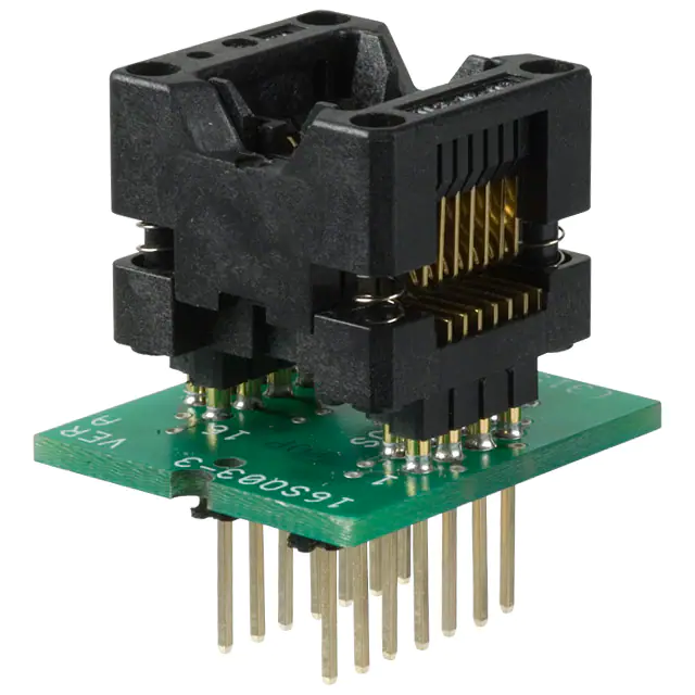

    ADAPTER 14-SOIC TO 14-DIP
PA14SO1-03-3 数据手册
PAxxSO1-03-x Data Sheet 8, 14 or 16 pin SO socket/ 8, 14 or 16 pin DIP 0.3" or 0.6” plug Supported Device/Footprints Adapter Parts & Part Numbers Using these adapters, 8, 14 and 16 pin SO packages with a body width of 3.9mm - 4.0mm (0.150”) and a lead pitch of 0.050” (1.27mm) can be programmed on DIP programmers. The following chart shows the various socket and board part numbers that make up these adapters. Device Dimensions This socket can accept devices of the following dimensions: Adapter PA8SO1-03-3 PA14SO1-03-3 PA16SO1-03-3 PA8SO1-03-6 PA14SO1-03-6 PA16SO1-03-6 Socket Board DIP Plug 8(16)SD-03 8SO03-3 0.3" 14(16)SD-03 16SO03-3-14 0.3" 16SD-03 16SO03-3 0.3" 8(16)SD-03 PA8SO-03-6 0.6" 14(16)SD-03 16SO03-6-14 0.6" 16SD-03 16SO03-6 0.6" Style SM TH TH SM SM SM Adapter Construction Body mm (inches) min. typ. max. n/a 3.9 4.0 (0.153) (0.157) Knee mm (inches) min. typ. max. n/a 5.0 5.2 (0.197) (0.205) Tip mm (inches) min. typ. 5.8 6.0 (0.228) (0.236) Body Length n/a max. 6.35 (0.250) Lead Pitch 1.27 (0.050) Adapter Dimensions The adapter is made up of 2 sub-assemblies. They assemble via connectors making the adapter modular. This way the subassemblies can be replaced easily. When disassembling the adapter take care not to bend the pins. When reassembling the adapter note the pin 1 indicators to align the parts correctly. Test Socket LSC # Style 16SD-03 Open Top ZIF xx(16)SD-03 Open Top ZIF Mfgr/Pn Enplas OTS-16-1.27-03 Enplas OTS-xx(16)-1.27-03 The 14 pin socket is depopulated from 16 pins to fit the devices. The part numbers are listed in the previous chart. The sockets are removable so that they may be replaced. They are depopulated at the Pin 1 end. If you remove the socket be sure to replace it with the correct orientation and alignment. Wiring Wiring is 1 to 1. Pin 1 of the SO device is wired to pin 1 of the DIP plug. Pin 2 to pin 2 and so on around the adapter. PA14SO1-03-3 (TH Style) PA8SO1-03-6 (SM Style) Logical Systems Corporation PO Box 6184, Syracuse, NY 13217-6184 USA Tel (315) 478-0722, FAX (315) 479-6753 S Y S T E M S www.logicalsys.com, Email: info@logicalsys.com PAxxSO1-03-x Data Sheet Doc: 16SO03.DOC Rev 06/20/02 Page 1 of 1
