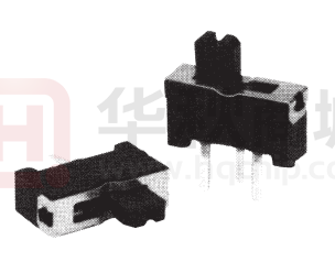

MFS101D-9-Z
MFS101D-9-Z
    NIDEC(尼得科)
    插件,10x3mm
    滑动开关 插件,10x3mm 单刀双掷 5千次 直插
MFS101D-9-Z 数据手册
MFS Sub-miniature Switches RoHS Compliant ■Common Specifications ●Initial contact resistance Measured at 1.5mA 200 µVAC 1kHz ●Dilectric strength Measurement at 500 VAC. ●Insulation Resistance Measured at 500VDC ●Operating temperature range −10℃〜+70℃ ■Part Numbering MFS  101  D  ● −   6   −   Z Switching function ● ● ● Registration number Number of poles Series code 101 1-pole D 201 2-poles EA 401 4-poles 1−pole or 3−poles N 2 poles or 4−poles PA MFS101D−6−Z ON - ON ON-ON-ON ON - ON ON-ON-ON ■Specifications Non-shorting Max. Min. Rating 2 2.5 3 1.2 10 2-φ1.2 2 2 8 ■PC Hole Layouts 1.2 Initial contact resistance 20mΩ Max. Dielectric strength AC500V 1 minute Insulation resistance 100MΩ Min. Electrical life 5,000 cycles Operating force 0.98〜2.94N Switch timing Non-shorting 2.5 (Stroke) 3 3.3 Max. (Top view) DC10V 0.3A(Resistive load) DC5V 10mA(Resistive load) Switching function (Viewed from A) Circuit diagram 5 5 2.5 (1) ON ON 2−3 2−1 2.5 0.3 0.5 Terminal numbers are not shown on the switch. No. of terminals φ0.7 (1) (2) 8 (3) 3 (2) (3) MFS MFS101D−8−Z ■ Specifications shorting Max. Rating Min. ■PC Hole Layouts (Top view) Initial contact resistance 20mΩ Max. Dielectric strength AC500V 1 minute Insulation resistance 100MΩ Min. Electrical life 5,000 cycles at DC30V 0.3A 100cycles at AC30V 2A Operating force 2.45±0.98 N Switch timing Shorting Switching function (Viewed from A) Terminal numbers are not shown on the switch. 10 8 2.5(Stroke) C0.5 2−1 2−3 3 Max. Min. DC12V 0.3A(Resistive load) DC5V 10mA(Resistive load) Initial contact resistance 20mΩ Max. Dielectric strength AC500V 1 minute Insulation resistance 100MΩ Min. Electrical life 5,000 cycles Operating force 0.98±2.94N Switch timing Non-shorting 8.1 5 1.9 φ1.2 φ0.7 0.3 2.7 3.1 0.5 (Top view) 3.3 0.8 3 ■PC Hole Layouts ON Rating 3 1.2 ON No. of Circuit diagram terminals ■ Specifications Non-shorting 0.4 MFS101D−9−Z DC30V 0.3A AC30V 2A (Resistive load) DC5V 10mA(Resistive load) 0.8 1.5 2 2 Switching function (Viewed from A) ON ON 2−1 2−3 No. of Circuit diagram terminals 3 Terminal numbers are not shown on the switch. ☆ MFS101D−10−Z ■ Specifications Non-shorting 20mΩ Max. 3.5 Dielectric strength AC500V 1 minute 2 Insulation resistance 100MΩ Min. Electrical life 5,000 cycles Operating force 2.94±1.96N Switch timing Non-shorting 2 (Stroke) 2 ■PC Hole Layouts 1 2.5 0.3 0.5 2 2 3.4 Terminal numbers are not shown on the switch. →Page 531. ☆:Semi-standard products. Switching function (Viewed from A) Circuit diagram No. of terminals 0.5 2 2.5 4 (Top view) shorting DC30V 0.3A(Resistive load) DC5V 10mA(Resistive load) Initial contact resistance 2 1 Max. Min. Rating 8.8 ON ON 2−3 2−1 3 MFS MFS101D−14−Z ■ Specifications Non-shorting Max. Min. Rating ■Panel Cut−Out Dimensions (Top view) DC30V 0.3A(Resistive load) DC5V 10mA(Resistive load) Initial contact resistance 20mΩ Max. Dielectric strength AC500V 1 minute Insulation resistance 100MΩ Min. Electrical life 5,000 cycles Operating force 1.96±0.98N Switch timing Non-shorting Switching function (Viewed from A) ON ON 2−1 2−3 No. of Circuit diagram terminals 3 Terminal numbers are not shown on the switch. ☆:Semi-standard products. MFS ☆MFS101EA−Z ※[Note] See below. ■ Specifications Max. Rating Min. Initial contact resistance 20mΩ Max. Dielectric strength AC500V 1 minute Insulation resistance 100MΩ Min. Electrical life 5,000 cycles at DC30V 0.3A 100cycles at AC30V 2A Operating force 2.45±0.98N 1.47±0.98N Switch timing ■PC Hole Layouts (Top view) Undefined Switching function Circuit diagram (Viewed from A) ON ON ON 3−1 3−2 3−4 Terminal numbers are not shown on the switch. MFS201N−Z DC30V 0.3A AC30V 2A (Resistive load) DC5V 10mA(Resistive load) No. of terminals 4 : Operating force from the center to the outer side (right or left). : Operating force from the outer side (right or left) to the center. ■ Specifications Non-shorting Max. Min. Rating ■Panel Cut−Out Dimensions AC125V 1A ・ DC30V 1A DC5V 10mA(Resistive load) Initial contact resistance 30mΩ Max. Dielectric strength AC500V 1 minute Insulation resistance 300MΩ Min. Electrical life 5,000 cycles Operating force 0.98〜4.9N Switch timing Non-shorting (Top view) Switching function (Viewed from A) Terminal numbers are not shown on the switch. ON ON 2−1 5−4 2−3 5−6 Circuit diagram No. of terminals 6 ■ Specifications MFS201N−4−Z Non-shorting Max. Min. Rating ■PC Hole Layouts AC125V 1A ・ DC30V 1A DC5V 10mA(Resistive load) Initial contact resistance 20mΩ Max. Dielectric strength AC500V 1 minute Insulation resistance 300MΩ Min. Electrical life 5,000 cycles Operating force 1.47〜4.41N Switch timing Non-shorting (Top view) Switching function (Viewed from A) Terminal numbers are not shown on the switch. ON ON 2−1 5−4 2−3 5−6 Circuit diagram No. of terminals 6 ☆:Semi-standard products. ※:Please note that MFS101EA-Z can be either Shorting or Non-shorting. MFS Non-shorting ■ Specifications 17 (2) (3) (4) (5) (6) 3 ストローク 5.2 AC125V 1A ・ DC30V 1A DC5V 10mA(Resistive load) Initial contact resistance 20mΩ Max. Dielectric strength AC500V 1 minute Insulation resistance 300MΩ Min. Electrical life 5,000 cycles Operating force 1.47〜4.41N Switch timing Non-shorting 5 4 Max. Min. Rating 4 (1) 7.5 MFS201N−9−Z (Top view) 9 ■PC Hole Layouts 2 (2) (5) (3) (6) 0.6 4 2.5 (1) (2) 1 0.5 4 No. of terminals Circuit diagram 3 (1) (4) Switching function (Viewed from A) ON ON 2−1 5−4 2−3 5−6 (3) 6 (4) (5) (6) Terminal numbers are not shown on the switch. MFS201N−16−Z ■ Specifications Non-shorting Max. Min. Rating ■PC Hole Layouts AC125V 1A ・ DC30V 1A DC5V 10mA(Resistive load) Initial contact resistance 20mΩ Max. Dielectric strength AC500V 1 minute Insulation resistance 100MΩ Min. Electrical life 5,000 cycles Operating force 2.94±1.47N Switch timing Non-shorting (Top view) Switching function (Viewed from A) 5.8 1.6 ON ON 2−3 5−6 2−1 5−4 Circuit diagram No. of terminals 6 Terminal numbers are not shown on the switch. MFS201N−19−Z ■ Specifications Shorting Max. Min. Rating ■PC Hole Layouts (Top view) DC30V 0.3A(Resistive load) DC5V 10mA(Resistive load) Initial contact resistance 20mΩ Max. Dielectric strength AC500V 1 minute Insulation resistance 100MΩ Min. Electrical life 5,000 cycles Operating force 2.45±0.98N Switch timing Shorting Switching function (Viewed from A) ON ON 2−1 5−4 2−3 5−6 Circuit diagram No. of terminals 6 Terminal numbers are not shown on the switch. shorting →Page 506. MFS ★ MFS201N−20−Z ■ Specifications Shorting Max. Min. Rating ■PC Hole Layouts (Top view) DC30V 0.3A(Resistive load) DC5V 10mA(Resistive load) Initial contact resistance 20mΩ Max. Dielectric strength AC500V 1 minute Insulation resistance 100MΩ Min. Electrical life 5,000 cycles Operating force 4.41±1.47N Switch timing Shorting Switching function (Viewed from A) ON ON 2−1 5−4 2−3 5−6 Circuit diagram No. of terminals 6 Terminal numbers are not shown on the switch. MFS201N−21−Z Non-shorting ■ Specifications Max. Min. Rating ■PC Hole Layouts (Top view) Terminal numbers are not shown on the switch. ★:Made to order products. DC30V 0.3A(Resistive load) DC5V 10mA(Resistive load) Initial contact resistance 20mΩ Max. Dielectric strength AC500V 1 minute Insulation resistance 100MΩ Min. Electrical life 5,000 cycles Operating force 2.45±0.98N Switch timing Non-shorting Switching function (Viewed from A) ON ON 2−1 5−4 2−3 5−6 Circuit diagram No. of terminals 6 MFS MFS201N−23−Z ■ Specifications Non-shorting Max. Min. Rating DC30V 0.3A(Resistive load) DC5V 10mA(Resistive load) Initial contact resistance 20mΩ Max. ■PC Hole Layouts (Top view) Dielectric strength AC500V 1 minute Insulation resistance 100MΩ Min. Electrical life 5,000 cycles Operating force 3.92±2.45N Switch timing Non-shorting Switching function (Viewed from A) ON ON 2−3 5−6 2−1 5−4 No. of terminals Circuit diagram 6 Terminal numbers are not shown on the switch. MFS201N−24−Z ■ Specifications Non-shorting Max. Min. Rating 9.8 DC30V 0.3A(Resistive load) DC5V 10mA(Resistive load) 5 Dielectric strength AC500V 1 minute 1.5 Initial contact resistance 20mΩ Max. Insulation resistance 100MΩ Min. Electrical life 5,000 cycles Operating force 1.96±0.98N Switch timing Non-shorting 2 2 (Stroke) 1.5 1 0.5 2 2.4 2.4 4 (Top view) 2 ■PC Hole Layouts 0.3 Switching function (Viewed from A) Circuit diagram No. of terminals 0.5 2 2 ON ON 2−3 5−6 2−1 5−4 6 Terminal numbers are not shown on the switch. shorting →Page 506. MFS ★MFS201PA−4−Z ■ Specifications ※[Note] See below. Max. Min. Rating Initial contact resistance 20mΩ Max. Dielectric strength AC500V 1 minute Insulation resistance 100MΩ Min. Electrical life 5,000 cycles Operating force 2.45±0.98N 1.47±0.98N Switch timing ■PC Hole Layouts (Top view) Undefined Switching function (Viewed from A) Terminal numbers are not shown on the switch. Circuit diagram ON ON ON 3−1 7−5 3−2 7−6 3−4 7−8 No. of terminals 8 : Operating force from the center to the outer side (right or left). : Operating force from the outer side (right or left) to the center. ★MFS201PA−5−Z ■ Specifications ※[Note] See below. Max. Min. Rating ■PC Hole Layouts (Top view) DC30V 0.3A(Resistive load) DC5V 10mA(Resistive load) Initial contact resistance 20mΩ Max. Dielectric strength AC500V 1 minute Insulation resistance 100MΩ Min. Electrical life 5,000 cycles Operating force 4.41 Switch timing Undefined Switching function ON ON ON 3−1 7−5 3−2 7−6 3−4 7−8 Terminal numbers are not shown on the switch. ※:Please note that MFS201PA-4-Z and MFS201PA-5-Z can be either Shorting or Non-shorting (See page 506). +1.67 N -2.16 Circuit diagram (Viewed from A) ★:Made to order products. DC30V 0.3A(Resistive load) DC5V 10mA(Resistive load) No. of terminals 8 MFS ★MFS401N−2−Z ■ Specifications Shorting Max. Min. Rating ■PC Hole Layouts (Top view) Initial contact resistance 20mΩ Max. Dielectric strength AC500V 1 minute Insulation resistance 100MΩ Min. Electrical life 5,000 cycles Operating force 節度なし detent) 1.57 N Max. (No No detent Switch timing Shorting Switching function (Viewed from A) Terminal numbers are not shown on the switch. ON 2−1 5−4 8−7 11−10 ■Flux Cleaning ⑴ Manual Soldering ⑴ Solvent : Fluorine or Alcohol type. Please refer to “MFS Series Heat-resistant Table” shown below. ⑵ Auto Soldering Circuit diagram ON 2−3 5−6 8−9 11−12 ■Soldering Device:Soldering iron DC30V 0.3A(Resistive load) DC5V 10mA(Resistive load) No. of terminals 12 ⑵ MSF Series are not process sealed. If the PC board is to be cleaned, clean the soldering surface of substrate with a brush so that the switch is not exposed to the cleaning solution. MFS series are not compatible with auto soldering. Soldering should be done manually. ⑶ When soldering two or more terminals to the common land, use solder resist to solder them independently. ■Frequency of switch use If the switch is not likely to be operated frequently (e.g. two or three operations a year) in the dry circuit area, a sulfide film is likely to be formed on the contacts, resulting in contact failure. If this is the case, gold-plated products are recommended. Please contact your local Nidec Copal Electronics sales representative. ■MFS series heat-resistant table Resin board Phenol board MFS101D−6−Z MFS101D−9−Z MFS101D−11−Z MFS101D−8−Z MFS201N−19−Z MFS201N−20−Z MFS101D−10−Z MFS101D−14−Z MFS201N−Z MFS201N−4−Z MFS201N−9−Z MFS201N−16−Z MFS201N−21−Z MFS201N−23−Z MFS201N−24−Z MFS201PA−4−Z MFS101EA−Z MFS201PA−5−Z MFS401N−2−Z 270℃ MAX. 3sec MAX. ■Packaging Specifications 360℃ MAX. 3sec MAX. Plastic Bag Type Spec Quantit LOT y Date NO MA Code   DE IN C 〔 H FUJRoHSINA ISO 〕 KU ★:Made to order products. shorting →Page 506.
