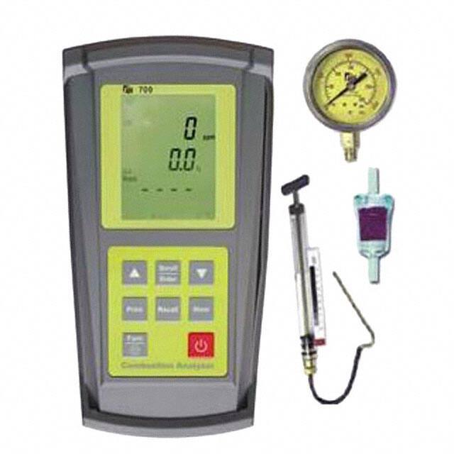

709 Data Sheet 02.11 709 Combustion Analyzer Test the TPI Advantage Features QUICK AND SIMPLE SET UP All TPI analyzers feature quick and simple set up. Fast purge and the ability to performfuel selectionduring start up enable tests to be performed quickly without requiring extra set-up time after initial startup. TPI analyzers also use the last selected fuel as the default setting. This feature prevents the need toperform fuel selection every time the analyzer is turned on. • Built-in differential manometer with 0.001” H2O resolution • Calculates combustion efficiency • Pump driven for fast response • Will not shut off if 15 ppm CO is present for increased safety • Optional A740 IR printer available for hard copies of test results • Built-in differential thermometer • Store function to save up to 50 readings • Push on fittings for fast and easy use • Large easy to read backlit display • Ten selectable fuels www.tpithevalueleader.com Specifications Instrument Operating Temperature Range 14°F to +122°F (-10°C to +50°C) Battery / Batery Life AA (3) / > 6 Hours Fuels Natural Gas, LPG, Light Oil, Heavy Oil, Bituminous Coal, Anthracite Coal, Coke, Butane, Wood, Bagasse Units of Pressure mbar, kPa & inH2O Display 3 Line Backlit LCD w/ annunciators Data Storage 50 sets of readings Time & Date 24 Hour Real Time Clock Dimensions 7.8” x 3.5” x 2.4” Weight 1.1lbs Gases Oxygen Carbon Monoxide Carbon Dioxide CO/CO2 Ratio Combustion Eff. Range 0-25% 0-10,000 ppm 0-25% 0-0.999 0-100% Resolution 0.1% 1 ppm 0.1% 0.001 0.1% Accuracy +/- 0.3% +/- 5 ppm or 5% Calculated Calculated Calculated Pressure Measurement Selectable Ranges Range Resolution Accuracy mbar, kPa and inH2O -120 inH2O to 120 inH2O 0.001 inH2O +/- 0.5% fsd Temperature Measurement Input Type Range Resolution Accuracy K-Type thermocouple -58°F to 1832°F (-50°C to 1000°C) 1°F (1°C) +/- (0.3% of rdg + 2°F) or +/- (0.3% of rdg + 1°C) A787 Soft Carrying Case A770 Flue Probe GK11M K-type thermocouple A763 Mini pump protection filter A774 Silicone Tubing Copyright © 2011 Test Products International, Inc.
