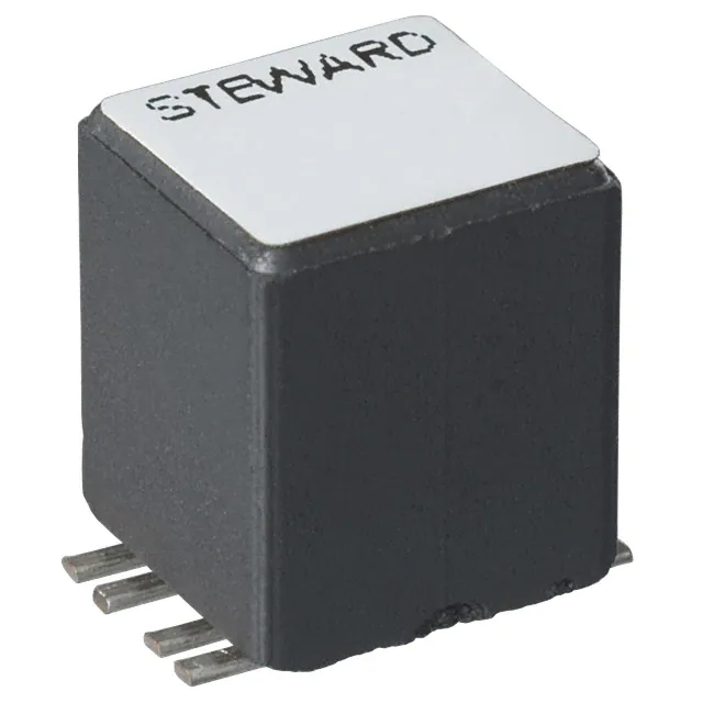

COMMON MODE Common Mode Choke Arrays Steward ‘s multi-line common mode power/data array filters provide the most economical EMI filtering available for common mode noise. These ferrite surface mount filters provide EMI suppression for groups of conductors like power traces and high speed input/output circuitry (including network and storage subsystems). Steward’s common mode choke arrays exhibit high frequency impedance essentially independent of low frequency AC or DC bias current. Protected by the following US Patent : 5,455,552 Features: ·Surface mount design ·The most economical common mode filter available for filtering groups of signals ·Can be used as multiturn device to multiply impedance ·With two turns, over 1000 ohms impedance at 100 MHz ·Will fit behind an RJ45 jack ·High continuous operating current carrying capability ·4, 6 or 8 line parts ·Parts available in broad band and high frequency materials Applications: ·Cost sensitive designs (no need for an expensive filtered connector) ·Filtering DC power on PC boards, especially in applications of greater than 3.0 amperes ·Filtering common mode EMI on high speed differential lines such as network and SCSI subsystems ·Low normal mode distortion provides excellent response in telecom applications Test Specifications: ·HP4396A (100KHz - 1.8 GHz) or HP8753 (to 6 GHz) Network/Spectrum Analyzer ·HP43961A Impedance Test Kit ·HP16192A Test Fixture or Inter-Continental Microwave custom fixtures ·HP16200A DC Bias Adapter ·Philips PM2811 DC Power Supply ·Ambient Temperature 23.5oC + 2o ·Bandwidth 3 kHz ·Sweep Time 423 ms ·Impedance is rated at + 25% @100MHz ·Board level components are rated up to a maximum of 75 volts ·Maximum current ratings are determined by testing to a maximum temperature rise of 40oC with continuous operating current. Part performance is shown with curves for Common, Open and Normal Mode Impedances measured along two conductors. Common Mode Impedance is the impedance of EMI noise conducted in the same direction along two conductors. Open Circuit Impedance is the impedance measured across a single leg of the common mode choke. Normal Mode Impedance is the total impedance to the differential circuit (both out and back). PART NUMBERING SYSTEM CM PRODUCT SERIES CODE 3032 V PART SIZE CODE 201 RATED CURRENT CODE IMPEDANCE VALUE CODE R PACKAGING CODE - 00 ADDITIONAL DESCRIPTION Ambient Operating Temperature Range: -55° C to +125° C PART NUMBER Fig # # of Single Lines A mm (inches) B mm (inches) C mm (inches) E1 mm (inches) E mm (inches) CM3032V201R-00 3 4 7.62 + 0.30 (0.300 + 0.012) 8.13 + 0.15 (0.320 + 0.006) 9.45 + 0.25 (0.372 + 0.010) 1.27 + 0.08 (0.050 + 0.003) 2.03 + 0.08 (0.080 + 0.003) 200 230 CM4732V201R-00 2 6 11.94 + 0.30 (0.470+ 0.012) 8.13 + 0.15 (0.320 + 0.006) 9.45 + 0.25 (0.372 + 0.010) 1.27 + 0.08 (0.050 + 0.003) 2.03 + 0.08 (0.080 + 0.003) 200 CM6032V201R-00 1 8 15.24 + 0.30 (0.600 + 0.012) 8.13 + 0.15 (0.320 + 0.006) 9.45 + 0.25 (0.372 + 0.010) 1.27 + 0.08 (0.050 + 0.003) 2.03 + 0.08 (0.080 + 0.003) CM3032V301R-00 3 4 7.62 + 0.30 (0.300 + 0.012) 8.13 + 0.15 (0.320 + 0.006) 14.48 + 0.25 (0.570 + 0.010) 1.27 + 0.08 (0.050 + 0.003) * CM4732V301R-00 2 6 11.94 + 0.30 (0.470+ 0.012) 8.13 + 0.15 (0.320 + 0.006) 14.48 + 0.25 (0.570 + 0.010) * CM6032V301R-00 1 8 15.24 + 0.30 (0.600 + 0.012) 8.13 + 0.15 (0.320 + 0.006) * CM3032V131R-00 3 4 7.62 + 0.30 (0.300 + 0.012) * CM4732V131R-00 2 6 * CM6032V131R-00 1 8 22 IMPEDANCE (Z) TYPICAL OHMS @ 100MHz 500MHz 1GHz DCR MAX OHMS RATED I MAX (continuous) mA 205 0.010 8,000 230 205 0.010 8,000 200 230 205 0.010 8,000 2.03 + 0.08 (0.080 + 0.003) 300 300 240 0.010 8,000 1.27 + 0.08 (0.050 + 0.003) 2.03 + 0.08 (0.080 + 0.003) 300 300 240 0.010 8,000 14.48 + 0.25 (0.570 + 0.010) 1.27 + 0.08 (0.050 + 0.003) 2.03 + 0.08 (0.080 + 0.003) 300 300 240 0.010 8,000 8.13 + 0.15 (0.320 + 0.006) 9.45 + 0.25 (0.372 + 0.010) 1.27 + 0.08 (0.050 + 0.003) 2.03 + 0.08 (0.080 + 0.003) 130 260 250 0.010 8,000 11.94 + 0.30 (0.470+ 0.012) 8.13 + 0.15 (0.320 + 0.006) 9.45 + 0.25 (0.372 + 0.010) 1.27 + 0.08 (0.050 + 0.003) 2.03 + 0.08 (0.080 + 0.003) 130 260 250 0.010 8,000 15.24 + 0.30 (0.600 + 0.012) 8.13 + 0.15 (0.320 + 0.006) 9.45 + 0.25 (0.372 + 0.010) 1.27 + 0.08 (0.050 + 0.003) 2.03 + 0.08 (0.080 + 0.003) 130 260 250 0.010 8,000 STEWARD - U.S.A. • Telephone: 423/867-4100 • Fax 423/867-4102 • Internet: http://www.steward.com SCOTLAND • Telephone: 44-(0)1-506-414200 • Fax 44-(0)1-506-410694 SINGAPORE • Telephone: (65)337-9667 • Fax (65)337-9686 PART NUMBER Fig # # of Single Lines A mm (inches) B mm (inches) C mm (inches) E1 mm (inches) E mm (inches) IMPEDANCE (Z) TYPICAL OHMS @ 100MHz 500MHz 1GHz DCR M AX OHMS RATED I MAX (continuous) mA 3 4 7.62 + 0.30 (0.300+ 0.012) 8.13 + 0.15 (0.320 + 0.006 14.48 + 0.25 (0.570 + 0.010 1.27 + 0.08 (0.050 + 0.003) 2.03 + 0.08 (0.080 + 0.003 220 300 190 0.010 8,000 * CM4732V221R-00 2 6 11.94 + 0.30 (0.470+ 0.012) 8.13 + 0.15 (0.320 + 0.006) 14.48 + 0.25 (0.570 + 0.010) 1.27 + 0.08 (0.050 + 0.003) 2.03 + 0.08 (0.080 + 0.003) 220 300 190 0.010 8,000 * CM6032V221R-00 1 8 15.24 + 0.30 (0.600 + 0.012) 8.13 + 0.15 (0.320 + 0.006) 14.48 + 0.25 (0.570 + 0.010) 1.27 + 0.08 (0.050 + 0.003) 2.03 + 0.08 (0.080 + 0.003) 220 300 190 0.010 8,000 COMMON MODE * CM3032V221R-00 *High Frequency Material CM3032V201R-00, CM4732V201R-00 & CM6032V201R-00 Z (1 & 2 Turn), R, XL vs. Frequency Impedance, Resistance, Inductive Reactance 1000 CM3032V201R-00, CM4732V201R-00 & CM6032V201R-00 Z vs. Frequency Open, Common and Normal Mode 600 1 900 500 700 Impedance (W) Impedance (W) 800 600 Z (2 Turns) 500 400 300 400 300 200 Open Common Normal Z (1 Turn) 200 R 100 100 XL 0 1 100 10 0 1000 10000 10 Frequency (MHz) 100 1000 10000 Frequency (MHz) CM3032V301R-00, CM4732V301R-00 & CM6032V301R-00 Z (1 & 2 Turn), R, XL vs. Frequency Impedance, Resistance, Inductive Reactance 1200 CM3032V301R-00, CM4732V301R-00 & CM6032V301R-00 Z vs. Frequency Open, Common and Normal Mode 600 1100 1000 500 Z (2 Turns) Impedance (W) Impedance (W) 900 800 700 600 500 400 300 Z (1 Turn) 200 100 R 1 10 300 Open 200 Common 100 XL 0 400 Normal 0 100 Frequency (MHz) 1000 10000 1 10 100 1000 10000 Frequency (MHz) STEWARD - U.S.A. • Telephone: 423/867-4100 • Fax 423/867-4102 • Internet: http://www.steward.com SCOTLAND • Telephone: 44-(0)1-506-414200 • Fax 44-(0)1-506-410694 SINGAPORE • Telephone: (65)337-9667 • Fax (65)337-9686 23 CM3032V131R-00, CM4732V131R-00 & CM6032V131R-00 Z (1 & 2 Turn), R, XL vs. Frequency Impedance, Resistance, Inductive Reactance CM3032V131R-00, CM4732V131R-00 & CM6032V131R-00 Z vs. Frequency Open, Common and Normal Mode COMMON MODE 1000 400 900 300 700 Impedance (W) Impedance (W) 800 600 Z (2 Turns) 500 400 300 Open 200 Common 100 Z (1 Turn) 200 Normal R 100 XL 0 0 1 10 1000 100 10000 1 10 Frequency (MHz) 100 1000 10000 Frequency (MHz) CM3032V221R-00, CM4732V221R-00 & CM6032V221R-00 Z (1 & 2 Turn), R, XL vs. Frequency Impedance, Resistance, Inductive Reactance CM3032V221R-00, CM4732V221R-00 & CM6032V221R-00 Z vs. Frequency Open, Common and Normal Mode 400 1200 1100 1000 300 Impedance (W) Impedance (W) 900 800 700 600 Z (2 Turns) 500 400 300 Z (1 Turn) 200 Open Common 100 R 200 100 1 10 100 Frequency (MHz) 24 Normal XL 0 0 1000 10000 1 10 100 Frequency (MHz) STEWARD - U.S.A. • Telephone: 423/867-4100 • Fax 423/867-4102 • Internet: http://www.steward.com SCOTLAND • Telephone: 44-(0)1-506-414200 • Fax 44-(0)1-506-410694 SINGAPORE • Telephone: (65)337-9667 • Fax (65)337-9686 1000 10000 Figure 2 Figure 1 A B A A COMMON MODE B B Figure 3 C C C E1 E1 E1 E E E Land Patterns for Reflow Soldering Figure 1 Figure 2 * Recommended Soldering Conditions Figure 3 (For wave soldering, add 0.076mm (0.030”) to this dimension.) One Turn / Two Turn Equivalent Circuits Figure 1 Figure 2 STEWARD - U.S.A. • Telephone: 423/867-4100 • Fax 423/867-4102 • Internet: http://www.steward.com SCOTLAND • Telephone: 44-(0)1-506-414200 • Fax 44-(0)1-506-410694 SINGAPORE • Telephone: (65)337-9667 • Fax (65)337-9686 Figure 3 25
