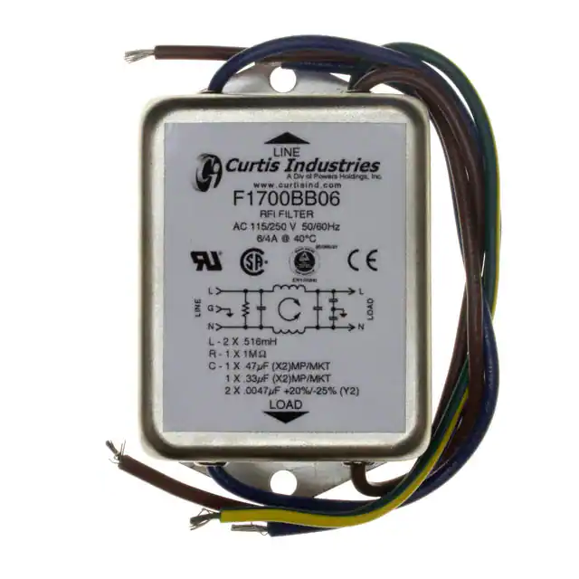

F1700/F1799 RFI Filters Specifications: High Performance Features: F1700 Simplified Schematic L LOAD LINE L G N N F1799 Simplified Schematic L LOAD L LINE SINGLE PHASE FILTERS Rated Voltage: 250VAC Maximum - 50/60 Hz Rated Current: 115VAC 250VAC 3A 2.5A 6A 4A 10A 6A 20A 10A 30A 15A Current Overload: 6X for 8 seconds Hi-Pot Test (1 min): Line to Ground 1500VAC Line to Line 1768VDC Insulation Resistance: 9 x 109 Ω at 100VDC Ambient Temperature: 40°C Max. at rated current Humidity Range: 0% to 95% R.H. Termination: A: QC – Quick Connect C: IEC Receptacle B: Wire D: Screw Maximum Leakage Current: Each Line to Ground F1700 F1710 F1720 F1740 F1799 115VAC, 60Hz: 0.40mA .15mA .002mA .060mA 0.25mA 250VAC, 50Hz: 0.75mA .25mA .005mA .120mA 0.45mA Agency Approvals: • General Purpose — Designed for Applications with Higher Differential Mode Noise • Higher Line-to-Line Capacitance for Protection from Pulsed, Intermittent or Continuous RFI • A Cost-Effective Replacement for Independent Coil Design in Many SMPS Applications • Available with Integral IEC Connector G Nominal Current Rating Except 30Amp N N MINIMUM INSERTION LOSS - dB (50 ohm Circuit) Part Number Termination Line/Load MODE .15 .50 1.0 5.0 10 30 Common Differential 20 25 35 60 43 65 52 65 55 50 50 50 QC/QC Common Differential 20 25 34 60 40 65 45 65 45 50 40 50 F1720AA03 QC/QC Common Differential 20 35 32 60 35 65 35 60 35 55 40 40 F1740AA03 QC/QC Common Differential 20 35 30 60 35 65 35 60 35 55 40 40 6A F1700AA06 F1700BB06 F1700CA06 QC/QC Wire/Wire IEC/QC Common Differential 10 15 22 50 30 65 46 60 50 60 45 60 10A F1700AA10 F1700BB10 F1700CA10 QC/QC Wire/Wire IEC/QC Common Differential 10 20 22 45 30 60 46 65 50 60 45 55 F1700AA20 QC/QC Screw/Screw Common Differential 10 15 22 45 30 60 42 65 47 60 40 55 F1700DD20 F1720DD20 Screw/Screw Common Differential 10 15 22 45 30 60 42 65 47 60 52 55 F1700DD30 Screw/Screw Common Differential 7 15 15 45 20 60 34 65 42 60 40 55 F1799DD30 Screw/Screw Common Differential 10 15 45 65 55 65 60 65 60 60 50 55 3A 20A 30A F1700AA03 F1700BB03 F1700CA03 QC/QC Wire/Wire IEC/QC F1710AA03 NOTE: Other combinations of terminals may be specified on special order. 22 www.curtisind.com Curtis Industries A Division of Powers Holdings, Inc. Specifications subject to change. Dimensions are shown for reference purposes only. F1700AA, 1710, 1720, 1740 (3, 6 and 10Amp) Dimensions A D L O A D F B C D E F 3A 2.750 (69,8) 1.750 (44,4) 1.125 (28,5) 2.375 (60,3) 2.000 (50,8) .550 (14,0) 6A 3.312 (84,1) 2.000 (50,8) 1.125 (28,5) 2.940 (74,7) 2.500 (63,5) .550 (14,0) 10A 3.312 (84,1) 2.000 (50,8) 1.500 (38,2) 2.940 (74,7) 2.500 (63,5) .550 (14,0) B E 20A F .250 QC E A B C D E 3A 2.750 (69,8) 1.750 (44,4) 1.125 (28,5) 2.375 (60,3) 2.000 (50,8) 6A 3.312 (84,1) 2.000 (50,8) 1.125 (28,5) 2.940 (74,7) 2.500 (63,5) 10A 3.312 (84,1) 2.000 (50,8) 1.500 (38,1) 2.940 (74,7) 2.500 (63,5) Refer to Page 40 for Standard Mounting Cutouts C A B C D E 3A 2.000 (50,8) 1.500 (38,1) .550 (14,0) .565 (14,3) 6A 2.500 (63,5) 2.000 (50,8) 1.500 (38,1) .550 (14,0) .565 (14,3) 10A 2.500 (63,5) 2.000 (50,8) 1.500 (38,1) .550 (14,0) .565 (14,3) B E 1.520 (38,6) .250 ±.062 (6,35) .188 Dia. (4.77) 2 Holes 2.000 (50,8) L I N E No. 18 Gauge Wire F1700DD20 (20Amp) Dimensions 5.075 (128,9) 4.140 (105,2) Type. C D 2.000 (50,8) A 4.00 Min. (101,6) A Amps D L O A D (2) No. 6-32 UNC2B B F1700DD30 (30Amp) Dimensions (4) .250 x .156 (6,35) (3,95) L O A D SINGLE PHASE FILTERS Amps L O A D L I N E (3, 6 and 10Amp) Dimensions F1700BB (3, 6 and 10Amp) Dimensions L I N E See 1700DD20 for Case Dimensions F1700CA C (6,4) .188 Dia. (4.77) 2 Holes A High Performance L I N E Amps 3.312 (84,1) 3.750 (95,2) Terminals No. 8-32 (5) F1799DD (30Amp) Dimensions 2.500 (63,5) L I N E L O A D 2.940 (74,7) 3.312 (84,1) (5) No. 8-32 Studs .625 (15,87) 2.000 (50,8) Also Available with .250” Quick Connect Terminals Dimensions are in inches and millimeters unless otherwise specified. Values in parentheses are metric equivalents. .625 (15,87) 1.500 (38,1) SLOTTED HOLE, 6.4(.25)X4.0(.16) #8-32 SCREW TERMINAL 3.5 (88,90) 3.12 (79,2) 3.96 (110,6) 50.8 (2.00) 5.95 (151,1) Curtis Industries A Division of Powers Holdings, Inc. 2.18 (55,4) 1-800-657-0853 23 Standard Mounting Cutouts F1200CA, F1300CA, F1400CA, F1500CA, F1600CA, F1700CA F1500FA, F1600FA, 1.20 (30.5) .187 (4,75) .638 (16,21) .140 Dia. (3,55) 2 Holes ✱.09 R (2,29) 1.275 (32,39) .90 (22,9) .140 Dia. (3,55) 2 Holes 1.575 (40,0) .234 (5,94) 1.145 (29,08) .450 (11,43) ✱ for mounting from back side 1.417 (36,0) SINGLE PHASE FILTERS How to Order The Curtis part numbering system is made up of four elements. Each element denotes a specific requirement (mechanical or electrical) which, when properly sequenced, fully identifies the required catalog filter. As shown, the first five alpha/numeric characters denote the series type; the sixth character (alpha) denotes the type of line termination; the seventh character (alpha) denotes the type of load termination; the last two characters (numeric) denote the current rating. Compose your part number as follows: Select the series required, add two alpha character for the line and load termination, followed by two numeric characters for the required current rating. For example, F1100AB06 completely identifies an F1100 series filter with quick connects on line side and wire leads on load side, with a 6-amp rating. F1100 X X SERIES PE = Power Entry PM = Medical Power Entry LINE TERMINATION A = Quick Connects B = Wire Leads C = IEC Connector D = Screw Terminals (20 & 30 amp only) F = Fused IEC P = Printed Circuit Pins W= Dual Fused IEC J = Switched IEC 40 www.curtisind.com LOAD TERMINATION A = Quick Connects B = Wire Leads D = Screw Terminals (20 & 30 amp only) P = Printed Circuit Pins S = Solder Tab X CURRENT RATING 01 = 1 Amp 03 = 3 Amps 06 = 6 Amps 10 = 10 Amps 15 = 15 Amps 20 = 20 Amps 30 = 30 Amps F1300CP, F1600CP 1.500 (38,1) .600 (15,2) N .700 (17,8) 1.400 (35,6) .062 Hole Dia. (1,57) 5 Holes L F5500/5600/5700 SERIES 1.575 (40,01) .90 (22,8) .140 Dia. (3,55) 2 Holes .234 R. (5,94) (Typ.) Curtis Industries A Division of Powers Holdings, Inc. 1.20 (30,48) Specifications subject to change. Dimensions are shown for reference purposes only.
