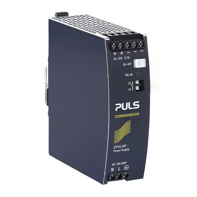

CP10.361 36V, 6.7A, 240W, SINGLE PHASE INPUT CP-Series POWER SUPPLY ▪ ▪ ▪ ▪ ▪ ▪ ▪ ▪ ▪ ▪ ▪ AC 100-240V Wide-range Input Width only 39mm Efficiency up to 95.4% Excellent Partial Load Efficiency 20% Output Power Reserves (PowerBoost) Safe HiccupPLUS Overload Mode Active Power Factor Correction (PFC) Minimal Inrush Current Surge Full Power Between -25°C and +60°C DC-OK Relay Contact 3 Year Warranty PRODUCT DESCRIPTION SHORT-FORM DATA The DIMENSION CP-Series units are high-end power supplies in a medium price range without compromising quality, reliability and performance. The CP-Series is part of the DIMENSION power supply family. The most outstanding features of CP10.361 are the high efficiency, advanced inrush current limitation, active PFC and the wide operational temperature range. Output voltage Adjustment range Output current The CP-Series includes all the essential basic functions. The devices also offer PowerBoost: Power reserves of 20%, which may even be used continuously at temperatures up to +45°C. Additionally, the CP10 can deliver three times the nominal output current for at least 12ms which helps to trip fuses on faulty output branches. High immunity to transients and power surges as well as low electromagnetic emission, a DC-OK relay contact and a large international approval package for a variety of applications makes this unit suitable for nearly every situation. ORDER NUMBERS Power Supply CP10.361 Accessory ZM10.WALL ZM12.SIDE PowerBoost Input voltage AC Mains frequency Input current AC Power factor Input voltage DC Input current DC Input inrush current Efficiency Losses Hold-up time Temperature range Size (w x h x d) Weight DC 36V Nominal 36 – 42V Factory setting 36.0V 6.7 - 5.7A Up to +60°C ambient 5.0 - 4.3A At +70°C ambient Derate linearly between +60°C and +70°C 8.0A Up to +45°C ambient Linear decrease to nominal power between +45°C and +60°C AC 100-240V -15%/ +10% 50-60Hz ±6% 2.16 / 1.13A At 120 / 230Vac 0.99 / 0.97 At 120 / 230Vac DC 110-150V ±20% 2.35A At 110Vdc 6 / 9A pk At 40°C 120 / 230Vac 93.8 / 95.4% At 120 / 230Vac 15.9 / 11.6W At 120 / 230Vac 38 / 38ms At 120 / 230Vac -25°C to +70°C 39x124x117mm Without DIN rail 600g MAIN APPROVAL For details and the complete approval list, see chapter 20. Wall/panel mount bracket Side mount bracket UL 61010-2-201 UL 60950-1 ATEX IECEx Class I Div 2 Marine Jul. 2022 / Rev. 1.2 DS-CP10.361-EN All parameters are specified at 36V, 6.7A, 230Vac, 50Hz, 25°C ambient and after a 5 minutes run-in time unless otherwise noted. www.pulspower.com Phone +49 89 9278 0 Germany 1/32 CP10.361 36V, 6.7A, 240W, SINGLE PHASE INPUT CP-Series INDEX Page 1. 2. 3. 4. 5. 6. 7. 8. 9. 10. 11. 12. 13. 14. 15. 16. 17. 18. 19. 20. 21. Intended Use ................................................................ 3 Installation Instructions ................................................ 3 AC-Input ....................................................................... 5 DC-Input ....................................................................... 6 Input Inrush Current ..................................................... 7 Output .......................................................................... 8 Hold-up Time ................................................................ 9 DC-OK Relay Contact .................................................. 10 Efficiency and Power Losses ....................................... 11 Lifetime Expectancy ................................................... 12 MTBF .......................................................................... 12 Functional Diagram .................................................... 13 Terminals and Wiring ................................................. 14 Front Side and User Elements .................................... 15 EMC ............................................................................ 16 Environment ............................................................... 17 Protection Features .................................................... 18 Safety Features........................................................... 18 Dielectric Strength ...................................................... 19 Approved, Fulfilled or Tested Standards .................... 20 Regulatory Product Compliance ................................. 21 Page 22. Physical Dimensions and Weight ............................... 23 23. Accessories................................................................. 24 23.1. ZM10.WALL - Wall/Panel Mount Bracket......... 24 23.2. ZM12.SIDE - Side Mounting Bracket................. 25 23.3. YR2.DIODE - Redundancy Module .................... 26 23.4. YR40.482 - Redundancy Module ...................... 26 24. Application Notes....................................................... 27 24.1. Peak Current Capability .................................... 27 24.2. Back-feeding Loads .......................................... 28 24.3. External Input Protection ................................. 28 24.4. Output Circuit Breakers .................................... 28 24.5. Parallel Use to Increase Output Power ............ 29 24.6. Parallel Use for Redundancy ............................ 29 24.7. Series Operation............................................... 30 24.8. Inductive and Capacitive Loads ........................ 30 24.9. Charging of Batteries ........................................ 30 24.10. Operation on Two Phases ................................ 31 24.11. Use in a Tightly Sealed Enclosure ..................... 31 24.12. Mounting Orientations ..................................... 32 The information given in this document is correct to the best of our knowledge and experience at the time of publication. If not expressly agreed otherwise, this information does not represent a warranty in the legal sense of the word. As the state of our knowledge and experience is constantly changing, the information in this data sheet is subject to revision. We therefore kindly ask you to always use the latest issue of this document (available under www.pulspower.com). No part of this document may be reproduced or utilized in any form without our prior permission in writing. TERMINOLOGY AND ABREVIATIONS PE and symbol PE is the abbreviation for Protective Earth and has the same meaning as the symbol . Earth, Ground This document uses the term “earth” which is the same as the U.S. term “ground”. t.b.d. To be defined, value or description will follow later. AC 230V A figure displayed with the AC or DC before the value represents a nominal voltage with standard tolerances (usually ±15%) included. E.g.: DC 12V describes a 12V battery disregarding whether it is full (13.7V) or flat (10V) 230Vac A figure with the unit (Vac) at the end is a momentary figure without any additional tolerances included. 50Hz vs. 60Hz As long as not otherwise stated, AC 100V and AC 230V parameters are valid at 50Hz mains frequency. AC 120V parameters are valid for 60Hz mains frequency. may A key word indicating flexibility of choice with no implied preference. shall A key word indicating a mandatory requirement. should A key word indicating flexibility of choice with a strongly preferred implementation. Jul. 2022 / Rev. 1.2 DS-CP10.361-EN All parameters are specified at 36V, 6.7A, 230Vac, 50Hz, 25°C ambient and after a 5 minutes run-in time unless otherwise noted. www.pulspower.com Phone +49 89 9278 0 Germany 2/32 CP10.361 36V, 6.7A, 240W, SINGLE PHASE INPUT CP-Series 1. INTENDED USE This device is designed for installation in an enclosure and is intended for commercial use, such as in industrial control, process control, monitoring and measurement equipment or the like. Do not use this device in equipment, where malfunctioning may cause severe personal injury or threaten human life without additional appropriate safety devices, that are suited for the application. If this device is used in a manner outside of its specification, the protection provided by the device may be impaired. 2. INSTALLATION INSTRUCTIONS WARNING - Risk of electrical shock, fire, personal injury or death. Turn power off before working on the device and protect against inadvertent re-powering. Do not open, modify or repair the device. Use caution to prevent any foreign objects from entering into the housing. Do not use in wet locations or in areas where moisture or condensation can be expected. Do not touch during power-on, and immediately after power-off. Hot surface may cause burns. Obey the following installation instructions: This device may only be installed and put into operation by qualified personnel. This device does not contain serviceable parts. The tripping of an internal fuse is caused by an internal defect. If damage or malfunction should occur during installation or operation, immediately turn power off and send unit to the factory for inspection. Install device in an enclosure providing protection against electrical, mechanical and fire hazards. Install the device onto a DIN rail according to EN 60715 with the input terminals on the bottom of the device. Other mounting orientations require a reduction in output current. Make sure that the wiring is correct by following all local and national codes. Use appropriate copper cables that are designed for a minimum operating temperature of 60°C for ambient temperatures up to +45°C, 75°C for ambient temperatures up to +60°C and 90°C for ambient temperatures up to +70°C. Ensure that all strands of a stranded wire enter the terminal connection. Use ferrules for wires on the input terminals. Unused screw terminals should be securely tightened. The device is designed for pollution degree 2 areas in controlled environments. No condensation or frost is allowed. The enclosure of the device provides a degree of protection of IP20. The enclosure does not provide protection against spilled liquids. The isolation of the device is designed to withstand impulse voltages of overvoltage category III according to IEC 60664-1. The device is designed as “Class of Protection I” equipment according to IEC 61140. Do not use without a proper PE (Protective Earth) connection. The device is suitable to be supplied from TN, TT or IT mains networks. The continuous voltage between the input terminal and the PE potential must not exceed 300Vac. The input can also be powered from batteries or similar DC sources. The continuous voltage between the supply voltage and the PE/ground potential must not exceed 375Vdc. A disconnecting means shall be provided for the input of the device. The device is designed for convection cooling and does not require an external fan. Do not obstruct airflow and do not cover ventilation grid! The device is designed for altitudes up to 5000m. Above 2000m a reduction in output current and over voltage category is required. Keep the following minimum installation clearances: 40mm on top, 20mm on the bottom, 5mm left and right side. Increase the 5mm to 15mm in case the adjacent device is a heat source. When the device is permanently loaded with less than 50%, the 5mm can be reduced to zero. Jul. 2022 / Rev. 1.2 DS-CP10.361-EN All parameters are specified at 36V, 6.7A, 230Vac, 50Hz, 25°C ambient and after a 5 minutes run-in time unless otherwise noted. www.pulspower.com Phone +49 89 9278 0 Germany 3/32 CP10.361 36V, 6.7A, 240W, SINGLE PHASE INPUT CP-Series The device is designed, tested and approved for branch circuits up to 32A (IEC) and 30A (UL) without additional protection device. If an external fuse is utilized, do not use circuit breakers smaller than 6A B- or C-Characteristic to avoid a nuisance tripping of the circuit breaker. The maximum surrounding air temperature is +70°C. The operational temperature is the same as the ambient or surrounding air temperature and is defined 2cm below the device. The device is designed to operate in areas between 5% and 95% relative humidity. Installation Instructions for Hazardous Location Areas The device is suitable for use in Group II Category 3 (Zone 2) environments. Classification: ATEX: EPS 15 ATEX 1 101 X, II 3G EX ec nC IIC T4 Gc / IECEx EPS 15.0079X WARNING EXPLOSION HAZARDS! Use only in standard vertical mounting orientation with the input terminals on bottom of the unit. Substitution of components may impair suitability for this environment. Do not disconnect the device or operate the voltage adjustment unless power has been switched off or the area is known to be nonhazardous. A suitable enclosure must be provided for the end product, which has a minimum protection of IP54 and fulfils the requirements of the EN 60079-0. Jul. 2022 / Rev. 1.2 DS-CP10.361-EN All parameters are specified at 36V, 6.7A, 230Vac, 50Hz, 25°C ambient and after a 5 minutes run-in time unless otherwise noted. www.pulspower.com Phone +49 89 9278 0 Germany 4/32 CP10.361 36V, 6.7A, 240W, SINGLE PHASE INPUT CP-Series 3. AC-INPUT AC input AC input range Nom. AC 100-240V 85-264Vac 264-300Vac 300Vac Suitable for TN-, TT- and IT mains networks For maximal 500ms Continuous, according to IEC 62477-1 Allowed voltage L or N to earth Max. Input frequency Turn-on voltage Shut-down voltage External input protection Nom. 50–60Hz ±6% Typ. 80Vac Steady-state value, see Fig. 3-1 Typ. 70Vac Steady-state value, see Fig. 3-1 Typ. 55Vac Dynamic value for maximal 250ms See recommendations in chapter 24.3. Input current Power factor*) Crest factor**) Start-up delay Rise time Typ. Typ. Typ. Typ. Typ. AC 100V 2.62A 0.99 1.5 300ms 60ms AC 120V 2.16A 0.99 1.5 290ms 60ms AC 230V 1.13A 0.97 1.65 240ms 60ms Typ. 120ms 120ms 120ms Turn-on overshoot External input protection Max. 200mV 200mV See recommendations in chapter 24.3. At 36V, 6.7A, see Fig. 3-3 At 36V, 6.7A, see Fig. 3-4 At 36V, 6.7A See Fig. 3-2 At 36V, 6.7A const. current load, 0mF load capacitance, see Fig. 3-2 At 36V, 6.7A const. current load, 7mF load capacitance,, see Fig. 3-2 See Fig. 3-2 200mV *) The power factor is the ratio of the true (or real) power to the apparent power in an AC circuit. **) The crest factor is the mathematical ratio of the peak value to RMS value of the input current waveform. Fig. 3-1 Input voltage range Turn-on Shut -dow n Input Voltage max. 500ms - 5% Output Voltage VIN 85V Start-up delay Overshoot Rated input range POUT Fig. 3-2 Turn-on behavior, definitions Rise Time 264V 300Vac Fig. 3-3 Input current vs. output current at 36V output voltage Fig. 3-4 Power factor vs. output current at 36V output voltage Power Factor, typ. Input Current, typ. 3A 1.0 (a) 2.5 a) 100Vac b) 120Vac c) 230Vac 2.0 1.5 (a) 0.95 (b) (b) 0.9 (c) 1.0 0.85 (a) 100Vac, (b) 120Vac, (c) 230Vac (c) 0.8 0.5 Output Current 0 Output Current 0.75 1 2 3 4 5 6 7 8A 1 2 3 4 5 Jul. 2022 / Rev. 1.2 DS-CP10.361-EN All parameters are specified at 36V, 6.7A, 230Vac, 50Hz, 25°C ambient and after a 5 minutes run-in time unless otherwise noted. www.pulspower.com Phone +49 89 9278 0 Germany 6 7 8A 5/32 CP10.361 36V, 6.7A, 240W, SINGLE PHASE INPUT CP-Series 4. DC-INPUT DC input DC input range DC input current Allowed Voltage L/N to Earth Turn-on voltage Shut-down voltage Nom. Typ. Max. Typ. Typ. Typ. DC 110-150V 88-180Vdc 2.35A 375Vdc 80Vdc 70Vdc 55Vdc Fig. 4-1 Wiring for DC Input Battery + Power Supply AC L N PE - + Load ±20% At 110Vdc Continuous, according to IEC 62477-1 Steady state value Steady state value Dynamic value for maximal 250ms Instructions for DC use: a) Use a battery or a similar DC source. A supply from the intermediate DC-bus of a frequency converter is not recommended and can cause a malfunction or damage the unit. b) Connect +pole to L and –pole to N. c) Connect the PE terminal to an earth wire or to the machine ground. DC Jul. 2022 / Rev. 1.2 DS-CP10.361-EN All parameters are specified at 36V, 6.7A, 230Vac, 50Hz, 25°C ambient and after a 5 minutes run-in time unless otherwise noted. www.pulspower.com Phone +49 89 9278 0 Germany 6/32 CP10.361 36V, 6.7A, 240W, SINGLE PHASE INPUT CP-Series 5. INPUT INRUSH CURRENT An active inrush limitation circuit (NTCs, which are bypassed by a relay contact) limits the input inrush current after turn-on of the input voltage. The charging current into EMI suppression capacitors is disregarded in the first microseconds after switch-on. Inrush current AC 100V 11Apeak 9Apeak 9Apeak 0.1A²s Max. Typ. Typ. Max. Inrush energy Fig. 5-1 Typical turn-on behaviour at nominal load, 120Vac input and 25°C ambient 50ms/DIV Output voltage 30V/DIV AC 230V 11Apeak 6Apeak 9Apeak 0.4A²s At 40°C, cold start At 25°C, cold start At 40°C, cold start At 40°C, cold start Fig. 5-2 Typical turn-on behaviour at nominal load, 230Vac input and 25°C ambient 50ms/DIV 6A Input current 2A/DIV Input voltage 250V/DIV AC 120V 7Apeak 6Apeak 6Apeak 0.1A²s Input current 2A/DIV 6A Input voltage 500V/DIV Output voltage 30V/DIV Jul. 2022 / Rev. 1.2 DS-CP10.361-EN All parameters are specified at 36V, 6.7A, 230Vac, 50Hz, 25°C ambient and after a 5 minutes run-in time unless otherwise noted. www.pulspower.com Phone +49 89 9278 0 Germany 7/32 CP10.361 36V, 6.7A, 240W, SINGLE PHASE INPUT CP-Series 6. OUTPUT Output voltage Adjustment range Nom. Guaranteed value This is the maximum output voltage which can occur at the clockwise end position of the potentiometer due to tolerances. It is not a guaranteed value which can be achieved. Typ. 36.0V ±0.2%, at full load and cold unit Max. 10mV Between 85 and 300Vac Max. 50mV Between 0 and 8A, static value, see Fig. 6-1 Max. 50mVpp Bandwidth 20Hz to 20MHz, 50Ohm Nom. 6.7A At 36V and up to +60°C ambient temperature, see Fig. 6-1 Nom. 5.0A At 36V and +70°C ambient temperature, see Fig. 16-1 Nom. 5.7A At 42V and up to +60°C ambient temperature, see Fig. 6-1 Nom. 4.3A At 42V and +70°C ambient temperature, see Fig. 16-1 Derate linearly between +60°C and +70°C, see chapter 16 Nom. 8.0A At 36V and up to +45°C ambient temperature, see Fig. 16-1 Nom. 6.9A At 42V and up to +45°C ambient temperature, see Fig. 16-1 PowerBoost decreases linearly to nominal power between +45°C and +60°C, see chapter 16 Typ. 20A For minimal 12ms once every five seconds, see Fig. 6-2. The output voltage stays above 30V. See chapter 24.1 for more peak current measurements. For AC 100V mains, the pulse length is shorter than 12ms. Continuous current Output voltage above 20Vdc, see Fig. 6-1 HiccupPLUS mode2) Output voltage below 20Vdc, see Fig. 6-1 Min. 8.7A3) Load impedance 4mm E.g. screws, small parts Yes Output shut-down with automatic restart. The temperature sensor is installed on critical components inside the unit and turns the unit off in safety critical situations (e.g. derating requirements not observed, high ambient temperature, ventilation obstructed or the mounting orientation derating is not followed). There is no correlation between the operating temperature and turn-off temperature since this is dependent on input voltage, load and installation methods. MOV For protection values see chapter 15 (EMC). (Metal Oxide Varistor) Included Not user replaceable slow-blow high-braking capacity fuse 18. SAFETY FEATURES Input / output separation Class of protection Isolation resistance PE resistance Touch current (leakage current) Double or reinforced galvanic isolation SELV IEC/EN 60950-1 PELV IEC/EN 60204-1, EN 62477-1, IEC 60364-4-41 I PE (Protective Earth) connection required > 500MOhm At delivered condition between input and output, measured with 500Vdc > 500MOhm At delivered condition between input and PE, measured with 500Vdc > 500MOhm At delivered condition between output and PE, measured with 500Vdc > 500MOhm At delivered condition between output and DC-OK contacts, measured with 500Vdc < 0.1Ohm Resistance between PE terminal and the housing in the area of the DIN rail mounting bracket. Typ. 0.14mA / 0.36mA At 100Vac, 50Hz, TN-,TT-mains / IT-mains Typ. 0.20mA / 0.50mA At 120Vac, 60Hz, TN-,TT-mains / IT-mains Typ. 0.33mA / 0.86mA At 230Vac, 50Hz, TN-,TT-mains / IT-mains Max. 0.18mA / 0.43mA At 110Vac, 50Hz, TN-,TT-mains / IT-mains Max. 0.26mA / 0.61mA At 132Vac, 60Hz, TN-,TT-mains / IT-mains Max. 0.44mA / 1.05mA At 264Vac, 50Hz, TN-,TT-mains / IT-mains Jul. 2022 / Rev. 1.2 DS-CP10.361-EN All parameters are specified at 36V, 6.7A, 230Vac, 50Hz, 25°C ambient and after a 5 minutes run-in time unless otherwise noted. www.pulspower.com Phone +49 89 9278 0 Germany 18/32 CP10.361 36V, 6.7A, 240W, SINGLE PHASE INPUT CP-Series 19. DIELECTRIC STRENGTH The output voltage is floating and has no ohmic connection to the ground. Type and factory tests are conducted by the manufacturer. Field tests may be conducted in the field using the appropriate test equipment which applies the voltage with a slow ramp (2s up and 2s down). Connect all input-terminals together as well as all output poles before conducting the test. When testing, set the cut-off current settings to the value in the table below. Type test 60s A 2500Vac B 4000Vac C 1000Vac D 500Vac Factory test 5s 2500Vac 2500Vac 500Vac 500Vac Field test 5s 2000Vac 2000Vac 500Vac 500Vac Cut-off current setting > 10mA > 10mA > 20mA > 1mA Fig. 19-1 Dielectric strength Input L N 13 14 B A DC-ok B* ) D Output Earth, PE C + - To fulfil the PELV requirements according to EN60204-1 § 6.4.1, we recommend that either the + pole, the – pole or any other part of the output circuit shall be connected to the protective earth system. This helps to avoid situations in which a load starts unexpectedly or can not be switched off when unnoticed earth faults occur. B*) When testing input to DC-OK ensure that the max. voltage between DC-OK and the output is not exceeded (column D). We recommend connecting DC-OK pins and the output pins together when performing the test. Jul. 2022 / Rev. 1.2 DS-CP10.361-EN All parameters are specified at 36V, 6.7A, 230Vac, 50Hz, 25°C ambient and after a 5 minutes run-in time unless otherwise noted. www.pulspower.com Phone +49 89 9278 0 Germany 19/32 CP10.361 36V, 6.7A, 240W, SINGLE PHASE INPUT CP-Series 20. APPROVED, FULFILLED OR TESTED STANDARDS UL 508 UL 61010-2-201 IEC 61010-2-201 UL Certificate Listed equipment for category NMTR - Industrial Control Equipment Applicable for US and Canada E-File: E198865 UL Certificate Listed equipment for category NMTR - Electrical Equipment for Measurement, Control and Laboratory Use - Particular requirements for control equipment Applicable for US and Canada E-File: E198865 CB Scheme Certificate Electrical Equipment for Measurement, Control and Laboratory Use Particular requirements for control equipment IEC 60950-1 CB Scheme Certificate General safety requirements for Information Technology Equipment (ITE) IEC 62368-1 CB Scheme Certificate IEC 62368-1 Audio/video, information and communication technology equipment - Safety requirements Output safety level: ES1 UL Certificate Recognized component for category QQGQ - Information Technology Equipment (ITE) Applicable for US and Canada E-File: E137006 Agency Certificate (Bureau Veritas) EN 60079-0 Explosive atmospheres - General requirements EN 60079-7, EN 60079-15 Equipment protection by type of protection "e" and "n" Certificate: EPS 15 ATEX 1 101 X Temperature Code: T4 Type of Protection: ec nC IECEx Certificate IEC 60079-0 Explosive atmospheres - General requirements IEC 60079-7, IEC 60079-15 Equipment protection by type of protection "e" and "n" Certificate: IECEx EPS 15.0079X Temperature Code: T4 Type of Protection: ec nC CSA Certificate Power Supplies for Hazardous Location Applicable for Canada and US CSA Class: 5318-01 (Canada), 5318-81 (USA) Temperature Code: T4 Groups: A, B, C and D UL 60950-1 ATEX IECEx Class I Div 2 Jul. 2022 / Rev. 1.2 DS-CP10.361-EN All parameters are specified at 36V, 6.7A, 230Vac, 50Hz, 25°C ambient and after a 5 minutes run-in time unless otherwise noted. www.pulspower.com Phone +49 89 9278 0 Germany 20/32 CP10.361 36V, 6.7A, 240W, SINGLE PHASE INPUT CP-Series Marine (DNV) DNV Certificate DNV Type approved product Certificate: TAA00002YX Temperature: Class D Humidity: Class B Vibration: Class C EMC: Class A Enclosure: Class A ABS Design Assessment Certificate ABS (American Bureau of Shipment) assessed product Certificate: 17-HG1599236-PDA Manufacturer's Declaration (Online Document) Environmental Tests, Flowing Mixed Gas Corrosion Test IEC 60068-2-60 Method 4 Test Ke - Method 4 H2S: 10ppb NO2: 200ppb Cl2: 10ppb SO2: 200ppb Test Duration: 3 weeks, this simulates a service life of 10 years. Manufacturer's Declaration (Online Document) Airborne Contaminants Corrosion Test ISA-71.04 G3 Severity Level: G3 Harsh H2S: 100ppb NOx: 1250ppb Cl2: 20ppb SO2: 300ppb Test Duration: 3 weeks, this simulates a service life of 10 years. Paint Wetting Impairment Substances Test (or LABS-Test) Tested for Zone 2 and test class C1 according to VDMA 24364-C1-L/W for solvents and water-based paints Marine (ABS) IEC 60068-2-60 ISA-71.04 G3 Labs 21. REGULATORY PRODUCT COMPLIANCE EU Declaration of Conformity REACH Regulation (EU) WEEE Regulation The CE mark indicates conformance with the - EMC directive - ATEX directive - RoHS directive Manufacturer's Declaration EU regulation regarding the Registration, Evaluation, Authorisation and Restriction of Chemicals (REACH) fulfilled. EU Regulation (EC) 1907/2006. Manufacturer's Declaration EU Regulation on Waste Electrical and Electronic Equipment Registered as business to business (B2B) products. EU Regulation 2012/19/EU Jul. 2022 / Rev. 1.2 DS-CP10.361-EN All parameters are specified at 36V, 6.7A, 230Vac, 50Hz, 25°C ambient and after a 5 minutes run-in time unless otherwise noted. www.pulspower.com Phone +49 89 9278 0 Germany 21/32 CP10.361 CP-Series UKCA CCC 36V, 6.7A, 240W, SINGLE PHASE INPUT UKCA Declaration of Conformity Trade conformity assessment for England, Scotland and Wales The UKCA mark indicates conformity with the UK Statutory Instruments 2016 No.1101, 2016 No.1091, 2012 No.3032 CCC Certificate China Compulsory Certification (CNCA-C23-01:2019) Certificate for devices made in Suzhou/China (PULS Electronics): 2021122303114443 Certificate for devices made in Chomutov/Czech Republic (PULS investiční): 2021122303114444 CCC-Ex Jul. 2022 / Rev. 1.2 DS-CP10.361-EN All parameters are specified at 36V, 6.7A, 230Vac, 50Hz, 25°C ambient and after a 5 minutes run-in time unless otherwise noted. www.pulspower.com Phone +49 89 9278 0 Germany 22/32 CP10.361 36V, 6.7A, 240W, SINGLE PHASE INPUT CP-Series 22. PHYSICAL DIMENSIONS AND WEIGHT Width Height Depth Weight DIN rail Housing material Installation clearances 39mm 124mm 117mm The DIN rail depth must be added to the unit depth to calculate the total required installation depth. 600g Use 35mm DIN rails according to EN 60715 or EN 50022 with a height of 7.5 or 15mm. Body: Aluminium alloy Cover: Zinc-plated steel See chapter 2 Fig. 22-1 Front view Fig. 22-2 Side view All dimensions in mm All dimensions in mm Jul. 2022 / Rev. 1.2 DS-CP10.361-EN All parameters are specified at 36V, 6.7A, 230Vac, 50Hz, 25°C ambient and after a 5 minutes run-in time unless otherwise noted. www.pulspower.com Phone +49 89 9278 0 Germany 23/32 CP10.361 36V, 6.7A, 240W, SINGLE PHASE INPUT CP-Series 23. ACCESSORIES 23.1. ZM10.WALL - WALL/PANEL MOUNT BRACKET This bracket is used to mount the devices on a wall/panel without utilizing the DIN rail. The bracket can be mounted without detaching the DIN rail brackets from the power supply. PSU for illustration purpose only. Fig. 23-1 Isometric view Fig. 23-4 Wall/panel mounting, Fig. 23-2 Isometric view Fig. 23-5 Hole pattern for wall mounting Fig. 23-3 Isometric view Fig. 23-6 Wall/panel mounting, side view front view Jul. 2022 / Rev. 1.2 DS-CP10.361-EN All parameters are specified at 36V, 6.7A, 230Vac, 50Hz, 25°C ambient and after a 5 minutes run-in time unless otherwise noted. www.pulspower.com Phone +49 89 9278 0 Germany 24/32 CP10.361 36V, 6.7A, 240W, SINGLE PHASE INPUT CP-Series 23.2. ZM12.SIDE - SIDE MOUNTING BRACKET This bracket is used to mount DIMENSION units sideways with or without utilizing a DIN rail. The two aluminum brackets and the black plastic slider of the unit have to be detached, so that the steel brackets can be mounted. For sideway DIN rail mounting, the removed aluminum brackets and the black plastic slider need to be mounted on the steel bracket. Side mounting with DIN rail brackets Side mounting without DIN rail brackets Jul. 2022 / Rev. 1.2 DS-CP10.361-EN All parameters are specified at 36V, 6.7A, 230Vac, 50Hz, 25°C ambient and after a 5 minutes run-in time unless otherwise noted. www.pulspower.com Phone +49 89 9278 0 Germany 25/32 CP10.361 36V, 6.7A, 240W, SINGLE PHASE INPUT CP-Series 23.3. YR2.DIODE - REDUNDANCY MODULE (2x 10A Inputs, 1x 20A output) The YR2.DIODE is a dual redundancy module, which has two diodes as decoupling devices included. It can be used for various purposes. The most popular application is to configure highly reliable and true redundant power supply systems. Another interesting application is the separation of sensitive loads from non-sensitive loads. This avoids the distortion of the power quality for the sensitive loads which can cause controller failures. The YR2.DIODE does not require an additional auxiliary voltage and is self-powered even in case of a short circuit across the output. The unit is very slender and only requires 32mm width on the DIN rail. 23.4. YR40.482 - REDUNDANCY MODULE (2x 20A Inputs, 1x 40A output) The YR40.482 is equipped with two input channels, which are individually decoupled by utilizing MOSFET technology. Using MOSFETs instead of diodes reduces the heat generation and the voltage drop between input and output. The YR40.482 does not require an additional auxiliary voltage and is self-powered even in case of a short circuit across the output. Due to the low power losses, the unit is very slender and only requires 46mm width on the DIN rail. Fig. 23-4 Typical 1+1 Redundant configuration for 6.7A with the YR2.DIODE redundancy module Fig. 23-5 Typical 1+1 Redundant configuration for 6.7A with the YR40.482 MOSFET redundancy module Failure Monitor + + - - - 36-42V DC-OK DCOK CP10.361 Power Supply L N PE I + + +- +- IN 1 IN 2 YR2.Diode Redundancy Module OUT - - - + + 36-42V DC-OK DCOK DCOK CP10.361 Power Supply + - - - - 36-42V DC-OK CP10.361 Power Supply L N PE L N PE + + + - + - Input Input 2 1 DCOK Redundancy Module Output - - - 36-42V DC-OK YR40.482 CP10.361 Power Supply + - I I 48V,5A Load L N PE Failure Monitor L N PE I 48V, 5A Load L N PE Jul. 2022 / Rev. 1.2 DS-CP10.361-EN All parameters are specified at 36V, 6.7A, 230Vac, 50Hz, 25°C ambient and after a 5 minutes run-in time unless otherwise noted. www.pulspower.com Phone +49 89 9278 0 Germany 26/32 CP10.361 36V, 6.7A, 240W, SINGLE PHASE INPUT CP-Series 24. APPLICATION NOTES 24.1. PEAK CURRENT CAPABILITY The unit can deliver peak currents (up to several milliseconds) which are higher than the specified short term currents. This helps to start current demanding loads. Solenoids, contactors and pneumatic modules often have a steady state coil and a pick-up coil. The inrush current demand of the pick-up coil is several times higher than the steady-state current and usually exceeds the nominal output current (including the PowerBoost). The same situation applies when starting a capacitive load. The peak current capability also ensures the safe operation of subsequent circuit breakers of load circuits. The load branches are often individually protected with circuit breakers or fuses. In case of a short or an overload in one branch circuit, the fuse or circuit breaker need a certain amount of over-current to open in a timely manner. This avoids voltage loss in adjacent circuits. The extra current (peak current) is supplied by the power converter and the built-in large sized output capacitors of the power supply. The capacitors get discharged during such an event, which causes a voltage dip on the output. The following two examples show typical voltage dips for resistive loads: Fig. 24-1 13.4A peak current for 50ms , typ. (2x the nominal current) Fig. 24-2 33.5A peak current for 5ms , typ. (5x the nominal current) 36V Output Voltage 36V Output Voltage 21.3V 24.6V 13.4A 33.5A Output Current Output Current 0A 0A 10ms/DIV 1ms/DIV Fig. 24-3 20A peak current for 12ms , typ. (3x the nominal current) 36V Output Voltage 12ms 16.8V 20A Output Current 0A 10ms/DIV Peak current voltage dips Please note: The DC-OK relay triggers when the voltage dips more than 10% for longer than 1ms. Typically from 36V to 24.6V Typically from 36V to 22.7V Typically from 36V to 21.3V At 13.4A for 50ms, resistive load At 33.5A for 2ms, resistive load At 33.5A for 5ms, resistive load Jul. 2022 / Rev. 1.2 DS-CP10.361-EN All parameters are specified at 36V, 6.7A, 230Vac, 50Hz, 25°C ambient and after a 5 minutes run-in time unless otherwise noted. www.pulspower.com Phone +49 89 9278 0 Germany 27/32 CP10.361 36V, 6.7A, 240W, SINGLE PHASE INPUT CP-Series 24.2. BACK-FEEDING LOADS Loads such as decelerating motors and inductors can feed voltage back to the power supply. This feature is also called return voltage immunity or resistance against Back- E.M.F. (Electro Magnetic Force). This power supply is resistant and does not show malfunctioning when a load feeds back voltage to the power supply. It does not matter whether the power supply is on or off. The maximum allowed feed-back-voltage is 50Vdc. The maximum allowed feed-back peak current is 27A. Higher currents can temporarily shut-down the output voltage. The absorbing energy can be calculated according to the built-in large sized output capacitor which is specified in chapter 6. 24.3. EXTERNAL INPUT PROTECTION The unit is tested and approved for branch circuits up to 30A (UL) and 32A (IEC). An external protection is only required if the supplying branch has an ampacity greater than this. Check also local codes and local requirements. In some countries local regulations might apply. If an external fuse is necessary or utilized, minimum requirements need to be considered to avoid nuisance tripping of the circuit breaker. A minimum value of 6A B- or C-Characteristic breaker should be used. 24.4. OUTPUT CIRCUIT BREAKERS Standard miniature circuit breakers (MCB’s or UL 1077 circuit breakers) are commonly used for AC-supply systems and may also be used on 36V branches. MCB’s are designed to protect wires and circuits. If the ampere value and the characteristics of the MCB are adapted to the wire size that is used, the wiring is considered as thermally safe regardless of whether the MCB opens or not. To avoid voltage dips and under-voltage situations in adjacent 36V branches which are supplied by the same source, a fast (magnetic) tripping of the MCB is desired. A quick shutdown within 10ms is necessary corresponding roughly to the ride-through time of PLC's. This requires power supplies with high current reserves and large output capacitors. Furthermore, the impedance of the faulty branch must be sufficiently small in order for the current to actually flow. The best current reserve in the power supply does not help if Ohm’s law does not permit current flow. The following table has typical test results showing which B- and C-Characteristic MCBs magnetically trip depending on the wire cross chapter and wire length. Fig. 24-4 Test circuit Power Supply AC MCB Load + + Wire length DC - S1 - Maximal wire length*) for a fast (magnetic) tripping: 0.75mm² 1.0mm² 1.5mm² C-2A 49m 64m 98m C-3A C-4A B-6A 14m 2m 7m 23m 2m 7m 30m 2m 7m 2.5mm² > 120m 48m 2m 8m S1... Fault simulation switch *) Don’t forget to consider twice the distance to the load (or cable length) when calculating the total wire length (+ and – wire). Jul. 2022 / Rev. 1.2 DS-CP10.361-EN All parameters are specified at 36V, 6.7A, 230Vac, 50Hz, 25°C ambient and after a 5 minutes run-in time unless otherwise noted. www.pulspower.com Phone +49 89 9278 0 Germany 28/32 CP10.361 36V, 6.7A, 240W, SINGLE PHASE INPUT CP-Series 24.5. PARALLEL USE TO INCREASE OUTPUT POWER CP10.361 power supplies can be paralleled to increase the output power. The output voltage of all power supplies shall be adjusted to the same value (±100mV) with the same load conditions on all units, or the units can be left with the factory settings. There is no feature included which balances the load current between the power supplies. Usually the power supply with the higher adjusted output voltage draws current until it goes into current limitation. This means no harm to this power supply as long as the ambient temperature stays below 40°C. Unit A AC + - DC + Unit B Load AC If more than three units are connected in parallel, a fuse or circuit breaker with a rating of 10A is required on each output. Alternatively, a diode or redundancy module can also be utilized. + - DC - Energize all units at the same time to avoid the overload HiccupPLUS mode. It also might be necessary to cycle the input power (turn-off for at least five seconds), if the output was in HiccupPLUS mode due to overload or short circuits and the required output current is higher than the current of one unit. Restrictions: Keep an installation clearance of 15mm (left / right) between two power supplies and avoid installing the power supplies on top of each other. Do not use power supplies in parallel in mounting orientations other than the standard mounting orientation (terminals on bottom of the unit) or in any other condition where a derating of the output current is required (e.g. altitude, …). Pay attention that leakage current, EMI, inrush current, harmonics will increase when using multiple power supplies. 24.6. PARALLEL USE FOR REDUNDANCY Power supplies can be paralleled for redundancy to gain higher system availability. Redundant systems require a certain amount of extra power to support the load in case one power supply unit fails. The simplest way is to put two decoupled power supplies in parallel. This is called a 1+1 redundancy. In case one power supply unit fails, the other one is automatically able to support the load current without any interruption. Redundant systems for a higher power demand are usually built in a N+1 method. E.g. five power supplies, each rated for 6.7A are paralleled to build a 26.8A redundant system. For N+1 redundancy the same restrictions apply as for increasing the output power, see also chapter 24.5. Please note: Always use a redundancy module to decouple power supplies from each other. This prevents that the defective unit becomes a load for the other power supplies and the output voltage cannot be maintained any more. Further information and wiring configurations can be found in chapter 23.3. Failure Monitor + + Recommendations for building redundant power systems: a) b) c) - - - 36-42V DC-OK DCOK Use separate input fuses for each power supply. Monitor the individual power supply units. Therefore, use the DC-OK relay contact of the CP10 power supply. It is desirable to set the output voltages of all units to the same value (± 100mV) or leave it at the factory setting. CP10.361 Power Supply L N PE + + + - + - Input Input 2 1 DCOK YR40.482 Redundancy Module Output CP10.361 Power Supply + - I - - - 36-42V DC-OK L N PE I 48V, 5A Load L N PE Jul. 2022 / Rev. 1.2 DS-CP10.361-EN All parameters are specified at 36V, 6.7A, 230Vac, 50Hz, 25°C ambient and after a 5 minutes run-in time unless otherwise noted. www.pulspower.com Phone +49 89 9278 0 Germany 29/32 CP10.361 36V, 6.7A, 240W, SINGLE PHASE INPUT CP-Series 24.7. SERIES OPERATION Unit A Power supplies of the same type can be connected in series for higher output voltages. It is possible to connect as many units in series as needed, providing the sum of the output voltage does not exceed 150Vdc. Voltages with a potential above 60Vdc are not SELV any more and can be dangerous. Such voltages must be installed with a protection against touching. AC Earthing of the output is required when the sum of the output voltage is above 60Vdc. AC DC + + Unit B Avoid return voltage (e.g. from a decelerating motor or battery) which is applied to the output terminals. DC Load + - Earth (see notes) Restrictions: Keep an installation clearance of 15mm (left / right) between two power supplies and avoid installing the power supplies on top of each other. Do not use power supplies in series in mounting orientations other than the standard mounting orientation (terminals on bottom of the unit). Pay attention that leakage current, EMI, inrush current, harmonics will increase when using multiple power supplies. 24.8. INDUCTIVE AND CAPACITIVE LOADS The unit is designed to supply any kind of loads, including capacitive and inductive loads. If extreme large capacitors, such as EDLCs (electric double layer capacitors or “UltraCaps”) with a capacitance larger than 0.8F are connected to the output, the unit might charge the capacitor in the HiccupPLUS mode (see chapter 6). 24.9. CHARGING OF BATTERIES The power supply can be used to charge lead-acid or maintenance free batteries (SLA or VRLA batteries). Three 12V batteries are needed in series. Instructions for charging batteries: a) Set output voltage (measured at no load and at the battery end of the cable) very precisely to the end-of-charge voltage. End-of-charge voltage 41.7V 41.25V 40.7V 40.2V Battery temperature 10°C 20°C 30°C 40°C b) Use a 10A circuit breaker (or blocking diode) between the power supply and the battery. c) Ensure that the output current of the power supply is below the allowed charging current of the battery. d) Use only matched batteries when putting 12V types in series. e) Ensure that the ambient temperature of the power supply stays below 40°C. f) The return current to the power supply (battery discharge current is typ. 2.5mA when the power supply is switched off (except in case a blocking diode is utilized). Jul. 2022 / Rev. 1.2 DS-CP10.361-EN All parameters are specified at 36V, 6.7A, 230Vac, 50Hz, 25°C ambient and after a 5 minutes run-in time unless otherwise noted. www.pulspower.com Phone +49 89 9278 0 Germany 30/32 CP10.361 36V, 6.7A, 240W, SINGLE PHASE INPUT CP-Series 24.10. OPERATION ON TWO PHASES Power Supply The power supply can also be used on two-phases of a three-phase-system. Such a phase-to-phase connection is allowed as long as the supplying voltage is below 240V+10%. Center L3 Tap 240V +10% max. L1 AC L N PE DC L2 24.11. USE IN A TIGHTLY SEALED ENCLOSURE When the power supply is installed in a tightly sealed enclosure, the temperature inside the enclosure will be higher than outside. In such situations, the inside temperature defines the ambient temperature for the power supply. The following measurement results can be used as a reference to estimate the temperature rise inside the enclosure. The power supply is placed in the middle of the box, no other heat producing items are inside the box The temperature sensor inside the box is placed in the middle of the right side of the power supply with a distance of 1cm. Enclosure size Input voltage Load Temperature inside the box Temperature outside the box Temperature rise Case A Case B Case C Case D 110x180x165mm Rittal Typ IP66 Box PK 9516 100, plastic 230Vac 36V, 5.4A; (=80%) 45.1°C 23.1°C 22.0K 110x180x165mm Rittal Typ IP66 Box PK 9516 100, plastic 230Vac 36V, 6.7A; (=100%) 48.9°C 22.6°C 26.3K 180x180x165mm Rittal Typ IP66 Box PK 9519 100, plastic 230Vac 36V, 5.4A; (=80%) 40.2°C 23.4°C 16.8K 180x180x165mm Rittal Typ IP66 Box PK 9519 100, plastic 230Vac 36V, 6.7A; (=100%) 44.9°C 23.2°C 21.7K Jul. 2022 / Rev. 1.2 DS-CP10.361-EN All parameters are specified at 36V, 6.7A, 230Vac, 50Hz, 25°C ambient and after a 5 minutes run-in time unless otherwise noted. www.pulspower.com Phone +49 89 9278 0 Germany 31/32 CP10.361 36V, 6.7A, 240W, SINGLE PHASE INPUT CP-Series 24.12. MOUNTING ORIENTATIONS Mounting orientations other than all terminals on the bottom require a reduction in continuous output power or a limitation in the maximum allowed ambient temperature. The amount of reduction influences the lifetime expectancy of the power supply. Therefore, two different derating curves for continuous operation can be found below: Curve A1 Recommended output current. Curve A2 Max allowed output current (results in approximately half the lifetime expectancy of A1). Fig. 24-5 Mounting Orientation A (Standard orientation) Output Current 8A OUTPUT A1 6 Power Supply 4 2 Ambient Temperature 0 INPUT 10 Fig. 24-6 Mounting Orientation B (Upside down) 20 30 40 50 60°C Output Current INPUT 8A A1 6 A2 Pow er Supply 4 2 Ambient Temperature OUTPUT 0 10 Fig. 24-7 Mounting Orientation C (Table-top mounting) 20 30 40 50 60°C Output Current 8A A1 6 A2 4 2 Ambient Temperature 0 10 40 50 60°C 8A OUTPUT Pow er Supply 6 A1 A2 4 2 Ambient Temperature 0 10 20 30 40 50 60°C Output Current 6 INPUT Pow er Supply 8A OUTPUT Fig. 24-9 Mounting Orientation E (Horizontal ccw) 30 Output Current INPUT Fig. 24-8 Mounting Orientation D (Horizontal cw) 20 A1 A2 4 2 Ambient Temperature 0 10 20 30 40 50 60°C Jul. 2022 / Rev. 1.2 DS-CP10.361-EN All parameters are specified at 36V, 6.7A, 230Vac, 50Hz, 25°C ambient and after a 5 minutes run-in time unless otherwise noted. www.pulspower.com Phone +49 89 9278 0 Germany 32/32

物料型号:CP10.361 - 这是一个CP-Series的电源模块,具有36V的单相输入,能够提供最高6.7A的输出电流,功率达到240W。
器件简介: - CP-Series电源模块是高性价比的高端电源,具有高效率、先进的输入电流限制、主动PFC(功率因数校正)和宽广的工作温度范围。 - 该系列包括所有基本功能,并提供PowerBoost功能,即在高达+45°C的温度下可以使用20%的额外输出功率储备。 - 设备还具有高瞬态和电源浪涌的抗扰度,低电磁辐射,DC-OK继电器接触点,以及适用于多种应用的大型国际认证包。
引脚分配: - 输入端子包括N(中性线)、L(相线)和PE(保护地)。 - 输出端子有两个相同的正极和三个相同的负极。
参数特性: - 输出电压:直流36V,可调节范围36-42V。 - 输出电流:在36V和+60°C环境温度下为6.7A,线性降低至+70°C环境温度。 - 输入电压:交流100-240V,频率50-60Hz。 - 效率:在120V交流输入时典型值为93.8%,在230V交流输入时典型值为95.4%。 - 工作温度范围:-25°C至+70°C。
功能详解: - 电源模块具有多种保护特性,包括过载保护、无负载保护和短路保护。 - 具有HiccupPLUS模式,在严重过载时,电源会尝试维持输出电流,然后周期性地关闭和重新启动。 - DC-OK继电器接触点监控运行中的电源模块的输出电压。
应用信息: - 设计用于商业用途,如工业控制、过程控制、监控和测量设备等。 - 不适用于可能造成严重人身伤害或威胁人命安全的设备中,除非有适当的安全装置。 - 电源模块适用于多种安装方式,包括DIN导轨安装和面板安装。
封装信息: - 尺寸:宽39mm x 高124mm x 深117mm,重量为600g。
