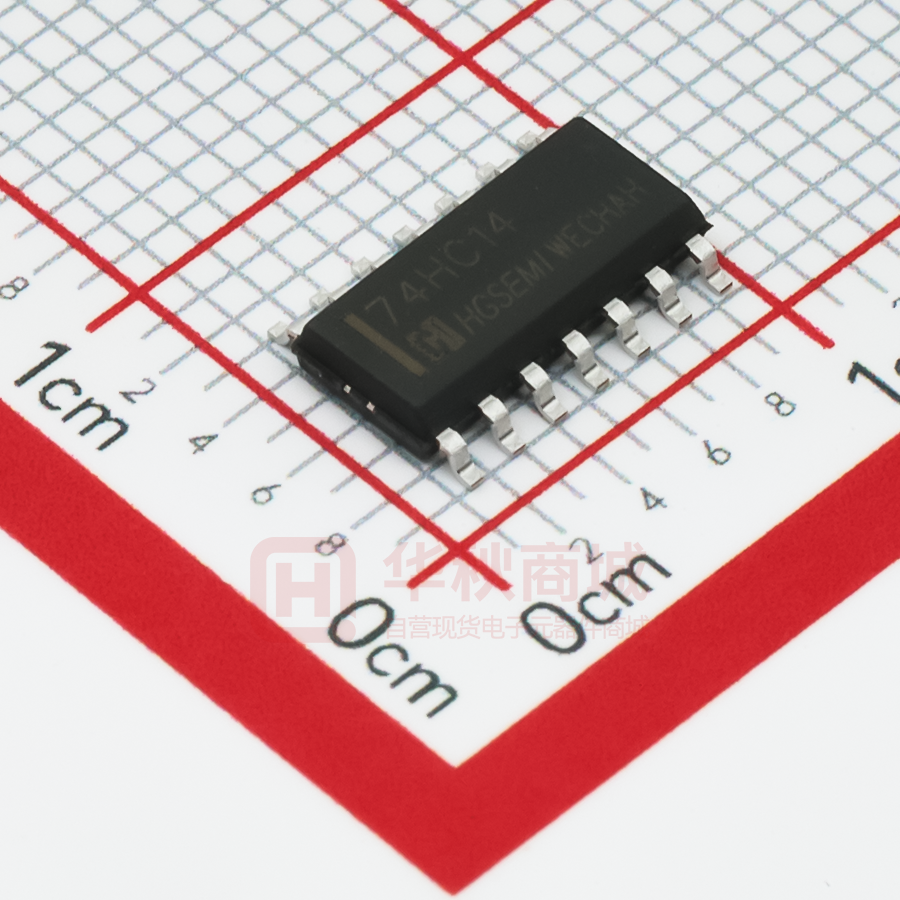

74HC14 Hex Schmitt−Trigger Inverter High−Performance Silicon−Gate CMOS The 74HC14 is identical in pinout to the LS14, LS04 and the HC04. The device inputs are compatible with Standard CMOS outputs; with pullup resistors, they are compatible with LSTTL outputs. The HC14 is useful to “square up” slow input rise and fall times. Due to hysteresis voltage of the Schmitt trigger, the HC14 finds applications in noisy environments. SOP −14 14 Features • • • • • • • • • Output Drive Capability: 10 LSTTL Loads Outputs Directly Interface to CMOS, NMOS and TTL Operating Voltage Range: 2.0 to 6.0 V Low Input Current: 1.0 mA High Noise Immunity Characteristic of CMOS Devices In Compliance With the JEDEC Standard No. 7A Requirements ESD Performance: HBM > 2000 V; Machine Model > 200 V Chip Complexity: 60 FETs or 15 Equivalent Gates These are Pb−Free Devices 1 DIP −14 Pinout: 14−Lead Packages (Top View) VCC A6 Y6 A5 Y5 A4 Y4 14 13 12 11 10 9 8 A1 A3 2 3 4 5 6 7 A1 Y1 A2 Y2 A3 Y3 GND Outputs A Y L H H L http://www.hgsemi.com.cn 12 11 10 9 8 1 2 3 4 5 6 7 1 2 3 4 5 6 9 8 11 10 13 12 Y1 Y2 Y3 Y=A A4 FUNCTION TABLE Inputs 13 LOGIC DIAGRAM A2 1 14 A5 A6 1 Y4 Pin 14 = VCC Pin 7 = GND Y5 Y6 2018 AUG 74HC14 ÎÎÎÎÎÎÎÎÎÎÎÎÎÎÎÎÎÎÎÎÎÎÎ ÎÎÎÎÎÎÎÎÎÎÎÎÎÎÎÎÎÎÎÎÎÎÎ MAXIMUM RATINGS Symbol Parameter Value Unit – 0.5 to + 7.0 V DC Input Voltage (Referenced to GND) – 0.5 to VCC + 0.5 V DC Output Voltage (Referenced to GND) – 0.5 to VCC + 0.5 V VCC DC Supply Voltage (Referenced to GND) Vin Vout Iin DC Input Current, per Pin ±20 mA Iout DC Output Current, per Pin ±25 mA ICC DC Supply Current, VCC and GND Pins ±50 mA PD Power Dissipation in Still Air, 500 450 mW Tstg Storage Temperature Range – 65 to + 150 _C TL Lead Temperature, 1 mm from Case for 10 Seconds SOIC or TSSOP Package SOIC Package† TSSOP Package† This device contains protection circuitry to guard against damage due to high static voltages or electric fields. However, precautions must be taken to avoid applications of any voltage higher than maximum rated voltages to this high−impedance circuit. For proper operation, Vin and Vout should be constrained to the range GND v (Vin or Vout) v VCC. Unused inputs must always be tied to an appropriate logic voltage level (e.g., either GND or VCC). Unused outputs must be left open. _C 260 Stresses exceeding Maximum Ratings may damage the device. Maximum Ratings are stress ratings only. Functional operation above the Recommended Operating Conditions is not implied. Extended exposure to stresses above the Recommended Operating Conditions may affect device reliability. †Derating — SOIC Package: – 7 mW/_C from 65_ to 125_C TSSOP Package: − 6.1 mW/_C from 65_ to 125_C For high frequency or heavy load considerations, see Chapter 2 of the ON Semiconductor High−Speed CMOS Data Book (DL129/D). RECOMMENDED OPERATING CONDITIONS Symbol VCC Vin, Vout Parameter DC Supply Voltage (Referenced to GND) DC Input Voltage, Output Voltage (Referenced to GND) TA Operating Temperature Range, All Package Types tr, tf Input Rise/Fall Time (Figure 1) VCC = 2.0 V VCC = 4.5 V VCC = 6.0 V Min Max Unit 2.0 6.0 V 0 VCC V – 55 + 125 _C 0 0 0 No Limit* No Limit* No Limit* ns *When Vin = 50% VCC, ICC > 1mA http://www.hgsemi.com.cn 2 2018 AUG 74HC14 DC CHARACTERISTICS (Voltages Referenced to GND) Guaranteed Limit VCC (V) −55 to 25°C ≤85°C ≤125°C Unit Vout = 0.1V |Iout| ≤ 20mA 2.0 3.0 4.5 6.0 1.50 2.15 3.15 4.20 1.50 2.15 3.15 4.20 1.50 2.15 3.15 4.20 V Minimum Positive−Going Input Threshold Voltage (Figure 3) Vout = 0.1V |Iout| ≤ 20mA 2.0 3.0 4.5 6.0 1.0 1.5 2.3 3.0 0.95 1.45 2.25 2.95 0.95 1.45 2.25 2.95 V VT− max Maximum Negative−Going Input Threshold Voltage (Figure 3) Vout = VCC − 0.1V |Iout| ≤ 20mA 2.0 3.0 4.5 6.0 0.9 1.4 2.0 2.6 0.95 1.45 2.05 2.65 0.95 1.45 2.05 2.65 V VT− min Minimum Negative−Going Input Threshold Voltage (Figure 3) Vout = VCC − 0.1V |Iout| ≤ 20mA 2.0 3.0 4.5 6.0 0.3 0.5 0.9 1.2 0.3 0.5 0.9 1.2 0.3 0.5 0.9 1.2 V VHmax Note 2 Maximum Hysteresis Voltage (Figure 3) Vout = 0.1V or VCC − 0.1V |Iout| ≤ 20mA 2.0 3.0 4.5 6.0 1.20 1.65 2.25 3.00 1.20 1.65 2.25 3.00 1.20 1.65 2.25 3.00 V VHmin Note 2 Minimum Hysteresis Voltage (Figure 3) Vout = 0.1V or VCC − 0.1V |Iout| ≤ 20mA 2.0 3.0 4.5 6.0 0.20 0.25 0.40 0.50 0.20 0.25 0.40 0.50 0.20 0.25 0.40 0.50 V VOH Minimum High−Level Output Voltage Vin ≤ VT− min |Iout| ≤ 20mA 2.0 4.5 6.0 1.9 4.4 5.9 1.9 4.4 5.9 1.9 4.4 5.9 V 3.0 4.5 6.0 2.48 3.98 5.48 2.34 3.84 5.34 2.20 3.70 5.20 2.0 4.5 6.0 0.1 0.1 0.1 0.1 0.1 0.1 0.1 0.1 0.1 3.0 4.5 6.0 0.26 0.26 0.26 0.33 0.33 0.33 0.40 0.40 0.40 Symbol Parameter VT+ max Maximum Positive−Going Input Threshold Voltage (Figure 3) VT+ min Condition Vin ≤ VT− min VOL Maximum Low−Level Output Voltage |Iout| ≤ 2.4mA |Iout| ≤ 4.0mA |Iout| ≤ 5.2mA Vin ≥ VT+ max |Iout| ≤ 20mA Vin ≥ VT+ max |Iout| ≤ 2.4mA |Iout| ≤ 4.0mA |Iout| ≤ 5.2mA V Iin Maximum Input Leakage Current Vin = VCC or GND 6.0 ±0.1 ±1.0 ±1.0 mA ICC Maximum Quiescent Supply Current (per Package) Vin = VCC or GND Iout = 0mA 6.0 2.0 20 40 mA 1. Information on typical parametric values along with frequency or heavy load considerations can be found in Chapter 2 of the ON Semiconductor High−Speed CMOS Data Book (DL129/D). 2. VHmin > (VT+ min) − (VT− max); VHmax = (VT+ max) − (VT− min). http://www.hgsemi.com.cn 3 2018 AUG 74HC14 AC CHARACTERISTICS (CL = 50pF, Input tr = tf = 6ns) Symbol Guaranteed Limit −55 to 25°C ≤85°C ≤125°C Unit tPLH, tPHL Maximum Propagation Delay, Input A or B to Output Y (Figures 1 and 2) 2.0 3.0 4.5 6.0 75 30 15 13 95 40 19 16 110 55 22 19 ns tTLH, tTHL Maximum Output Transition Time, Any Output (Figures 1 and 2) 2.0 3.0 4.5 6.0 75 27 15 13 95 32 19 16 110 36 22 19 ns 10 10 10 pF Cin Parameter VCC (V) Maximum Input Capacitance NOTE: For propagation delays with loads other than 50 pF, and information on typical parametric values, see Chapter 2 of the ON Semiconductor High−Speed CMOS Data Book (DL129/D). Typical @ 25°C, VCC = 5.0 V CPD 22 Power Dissipation Capacitance (Per Inverter)* pF * Used to determine the no−load dynamic power consumption: PD = CPD VCC2 f + ICC VCC . For load considerations, see Chapter 2 of the ON Semiconductor High−Speed CMOS Data Book (DL129/D). tf INPUT A tr VCC 90% 50% 10% GND tPLH tPHL 90% OUTPUT Y 50% 10% tTLH tTHL Figure 1. Switching Waveforms TEST POINT OUTPUT DEVICE UNDER TEST C L* *Includes all probe and jig capacitance Figure 2. Test Circuit http://www.hgsemi.com.cn 4 2018 AUG VT , TYPICAL INPUT THRESHOLD VOLTAGE (VOLTS 74HC14 4 3 (VT+) VHtyp 2 (VT−) 1 2 3 4 5 VCC, POWER SUPPLY VOLTAGE (VOLTS) 6 VHtyp = (VT+ typ) − (VT− typ) Figure 3. Typical Input Threshold, VT+, VT− versus Power Supply Voltage A Y (a) A Schmitt−Trigger Squares Up Inputs With Slow Rise and Fall Times VH Vin (b) A Schmitt−Trigger Offers Maximum Noise Immunity VCC VH VT+ VT− Vin VCC VT+ VT− GND GND VOH VOH Vout Vout VOL VOL Figure 4. Typical Schmitt−Trigger Applications http://www.hgsemi.com.cn 5 2018 AUG
