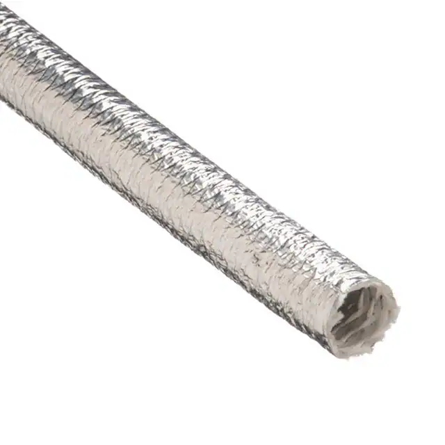

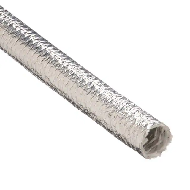

EXTREME TEMPERATURE Technical Data Sheet ADVANCED ENGINEERING Technical Data Sheet CONVOLUTED Put-Ups E  conomical And Easy To Install C  uts Easily With Scissors R  eflects Radiant Heat I nsulates Delicate Wires And Components R  esists Gasoline And Engine Chemicals 4’ Pcs. Put-Ups Nominal Size Part # Wall Thickness ±0.006” Bulk Box Box 8x8 Box 6x6 Box 4x4 Available Colors Lbs/ 10Pcs. 3/8” 1/2” 5/8” 3/4” 7/8” 1” 1 1/4” TCN0.38SV TCN0.50SV TCN0.63SV TCN0.75SV TCN0.88SV TCN1.00SV TCN1.25SV 0.045" 0.045” 0.045” 0.045” 0.045" 0.045” 0.045” 300 250 150 125 100 88 63 80 70 60 50 40 30 20 45 40 35 30 25 20 10 30 25 20 15 12 9 6 Silver Silver Silver Silver Silver Silver Silver 1.0 1.2 1.5 1.8 1.9 2.1 2.3 Reflective Aluminized Surface Bonded to Insulating Fiberglass THERMASHIELD® creates a buffer between your wires, hoses and cables and the high temperature environments they are required to perform in. ThermaShield® is engineered by laminating an aluminum heat shield to a layer of strong fiberglass insulation. This system provides superior protection from radiant heat by reflecting it away from sensitive electronics, wiring and hoses. THERMASHIELD® CONVOLUTED (TCN) is designed to easily slip over wires or hoses, and bend in any direction needed. The seamless construction provides full coverage and protection, and the flexible sleeving cuts easily with scissors. Cut Cleanly Scissor Colors Available: Silver (SV) Material Aluminum Laminated Fiberglass Grade TCN Wall Thickness .045” When applied, the aluminum laminate reflects heat away and the insulating fiberglass backing protects the fragile contents from thermal damage and failure. Drawing Number TF001TT-WD www.techflex.com 1 (833) SLEEVING • (973) 300-9242 • fax: (973) 300-9409 104 Demarest Road • Sparta, NJ 07871 HALOGEN FREE FAR-25 EXTREME ADVANCED ENGINEERING TEMPERATURE Technical Data Sheet Technical Data Sheet CONVOLUTED Melt Point ASTM D-2117 ABRASION Very High Rating______________Non Combustible Will not burn Abrasion Test Machine Calibrase H-18 Abrasion Test Load 500g Mil-I-23053 491°F (255°C) Minimum Continuous -76°F (-60°C) Taber 5150 Abrasion Test Wheel Maximum Continuous CHEMICAL RESISTANCE 1=No Effect 2=Little Effect 3=Affected 4=More Affected 5=Severely Affected Aromatic Solvents_________________ 1 Aliphatic Solvents__________________ 1 Chlorinated Solvents_______________ 1 Weak Bases_______________________ 1 Salts_____________________________ 1 Strong Bases______________________ 1 Salt Water 0-S-1926_________________ 1 Hydraulic Fluid MIL-H-5606__________ 1 Lube Oil MIL-L-7808________________ 1 De-Icing Fluid MIL-A-8243___________ 1 Strong Acids______________________ 2 Strong Oxidants___________________ 2 Esters/Ketones____________________ 1 UV Light_________________________ 1 Petroleum________________________ 1 Fungus ASTM G-21_________________ 1 Halogen Free____________________ Yes RoHS___________________________ Yes PHYSICAL PROPERTIES Flammability Rating__Non Combustible Recommended Cutting________Scissor Colors__________________________ 1 Wall Thickness_________________ .045” © 2021 Techflex® - Any unauthorized reproduction, in whole or part, in any medium whatsoever, without the express written permission of Techflex® is strictly forbidden. Techflex® product names and logos are registered trademarks of Techflex®, unless otherwise attributed. The contents and illustrations contained herein are believed to be reliable. Techflex® makes no warranties as to their accuracy or completeness and disclaims any liability in connection with their use. Techflex’s® only obligations are those in standard terms of sale for these products and Techflex® will not be liable for any consequential or other damages arising due to misuse of these products or typographical errors or omissions. 08-26 Users should make their own evaluation to determine the suitability of these products for their unique and specific applications. www.techflex.com Abrasion Resistance FLAMMABILITY 2,048°F (1,120°C)
