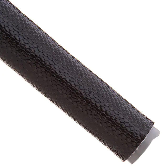

ADVANCED ENGINEERING ELECTRICAL INSULATION Technical Data Sheet Technical Data Sheet Rated to 155°C Class F Acrylic Resin Coated Fiberglass Sleeving Grade A & C UL Recognized ACRYLIC FLEX GLASS (AG) sleeving is a heat-treated, tightly braided fiberglass File# E329693 Grade A (7,000 V) Grade C (2,500 V) Cut and Abrasion Resistant sleeving coated with a dielectric acrylic resin. This durable sleeving will withstand mechanical stress and holds it’s dielectric strength on all bends. Acrylic Flex Glass is used in applications such as relays, radio circuits, transformers, and lead/crossover protection on motors. Highly resistant to acids and solvents, and will withstand tough assembly handling. Sleeving is recommended for thermal requirements from 105°C (221°F) to 155°C (311°F) ranges. Excellent Low Temp. Flexibility -13°F Resists Acids and Most Organic Solvents Colors Available: 4= YL, NT, BK, & RD. Acrylic Resin Coated Flex Glass sleeving has superior mechanical and electrical properties, providing its rated dielectric strength during and after the most severe handling in your application. Cut Cleanly Scissors Material Acrylic Coated Fiberglass Grade A&C Colors Available: Wall Thickness .014” - .040” Yellow (YL), Natural (NT), Black (BK) and Red (RD). www.techflex.com 1 (833) SLEEVING • (973) 300-9242 • fax: (973) 300-9409 104 Demarest Road • Sparta, NJ 07871 ELECTRICAL ADVANCEDINSULATION ENGINEERING Technical Data Sheet Technical Data Sheet Put-Ups Diameter Part# Grade Wall Thickness (Grade A) Part# Grade Wall Thickness (Grade C) Bulk Spool Shop Spool Available Colors 24 22 20 18 16 14 12 11 10 9 8 7 6 5 4 3 2 1 0 3/8” 7/16” 1/2” 5/8” 3/4” 7/8” 1” 0.022” 0.027” 0.034” 0.042” 0.053” 0.066” 0.085” 0.095” 0.106” 0.118” 0.133” 0.148” 0.166” 0.186” 0.208” 0.234” 0.263” 0.294” 0.330” 0.375” 0.438” 0.500” 0.625” 0.750” 0.875” 1.000” AGAG.24 AGAG.22 AGAG.20 AGAG.18 AGAG.16 AGAG.14 AGAG.12 AGAG.11 AGAG.10 AGAG.09 AGAG.08 AGAG.07 AGAG.06 AGAG.05 AGAG.04 AGAG.03 AGAG.02 AGAG.01 AGAG.00 AGA0.38 AGA0.44 AGA0.50 AGA0.63 AGA0.75 AGA0.88 AGA1.00 A A A A A A A A A A A A A A A A A A A A A A A A A A .018” .018” .018” .018” .020” .020” .022” .022” .022” .024” .024” .024” .024” .028” .028” .028” .028” .028” .028” .034” .034” .034” .034” .040” .040” .040” AGCG.24 AGCG.22 AGCG.20 AGCG.18 AGCG.16 AGCG.14 AGCG.12 AGCG.11 AGCG.10 AGCG.09 AGCG.08 AGCG.07 AGCG.06 AGCG.05 AGCG.04 AGCG.03 AGCG.02 AGCG.01 AGCG.00 AGC0.38 AGC0.44 AGC0.50 AGC0.63 AGC0.75 AGC0.88 AGC1.00 C C C C C C C C C C C C C C C C C C C C C C C C C C .014” .014” .014” .014” .016” .016” .017” .017” .017” .019” .019” .019” .019” .023” .023” .023” .023” .023” .023” .030” .030” .030” .030” .038” .038” .038” 500’ 500’ 500’ 500’ 500’ 500’ 250’ 250’ 250’ 250’ 250’ 250’ 250’ 250’ 250’ 250’ 250’ 100’ 100’ 100’ 100’ 100’ 100’ 100’ 100’ 100’ 250’ 250’ 250’ 250’ 250’ 250’ 100’ 100’ 100’ 100’ 100’ 100’ 100’ 100’ 100’ 100’ 100’ 50’ 50’ 50’ 50’ 50’ 50’ 50’ 50’ 50’ YL,NT,BK,RD YL,NT,BK,RD YL,NT,BK,RD YL,NT,BK,RD YL,NT,BK,RD YL,NT,BK,RD YL,NT,BK,RD YL,NT,BK,RD YL,NT,BK,RD YL,NT,BK,RD YL,NT,BK,RD YL,NT,BK,RD YL,NT,BK,RD YL,NT,BK,RD YL,NT,BK,RD YL,NT,BK,RD YL,NT,BK,RD YL,NT,BK,RD YL,NT,BK,RD YL,NT,BK,RD YL,NT,BK,RD YL,NT,BK,RD YL,NT,BK,RD YL,NT,BK,RD YL,NT,BK,RD YL,NT,BK,RD RATE OF BURNING Conforms with requirements of NEMA TF-1, MIL-I-003190/3, and ASTM D372. CHEMICAL RESISTANCE Resistant to oils, acids, alkalies and most organic solvents. After more than 168 hours in the most commonly used aromatics, xylene and toluene, the dried sleeving substantially regains its original properties. LOW TEMPERATURE Bends without cracking at -25°C/-13°F. © 2021 Techflex® - Any unauthorized reproduction, in whole or part, in any medium whatsoever, without the express written permission of Techflex® is strictly forbidden. Techflex® product names and logos are registered trademarks of Techflex®, unless otherwise attributed. The contents and illustrations contained herein are believed to be reliable. Techflex® makes no warranties as to their accuracy or completeness and disclaims any liability in connection with their use. Techflex’s® only obligations are those in standard terms of sale for these products and Techflex® will not be liable for any consequential or other damages arising due to misuse of these products or typographical errors or omissions. 06-21 Users should make their own evaluation to determine the suitability of these products for their unique and specific applications. www.techflex.com Nominal Size

1. 物料型号:AGAG.24至AGA1.00,以及AGA0.38、AGA0.44、AGA0.50、AGA0.63、AGA0.75、AGA0.88和AGA1.00,分别对应不同的标称尺寸。
2. 器件简介:ACRYLIC FLEX GLA55套管是一种经过热处理、紧密编织的玻璃纤维套管,涂覆有电介质丙烯酸树脂。这种耐用的套管能够承受机械应力,并在所有弯曲处保持其介电强度。
3. 引脚分配:文档中没有提及具体的引脚分配信息,因为它是关于套管产品的。
4. 参数特性: - 耐温等级:Grade A (7,000 V) 和 Grade C (2,500 V) - 耐温范围:105°C (221°F) 至 155°C (311°F) - 壁厚:Grade A的壁厚从.018"到.040",Grade C的壁厚从.014"到.038"
5. 功能详解:该套管用于继电器、无线电电路、变压器以及电机的导线/交叉保护等应用。它高度耐酸和溶剂,能够承受严格的组装处理。
6. 应用信息:适用于需要耐酸和大多数有机溶剂的场合,以及在-25°C/-13°F的低温下不破裂的应用。
7. 封装信息:提供Bulk Spool(大盘卷)和Shop Spool(小盘卷)两种包装方式,颜色有黄色(YL)、自然色(NT)、黑色(BK)和红色(RD)。
8. 其他特性:符合NEMA TF-1、MIL-I-003190/3和ASTMD372的燃烧要求,耐油、酸、碱和大多数有机溶剂。
