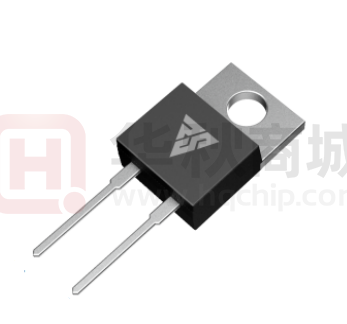

    TO-220-2
    肖特基二极管 VR=650V IF=29A IR=100μA CT=440pF TO220-2
RSS10065A 数据手册
RSS10065A Silicon Carbide Schottky Diode VRRM IF ( TC≤135℃) QC 650V 15A 30nC Applications: • Switch Mode Power Supplies • Power Factor Correction • Motor drive, PV Inverter, Wind Power Station Features: • Zero Reverse Recovery Current • Zero Forward Recovery Voltage • Positive Temperature Coefficient on VF • Temperature-independent Switching • 175°C Operating Junction Temperature Benefits: • Replace Bipolar with Unipolar Device • Reduction of Heat Sink Size • Parallel Devices Without Thermal Runaway • Essentially No Switching Losses Ordering Information Part Number Package Marking Packing Qty. RSS10065A TO-220-2 RSS10065A Tube 50 PCS www.reasunos.com 1 /6 Copyright Reasunos RSS10065A Silicon Carbide Schottky Diode Maximum Ratings(TJ= 25℃ unless otherwise specified) Symbo Parameter l Valu e Unit Test Conditions VRRM Repetitive Peak Reverse Voltage 650 V TC = 25℃ VRSM Surge Peak Reverse Voltage 650 V TC = 25℃ VR DC Blocking Voltage 650 V TC = 25℃ IF Forward Current 32 15 10 A IFSM Non-Repetitive Forward Surge Current 96 83 A IFRM Repetitive Peak Forward Surge Current 85 A Ptot Power Dissipation 127 W TC Maximum Case Temperature 154 ℃ TJ,TST G Operating Junction and Storage Temperature -55 to17 5 ℃ Not e TC ≤ 25℃ TC ≤ 135℃ TC ≤ 154℃ TC = 25℃, tp = 10ms, Half Sine Wave TC = 110℃, tp = 10ms, Half Sine Wave TC = 25℃, tp = 10ms, Half Sine Wave TC = 25℃ Fig. 3 Fig. 4 Electrical Characteristics (TJ= 25℃ unless otherwise specified) Symbo Parameter l Typ. VF Forward Voltage 1.37 1.66 Max . 1.6 - IR Reverse Current 5 12 60 - C Total Capacitance 455 57 56 QC Total Capacitive Charge 30 Ec Capacitance Stored Energy 4.8 Unit Test Conditions Note IF = 10A, TJ = 25℃ IF = 10A, TJ = 175℃ Fig.1 µA VR = 650V, TJ = 25℃ VR = 650V, TJ = 175℃ Fig.2 / pF VR = 1V, TJ = 25℃, f = 1MHz VR = 200V, TJ = 25℃, f = 1MHz Fig.5 VR = 400V, TJ = 25℃, f = 1MHz / nC VR =400V, Fig.6 uJ VR =400V, Fig.7 V Thermal Characteristics (TJ= 25℃ unless otherwise specified) Symbol Parameter Typ. Unit Note RθJC Thermal Resistance from Junction to Case 1.175 ℃/W Fig.8 www.reasunos.com 2 /6 Copyright Reasunos RSS10065A Silicon Carbide Schottky Diode Typical Feature Curve www.reasunos.com 3 /6 Copyright Reasunos RSS10065A Silicon Carbide Schottky Diode www.reasunos.com 4 /6 Copyright Reasunos RSS10065A Silicon Carbide Schottky Diode Package outline drawing(TO-220 Unit: mm ) www.reasunos.com 5 /6 Copyright Reasunos RSS10065A Silicon Carbide Schottky Diode Disclaimers: Reasunos Semiconductor Technology Co.Ltd (Reasunos) reserves the right to make changes without notice in order to improve reliability,function or design and to discontinue any product or service without notice .Customers should obtain the latest relevant information before orders and should verify that such information in current and complete.All products are sold subject to Reasunos's terms and conditions supplied at the time of orderacknowledgement. Reasunos Semiconductor Technology Co.Ltd warrants performance of its hardware products to the speciffications at the time of sale.Testing,reliability and quality control are used to the extene Reasunos deems necessary to support this warrantee. Except where agreed upon by contr- actual agreement,testing of all parameters of each product is not necessarily performed. Reasunos Semiconductor Technology Co.Ltd does not assume any liability arising from the use of any product or circuit designs described herein.Customers are responsible for their products and applications using Reasunos's components.To minimize risk,customers must provide adequate design and operating safeguards. Reasunos Semiconductor Technology Co.Ltd does not warrant or convey any license eith- er expressed or implied under its patent rights,nor the rights of others.Reproduction of inform- ation in Reasunos's data sheeets or data books is permissible only if reproduction is without modification oralteration.Reproduction of this information with any alteration is an unfair and deceptive business practice. Reasunos Semiconductor Technology Co.Ltd is not responsi- ble or liable for such altered documentation. Resale of Reasunos's products with statements different from or beyond the parameters stated by Reasunos Semiconductor Technology Co.Ltd for that product or service voids all exp- ress or implied warrantees for the associated Reasunos's product or service and is unfair and deceptive business practice. Reasunos Semiconductor Technology Co.Ltd is not responsi- ble or liable for such statements. Life Support Policy: Reasunos Semiconductor Technology Co.Ltd's Products are not authorized for use as cri- tical components in life support devices or systems without the expressed written approval of Reasunos Semiconductor Technology Co.Ltd. As used herein: 1. Life support devices or systems are devices or systems which: a.are intended for surgical implant into the human body, b.support or sustain life, c.whose failuer to when properly used in accordance with instructions for used provided in the laeling,can be reasonably expected to result in significant injury to the user. 2.A critical component is any component of a life support device or system whose failure to system whose failure to perform can be reasonably expected to cause the failure of the life support device or system,or to affect its safety or effectiveness. www.reasunos.com 6 /6 Copyright Reasunos
