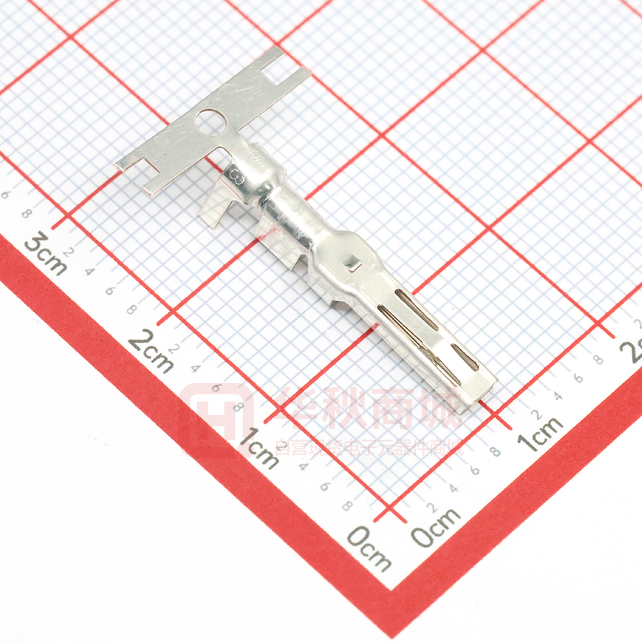

    该连接器专为线对线和线对板连接设计,间距为6.2mm,可承受高达20A的大电流(1或2路,线径3.5mm2)。二次固定器可防止触点插入不足和脱落,能确保大电流电路连接安全可靠。
SVM-61T-P2.0 数据手册
VL CONNECTOR 6.2mm pitch/Disconnectable Crimp style Wire-to-wire connectors (Combined use for both wire-to-wire and wire-to-board connections) Specifications ––––––––––––––––––– This VL connector is 6.2 mm pitch wire-to-wire and wire-to-board connector, designed for large current up to 20 A (1 or 2-circuit with 3.5 mm2 wire). Secondary retainer, which prevents from insufficient insertion of contact and coming off contact, may use and large current circuit can be connected certainly and safety. • Housing lances • Retainer • Suited for large carrent • Panel lock Standards –––––––––––––––––––– 0 Recognized E60389 1 Certified LR20812 2R9351103 • Current rating: 20 A AC, DC max. (Refer to the following table.) • Voltage rating: 600 V AC, DC max. • Temperature range: -25˚C to +90˚C (including temperature rise in applying electrical current) • Contact resistance: Initial value/ 7 mΩ max. After environmental tests/ 10 mΩ max. • Insulation resistance: 1,000 MΩ min. • Withstanding voltage: 2,000 VAC/minute • Applicable wire: AWG #22 to #12 0.3 to 3.5 mm2 • Applicable panel thickness: 0.5 to 2.0 mm * In using the products, refer to "Handling Precaution for Terminal and Connector" described on our website (Technical documents of Product information page). * Contact JST for details. * RoHS2 compliance Note: The current rating varies depending on the number of circuits and the wire size used in each connector. The table below lists the current rating as a function of the number of circuits and the wire size. Current unit: A No. of circuits 1 2 3 4 6 8 12 #12 #14 20 20 19 18 16 16 15 15 15 14 13 12 11 10 Wire size (AWG) #16 #18 10 10 9 9 8 7 7 #20 #22 6 6 6 6 5 5 4 4 4 4 4 3 3 3 8 8 8 7 7 6 6 Inner-housing lock Inner-housing lock 12.2 19.3 (including retainer) Panel layout and Assembly layout 40.5 40.5 44.1 (including retainer) 44.1 (including retainer) Outer-housing lock 14.6 21.7 (including retainer) Outer-housing lock 40.5 40.5 44.1 (including retainer) 44.1 (including retainer) Shape I Shape II 9.8±0.13 B 18.6±0.13 C E D 2 12.2±0.13 C E A 0.5±0.13 4.2±0.13 No. of circuits D 9.8 ±0.13 3 4 4 (Single-row) 6 A 8 B 12 Receptacle housing Model No. VLR-02V VLR-03V VLR-04V VLR-04VN VLR-06V VLR-08V VLR-12V Note: 1. Punch holes in the panel according to the figures and table shown above. Burrs must be removed. 2. The strength of the panel must be considered when punching two or more holes. 3. The connector must be inserted from the same side as the hole is punched. 1 Panel hole dimensions (mm) General tolerance Panel hole shape A B C D E 1 13.8 20.6 5.7 8.5 1.4 1 20.0 26.8 5.7 8.5 1.4 2 13.8 20.6 7.0 15.4 4.2 1 26.2 33.0 5.7 8.5 1.4 2 20.0 26.8 7.0 15.4 4.2 2 26.2 33.0 7.0 15.4 4.2 2 38.9 45.4 7.0 15.4 4.2 A, B, D: 0.13 C, E: 0.1 Applicable panel thickness (mm) 0.5∼2.0 VL CONNECTOR Contact Applicable wire mm2 AWG # Model No. Pin contact Socket contact Pin contact SVF-42T-P2.0 SVM-61T-P2.0 SVF-61T-P2.0 SVM-81T-P2.0 SVF-81T-P2.0 4.1 3.2 TSJ 22.2 3.6 2 0.3∼1.25 22∼16 1.7∼3.2 0.3+0.3∼ 0.5+0.75 22+22∼ 20+18 1.7+1.7∼ 2.5+2.7 0.5∼2.0 20∼14 1.9∼3.4 0.5+0.5∼ 0.75+1.25 20+20∼ 18+16 1.9+1.9∼ 2.1+2.7 3.5 12 4.1 Q'ty/ reel 2,000 3.1 1.7 SVM-42T-P2.0 Insulation O.D. (mm) 2 Material and Finish Phosphor bronze, tin-plated (reflow treatment) Socket contact 4.1 TSJ RoHS2 compliance Note: Contact JST for special products. SVM-42T-P2.0 16.7 3.6 2 1.7 − SVM-61T-P2.0 MKS-L AP-K2N Crimp applicator with dies MK/SVF/M-42-20 APLMK SVF/M42-20 MKS-L SVF-42T-P2.0 SVF-61T-P2.0 3.1 Applicator Dies Crimping machine Crimp applicator Contact − − MK/SVF/M-61-20 APLMK SVF/M61-20 − − − SVM-81T-P2.0 MKS-L SVF-81T-P2.0 − MK/SVF/M-81-20 APLMK SVF/M81-20 − − Note: Contact JST for fully automatic crimping applicator. Contact position location numbers Retainer Retainer Contact position numbers are stamped Receptacle housing Plug housing Receptacle housing 5 4 9 3 8 2 7 1 12 11 10 9 8 7 L JST 10 1 5 L JST 11 2 6 L JST 4 3 2 1 6 12 L JST 1 4 1 8 7 6 5 3 7 2 2 1 6 3 5 2 4 1 4 3 5 L JST 1 3 1 L JST 6 3 2 L JST L JST 4 2 3 1 8 4 2 4 3 2 1 3 2 1 2 1 4 3 2 1 6 5 4 3 2 1 Plug housing L JST 3 2 4 2 4 1 3 L JST 4 3 2 1 12 11 8 7 9 L JST 10 5 4 3 8 7 6 5 2 L JST 6 1 5 L JST 4 3 2 1 1 8 7 4 3 3 6 2 5 1 4 2 6 5 3 4 L JST 12 11 10 9 8 7 2 10 9 8 1 7 L JST 6 5 4 3 2 1 1 12 11 6 5 4 3 5 8 7 6 5 2 8 7 6 L JST 3 4 5 4 2 1 6 3 2 1 L JST 3 6 2 5 1 4 4 3 2 1 6 1 1 1 3 2 3 2 1 3 L JST 2 1 2 L JST 2 L JST 4 2 2 4 1 3 1 1 3 2 JST 2 1 1 3 3 2 1 L 2 L JST 1 1 4 L JST 6 5 4 3 2 1 12 11 10 9 8 7 L JST 2 VL CONNECTOR Housing Material: Housing...PA 66, UL94V-0, white Retainer...Glass-filled PA 66, UL94V-0, ivory No. of Voltage Current rating circuits rating Receptacle housing (for pin contact) 20A Q'ty/ bag VLS-01V Q'ty/ bag 500 9.2 3 Q'ty/ bag 11 2.8 7.3 VLP-02V Q'ty/ bag L JST 13.4 2 L JST 13.4 1,000 500 9.4 2 3.4 VLR-02V 13 29.5 6.2 600V VLP-01V 7.2 1 Q'ty/ bag Retainer 7.2 VLR-01VF (Without panel lock product) Plug housing (for socket contact) 9.4 VLS-02V (commonly used for 2-circuit housing and 4-circuit housing) Q'ty/ bag 1 1 13 20A 8.2 11 2.8 8.4 29.5 3 500 VLP-02V-1 500 9.4 1 L JST 15 L JST 2 13.4 1,000 5.9 2 VLR-02VF (Without panel lock product) 11.4 600V 3.4 2 1 8.2 13 29.5 3 Q'ty/ bag 5.2 8.4 Q'ty/ bag VLP-03V Q'ty/ bag 2 JST 1 L 3.4 VLS-03V (commonly used for 3-circuit housing and 6-circuit housing) 19.6 3 VLR-03V 11 3 11 2.8 8.4 VLP-03V-1 500 1,000 29.5 19.6 3 5.9 9.4 1 8.2 2 L JST 3.4 3 1 500 17.6 19A 2 L JST 600V 19.6 13 3 13 5.2 8.4 VLP-04V Q'ty/ bag VLS-02V Q'ty/ bag 3 1 13.4 2 4 13.4 2 4 Q'ty/ bag 3.4 VLR-04V 11 1 3 L JST L JST 2.8 15.4 11.4 3 15 11 29.5 500 VLP-04V-1 500 3 13.4 1 L JST 1 L JST 15 3 13 29.5 VLR-04VN 5.2 15.4 VLP-04VN-1 Q'ty/ bag VLS-08V (commonly used for 4-circuit housing and 8-circuit housing) 500 Q'ty/ bag 4 3.4 Q'ty/ bag 11 23.8 18A 3 600V 9.4 15 2 4 4 1,000 5.9 2 VLR-04VF (Without panel lock product) 4 3.4 13 25.8 2 L JST 25.8 3 L JST 3 4 2 500 3.4 1 1 13 8.2 3 RoHS2 compliance Note: 1. Contact JST for special products. 2. Contact JST for Glow Wire compliant connectors. 3 29.5 11 5.2 8.4 5.9 9.4 1,000 VL CONNECTOR Housing Material: Housing...PA 66, UL94V-0, white Retainer...Glass-filled PA 66, UL94V-0, ivory Voltage rating Current rating Receptacle housing (for pin contact) VLR-06V Plug housing (for socket contact) VLP-06V Q'ty/ bag 5 VLS-03V (commonly used for 3-circuit housing and 6-circuit housing) Q'ty/ bag 4 1 3.4 2 6 3 Q'ty/ bag Retainer 19.6 No. of circuits L JST 2.8 15.4 17.6 19.6 11 2 16A 5 600V 3 6 6 13 500 VLP-06V-1 500 1,000 1 4 6 5.9 9.4 1 4 5 29.5 2 3 15 19.6 3.4 3 L JST 13 L JST 15.4 VLP-08V Q'ty/ bag 7 VLS-08V (commonly used for 4-circuit housing and 8-circuit housing) 6 1 5 2 3.4 L JST 3 8 Q'ty/ bag 4 Q'ty/ bag 5.2 25.8 VLR-08V 11 L JST 4 8 25.8 16A 15.4 L JST 600V 2.8 3 7 8 11 23.8 13 6 2 100 200 VLP-08V-1 1,000 1 5 7 5.9 L JST 29.5 9.4 1 5 2 6 3 15 25.8 3 3.4 4 8 L JST 13 L JST 15.4 VLP-12V 11 10 5 8 9 L JST 4 2 3 3.4 7 1 L JST 11 2.8 36.2 3 15.4 100 VLP-12V-1 1,000 100 2 8 12 11 5.9 10 29.5 8 2 RoHS2 compliance Note: 1. Contact JST for special products. 2. Contact JST for Glow Wire compliant connectors. 11 5.2 7 1 13 9.4 9 L JST 4 3 3 15 38.2 3.4 6 1 7 5 38.2 4 9 13 L JST 10 15A 5 11 600V Q'ty/ bag 6 12 12 VLS-12V 12 Q'ty/ bag 6 Q'ty/ bag 5.2 38.2 VLR-12V 11 15.4 4
