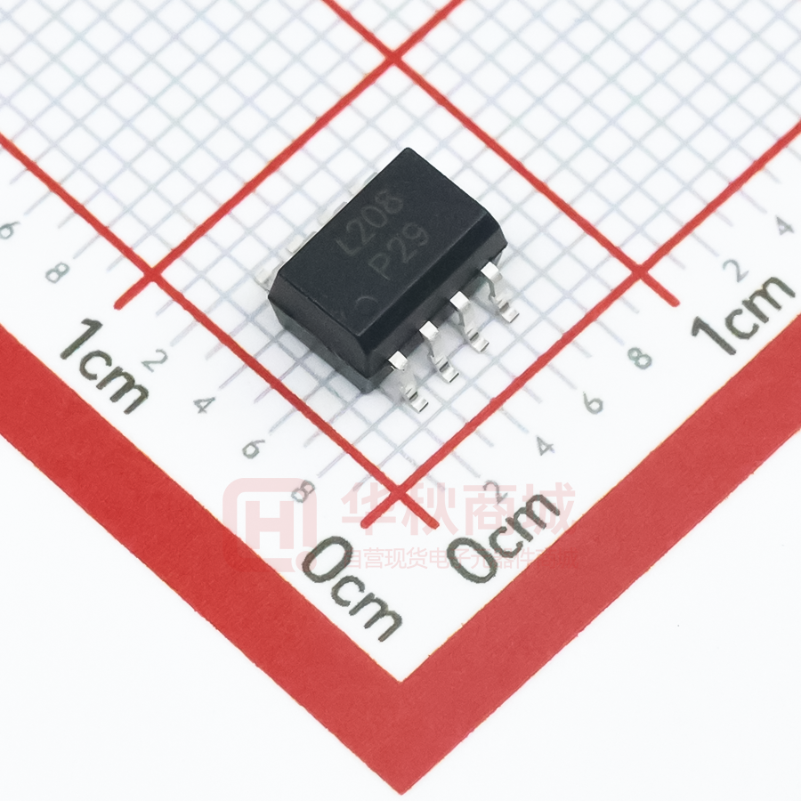

LI TE-O N TEC H N O LO G Y C O RP O R ATI O N
Property of Lite-on Only
LTV-200/205/206/207/208
Optocouplers, Phototransistor Output, Dual Channel,
SOP8 Package
Description
The LTV-200/205/206/207/208 are consist
of a high efficient Gallium Arsenide Infrared
LED and a Silicon NPN phototransistor. This
design provides excellent isolation between
the input and output sides of the
Optocoupler.
Features
The LTV-200/205/206/207/208 come in a
standard SOP8 small outline package for
surface mounting which makes it ideally
suited for high density application with
limited space.
A Specific CTR range allows a narrow
tolerance in the electrical design of the
adjacent circuits.
Two Channel Coupler
SOP8 surface mountable Package
Isolation Voltage 3.75KV
UL, CSA in progress
Application
Functional Diagram
Feedback Control Circuits
Feedback element in switching
mode power supplier
Monitor & Detection Circuits
Order Information
P/N
Part No. : LTV-200 / 205 / 206 / 207 / 208
BNS-OD-C131/A4
Remarks
LTV-200
CTR > 20%, SOP8
LTV-205
CTR 40-80%, SOP8
LTV-206
CTR 63-125%, SOP8
LTV-207
CTR 100-200%, SOP8
LTV-208
CTR 160-320%, SOP8
Page : 1
