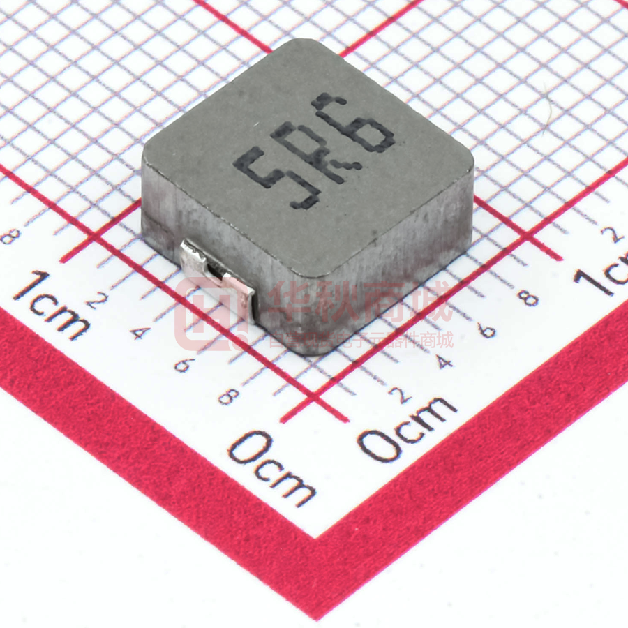

    SMD,8.8*8.2*3.8mm(0804) 电感值:5.6µH 精度:±20% 额定电流:9A 饱和电流:11A 直流电阻(DCR):30mΩ 合金电感/一体成型电感/大电流
FXL0840-5R6-M 数据手册
深圳市长江微电科技有限公司 SZ CJIANG TECHNOLOGY CO.,LTD Introduction • ROHS,Halogen Free and REACH compliance • High rated current • 125℃ maximum total temperature operation • 9.2×8.5×4.0mm maximum surface mount package . • Low core loss • Ultra low buzz noise due to molding construction Applications • Laptops and PCs • Switch and servers • Base stations • DC/DC converters • Battery powered devices • SSD modules Product Identification FXL ① 0840 ② -R22 ③ -M ④ ① FXL ---------- Series name ② 0840 ---------- Dimension ③ R22----------- Inductance Value (R22 = 0.22μH) ④ M -----------Inductance Tolerance ( M= ± 20% ) Dimensions-mm A C b E B c D a Recommend Land Pattern A B C D E a typ b typ c typ 8.8±0.4 8.2±0.3 3.8±0.2 1.4±0.3 5.0±0.3 4 9.5 5.5 深圳市长江微电科技有限公司 SZ CJIANG TECHNOLOGY CO.,LTD Marking The inductor is marked with a 3-digit code Nominal Inductance Example Nominal Value 1R0 1.0 μH 100 10 μH 101 100 μH Note:Using Ink for marking 1R0 Structure and Components Symbol Components Material a MARKING Ink(black) b CORE Alloy Sponge Powder c WIRE Polyurethane copper wire d Terminal Copper plated with Sn 深圳市长江微电科技有限公司 SZ CJIANG TECHNOLOGY CO.,LTD Specification Heating Rating Inductance DC Resistance Saturation Current L0 (μH) DCR (mΩ) Isat (A) Irms (A) ±20 %, 100 kHz, 1V MAX. Typ(Max) Typ(Max) FXL0840-R22-M 0.22 1.8 60(55) 36(30) FXL0840-R33-M 0.33 2.4 45(40) 30(25) FXL0840-R47-M 0.47 2.8 42(36) 28(25) FXL0840-R56-M 0.56 3.2 26(23) 24(22) FXL0840-R68-M 0.68 3.8 24(22) 23(21) FXL0840-R82-M 0.82 4.4 21(19) 21(19) FXL0840-1R0-M 1.0 4.62 19(17) 19(17) FXL0840-1R5-M 1.5 7.6 17(15) 17(15) FXL0840-1R8-M 1.8 11 15(13.5) 15(12.5) FXL0840-2R2-M 2.2 11.4 14(12) 14(12) FXL0840-3R3-M 3.3 15 12.5(11) 12(10) FXL0840-4R7-M 4.7 26.5 11.5(10.5) 9.5(8.5) FXL0840-5R6-M 5.6 30 11(10) 9(8.0) FXL0840-6R8-M 6.8 36.8 9(8.0) 8(7.0) FXL0840-8R2-M 8.2 46 8.7(7.7) 7(6.0) FXL0840-100-M 10.0 59 8(7.0) 6.5(5.5) FXL0840-150-M 15.0 71 5.5(4.9) 5.4(4.8) FXL0840-220-M 22.0 113 5(4.5) 4.8(4.2) FXL0840-330-M 33.0 156 3.5(3.3) 3.5(3.0) FXL0840-470-M 47.0 225 3.1(2.9) 2.9(2.5) Part No. Current Notes 1. All test data is referenced to 25 °C ambient 2. Operating temperature range - 55 °C to + 125 °C 3. Irms (A):DC current (A) that will cause an approximate ΔT of 40 °C(reference ambient temperature is 25 °C) 4. Isat(A):DC current (A) that will cause L0 to drop approximately 30 % 5. The part temperature (ambient + temp rise) should not exceed 125 °C under worst case operating conditions. Circuit design, component placement, PWB trace size and thickness, airflow and other cooling provisions all affect the part temperature. Part temperature should be verified in the end application. 深圳市长江微电科技有限公司 SZ CJIANG TECHNOLOGY CO.,LTD Mechanical Reliability Item Specification and Requirement 1. No case deformation or change in apperarance Solderability 2. New solder coverage Test Method 1.Preheat:155℃±5℃ ,60S±2S 2.Tin: lead-free. 3.Temperature:240℃±5℃,flux 3.0S±0.5S. More than 95% Mechanical 1. No case deformation 1. Acceleration: 100G or change in apperarance 2. Pulse time::6ms shock 3. 3 times in each positive and negative direction of 3 2. △L/Lo≦±10% 1. No case deformation Mechanical or change in apperarance vibration 2. △L/Lo≦±10% mutual perpendicular directions 1. Reflow: 2times 2. Frequency: 10HZ~55HZ~10HZ,20 Min/Cycles 3. Amplitude: 1.52 mm 4. Directions: X,Y,Z 5. Time: 12 cycle / direction Endurance Reliability Item Specification and Requirement Inductance change: Thermal Shock Within ± 10% Without distinct damage in appearance Test Method 1. First -55℃ for 30 minutes,last 125℃ for 30 minutes as 1 cycle. Go through 1000 cycles. 2. Max transfer time is 3 minutes. 3. Measured at room temperature after placing for 24±2 hours Humidity Resistance Inductance change: 1.Reflow 2 times, Within ± 10% Without distinct damage 2.85℃,85%RH,1000 hours in appearance 3.Measured at room temperature after placing for 24±2 hours Low temperature storage High temperature storage Inductance change: 1. Temperature:-55 ± 2℃ Within ± 10% Without distinct damage 2. Time:1000 hours in appearance 3. Measured at room temperature after placing for 24±2 hours Inductance change: Within ± 10% Without distinct damage in appearance 1. Temperature:+125 ± 2℃ 2. Time:1000 hours 3. Measured at room temperature after placing for 24±2 hours 深圳市长江微电科技有限公司 SZ CJIANG TECHNOLOGY CO.,LTD Recommended Soldering Technologies (1)Re-flowing Profile Preheat condition: 150 ~200℃/60~120sec. Allowed time above 217℃: 60~90sec. Max temp: 260℃ Max time at max temp: 10 sec. Solder paste: Sn/3.0Ag/0.5Cu Allowed Reflow time: 2x max (2)Iron Soldering Profile Iron soldering power: Max. 30W Pre-heating: 150℃/60sec. 3sec. Max. 350℃ Soldering Tip temperature: 350℃ Max. Power: max. 30W Soldering time: 3sec. Max. Diameter of Soldering Solder paste: Sn/3.0Ag/0.5Cu Max.1 times for iron soldering Soldering Iron Iron 1.0mm max. Tc ℃ 深圳市长江微电科技有限公司 SZ CJIANG TECHNOLOGY CO.,LTD Packaging Information (1) Tape Packaging Dimensions(Unit:mm) Type FXL0840 Tape dimensions (mm) W P P0 P2 D0 D1 T A0 B0 K0 E F 24 ±0.3 16 ±0.1 4 ±0.1 2 ±0.1 1.55 ±0.1 1.55 ±0.1 0.35 ±0.05 8.9 ±0.1 10.1 ±0.1 4.4 ±0.1 1.75 ±0.1 11.5 ±0.1 Taping Drawings (UNIT:mm) 深圳市长江微电科技有限公司 SZ CJIANG TECHNOLOGY CO.,LTD (2) Reel Dimensions(Unit:mm) B N W C A W N B C 330+2.0 24±0.5 97±0.5 2.2+0.5 13.0±0.2 (3) Packaging Quantity Standard Quantity Type FXL0840 Reel Inner box 800 pcs / reel 2Reel / box (1600 pcs) (4) Peel force of top cover tape The peel speed shall be about 300mm/minute The peel force of top cover tape shall be between 0.1 to 1.3 N Carton box 4 Middle boxes, (6400 pcs) A 深圳市长江微电科技有限公司 SZ CJIANG TECHNOLOGY CO.,LTD (5) Reel Label Label on the reel • Customer's part Number • Lot Number • Quantity • date code Shipping Label • Customer's part Number • Manufacturer's part Number • Quantity • date code (6) Inner Box (7) Carton A B C
