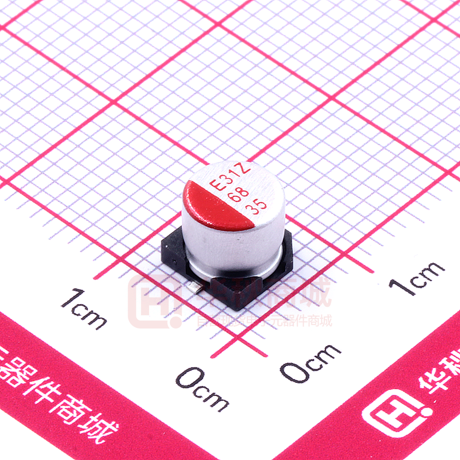

    贴片铝电解电容 SMD,D6.3xL6mm 68µF ±20% 35V 2000Hrs@105℃
SVZ1VM680E06E00RAXXX 数据手册
CONDUCTIVE POLYMER ALUMINUM SOLID CAPACITORS VZ series Endurance: +105°C 2,000 hours Standard substance Recommended Applications: Display Card & System Board RoHS Compliant and lead-free SPECIFICATIONS Items Characteristics Category Temperature Range -55~+105°C Rated Working Voltage Range 2.5~100 V dc Nominal Capacitance Range 22~2200µF Capacitance Tolerance ±20%(M) (at 20°C,120Hz) I≤0.2CV or 500μA, whichever is greater. Where, I:Max.leakage current (µA),C:Nominal capacitance (µF),V: Rated voltage (V) DC Leakage Current 2.5 Rated Voltage(V dc ) Dissipation Factor (tanδ) 6.3 10 16 25 0.08 tanδ (max.) ESR(100kHz,20°C) Value in characteristics table Temperature Characteristic (Impedance Ratio at 100kHz) Z(+105°C)/Z(+20°C)≤1.25 Z(-55°C)/Z(+20°C)≤1.25 35 (at 20°C after 2 minutes) 50 63 (at 20°C,120Hz) 0.12 After applying rated voltage for 2,000 hours at 105°C, the capacitors shall meet the following requirements. Endurance Appearance No significant damage Capacitance Change ≤±20% of the initial value D.F. (tanδ) ≤150% of the initial specified value ESR ≤150% of the initial specified value Leakage Current ≤The initial specified value After subjecting to 90~95% RH for 2,000 hours at 60°C without voltage applied, the capacitors shall meet the specified values for the Endurance characteristics listed above. Humidity Test After subjecting to 1,000 cycles each consisting of charge with the surge voltage specified at normal temperature for 30 seconds through a protective resistor and discharge for 5 minutes 30 seconds, the capacitors shall meet the following requirements. Surge Test Appearance No significant damage Capacitance Change ≤ ± 20% of the initial value D.F. (tanδ) ≤150% of the initial specified value ESR ≤150% of the initial specified value Leakage Current ≤The initial specified value *Note: If any doubt arises, measure the leakage current after the following voltage treatment. Voltage treatment: DC rated voltage is applied to the capacitors for 120 minutes at 105°C. DIMENSIONS[mm] D 6.3 8 10 P±0.2 A±0.2 B±0.2 C±0.2 W ØD' L' 1.9 3.1 4.5 6.6 6.6 7.2 0.5~0.8 8.3 8.3 9.0 0.7~1.1 10.3 10.3 11.0 0.7~1.1 ØD-0.1~+0.5 L±0.5 ØD-0.1~+0.5 L±0.3 ØD-0.1~+0.5 L±0.3 PART NUMBERING SYSTEM S V Z 0 J M 2 7 1 E 0 6 E 0 0 R A X X X Special code Marking code Terminal code Size code Capacitance code Capacitance tolerance code Voltage code Series code Category code 59 CONDUCTIVE POLYMER ALUMINUM SOLID CAPACITORS VZ series VDC (SV) 2.5 (2.9) 6.3 (7.2) Cap (µF) 330 390 470 560 680 220 270 330 470 560 1000 1500 2200 120 220 330 10 (11.5) 470 560 1000 1500 47 68 100 150 180 16 (18.4) 220 270 330 560 680 1000 22 27 47 56 68 25 (28.8) 100 150 220 330 470 560 680 22 27 33 47 68 35 (40.3) 100 150 220 270 330 470 22 33 47 68 50 (57.5) 82 100 120 150 220 Size ΦDxL(mm) 6.3×6 6.3×6 6.3×6 6.3×6 6.3×9 6.3×6 6.3×6 6.3×6 6.3×9 6.3×9 8×11.5 8×11.5 10×12.5 6.3×6 6.3×6 6.3×9 6.3×9 6.3×9 8×9.5 8×11.5 10×12.5 8×11.5 10×12.5 10×12.5 6.3×6 6.3×6 6.3×6 6.3×6 6.3×9 6.3×6 6.3×9 6.3×9 6.3×9 8×9.5 6.3×9 8×11.5 10×12.5 8×11.5 10×12.5 10×12.5 6.3×6 6.3×6 6.3×6 6.3×9 6.3×6 6.3×6 6.3×9 6.3×6 6.3×9 6.3×9 8×11.5 10×12.5 8×11.5 8×11.5 10×12.5 10×12.5 10×12.5 6.3×6 6.3×6 6.3×6 6.3×9 6.3×6 6.3×6 6.3×9 6.3×9 8×9.5 8×11.5 8×11.5 8×11.5 8×11.5 10×12.5 10×12.5 10×12.5 6.3×6 6.3×6 6.3×9 8×11.5 10×12.5 8×11.5 8×11.5 10×12.5 8×11.5 10×12.5 10×12.5 ESR (mΩ,20°C,100kHz) (max.) Rated ripple current (mArms/105°C,100kHz) Leakage Current (µA)(max.) Part Number 20 20 20 20 15 20 20 20 15 15 15 15 15 30 30 20 20 30 22 20 20 15 15 15 40 40 30 30 25 60 25 25 25 25 25 20 20 20 20 20 80 50 50 35 50 50 30 50 30 30 30 22 30 30 22 22 22 60 60 60 50 45 45 40 40 40 30 30 30 30 30 30 30 80 80 60 30 30 30 30 30 30 30 30 2700 2800 2900 3000 4300 2800 3000 2100 3500 3700 4300 4400 5600 2700 2700 3000 3100 3400 3400 3600 5000 4200 4400 4400 1700 2000 2400 2400 2600 2500 2700 2500 2600 2800 2600 4000 5000 3500 4000 4100 1600 1100 1800 2000 1800 1800 2400 2100 2500 2500 2600 2800 2700 2800 3100 3300 3300 1100 1100 1100 1500 1100 1100 1800 2100 2800 3000 3000 2400 2500 2700 2700 3000 800 850 1400 2000 2000 2000 2000 2100 2000 2100 2300 500 500 500 500 500 500 500 500 592 706 1260 1890 2772 500 500 500 660 940 940 1120 1120 2000 2000 3000 500 500 500 500 500 576 576 704 864 864 1056 1056 1056 1792 2176 3200 500 500 500 500 500 500 500 500 750 1100 1100 1650 500 2350 2350 2800 3400 500 500 500 500 500 500 500 700 700 700 1050 1540 1890 1890 2310 3290 500 500 500 680 820 820 1000 1000 1200 1500 2200 SVZ0EM331E06E00RAXXX SVZ0EM391E06E00RAXXX SVZ0EM471E06E00RAXXX SVZ0EM561E06E00RAXXX SVZ0EM681E09E00RAXXX SVZ0JM221E06E00RAXXX SVZ0JM271E06E00RAXXX SVZ0JM331E06E00RAXXX SVZ0JM471E09E00RAXXX SVZ0JM561E09E00RAXXX SVZ0JM102FBRE00RAXXX SVZ0JM152FBRE00RAXXX SVZ0JM222GCRE00RAXXX SVZ1AM121E06E00RAXXX SVZ1AM221E06E00RAXXX SVZ1AM221E09E00RAXXX SVZ1AM331E09E00RAXXX SVZ1AM471E09E00RAXXX SVZ1AM471F9RE00RAXXX SVZ1AM561FBRE00RAXXX SVZ1AM561GCRE00RAXXX SVZ1AM102FBRE00RAXXX SVZ1AM102GCRE00RAXXX SVZ1AM152GCRE00RAXXX SVZ1CM470E06E00RAXXX SVZ1CM680E06E00RAXXX SVZ1CM101E06E00RAXXX SVZ1CM151E06E00RAXXX SVZ1CM151E09E00RAXXX SVZ1CM181E06E00RAXXX SVZ1CM181F09E00RAXXX SVZ1CM221E09E00RAXXX SVZ1CM271E09E00RAXXX SVZ1CM271F9RE00RAXXX SVZ1CM331E09E00RAXXX SVZ1CM331FBRE00RAXXX SVZ1CM331GCRE00RAXXX SVZ1CM561FBRE00RAXXX SVZ1CM681GCRE00RAXXX SVZ1CM102GCRE00RAXXX SVZ1EM220E06E00RAXXX SVZ1EM270E06E00RAXXX SVZ1EM470E06E00RAXXX SVZ1EM470E09E00RAXXX SVZ1EM560E06E00RAXXX SVZ1EM680E06E00RAXXX SVZ1EM101E09E00RAXXX SVZ1EM101E06E00RAXXX SVZ1EM151E09E00RAXXX SVZ1EM221E09E00RAXXX SVZ1EM221FBRE00RAXXX SVZ1EM331GCRE00RAXXX SVZ1EM331FBRE00RAXXX SVZ1EM471FBRE00RAXXX SVZ1EM471GCRE00RAXXX SVZ1EM561GCRE00RAXXX SVZ1EM681GCRE00RAXXX SVZ1VM220E06E00RAXXX SVZ1VM270E06E00RAXXX SVZ1VM330E06E00RAXXX SVZ1VM470E09E00RAXXX SVZ1VM470E06E00RAXXX SVZ1VM680E06E00RAXXX SVZ1VM680E09E00RAXXX SVZ1VM101E09E00RAXXX SVZ1VM101F9RE00RAXXX SVZ1VM101FBRE00RAXXX SVZ1VM151FBRE00RAXXX SVZ1VM221FBRE00RAXXX SVZ1VM271FBRE00RAXXX SVZ1VM271GCRE00RAXXX SVZ1VM331GCRE00RAXXX SVZ1VM471GCRE00RAXXX SVZ1HM220E06E00RAXXX SVZ1HM330E06E00RAXXX SVZ1HM470E09E00RAXXX SVZ1HM680FBRE00RAXXX SVZ1HM820GCRE00RAXXX SVZ1HM820FBRE00RAXXX SVZ1HM101FBRE00RAXXX SVZ1HM101GCRE00RAXXX SVZ1HM121FBRE00RAXXX SVZ1HM151GCRE00RAXXX SVZ1HM221GCRE00RAXXX 60 Conductive Polymer SMD Type STANDARD RATINGS CONDUCTIVE POLYMER ALUMINUM SOLID CAPACITORS VZ series STANDARD RATINGS VDC (SV) 63 (72.5) 80 (92.0) 100 (115.0) Cap (µF) 22 33 47 56 100 27 47 68 22 47 Size ΦDxL(mm) ESR (mΩ,20°C,100kHz) (max.) 6.3×6 6.3×9 8×9.5 8×11.5 10×12.5 8×11.5 10×12.5 10×12.5 8×11.5 10×12.5 80 60 60 40 40 50 50 50 50 50 Rated ripple current (mArms/105°C,100kHz) 450 500 1000 1400 1600 600 900 900 600 900 Leakage Current (µA)(max.) 500 500 592 706 1260 500 752 1088 500 940 Part Number SVZ1JM220E06E00RAXXX SVZ1JM330E09E00RAXXX SVZ1JM470F9RE00RAXXX SVZ1JM560FBRE00RAXXX SVZ1JM101GCRE00RAXXX SVZ1BM270FBRE00RAXXX SVZ1BM470GCRE00RAXXX SVZ1BM680GCRE00RAXXX SVZ1KM220FBRE00RAXXX SVZ1KM470GCRE00RAXXX ※ Specifications subject to change without notice. 61
