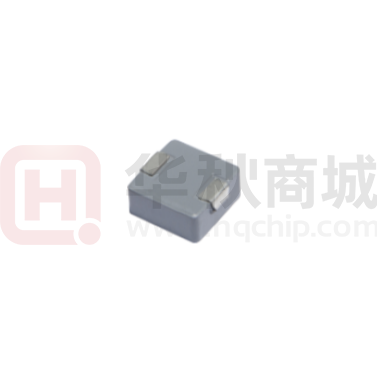

TMPC1206HP-270MG-D
TMPC1206HP-270MG-D
    TAI-TECH(台庆)
    SMD,13.5x12.5mm
    功率电感 27µH ±20% IND_13.5X12.5MM_SM 6.00mm 13.50 x 12.50mm 56mΩ 7A
TMPC1206HP-270MG-D 数据手册
