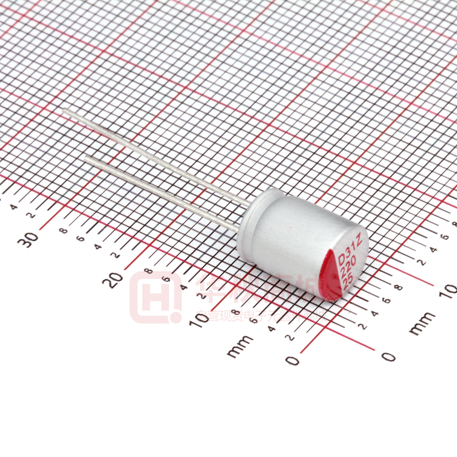

    插件,D8xL11mm
    铝聚合物电容器 AEC_D8X11MM_TM 220µF ±20% 25V Ф8.00 x 11.00mm 20mΩ
SPZ1EM221F11O00RAXXX 数据手册
CONDUCTIVE POLYMER ALUMINUM SOLID CAPACITORS PZ series Endurance: +105°C 2,000 hours Low ESR Recommended Applications: System Board,Display Card,Small Charger and intelligent TV RoHS Compliant and lead-free SPECIFICATIONS Items Characteristics Category Temperature Range -55~+105°C Rated Working Voltage Range 6.3~100 V dc Nominal Capacitance Range 4.7~5600µF Capacitance Tolerance ±20%(M) DC Leakage Current I≤0.2CV or 500μA, whichever is greater. Where, I:Max.leakage current (µA),C:Nominal capacitance (µF),V: Rated voltage (V) Dissipation Factor (tanδ) Rated Voltage(V dc ) (at 20°C,120Hz) 6.3 tanδ (max.) 6.8 7.5 10 16 25 0.08 ESR(100kHz,20°C) Value in characteristics table Temperature Characteristic (Impedance Ratio at 100kHz) Z(+105°C)/Z(+20°C)≤1.25 Z(-55°C)/Z(+20°C)≤1.25 35 (at 20°C after 2 minutes) 50 63 100 0.12 0.15 (at 20°C,120Hz) After applying rated voltage for 2,000 hours at 105°C,the capacitors shall meet the following requirements. Endurance Appearance No significant damage Capacitance Change ≤±20% of the initial value D.F. (tanδ) ≤150% of the initial specified value ESR ≤150% of the initial specified value Leakage Current ≤The initial specified value After subjecting to 90%~95% RH for 2,000 hours at 60°C without voltage applied, the capacitors shall meet the specified values for the Endurance characteristics listed above. Humidity Test After subjecting to 1,000 cycles each consisting of charge with the surge voltage specified at normal temperature for 30 seconds through a protective resistor and discharge for 5 minutes 30 seconds, the capacitors shall meet the following requirements. Surge Test Appearance No significant damage Capacitance Change ≤ ± 20% of the initial value D.F. (tanδ) ≤150% of the initial specified value ESR ≤150% of the initial specified value Leakage Current ≤The initial specified value DIMENSIONS[mm] Ød ØD' F±0.5 L' 4min. 15min. ØD 5 5.5 6.3 8 10 Ød 0.5 0.5 0.5 0.6 0.6 F ØD' L' 2.0 2.5 2.5 3.5 5.0 Ø D-0.1~+0.5 L+1.0max. L-0.5~+1 PART NUMBERING SYSTEM S P Z 1 C M 2 7 1 E 0 8 O 0 0 R A X X X Special code Marking code Terminal code Size code Capacitance code Capacitance tolerance code Voltage code Series code Category code 23 CONDUCTIVE POLYMER ALUMINUM SOLID CAPACITORS PZ series VDC (SV) Cap (µF) 100 220 270 330 390 470 500 560 6.3 (7.2) 680 820 1000 1200 1500 1800 2200 3300 4700 5600 220 270 330 6.8 (7.8) 390 470 560 680 820 1000 150 220 270 330 7 (8.1) 470 560 680 820 220 270 330 390 470 7.5 (8.6) 500 560 680 820 1000 10 (11.5) 1200 1500 1800 2200 47 56 68 82 100 120 Size ΦDxL(mm) 5×7 5×7 6.3×7 5×7 5×8 6.3×5 6.3×8 5×9 5×10 5.5×9 6.3×7 6.3×8 5×9 6.3×7 6.3×8 5.5×9 6.3×9 5.5×9 8×9 5.5×12 6.3×9 8×9 6.3×10 8×9 8×11 6.3×11 8×11 8×11 10×12 10×10 8×14 10×12 10×14 10×17 10×18 5×7 5×7 6.3×8 5×8 6.3×5 6.3×7 5×9 5×9 6.3×7 6.3×8 6.3×9 6.3×9 6.3×11 8×11 5×6 5×7 5×8 5×9 6.3×8 5.5×9 6.3×8 6.3×9 6.3×10 8×9 5×7 5×8 5×8 5×9 6.3×7 5.5×9 5×9 5.5×8 5.5×9 6.3×8 6.3×9 6.3×10 8×9 8×11 6.3×11 8×11 8×11 6.8×13 8×14 10×12 5×7 5×7 5×7 5×7 5×7 6.3×5 5×7 ESR (mΩ,20°C,100kHz) (max.) Rated ripple current (mArms/105°C,100kHz) Leakage Current (µA)(max.) Part Number 30 20 20 20 20 25 15 20 20 20 20 15 20 20 20 20 20 20 20 20 20 15 10 12 10 10 10 10 10 10 10 10 10 10 10 20 20 20 20 25 20 20 20 20 20 20 20 12 10 30 20 20 20 20 20 20 12 12 12 20 20 20 20 25 20 20 25 20 20 12 12 12 12 12 12 12 12 12 12 35 35 35 35 35 30 20 1800 3500 3900 3800 4000 3160 4000 4100 4300 4100 3900 4400 4100 4200 4800 4300 5080 4800 4600 5000 5080 4700 5150 4800 5200 5200 5300 5400 5500 5560 5700 5800 5900 6100 6300 3300 3600 3900 3800 3100 3400 3900 4100 3700 4500 4800 4900 5100 5150 1500 3200 3400 3600 3800 3600 4000 4200 4500 4600 3100 3300 3500 3500 3200 3550 3550 3100 3600 3900 4100 4400 4550 4700 4500 4800 4900 4800 5100 5700 2200 2250 2300 2350 2400 2300 2450 500 500 500 500 500 500 500 500 592 592 592 592 630 706 706 706 857 857 857 1033 1033 1033 1260 1260 1260 1512 1512 1890 1890 2268 2772 2772 4158 5000 5000 500 500 500 500 500 500 530 639 639 762 925 1115 1360 1360 500 500 500 500 658 658 784 952 1148 1148 500 500 500 585 705 705 705 705 750 840 1020 1230 1230 1500 1500 1800 2250 2250 2700 3300 500 500 500 500 500 500 500 SPZ0JM101D07O00RAXXX SPZ0JM221D07O00RAXXX SPZ0JM221E07O00RAXXX SPZ0JM271D07O00RAXXX SPZ0JM331D08O00RAXXX SPZ0JM331E05O00RAXXX SPZ0JM331E08O00RAXXX SPZ0JM391D09O00RAXXX SPZ0JM471D10O00RAXXX SPZ0JM471B09O00RAXXX SPZ0JM471E07O00RAXXX SPZ0JM471E08O00RAXXX SPZ0JM501D09O00RAXXX SPZ0JM561E07O00RAXXX SPZ0JM561E08O00RAXXX SPZ0JM561B09O00RAXXX SPZ0JM681E09O00RAXXX SPZ0JM681B09O00RAXXX SPZ0JM681F09O00RAXXX SPZ0JM821B12O00RAXXX SPZ0JM821E09O00RAXXX SPZ0JM821F09O00RAXXX SPZ0JM102E10O00RAXXX SPZ0JM102F09O00RAXXX SPZ0JM102F11O00RAXXX SPZ0JM122E11O00RAXXX SPZ0JM122F11O00RAXXX SPZ0JM152F11O00RAXXX SPZ0JM152G12O00RAXXX SPZ0JM182G10O00RAXXX SPZ0JM222F14O00RAXXX SPZ0JM222G12O00RAXXX SPZ0JM332G14O00RAXXX SPZ0JM472G17O00RAXXX SPZ0JM562G18O00RAXXX SPZ0CM221D07O00RAXXX SPZ0CM271D07O00RAXXX SPZ0CM271E08O00RAXXX SPZ0CM331D08O00RAXXX SPZ0CM331E05O00RAXXX SPZ0CM331E07O00RAXXX SPZ0CM391D09O00RAXXX SPZ0CM471D09O00RAXXX SPZ0CM471E07O00RAXXX SPZ0CM561E08O00RAXXX SPZ0CM681E09O00RAXXX SPZ0CM821E09O00RAXXX SPZ0CM102E11O00RAXXX SPZ0CM102F11O00RAXXX SPZ0QM151D06O00RAXXX SPZ0QM221D07O00RAXXX SPZ0QM271D08O00RAXXX SPZ0QM331D09O00RAXXX SPZ0QM471E08O00RAXXX SPZ0QM471B09O00RAXXX SPZ0QM561E08O00RAXXX SPZ0QM681E09O00RAXXX SPZ0QM821E10O00RAXXX SPZ0QM821F09O00RAXXX SPZ0AM221D07O00RAXXX SPZ0AM271D08O00RAXXX SPZ0AM331D08O00RAXXX SPZ0AM391D09O00RAXXX SPZ0AM471E07O00RAXXX SPZ0AM471B09O00RAXXX SPZ0AM471D09O00RAXXX SPZ0AM471B08O00RAXXX SPZ0AM501B09O00RAXXX SPZ0AM561E08O00RAXXX SPZ0AM681E09O00RAXXX SPZ0AM821E10O00RAXXX SPZ0AM821F09O00RAXXX SPZ0AM102F11O00RAXXX SPZ0AM102E11O00RAXXX SPZ0AM122F11O00RAXXX SPZ0AM152F11O00RAXXX SPZ0AM152Q13O00RAXXX SPZ0AM182F14O00RAXXX SPZ0AM222G12O00RAXXX SPZ1AM470D07O00RAXXX SPZ1AM560D07O00RAXXX SPZ1AM680D07O00RAXXX SPZ1AM820D07O00RAXXX SPZ1AM101D07O00RAXXX SPZ1AM101E05O00RAXXX SPZ1AM121D07O00RAXXX 24 Conductive Polymer Radial Type STANDARD RATINGS CONDUCTIVE POLYMER ALUMINUM SOLID CAPACITORS PZ series STANDARD RATINGS VDC (SV) Cap (µF) 150 180 220 270 330 390 10 (11.5) 470 560 680 820 1000 1200 1500 1800 2200 3300 330 470 12 (13.8) 560 680 820 1000 1200 1500 22 47 56 68 82 100 120 150 180 220 16 (18.4) 270 330 470 560 680 820 1000 1200 1500 1800 2200 20 (23.0) 120 150 220 270 330 470 Size ΦDxL(mm) 5×7 6.3×7 5×8 5×9 6.3×5 6.3×8 6.3×8 6.3×8 8×9 6.3×10 6.3×8 5.5×9 6.3×8 8×9 8×11 6.3×10 8×9 8×11 8×8 8×11 8×11 10×12 8×12 10×12 10×12 8×14 10×13 10×15 10×18 5.5×9 6.3×8 5.5×9 6.3×9 6.3×10 6.3×11 8×10 8×11 8×12 8×14 8×16 5×9 5×7 5×7 5×7 5×8 5×7 6.3×5 6.3×8 5×8 5×8 5×8 6.3×7 5×10 6.3×8 6.3×10 5.5×9 6.3×8 8×9 5.5×9 6.3×9 6.3×10 5.5×11 6.3×11 8×11 8×9 8×11 8×13 10×12 8×11 10×12 8×13 10×12 10×12 8×14 10×15 10×12 10×12 10×18 10×14 10×17 10×15 6.3×8 6.3×10 8×11 8×11 8×11 6.3×10 10×12 8×16 8×11 ESR (mΩ,20°C,100kHz) (max.) Rated ripple current (mArms/105°C,100kHz) Leakage Current (µA)(max.) Part Number 20 20 20 20 25 15 20 20 15 12 20 20 20 15 12 13 15 12 20 12 12 10 10 10 10 10 10 10 10 20 20 20 20 15 15 15 12 12 12 12 80 20 20 20 20 20 25 20 20 20 20 16 20 20 15 20 20 20 20 20 15 20 15 11 13 11 15 11 15 11 11 11 11 11 12 12 12 12 12 12 12 30 20 20 20 20 20 20 20 20 2500 2800 2700 2820 2800 3160 3100 3300 3400 3500 3400 3400 3500 3550 5650 3600 3600 3900 3300 4000 4200 5300 4500 5450 5500 4800 5800 6100 6200 3100 3100 3200 3450 3400 3600 3700 3800 4000 4400 4800 1600 2050 2100 2150 2200 2250 2100 2800 2350 2400 2450 2500 2600 2700 2900 2750 2800 2900 2900 2900 3100 3100 3200 4600 4100 3200 3300 3500 3400 3600 3500 3800 4000 3600 4300 4200 4800 5500 5400 5800 5500 2300 2350 2550 2700 2800 2100 2900 3000 2400 500 500 500 500 500 500 540 660 660 660 780 940 940 940 940 1120 1120 1360 1360 1640 2000 2000 2400 2400 3000 3000 3600 4400 5000 792 792 1128 1128 1344 1632 1632 1968 2400 2880 3600 500 500 500 500 500 500 500 500 500 500 576 576 704 704 704 864 864 864 1056 1056 1056 1504 1504 1504 1504 1792 1792 1792 2176 2176 2624 2624 3200 3200 3840 3840 4800 4800 5000 5000 5000 500 600 880 1080 1320 1320 1880 1880 1880 SPZ1AM151D07O00RAXXX SPZ1AM181E07O00RAXXX SPZ1AM181D08O00RAXXX SPZ1AM221D09O00RAXXX SPZ1AM221E05O00RAXXX SPZ1AM221E08O00RAXXX SPZ1AM271E08O00RAXXX SPZ1AM331E08O00RAXXX SPZ1AM331F09O00RAXXX SPZ1AM331E10O00RAXXX SPZ1AM391E08O00RAXXX SPZ1AM471B09O00RAXXX SPZ1AM471E08O00RAXXX SPZ1AM471F09O00RAXXX SPZ1AM471F11O00RAXXX SPZ1AM561E10O00RAXXX SPZ1AM561F09O00RAXXX SPZ1AM681F11O00RAXXX SPZ1AM681F08O00RAXXX SPZ1AM821F11O00RAXXX SPZ1AM102F11O00RAXXX SPZ1AM102G12O00RAXXX SPZ1AM122F12O00RAXXX SPZ1AM122G12O00RAXXX SPZ1AM152G12O00RAXXX SPZ1AM152F14O00RAXXX SPZ1AM182G13O00RAXXX SPZ1AM222G15O00RAXXX SPZ1AM332G18O00RAXXX SPZ1TM331B09O00RAXXX SPZ1TM331E08O00RAXXX SPZ1TM471B09O00RAXXX SPZ1TM471E09O00RAXXX SPZ1TM561E10O00RAXXX SPZ1TM681E11O00RAXXX SPZ1TM681F10O00RAXXX SPZ1TM821F11O00RAXXX SPZ1TM102F12O00RAXXX SPZ1TM122F14O00RAXXX SPZ1TM152F16O00RAXXX SPZ1CM220D09O00RAXXX SPZ1CM470D07O00RAXXX SPZ1CM560D07O00RAXXX SPZ1CM680D07O00RAXXX SPZ1CM820D08O00RAXXX SPZ1CM101D07O00RAXXX SPZ1CM101E05O00RAXXX SPZ1CM101E08O00RAXXX SPZ1CM121D08O00RAXXX SPZ1CM151D08O00RAXXX SPZ1CM181D08O00RAXXX SPZ1CM181E07O00RAXXX SPZ1CM221D10O00RAXXX SPZ1CM221E08O00RAXXX SPZ1CM221E10O00RAXXX SPZ1CM271B09O00RAXXX SPZ1CM271E08O00RAXXX SPZ1CM271F09O00RAXXX SPZ1CM331B09O00RAXXX SPZ1CM331E09O00RAXXX SPZ1CM331E10O00RAXXX SPZ1CM471B11O00RAXXX SPZ1CM471E11O00RAXXX SPZ1CM471F11O00RAXXX SPZ1CM471F09O00RAXXX SPZ1CM561F11O00RAXXX SPZ1CM561F13O00RAXXX SPZ1CM561G12O00RAXXX SPZ1CM681F11O00RAXXX SPZ1CM681G12O00RAXXX SPZ1CM821F13O00RAXXX SPZ1CM821G12O00RAXXX SPZ1CM102G12O00RAXXX SPZ1CM102F14O00RAXXX SPZ1CM122G15O00RAXXX SPZ1CM122G12O00RAXXX SPZ1CM152G12O00RAXXX SPZ1CM152G18O00RAXXX SPZ1CM182G14O00RAXXX SPZ1CM222G17O00RAXXX SPZ1CM222G15O00RAXXX SPZ1DM121E08O00RAXXX SPZ1DM151E10O00RAXXX SPZ1DM221F11O00RAXXX SPZ1DM271F11O00RAXXX SPZ1DM331F11O00RAXXX SPZ1DM331E10O00RAXXX SPZ1DM471G12O00RAXXX SPZ1DM471F16O00RAXXX SPZ1DM471F11O00RAXXX 25 CONDUCTIVE POLYMER ALUMINUM SOLID CAPACITORS PZ series VDC (SV) Cap (µF) 560 20 (23.0) 680 820 1000 6.8 10 22 33 39 47 56 68 82 100 120 150 25 (28.8) 180 220 270 330 470 560 680 820 1000 4.7 10 15 22 33 39 47 56 68 82 100 35 (40.3) 120 150 180 220 270 330 470 560 680 820 1000 4.7 10 15 22 33 47 56 68 50 (57.5) 63(72.5) 100 120 150 180 220 270 330 440 470 4.7 Size ΦDxL(mm) ESR (mΩ,20°C,100kHz) (max.) Rated ripple current (mArms/105°C,100kHz) Leakage Current (µA)(max.) Part Number 10×12 8×16 10×15 8×14 10×18 10×18 6.3×5 5×8 5×9 5×9 5×8 5×9 5×9 6.3×7 6.3×7 6.3×8 6.3×10 8×11 6.3×8 6.3×10 6.3×10 8×9 8×11 10×12 5.5×11 8×11 8×11 10×12 10×10 10×12 8×16 8×11 10×10 10×12 8×12 10×15 10×12 8×14 10×18 10×12 8×16 10×18 5×8 5×8 5×8 5×9 5×9 5×9 6.3×7 6.3×7 6.3×7 6.3×7 6.3×8 6.3×10 8×11 6.3×10 6.3×10 6.3×11 8×11 10×12 6.3×11 10×12 10×12 10×13 10×14 10×16 10×18 10×18 5×8 6.3×7 5×8 5×8 6.3×7 6.3×7 6.3×8 6.3×8 6.3×10 8×11 8×9 8×11 10×12 10×12 10×12 10×13 10×15 10×18 10×18 6.3×8 20 20 20 20 20 20 100 70 60 50 60 60 60 30 30 30 20 20 30 20 20 30 20 20 20 20 20 20 25 20 20 20 25 20 20 20 20 20 20 20 20 20 60 60 60 100 50 50 50 50 50 50 50 40 40 40 40 40 40 30 40 30 30 20 20 20 20 20 60 35 70 70 40 40 35 35 30 30 40 30 30 30 30 20 20 20 20 60 3100 3200 3300 2700 3400 3900 1100 1800 1810 1850 1900 1950 2050 2100 2150 2500 2800 3000 2500 2800 2800 2500 3000 3500 1900 3000 3100 3800 2800 4000 3400 3000 2800 4000 3100 4300 2240 2240 2720 2720 3280 4000 500 500 500 500 500 500 500 500 500 500 500 500 600 750 900 900 1100 1100 1100 1350 1650 1650 1650 2350 2350 2350 2350 2800 2800 3400 3400 3400 4100 4100 4100 5000 500 500 500 500 500 500 500 500 500 574 700 700 700 840 1050 1260 1540 1540 1540 1890 2310 3290 3920 4760 5000 5000 500 500 500 500 500 500 500 560 680 1000 1000 1200 1500 1800 2200 2700 3300 4400 4700 500 SPZ1DM561G12O00RAXXX SPZ1DM561F16O00RAXXX SPZ1DM681G15O00RAXXX SPZ1DM681F14O00RAXXX SPZ1DM821G18O00RAXXX SPZ1DM102G18O00RAXXX SPZ1EM6R8E05O00RAXXX SPZ1EM100D08O00RAXXX SPZ1EM220D09O00RAXXX SPZ1EM330D09O00RAXXX SPZ1EM390D08O00RAXXX SPZ1EM470D09O00RAXXX SPZ1EM560D09O00RAXXX SPZ1EM680E07O00RAXXX SPZ1EM820E07O00RAXXX SPZ1EM101E08O00RAXXX SPZ1EM101E10O00RAXXX SPZ1EM101F11O00RAXXX SPZ1EM121E08O00RAXXX SPZ1EM151E10O00RAXXX SPZ1EM181E10O00RAXXX SPZ1EM181F09O00RAXXX SPZ1EM221F11O00RAXXX SPZ1EM221G12O00RAXXX SPZ1EM221B11O00RAXXX SPZ1EM271F11O00RAXXX SPZ1EM331F11O00RAXXX SPZ1EM331G12O00RAXXX SPZ1EM331G10O00RAXXX SPZ1EM471G12O00RAXXX SPZ1EM471F16O00RAXXX SPZ1EM471F11O00RAXXX SPZ1EM471G10O00RAXXX SPZ1EM561G12O00RAXXX SPZ1EM561F12O00RAXXX SPZ1EM681G15O00RAXXX SPZ1EM681G12O00RAXXX SPZ1EM681F14O00RAXXX SPZ1EM821G18O00RAXXX SPZ1EM821G12O00RAXXX SPZ1EM821F16O00RAXXX SPZ1EM102G18O00RAXXX SPZ1VM4R7D08O00RAXXX SPZ1VM100D08O00RAXXX SPZ1VM150D08O00RAXXX SPZ1VM220D09O00RAXXX SPZ1VM330D09O00RAXXX SPZ1VM390D09O00RAXXX SPZ1VM470E07O00RAXXX SPZ1VM560E07O00RAXXX SPZ1VM680E07O00RAXXX SPZ1VM820E07O00RAXXX SPZ1VM101E08O00RAXXX SPZ1VM101E10O00RAXXX SPZ1VM101F11O00RAXXX SPZ1VM121E10O00RAXXX SPZ1VM151E10O00RAXXX SPZ1VM181E11O00RAXXX SPZ1VM221F11O00RAXXX SPZ1VM221G12O00RAXXX SPZ1VM221E11O00RAXXX SPZ1VM271G12O00RAXXX SPZ1VM331G12O00RAXXX SPZ1VM471G13O00RAXXX SPZ1VM561G14O00RAXXX SPZ1VM681G16O00RAXXX SPZ1VM821G18O00RAXXX SPZ1VM102G18O00RAXXX SPZ1HM4R7D08O00RAXXX SPZ1HM100E07O00RAXXX SPZ1HM100D08O00RAXXX SPZ1HM150D08O00RAXXX SPZ1HM220E07O00RAXXX SPZ1HM330E07O00RAXXX SPZ1HM470E08O00RAXXX SPZ1HM560E08O00RAXXX SPZ1HM680E10O00RAXXX SPZ1HM101F11O00RAXXX SPZ1HM101F09O00RAXXX SPZ1HM121F11O00RAXXX SPZ1HM151G12O00RAXXX SPZ1HM181G12O00RAXXX SPZ1HM221G12O00RAXXX SPZ1HM271G13O00RAXXX SPZ1HM331G15O00RAXXX SPZ1HM441G18O00RAXXX SPZ1HM471G18O00RAXXX SPZ1JM4R7E08O00RAXXX 4100 3400 4500 4100 3600 4500 1700 1800 1850 1950 2000 2050 2100 2150 2200 2250 2350 2400 2600 2500 2550 2600 2800 2900 2600 3000 3100 3200 3300 3400 3500 3700 1600 1850 1630 1660 1900 2000 2100 2120 2150 2300 2100 2400 2500 2600 2700 2900 3000 3100 3150 1600 26 Conductive Polymer Radial Type STANDARD RATINGS CONDUCTIVE POLYMER ALUMINUM SOLID CAPACITORS PZ series STANDARD RATINGS VDC (SV) 63 (72.5) 80 (92.0) 100 (115.0) Cap (µF) Size ΦDxL(mm) 6.8 10 33 39 47 56 68 82 100 150 180 220 270 330 4.7 6.8 22 33 47 68 100 4.7 6.8 6.3×8 6.3×5 6.3×8 6.3×8 6.3×9 8×9 8×11 8×11 10×12 10×12 10×13 10×15 10×17 10×18 6.3×8 6.3×8 6.3×10 8×11 10×12 10×12 10×14 6.3×8 6.3×8 6.3×10 8×11 8×11 10×12 10×14 10×16 10 15 22 33 47 ESR (mΩ,20°C,100kHz) (max.) 60 60 30 30 30 30 30 30 30 30 20 20 20 20 60 60 60 35 35 35 35 120 120 50 50 35 35 35 35 Rated ripple current (mArms/105°C,100kHz) Leakage Current (µA)(max.) Part Number 1650 1600 1700 1750 1900 1800 2000 2100 2200 2500 2600 2650 2850 2950 1500 1550 1650 1700 1850 1900 2100 1400 1450 1500 1550 1550 1600 1650 1800 500 500 500 500 592 706 857 1033 1260 1890 2268 2772 3402 4158 500 500 500 528 752 1088 1600 500 500 500 500 500 500 660 940 SPZ1JM6R8E08O00RAXXX SPZ1JM100E05O00RAXXX SPZ1JM330E08O00RAXXX SPZ1JM390E08O00RAXXX SPZ1JM470E09O00RAXXX SPZ1JM560F09O00RAXXX SPZ1JM680F11O00RAXXX SPZ1JM820F11O00RAXXX SPZ1JM101G12O00RAXXX SPZ1JM151G12O00RAXXX SPZ1JM181G13O00RAXXX SPZ1JM221G15O00RAXXX SPZ1JM271G17O00RAXXX SPZ1JM331G18O00RAXXX SPZ1BM4R7E08O00RAXXX SPZ1BM6R8E08O00RAXXX SPZ1BM220E10O00RAXXX SPZ1BM330F11O00RAXXX SPZ1BM470G12O00RAXXX SPZ1BM680G12O00RAXXX SPZ1BM101G14O00RAXXX SPZ1KM4R7E08O00RAXXX SPZ1KM6R8E08O00RAXXX SPZ1KM100E10O00RAXXX SPZ1KM100F11O00RAXXX SPZ1KM150F11O00RAXXX SPZ1KM220G12O00RAXXX SPZ1KM330G14O00RAXXX SPZ1KM470G16O00RAXXX ※ Specifications subject to change without notice. 27
物料型号:AiSHi PZ系列导电聚合物铝固体电容器。
器件简介:这些电容器具有低等效串联电阻(ESR)和高耐久性,适用于系统主板、显示卡、小型充电器和智能电视等应用。它们符合RoHS标准,无铅。
引脚分配:文档中没有提供具体的引脚分配信息,通常这类电容器为径向引线形式。
参数特性: - 工作温度范围:-55°C 至 +105°C - 额定工作电压范围:6.3V 至 100V - 标称电容范围:4.7μF 至 5600μF - 电容公差:+20%(M),在20°C、120Hz时 - 直流漏电流:I≥0.2CV或500pA,取较大者,其中I为最大漏电流,C为标称电容,V为额定电压 - 耗散因数(tano):随额定电压不同而变化,最大值为0.08至0.15,在20°C、120Hz时 - ESR(100kHz, 20°C):特性表中的特定值 - 温度特性:在100kHz时,+105°C与+20°C的阻抗比不超过1.25,-55°C与+20°C的阻抗比不超过1.25
功能详解:电容器在经过105°C、2000小时的额定电压施加后,应满足外观无明显损伤、电容变化不超过初始值的±20%、耗散因数不超过初始值的150%、ESR不超过初始值的150%、漏电流不超过初始规定值等要求。
应用信息:推荐用于系统主板、显示卡、小型充电器和智能电视等。
封装信息:提供了不同尺寸的外径(OD)和长度(L)的详细尺寸数据,以及尺寸公差。
