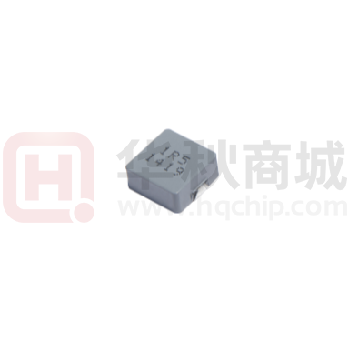

    功率电感 100μH ±20% 1265 6.50mm 13.50 x 12.50mm 165mΩ 4.2A
