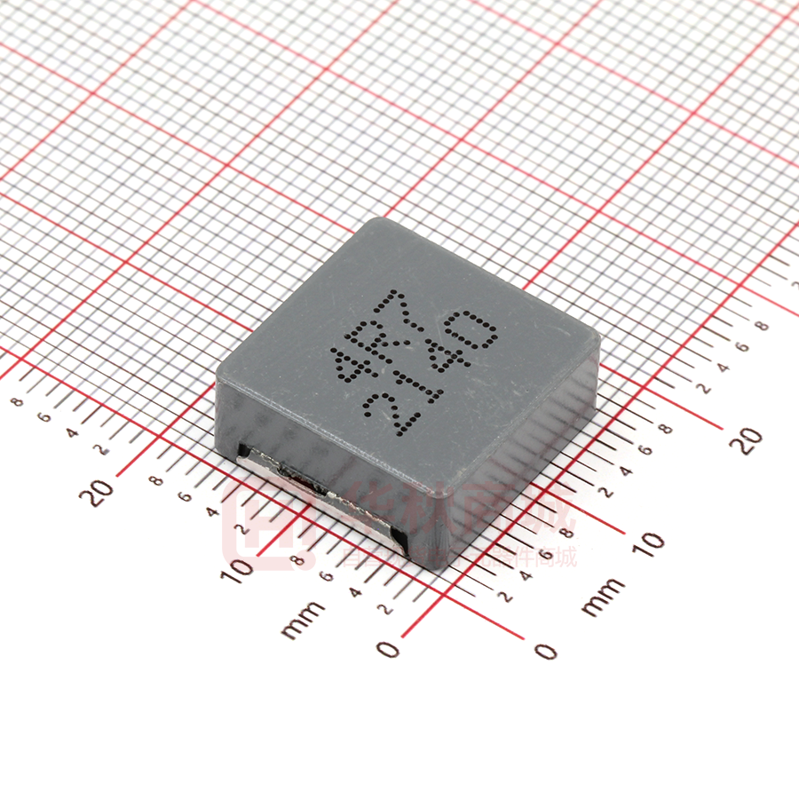

    功率电感 4.7µH ±20% 1707 7.00mm 17.60 x 16.90mm 5.5mΩ 25A
TMPC1707HP-4R7MG-D 数据手册
TAI-TECH P1 5. Specification Part Number Inductance L0 (uH)±20% @0A I rms (A) Typ. I sat 1(A) Typ. I sat2 (A) Typ. DCR (mΩ) Typ. @25℃ DCR (mΩ) Max. @25℃ TMPC1707HP-R45MG-D 0.45 62 85 125 0.8 0.96 TMPC1707HP-1R0MG-D 1.00 52 60 70 1.6 2.0 TMPC1707HP-1R3MG-D 1.30 49 54 67 1.7 2.3 TMPC1707HP-1R5MG-D 1.50 47 52 65 2.0 2.5 TMPC1707HP-2R2MG-D 2.20 43.5 47 62 2.4 2.7 TMPC1707HP-3R3MG-D 3.30 28 45 54 3.5 3.9 TMPC1707HP-4R7MG-D 4.70 25 41 50 4.8 5.5 TMPC1707HP-5R6MG-D 5.60 21 40 45 5.8 7.05 TMPC1707HP-6R8MG-D 6.80 19 32 39 8.4 9.2 TMPC1707HP-8R2MG-D 8.20 18 25 31 9.6 10.8 TMPC1707HP-100MG-D 10.0 16.5 24 29 11.8 13.0 TMPC1707HP-150MG-D 15.0 12.5 23 27 17.8 20.5 TMPC1707HP-220MG-D 22.0 12 18 23 25.1 26.5 TMPC1707HP-330MG-D 33.0 10.7 15 20 38.0 44.0 TMPC1707HP-390MG-D 39.0 9.2 11 18 40.0 48.0 TMPC1707HP-470MG-D 47.0 8.7 9.5 16 48.0 55.0 TMPC1707HP-560MG-D 56.0 7.8 9.0 15 54.0 62.0 TMPC1707HP-680MG-D 68.0 7.0 8.0 13 68.0 80.0 TMPC1707HP-101MG-D 100 5.3 6.5 12 102.0 118.0 Note: 1. Test frequency : L/Q: 100KHz /1.0V. 2. All test data referenced to 25℃ ambient. 3. Testing Instrument : L/Q: HP4284A,CH11025,CH3302,CH1320 ,CH1320S LCR METER / Rdc:CH16502,Agilent33420A MICRO OHMMETER. 4. Heat Rated Current (Irms) will cause the coil temperature rise approximately Δt of 40℃ 5. Saturation Current (Isat1) will cause L0 to drop approximately 20% 6. Saturation Current (Isat2) will cause L0 to drop approximately 30% 7. The part temperature (ambient + temp rise) should not exceed 125℃under worst case operating conditions.Circuit design,component,PCB trace size and thickness,airflow and other cooling provisions all affect the part temperature. Part temperature should be verified in the end application. 7. Special inquiries besides the above common used types can be met on your requirement. TAI-TECH P2 6. Typical Performance Curves 0.14 24 0 104 30 16 1.8 72 1.2 48 0.6 24 0 0 28 42 56 40 48 2 48 0.7 24 1 24 0 0 0 70 0 12.4 TMPC1707HP-6R8 4 48 4.8 48 24 2 24 2.4 24 0 0 50 0 0 9.2 18.4 27.6 36.8 120 0 46 0 0 8 16 24 32 40 DC CURRENT(A) TMPC1707HP-100 TMPC1707HP-150 100 25 12 80 20 80 9 60 15 60 6 40 10 40 24 3 20 5 20 0 0 0 0 TEMP. RISE(oC) INDUCTANCE (uH) INDUCTANCE (uH) 34 0 5.8 11.6 17.4 23.2 29 120 50 28 96 21 72 14 48 7 100 0 0 5.4 DC CURRENT(A) 10.8 16.2 21.6 27 DC CURRENT(A) TMPC1707HP-330 TMPC1707HP-390 120 60 40 96 48 96 30 72 36 72 20 48 24 48 24 10 24 12 24 0 0 0 0 21 TEMP. RISE(oC) INDUCTANCE (uH) INDUCTANCE (uH) 54 72 TEMP. RISE(oC) INDUCTANCE (uH) INDUCTANCE (uH) TMPC1707HP-5R6 DC CURRENT(A) 16.8 43.2 7.2 3 0 32.4 72 48 TMPC1707HP-220 21.6 DC CURRENT(A) 6 6 12.6 10.8 96 72 8.4 0 0 9.6 9 DC CURRENT(A) 62 96 96 4.2 49.6 8 12 0 37.2 12 15 35 24.8 120 120 120 27.2 70 TMPC1707HP-3R3 DC CURRENT(A) 0 56 1.4 DC CURRENT(A) TMPC1707HP-8R2 42 72 1.6 0 28 DC CURRENT(A) 3 48 20.4 14 72 3.2 13.6 0 0 2.1 72 6.8 0 80 96 4.8 0 64 4 96 15 24 96 6.4 30 0.4 2.8 10 20 48 5 120 10 0.8 DC CURRENT(A) TMPC1707HP-4R7 0 72 120 DC CURRENT(A) 8 48 TEMP. RISE(oC) INDUCTANCE (uH) 96 14 32 TMPC1707HP-2R2 3.5 TEMP. RISE(oC) INDUCTANCE (uH) INDUCTANCE (uH) 120 2.4 0 1.2 DC CURRENT(A) TMPC1707HP-1R5 3 96 0 0 130 DC CURRENT(A) TEMP. RISE(oC) INDUCTANCE (uH) 78 0.3 TEMP. RISE(oC) INDUCTANCE (uH) 52 60 0 4 8 12 DC CURRENT(A) 16 20 TEMP. RISE(oC) INDUCTANCE (uH) 26 0.6 0 0 0 90 1.6 TEMP. RISE(oC) 48 0.9 120 TEMP. RISE(oC) 0.28 120 TEMP. RISE(oC) 72 1.2 TMPC1707HP-1R3 2 TEMP. RISE(oC) 0.42 150 120 0 0 3.6 7.2 10.8 DC CURRENT(A) 14.4 18 TEMP. RISE(oC) 96 TEMP. RISE(oC) INDUCTANCE (uH) INDUCTANCE (uH) 0.56 TMPC1707HP-1R0 1.5 120 TEMP. RISE(oC) INDUCTANCE (uH) TMPC1707HP-R45 0.7 TAI-TECH 48 96 36 72 24 48 12 0 0 3.2 6.4 9.6 12.8 100 64 48 80 56 48 36 60 42 32 24 40 28 24 16 12 20 14 0 0 0 0 16 0 96 90 72 60 48 30 24 0 0 2.4 4.8 7.2 DC CURRENT(A) 9.6 12 TEMP. RISE(oC) INDUCTANCE (uH) 120 120 0 1.8 3.6 5.4 DC CURRENT(A) TMPC1707HP-101 TMPC1707HP-680 60 DC CURRENT(A) 150 TMPC1707HP-560 7.2 9 70 0 0 2.6 5.2 7.8 DC CURRENT(A) 10.4 13 TEMP. RISE(oC) 80 TEMP. RISE(oC) INDUCTANCE (uH) 120 TEMP. RISE(oC) INDUCTANCE (uH) TMPC1707HP-470 60 INDUCTANCE (uH) P3
