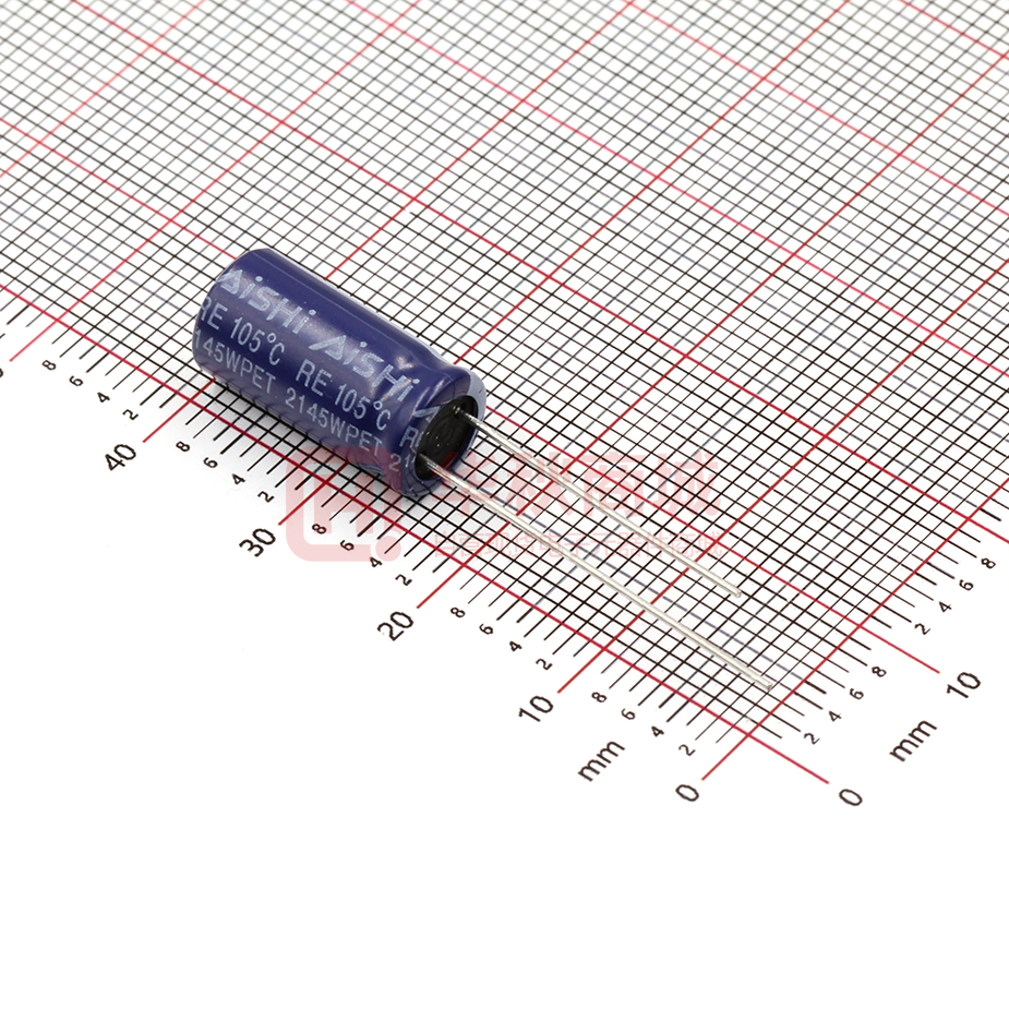

    插件,D8xL16mm
    直插铝电解电容 插件,D8xL16mm 1mF ±20% Ф8.00 x 16.00mm 10V 87mΩ 850mA 3000Hrs@105℃
ERE1AM102F16OT 数据手册
MINIATURE ALUMINUM ELECTROLYTIC CAPACITORS RE series Low impedance and high frequency. Endurance: +105°C 2,000~4,000 hours RE 105 C 1808 Suitable for switching power, UPS, power sources, etc. RoHS Compliant SPECIFICATIONS Items Characteristics Category Temperature Range -40~+105°C Rated Voltage Range 6.3~100 V dc Capacitance Tolerance ±20%(M) Leakage Current I≤0.01CV or 3μA, whichever is greater. Where, I:Max.leakage current (μA),C:Nominal capacitance (μF),V: Rated voltage (V) (at 20°C,120Hz) Rated Voltage(V dc ) Dissipation Factor (tanδ) 6.3 10 16 25 35 0.22 0.19 0.16 0.14 0.12 tanδ (max.) 50 63 100 0.10 0.09 0.08 (at 20°C after 2 minutes) When nominal capacitance exceeds 1,000μF, add 0.02 to the value above for each 1,000μF increase. (at 20°C,120Hz) Low Temperature Characteristics (Max. Impedance Ratio) Rated Voltage(V dc ) 6.3 10 Z(-25°C)/Z(+20°C) 4 3 Z(-40°C)/Z(+20°C) 8 6 16 25 35 50 63 100 2 4 3 (at 120Hz) The following specifications listed below shall be met when the capacitors are restored to 20°C after DC voltage plus rated ripple current is applied for a specified period of time at 105 °C. Endurance Capacitance Change Case Dia.(mm) ≤±25% of the initial value D.F. (tanδ) ≤200% of the initial specified value Leakage Current ≤The initial specified value ØD≤6.3 ØD=8&10 ØD≥12.5 Load life (hours) 2,000 3,000 4,000 The following specifications shall be satisfied when the capacitors are restored to 20°C after leaving them under no load at 105°C for 1,000 hours. Shelf Life Capacitance Change ≤ ± 25% of the initial value D.F. (tanδ) ≤200% of the initial specified value Leakage Current ≤200% of the initial specified value DIMENSIONS[mm] Sleeve(Violet) Ød ØD' F±0.5 L' 4min. 15min. ( Ø 5~ Ø 12.5) ØD 5 6.3 Ød 0.5 0.5 F ØD' L' 2.0 2.5 8 0.5 0.6 3.5 10 12.5 0.6 0.6 5.0 5.0 Ø D+0.5max. L+2max. PART NUMBERING SYSTEM E RE 1H M 330 E11 O- - T Sleeve Code: “C” for PVC, “T” for PET Terminal code Size code Capacitance code Capacitance tolerance code Voltage code Series code Category code RATED RIPPLE CURRENT MULTIPLIERS Frequency correction factor for ripple current Freq.(Hz) Cap.(μF) 120 1k 10k 100k Cap.
