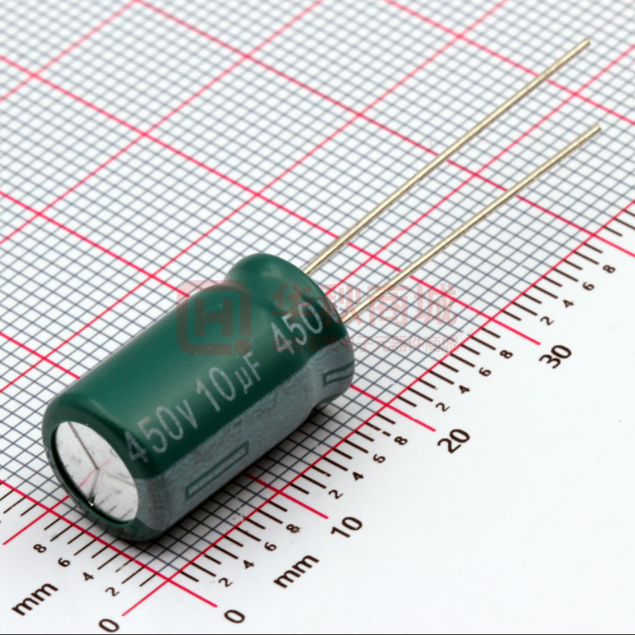

    直插铝电解电容 插件,D10xL16mm 10µF ±20% Ф10.00 x 16.00mm 450V 218mA 8000Hrs@105℃
EGD2WM100G16OT 数据手册
MINIATURE ALUMINUM ELECTROLYTIC CAPACITORS CD11GD series Endurance: +105 °C 8,000 hours Upgrade Miniaturized and high stability CD11GD 105 C 1808 RoHS Compliant SPECIFICATIONS Items Characteristics Category Temperature Range -40~+105°C Rated Voltage Range 140~450 V dc Capacitance Tolerance ±20%(M) (at 20°C,120Hz) 140~400 V dc 450V dc I≤0.02CV+10μA I≤0.03CV+10μA Leakage Current Where, I: Max.leakage current (μA),C:Nominal capacitance (μF), V: Rated voltage (V) (at 20°C after 2 minutes) Rated Voltage(V dc ) 140 160 200 250 315 350 400 450 tanδ (max.) 0.15 0.15 0.15 0.15 0.20 0.20 0.20 0.20 Rated Voltage(V dc ) 140 160 200 250 315 350 400 450 Z(-25°C)/Z(+20°C) 3 3 3 3 5 5 5 6 Z(-40°C)/Z(+20°C) 6 6 6 6 6 6 6 9 Dissipation Factor (tanδ) Low Temperature Characteristics (Max. Impedance Ratio) (at 20°C,120Hz) (at 120Hz) The specifications listed below shall be met when the capacitors are restored to 20 °C after DC voltage plus rated ripple current is applied for 8,000 hours at 105°C,the peak voltage shall not exceed the rated voltage. Endurance Capacitance Change ≤±20% of the initial value D.F. (tanδ) ≤200% of the initial specified value Leakage Current ≤The initial specified value The following specifications shall be satisfied when the capacitors are restored to 20°C after leaving them under no load at 105°C for 1,000 hours. Shelf Life Capacitance Change ≤±20% of the initial value D.F. (tanδ) ≤200% of the initial specified value Leakage Current ≤200% of the initial specified value DIMENSIONS[mm] Ød ØD' F±0.5 L' 4min. 15min. ( Ø 6.3~ Ø 18) ØD 6.3 Ød 0.5 F ØD' L' 2.5 8 0.5 0.6 3.5 10 12.5 13 16 18 0.6 0.6 0.6 0.8 0.8 5.0 5.0 5.0 7.5 7.5 Ø D+0.5max. L+2max. Radial Type Sleeve(Dark Green) PART NUMBERING SYSTEM E GD 2G M 3R3 F16 O- - T Sleeve Code: “C” for PVC, “T” for PET Terminal code Size code Capacitance code Capacitance tolerance code Voltage code Series code Category code RATED RIPPLE CURRENT MULTIPLIERS Frequency correction factor for ripple current Freq.(Hz) Rated voltage(Vdc) 140~450 120 1k 10k 100k 0.50 0.80 0.90 1.00 114 MINIATURE ALUMINUM ELECTROLYTIC CAPACITORS CD11GD series STANDARD RATINGS (Rated ripple current: mArms/105°C 100kHz) WV (Vdc) 140(2A) Cap (µF) Size ΦD×L(mm) Rated ripple current PartNumber 10 6.3×12 100 EGD2AM100E12OT 15 6.3×12 125 EGD2AM150E12OT 22 8×12 250 EGD2AM220F12OT 33 10×12 365 EGD2AM330G12OT 47 8×20 430 EGD2AM470F20OT 68 10×20 520 EGD2AM680G20OT 100 12.5×16 650 EGD2AM101W16OT 150 12.5×25 750 EGD2AM151W25OT 220 16×20 850 EGD2AM221L20OT 6.3×7 34 6.3×9 WV (Vdc) Cap (µF) Size ΦD×L(mm) Rated ripple current PartNumber 6.3×7 55 EGD2DM2R2E07OT 6.3×9 60 EGD2DM2R2E09OT 6.3×7 61 EGD2DM2R8E07OT 6.3×9 68 EGD2DM2R8E09OT 6.3×7 65 EGD2DM3R3E07OT 6.3×9 72 EGD2DM3R3E09OT 6.3×9 76 EGD2DM4R7E09OT 6.3×12 85 EGD2DM4R7E12OT 6.3×12 90 EGD2DM5R6E12OT EGD2CM010E07OT 8×9 92 EGD2DM5R6F09OT 36 EGD2CM010E09OT 6.3×12 94 EGD2DM6R8E12OT 6.3×7 38 EGD2CM1R5E07OT 8×9 98 EGD2DM6R8F09OT 6.3×9 45 EGD2CM1R5E09OT 8×12 110 EGD2DM6R8F12OT 6.3×7 49 EGD2CM1R8E07OT 8×9 145 EGD2DM8R2F09OT 6.3×9 50 EGD2CM1R8E09OT 8×12 155 EGD2DM8R2F12OT 6.3×7 53 EGD2CM2R2E07OT 8×9 165 EGD2DM100F09OT 6.3×9 56 EGD2CM2R2E09OT 8×12 180 EGD2DM100F12OT 6.3×7 57 EGD2CM2R8E07OT 8×12 200 EGD2DM150F12OT 6.3×9 60 EGD2CM2R8E09OT 8×16 225 EGD2DM150F16OT 6.3×7 61 EGD2CM3R3E07OT 8×16 320 EGD2DM220F16OT 6.3×9 65 EGD2CM3R3E09OT 10×12 320 EGD2DM220G12OT 6.3×7 65 EGD2CM3R9E07OT 10×16 380 EGD2DM220G16OT 6.3×9 68 EGD2CM3R9E09OT 10×16 425 EGD2DM330G16OT 6.3×7 66 EGD2CM4R7E07OT 10×20 450 EGD2DM330G20OT 6.3×9 70 EGD2CM4R7E09OT 12.5×13 430 EGD2DM330W13OT 6.3×12 72 EGD2CM4R7E12OT 10×20 520 EGD2DM470G20OT 6.3×9 72 EGD2CM5R6E09OT 12.5×16 520 EGD2DM470W16OT 6.3×12 74 EGD2CM5R6E12OT 12.5×20 600 EGD2DM680W20OT 6.3×9 80 EGD2CM6R8E09OT 12.5×25 665 EGD2DM680W25OT 6.3×12 84 EGD2CM6R8E12OT 12.5×20 670 EGD2DM820W20OT 6.3×12 120 EGD2CM8R2E12OT 12.5×25 700 EGD2DM101W25OT 8×9 135 EGD2CM8R2F09OT 16×20 700 EGD2DM101L20OT 6.3×12 145 EGD2CM100E12OT 16×25 820 EGD2DM151L25OT 8×9 165 EGD2CM100F09OT 16×30 895 EGD2DM151L30OT 8×12 206 EGD2CM100F12OT 6.3×7 36 EGD2EM010E07OT 8×9 180 EGD2CM120F09OT 6.3×9 40 EGD2EM010E09OT 8×9 192 EGD2CM150F09OT 6.3×7 41 EGD2EM1R2E07OT 8×12 213 EGD2CM150F12OT 6.3×9 46 EGD2EM1R2E09OT 8×12 267 EGD2CM220F12OT 6.3×7 51 EGD2EM1R5E07OT 8×16 330 EGD2CM220F16OT 6.3×9 54 EGD2EM1R5E09OT 10×12 330 EGD2CM220G12OT 6.3×7 54 EGD2EM1R8E07OT 10×12 400 EGD2CM330G12OT 6.3×9 58 EGD2EM1R8E09OT 10×16 425 EGD2CM330G16OT 6.3×7 55 EGD2EM2R2E07OT 10×16 455 EGD2CM470G16OT 6.3×9 62 EGD2EM2R2E09OT 10×20 500 EGD2CM470G20OT 6.3×7 63 EGD2EM2R8E07OT 10×20 530 EGD2CM560G20OT 6.3×9 70 EGD2EM2R8E09OT 10×20 550 EGD2CM680G20OT 6.3×9 75 EGD2EM3R3E09OT 12.5×16 565 EGD2CM680W16OT 6.3×12 80 EGD2EM3R3E12OT 12.5×20 640 EGD2CM820W20OT 6.3×12 92 EGD2EM4R7E12OT 12.5×20 700 EGD2CM101W20OT 8×9 92 EGD2EM4R7F09OT 12.5×25 722 EGD2CM101W25OT 8×12 102 EGD2EM4R7F12OT 12.5×25 755 EGD2CM151W25OT 8×9 95 EGD2EM5R6F09OT 16×20 760 EGD2CM151L20OT 8×12 105 EGD2EM5R6F12OT 220 16×25 900 EGD2CM221L25OT 8×9 105 EGD2EM6R8F09OT 330 18×30 1100 EGD2CM331M30OT 8×12 109 EGD2EM6R8F12OT 6.3×7 35 EGD2DM010E07OT 8×9 120 EGD2EM8R2F09OT 6.3×9 38 EGD2DM010E09OT 8×12 132 EGD2EM8R2F12OT 6.3×7 38 EGD2DM1R2E07OT 8×10 187 EGD2EM100F10OT 6.3×9 42 EGD2DM1R2E09OT 8×12 200 EGD2EM100F12OT 6.3×7 49 EGD2DM1R5E07OT 10×9 175 EGD2EM100G09OT 6.3×9 50 EGD2DM1R5E09OT 8×16 225 EGD2EM150F16OT 6.3×7 50 EGD2DM1R8E07OT 10×12 225 EGD2EM150G12OT 6.3×9 54 EGD2DM1R8E09OT 1 1.5 1.8 2.2 2.8 3.3 3.9 4.7 5.6 6.8 8.2 160(2C) 10 12 15 22 33 47 56 68 82 100 150 1 1.2 200(2D) 1.5 1.8 2.2 2.8 3.3 4.7 5.6 6.8 8.2 10 200(2D) 15 22 33 47 68 82 100 150 1 1.2 1.5 1.8 2.2 2.8 3.3 250(2E) 4.7 5.6 6.8 8.2 10 15 115 MINIATURE ALUMINUM ELECTROLYTIC CAPACITORS CD11GD series STANDARD RATINGS (Rated ripple current: mArms/105°C 100kHz) Cap (µF) 8×16 350 EGD2EM220F16OT 10×16 380 EGD2EM220G16OT 10×20 430 EGD2EM330G20OT 12.5×16 450 EGD2EM330W16OT 12.5×16 520 EGD2EM470W16OT 12.5×20 580 EGD2EM470W20OT 12.5×25 660 EGD2EM680W25OT 16×20 660 EGD2EM680L20OT 16×20 720 16×25 WV (Vdc) Cap (µF) Size ΦD×L(mm) Rated ripple current PartNumber EGD2GM010E07OT 6.3×9 55 EGD2GM010E09OT 6.3×9 59 EGD2GM1R2E09OT 6.3×12 63 EGD2GM1R2E12OT 6.3×9 65 EGD2GM1R5E09OT 6.3×12 68 EGD2GM1R5E12OT 6.3×9 68 EGD2GM1R8E09OT 6.3×12 71 EGD2GM1R8E12OT EGD2EM820L20OT 6.3×9 68 EGD2GM2R2E09OT 760 EGD2EM820L25OT 6.3×12 72 EGD2GM2R2E12OT 16×20 765 EGD2EM101L20OT 8×9 75 EGD2GM2R2F09OT 16×25 790 EGD2EM101L25OT 8×12 78 EGD2GM2R2F12OT 16×30 885 EGD2EM151L30OT 6.3×12 74 EGD2GM2R8E12OT 18×25 885 EGD2EM151M25OT 8×9 78 EGD2GM2R8F09OT 2.2 6.3×9 66 EGD2FM2R2E09OT 8×12 81 EGD2GM2R8F12OT 3.3 6.3×9 74 EGD2FM3R3E09OT 8×7 78 EGD2GM3R3F07OT 4.7 6.3×12 90 EGD2FM4R7E12OT 8×9 85 EGD2GM3R3F09OT 5.6 8×9 95 EGD2FM5R6F09OT 8×12 91 EGD2GM3R3F12OT 6.8 8×9 102 EGD2FM6R8F09OT 8×9 90 EGD2GM4R7F09OT 8.2 8×12 120 EGD2FM8R2F12OT 8×12 104 EGD2GM4R7F12OT 10 10×12 205 EGD2FM100G12OT 8×12 114 EGD2GM5R6F12OT 15 10×16 260 EGD2FM150G16OT 10×12 124 EGD2GM5R6G12OT 22 10×20 370 EGD2FM220G20OT 8×12 125 EGD2GM6R8F12OT 33 12.5×20 450 EGD2FM330W20OT 10×12 140 EGD2GM6R8G12OT 47 12.5×20 580 EGD2FM470W20OT 10×12 185 EGD2GM8R2G12OT 6.3×7 40 EGD2VM010E07OT 10×16 218 EGD2GM8R2G16OT 6.3×9 45 EGD2VM010E09OT 10×12 220 EGD2GM100G12OT 6.3×7 55 EGD2VM1R2E07OT 10×16 230 EGD2GM100G16OT 6.3×9 50 EGD2VM1R2E09OT 10×20 255 EGD2GM150G20OT 6.3×9 55 EGD2VM1R5E09OT 12.5×16 270 EGD2GM150W16OT 6.3×12 60 EGD2VM1R5E12OT 12.5×16 370 EGD2GM220W16OT 6.3×9 60 EGD2VM1R8E09OT 12.5×20 400 EGD2GM220W20OT 6.3×12 64 EGD2VM1R8E12OT 12.5×25 520 EGD2GM330W25OT 6.3×9 66 EGD2VM2R2E09OT 13×20 465 EGD2GM330K20OT 6.3×12 70 EGD2VM2R2E12OT 16×20 520 EGD2GM330L20OT 8×9 72 EGD2VM2R2F09OT 12.5×30 565 EGD2GM470W30OT 8×9 76 EGD2VM2R8F09OT 16×20 565 EGD2GM470L20OT 8×12 80 EGD2VM2R8F12OT 16×25 590 EGD2GM470L25OT 6.3×12 77 EGD2VM3R3E12OT 16×30 680 EGD2GM680L30OT 8×9 78 EGD2VM3R3F09OT 18×25 700 EGD2GM680M25OT 8×12 82 EGD2VM3R3F12OT 82 18×25 770 EGD2GM820M25OT 8×9 90 EGD2VM4R7F09OT 100 18×30 900 EGD2GM101M30OT 8×12 102 EGD2VM4R7F12OT 150 18×40 1250 EGD2GM151M40OT 8×12 110 EGD2VM5R6F12OT 6.3×9 55 EGD2WM010E09OT 10×9 110 EGD2VM5R6G09OT 6.3×12 58 EGD2WM010E12OT 8×12 120 EGD2VM6R8F12OT 6.3×9 60 EGD2WM1R2E09OT 10×9 120 EGD2VM6R8G09OT 8×9 65 EGD2WM1R5F09OT 8×16 140 EGD2VM8R2F16OT 8×12 70 EGD2WM1R5F12OT 10×12 140 EGD2VM8R2G12OT 8×9 68 EGD2WM1R8F09OT 8×20 226 EGD2VM100F20OT 8×12 72 EGD2WM1R8F12OT 10×12 205 EGD2VM100G12OT 8×9 72 EGD2WM2R2F09OT 10×16 260 EGD2VM150G16OT 8×12 74 EGD2WM2R2F12OT 10×20 285 EGD2VM150G20OT 8×9 75 EGD2WM2R8F09OT 10×20 370 EGD2VM220G20OT 8×12 77 EGD2WM2R8F12OT 12.5×16 370 EGD2VM220W16OT 8×12 80 EGD2WM3R3F12OT 12.5×20 450 EGD2VM330W20OT 8×16 86 EGD2WM3R3F16OT 12.5×25 480 EGD2VM330W25OT 10×9 80 EGD2WM3R3G09OT 16×20 600 EGD2VM470L20OT 8×12 84 EGD2WM4R7F12OT 16×25 720 EGD2VM680L25OT 8×16 92 EGD2WM4R7F16OT 18×20 720 EGD2VM680M20OT 10×12 94 EGD2WM4R7G12OT 16×30 770 EGD2VM820L30OT 10×12 102 EGD2WM5R6G12OT 18×25 770 EGD2VM820M25OT 10×16 115 EGD2WM5R6G16OT 16×30 850 EGD2VM101L30OT 10×12 130 EGD2WM6R8G12OT 18×25 850 EGD2VM101M25OT 10×16 142 EGD2WM6R8G16OT 47 68 82 100 150 1 1.2 1.5 1.8 2.2 2.8 3.3 4.7 350(2V) PartNumber 50 33 315(2F) Rated ripple current 6.3×7 22 250(2E) Size ΦD×L(mm) 5.6 6.8 8.2 10 15 22 33 47 68 82 100 1 1.2 1.5 1.8 2.2 2.8 3.3 4.7 400(2G) 5.6 6.8 8.2 10 15 22 33 47 68 1 1.2 1.5 1.8 2.2 450(2W) 2.8 3.3 4.7 5.6 6.8 116 Radial Type WV (Vdc) MINIATURE ALUMINUM ELECTROLYTIC CAPACITORS CD11GD series STANDARD RATINGS WV (Vdc) Cap (µF) (Rated ripple current: mArms/105°C 100kHz) Size ΦD×L(mm) Rated ripple current PartNumber 10×16 185 EGD2WM8R2G16OT 10×20 209 EGD2WM8R2G20OT 10×16 218 EGD2WM100G16OT 10×20 225 EGD2WM100G20OT 12.5×16 300 EGD2WM150W16OT 12.5×20 332 EGD2WM150W20OT 12.5×20 385 EGD2WM220W20OT 12.5×25 427 EGD2WM220W25OT 10×45 510 EGD2WM330G45OT 12.5×30 495 EGD2WM330W30OT 16×20 495 EGD2WM330L20OT 12.5×35 595 EGD2WM470W35OT 16×25 630 EGD2WM470L25OT 68 18×25 740 EGD2WM680M25OT 82 18×30 800 EGD2WM820M30OT 100 18×35 890 EGD2WM101M35OT 150 18×45 1085 EGD2WM151M45OT 8.2 10 15 22 450(2W) 33 47 117
