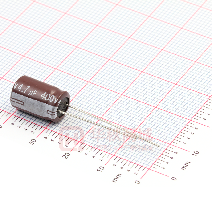

    AISHI(艾华集团)
    插件,D8xL12mm
    直插铝电解电容 插件,D8xL12mm 4.7µF ±20% Ф8.00 x 12.00mm 400V 140mA 6000Hrs@105℃
EGS2GM4R7F12OT 数据手册
MINIATURE ALUMINUM ELECTROLYTIC CAPACITORS CD11GHS series Upgrade Upgrade for CD11GH Series, longer life, better performance, cost-effective CD11GH CD11GHS CD11GHS 105 C 1808 Endurance: +105°C 6,000 hours Suitable for electronic ballast and electronic energy saving lamp. RoHS Compliant SPECIFICATIONS Items Characteristics Category Temperature Range -40~+105°C Rated Voltage Range 140~500 V dc Capacitance Tolerance ±20%(M) (at 20°C,120Hz) 140~400 V dc 450~500 V dc I≤0.02CV+10μA I≤0.03CV+10μA Leakage Current Where, I: Max.leakage current (μA),C:Nominal capacitance (μF), V: Rated voltage (V) (at 20°C after 2 minutes) Rated Voltage(V dc ) 140 160 200 250 315 350 400 450 500 tanδ (max.) 0.15 0.15 0.15 0.15 0.20 0.20 0.20 0.20 0.24 Rated Voltage(V dc ) 140 160 200 250 315 350 400 450 500 Z(-25°C)/Z(+20°C) 3 3 3 3 5 5 5 6 6 Z(-40°C)/Z(+20°C) 6 6 6 6 6 6 6 9 15 Dissipation Factor (tanδ) Low Temperature Characteristics (Max. Impedance Ratio) (at 20°C,120Hz) (at 120Hz) The specifications listed below shall be met when the capacitors are restored to 20°C after DC voltage plus rated ripple current is applied for 6,000 hours at 105°C,the peak voltage shall not exceed the rated voltage. Endurance Capacitance Change ≤±20% of the initial value D.F. (tanδ) ≤200% of the initial specified value Leakage Current ≤The initial specified value The following specifications shall be satisfied when the capacitors are restored to 20°C after leaving them under no load at 105°C for 1,000 hours. Shelf Life Capacitance Change ≤±20% of the initial value D.F. (tanδ) ≤200% of the initial specified value Leakage Current ≤200% of the initial specified value DIMENSIONS[mm] Ød ØD' F±0.5 L' 4min. 15min. ( Ø 6.3~ Ø 22) ØD 6.3 Ød 0.5 F ØD' L' 2.5 8 0.5 0.6 3.5 10 12.5 13 16 18 22 0.6 0.6 0.6 0.8 0.8 0.8 5.0 5.0 5.0 7.5 7.5 10 Ø D+0.5max. L+2max. Radial Type Sleeve(Brown) PART NUMBERING SYSTEM E GS 2G M 3R3 F12 O- - T Sleeve Code: “C” for PVC, “T” for PET Terminal code Size code Capacitance code Capacitance tolerance code Voltage code Series code Category code RATED RIPPLE CURRENT MULTIPLIERS Frequency correction factor for ripple current Freq.(Hz) Rated voltage(Vdc) 140~500 120 1k 10k 100k 0.50 0.80 0.90 1.00 118 MINIATURE ALUMINUM ELECTROLYTIC CAPACITORS CD11GHS series STANDARD RATINGS (Rated ripple current: mArms/105°C 100kHz) WV (Vdc) 140(2A) Cap (µF) Size ΦD×L(mm) 10 Rated ripple current PartNumber 6.3×12 100 EGS2AM100E12OT 15 6.3×12 125 EGS2AM150E12OT 22 8×12 250 EGS2AM220F12OT 33 10×12 365 EGS2AM330G12OT 47 8×20 430 EGS2AM470F20OT 68 10×20 520 EGS2AM680G20OT 100 12.5×16 650 EGS2AM101W16OT 150 12.5×25 750 EGS2AM151W25OT 220 16×20 850 EGS2AM221L20OT 6.3×7 34 EGS2CM010E07OT 6.3×9 36 EGS2CM010E09OT 6.3×7 38 EGS2CM1R5E07OT 6.3×9 45 EGS2CM1R5E09OT 6.3×7 49 EGS2CM1R8E07OT 6.3×9 50 EGS2CM1R8E09OT 6.3×7 53 EGS2CM2R2E07OT 6.3×9 56 EGS2CM2R2E09OT 6.3×7 58 EGS2CM2R8E07OT 6.3×9 62 EGS2CM2R8E09OT 6.3×7 62 EGS2CM3R3E07OT 6.3×9 67 EGS2CM3R3E09OT 6.3×7 68 EGS2CM4R7E07OT 6.3×9 72 EGS2CM4R7E09OT 6.3×9 75 EGS2CM5R6E09OT 6.3×12 79 EGS2CM5R6E12OT 6.3×9 84 EGS2CM6R8E09OT 6.3×12 89 EGS2CM6R8E12OT 6.3×12 120 EGS2CM8R2E12OT 8×9 135 EGS2CM8R2F09OT 8×9 165 EGS2CM100F09OT 8×12 206 EGS2CM100F12OT 8×9 215 EGS2CM150F09OT 8×12 230 EGS2CM150F12OT 8×12 306 EGS2CM220F12OT 8×16 340 EGS2CM220F16OT 10×12 400 EGS2CM330G12OT 10×16 425 EGS2CM330G16OT 10×16 460 EGS2CM470G16OT 10×20 500 EGS2CM470G20OT 10×20 560 EGS2CM680G20OT 12.5×16 570 EGS2CM680W16OT 12.5×20 665 EGS2CM820W20OT 12.5×20 720 EGS2CM101W20OT 12.5×25 740 EGS2CM101W25OT 12.5×25 780 EGS2CM151W25OT 16×20 780 EGS2CM151L20OT 220 16×25 980 EGS2CM221L25OT 330 18×30 1145 EGS2CM331M30OT 6.3×7 35 EGS2DM010E07OT 6.3×9 38 EGS2DM010E09OT 6.3×7 49 EGS2DM1R5E07OT 6.3×9 50 EGS2DM1R5E09OT 6.3×7 50 EGS2DM1R8E07OT 6.3×9 54 EGS2DM1R8E09OT 6.3×7 55 EGS2DM2R2E07OT 6.3×9 60 EGS2DM2R2E09OT 6.3×7 61 EGS2DM2R8E07OT 6.3×9 68 EGS2DM2R8E09OT 6.3×7 68 EGS2DM3R3E07OT 6.3×9 74 EGS2DM3R3E09OT 6.3×9 82 EGS2DM4R7E09OT 6.3×12 90 EGS2DM4R7E12OT 6.3×12 95 EGS2DM5R6E12OT 8×9 95 EGS2DM5R6F09OT 1 1.5 1.8 2.2 2.8 3.3 4.7 5.6 6.8 160(2C) 8.2 10 15 22 33 47 68 82 100 150 1 1.5 1.8 2.2 200(2D) 2.8 3.3 4.7 5.6 WV (Vdc) Cap (µF) 6.8 8.2 10 15 22 200(2D) 33 47 68 82 100 150 1 1.5 1.8 2.2 2.8 3.3 4.7 5.6 6.8 250(2E) 8.2 10 15 22 33 47 68 82 100 150 Size ΦD×L(mm) Rated ripple current PartNumber 8×9 105 EGS2DM6R8F09OT 8×12 120 EGS2DM6R8F12OT 8×9 150 EGS2DM8R2F09OT 8×12 160 EGS2DM8R2F12OT 8×9 170 EGS2DM100F09OT 8×12 185 EGS2DM100F12OT 8×12 225 EGS2DM150F12OT 8×16 250 EGS2DM150F16OT 8×16 360 EGS2DM220F16OT 10×16 400 EGS2DM220G16OT 10×16 425 EGS2DM330G16OT 10×20 450 EGS2DM330G20OT 10×20 550 EGS2DM470G20OT 12.5×16 550 EGS2DM470W16OT 12.5×20 635 EGS2DM680W20OT 12.5×25 700 EGS2DM680W25OT 12.5×20 705 EGS2DM820W20OT 12.5×25 735 EGS2DM101W25OT 16×20 735 EGS2DM101L20OT 16×25 855 EGS2DM151L25OT 16×30 920 EGS2DM151L30OT 6.3×7 36 EGS2EM010E07OT 6.3×9 40 EGS2EM010E09OT 6.3×7 51 EGS2EM1R5E07OT 6.3×9 54 EGS2EM1R5E09OT 6.3×7 55 EGS2EM1R8E07OT 6.3×9 59 EGS2EM1R8E09OT 6.3×7 64 EGS2EM2R2E07OT 6.3×9 71 EGS2EM2R2E09OT 6.3×7 71 EGS2EM2R8E07OT 6.3×9 75 EGS2EM2R8E09OT 6.3×9 78 EGS2EM3R3E09OT 6.3×12 83 EGS2EM3R3E12OT 6.3×12 91 EGS2EM4R7E12OT 8×9 97 EGS2EM4R7F09OT 8×12 102 EGS2EM4R7F12OT 8×9 95 EGS2EM5R6F09OT 8×12 105 EGS2EM5R6F12OT 8×9 105 EGS2EM6R8F09OT 8×12 109 EGS2EM6R8F12OT 8×9 120 EGS2EM8R2F09OT 8×12 132 EGS2EM8R2F12OT 8×12 170 EGS2EM100F12OT 8×16 210 EGS2EM100F16OT 8×16 295 EGS2EM150F16OT 10×12 295 EGS2EM150G12OT 8×16 360 EGS2EM220F16OT 10×16 400 EGS2EM220G16OT 10×20 480 EGS2EM330G20OT 12.5×16 480 EGS2EM330W16OT 12.5×16 560 EGS2EM470W16OT 12.5×20 627 EGS2EM470W20OT 12.5×25 675 EGS2EM680W25OT 16×20 675 EGS2EM680L20OT 16×20 730 EGS2EM820L20OT 16×25 760 EGS2EM820L25OT 16×20 780 EGS2EM101L20OT 16×25 820 EGS2EM101L25OT 16×30 930 EGS2EM151L30OT 18×25 930 EGS2EM151M25OT 119 MINIATURE ALUMINUM ELECTROLYTIC CAPACITORS CD11GHS series STANDARD RATINGS(Rated ripple current: mArms/105°C 100kHz) 315(2F) Cap (µF) PartNumber 6.3×9 71 EGS2FM2R2E09OT 3.3 6.3×9 78 EGS2FM3R3E09OT 4.7 6.3×12 95 EGS2FM4R7E12OT 5.6 8×9 100 EGS2FM5R6F09OT 6.8 8×9 110 EGS2FM6R8F09OT 8.2 8×12 130 EGS2FM8R2F12OT 10 10×12 215 EGS2FM100G12OT 15 10×16 325 EGS2FM150G16OT 22 10×20 420 EGS2FM220G20OT 33 12.5×20 540 EGS2FM330W20OT 47 12.5×20 630 EGS2FM470W20OT 6.3×7 52 EGS2VM010E07OT 6.3×9 58 EGS2VM010E09OT 6.3×7 62 EGS2VM1R5E07OT 6.3×9 68 EGS2VM1R5E09OT 6.3×9 74 EGS2VM1R8E09OT 6.3×12 80 6.3×9 1.5 1.8 2.2 2.8 3.3 4.7 5.6 6.8 8.2 10 15 22 33 47 68 82 100 1 1.5 1.8 2.2 400(2G) Rated ripple current 2.2 1 350(2V) Size ΦD×L(mm) 2.8 3.3 4.7 5.6 6.8 WV (Vdc) Cap (µF) Size ΦD×L(mm) Rated ripple current PartNumber 10×12 200 EGS2GM8R2G12OT 10×16 220 EGS2GM8R2G16OT 10×12 230 EGS2GM100G12OT 10×16 252 EGS2GM100G16OT 12 10×16 262 EGS2GM120G16OT 15 10×20 300 EGS2GM150G20OT 12.5×16 370 EGS2GM220W16OT 12.5×20 400 EGS2GM220W20OT 12.5×25 520 EGS2GM330W25OT 13×20 465 EGS2GM330K20OT 16×20 520 EGS2GM330L20OT 47 16×20 580 EGS2GM470L20OT 56 16×25 650 EGS2GM560L25OT 16×30 760 EGS2GM680L30OT 18×25 760 EGS2GM680M25OT 82 18×25 810 EGS2GM820M25OT EGS2VM1R8E12OT 100 18×30 920 EGS2GM101M30OT 85 EGS2VM2R2E09OT 150 18×40 1280 EGS2GM151M40OT 6.3×12 90 EGS2VM2R2E12OT 6.3×9 60 EGS2WM010E09OT 8×9 101 EGS2VM2R8F09OT 6.3×12 65 EGS2WM010E12OT 8×12 106 EGS2VM2R8F12OT 8×9 70 EGS2WM1R5F09OT 8×9 106 EGS2VM3R3F09OT 8×12 75 EGS2WM1R5F12OT 8×12 110 EGS2VM3R3F12OT 8×9 81 EGS2WM1R8F09OT 8×9 112 EGS2VM4R7F09OT 8×12 90 EGS2WM1R8F12OT 8×12 120 EGS2VM4R7F12OT 8×9 93 EGS2WM2R2F09OT 8×12 130 EGS2VM5R6F12OT 8×12 103 EGS2WM2R2F12OT 8×16 150 EGS2VM5R6F16OT 8×9 105 EGS2WM2R8F09OT 8×12 160 EGS2VM6R8F12OT 8×12 115 EGS2WM2R8F12OT 8×16 170 EGS2VM6R8F16OT 8×12 116 EGS2WM3R3F12OT 8×16 190 EGS2VM8R2F16OT 8×16 128 EGS2WM3R3F16OT 8×20 230 EGS2VM100F20OT 8×12 130 EGS2WM4R7F12OT 10×12 210 EGS2VM100G12OT 8×16 140 EGS2WM4R7F16OT 10×16 280 EGS2VM150G16OT 10×12 150 EGS2WM5R6G12OT 10×20 310 EGS2VM150G20OT 10×16 162 EGS2WM5R6G16OT 10×20 385 EGS2VM220G20OT 10×12 170 EGS2WM6R8G12OT 12.5×16 400 EGS2VM220W16OT 10×16 180 EGS2WM6R8G16OT 12.5×20 515 EGS2VM330W20OT 10×16 210 EGS2WM8R2G16OT 12.5×25 535 EGS2VM330W25OT 10×20 230 EGS2WM8R2G20OT 16×20 650 EGS2VM470L20OT 10×16 235 EGS2WM100G16OT 16×25 760 EGS2VM680L25OT 10×20 250 EGS2WM100G20OT 18×20 760 EGS2VM680M20OT 12.5×16 320 EGS2WM150W16OT 16×30 910 EGS2VM820L30OT 12.5×20 350 EGS2WM150W20OT 18×25 910 EGS2VM820M25OT 12.5×20 425 EGS2WM220W20OT 16×30 960 EGS2VM101L30OT 12.5×25 450 EGS2WM220W25OT 18×25 960 EGS2VM101M25OT 33 16×20 510 EGS2WM330L20OT 6.3×7 63 EGS2GM010E07OT 47 16×25 640 EGS2WM470L25OT 6.3×9 70 EGS2GM010E09OT 68 18×25 760 EGS2WM680M25OT 6.3×9 72 EGS2GM1R5E09OT 82 18×30 860 EGS2WM820M30OT 6.3×12 78 EGS2GM1R5E12OT 100 18×35 920 EGS2WM101M35OT 6.3×9 80 EGS2GM1R8E09OT 150 18×45 1100 EGS2WM151M45OT 6.3×12 85 EGS2GM1R8E12OT 12.5×20 259 EGS2HM100W20OT 6.3×9 85 EGS2GM2R2E09OT 12.5×25 272 EGS2HM100W25OT 6.3×12 90 EGS2GM2R2E12OT 12.5×25 356 EGS2HM150W25OT 8×12 105 EGS2GM2R2F12OT 16×20 356 EGS2HM150L20OT 8×9 105 EGS2GM2R8F09OT 12.5×35 453 EGS2HM220W35OT 8×12 110 EGS2GM2R8F12OT 16×25 453 EGS2HM220L25OT 8×9 110 EGS2GM3R3F09OT 33 18×25 567 EGS2HM330M25OT 8×12 120 EGS2GM3R3F12OT 47 18×30 713 EGS2HM470M30OT 8×9 125 EGS2GM4R7F09OT 56 18×30 770 EGS2HM560M30OT 8×12 140 EGS2GM4R7F12OT 18×35 900 EGS2HM680M35OT 8×12 150 EGS2GM5R6F12OT 22×35 1000 EGS2HM680O35OT 10×12 160 EGS2GM5R6G12OT 82 22×35 1150 EGS2HM820O35OT 8×12 165 EGS2GM6R8F12OT 100 22×35 1400 EGS2HM101O35OT 10×12 180 EGS2GM6R8G12OT 8.2 10 22 400(2G) 33 68 1 1.5 1.8 2.2 2.8 3.3 4.7 5.6 450(2W) 6.8 8.2 10 15 22 10 15 22 500(2H) 68 120 Radial Type WV (Vdc)
