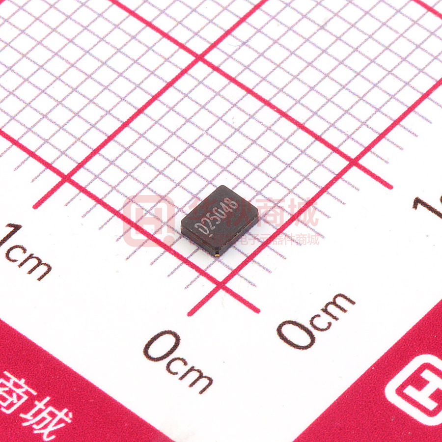

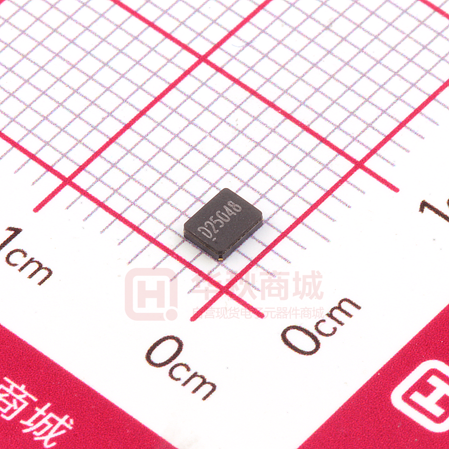

DATE 28-Apr-18 P/N 1N225000BC0CK SPECIFICATION OF SURFACE MOUNT TYPE 1 .TYPE DSX321G 2 .NOMINAL FREQUENCY MHz 25.000000 3 .LOAD CAPACITANCE(CL) 20.0 pF 4 .DRIVE LEVEL 10 uW 5 .FREQUENCY TOLERANCE +/- 20 6 .SERIES RESISTANCE 50 7 .FREQUENCY CHARACTERISTICS OVER TEMPERATURE +/- 8 .OPERATING TEMPERATURE RANGE -40 deg.C to +85 deg.C 9 .STORAGE TEMPERATURE RANGE -40 deg.C to +85 deg.C +/- 2 × 10-6 at ohms max. / × 10-6 / 30 pF uW 25 deg.C +/CL = SERIES -40 deg.C to +85 deg.C (ref. +25 deg.C) 10 .SHUNT CAPACITANCE(C0) 2.0 11 .INSULATION RESISTANCE 500 Mohms min. at 100V DC max. 12 .OVERTONE ORDER Fundamental 13 .DIMENSIONS Refer to Fig-1 0 .15 (1 )(2 )(3 ) 2 .50 3 .20 (1). Logo and Manufacturing Location THAILAND Logo 3 deg.C F requency Lo t No . 0 .75 + / -0 .15 (2). Freq. (3). Lot No. 2 .10 C0 .30 #2 #4 #3 < To p V iew > 0 .70 1 .60 #1 # 4 # 3 # 1 # 2 0 .90 unit : mm Tolerance : +/-0.1 Pin #2 #4 is not connected with anything. Pin #2 #4 must be connected with GND. Fig.-1 25
