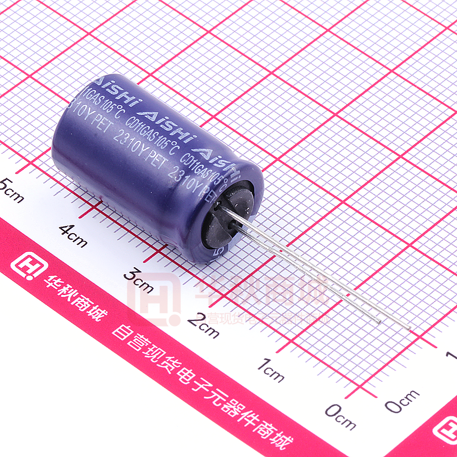

MINIATURE ALUMINUM ELECTROLYTIC CAPACITORS
CD11GAS series
Upgrade
Miniaturized, long life
Endurance: +105 °C 8,000~10,000 hours
CD11GA
CD11GAS 105 C
1808
CD11GAS
RoHS Compliant
SPECIFICATIONS
Items
Characteristics
Category Temperature Range
-40~+105°C
Rated Voltage Range
140~500 V dc
Capacitance Tolerance
±20%(M)
(at 20°C,120Hz)
140~400 V dc
450~500 V dc
I≤0.02CV+10μA
I≤0.03CV+10μA
Leakage Current
Where, I: Max.leakage current (μA),C:Nominal capacitance (μF),
V: Rated voltage (V)
(at 20°C after 2 minutes)
Rated Voltage(V dc )
140
160
200
250
315
350
400
450
500
tanδ (max.)
0.15
0.15
0.15
0.15
0.20
0.20
0.20
0.20
0.24
140
160
200
250
315
350
400
450
500
Z(-25°C)/Z(+20°C)
3
3
3
3
5
5
5
6
6
Z(-40°C)/Z(+20°C)
6
6
6
6
6
6
6
9
15
Dissipation Factor (tanδ)
Low Temperature
Characteristics
(Max. Impedance Ratio)
(at 20°C,120Hz)
(at 120Hz)
The specifications listed below shall be met when the capacitors are restored to 20°C after DC voltage plus the rated ripple current
is applied for 10,000 hours at 105°C(WV:500V for 8,000 hours),the peak voltage shall not exceed the rated voltage.
Endurance
Capacitance Change
≤±20% of the initial value
D.F. (tanδ)
≤200% of the initial specified value
Leakage Current
≤The initial specified value
The following specifications shall be satisfied when the capacitors are restored to 20°C after leaving them under no load
at 105°C for 1,000 hours.
Shelf Life
Capacitance Change
D.F. (tanδ)
Leakage Current
DIMENSIONS[mm]
Ød
ØD'
F±0.5
L'
4min.
15min.
( Ø 6.3~ Ø 22)
ØD
6.3
Ød
0.5
F
ØD'
L'
2.5
8
0.5
0.6
3.5
10
12.5
16
18
22
0.6
0.6
0.8
0.8
0.8
5.0
5.0
7.5
7.5
10
Ø D+0.5max.
L+2max.
Radial Type
Sleeve(Violet)
