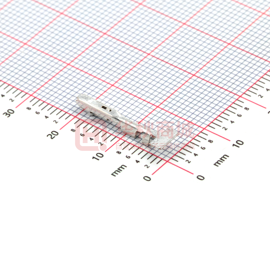

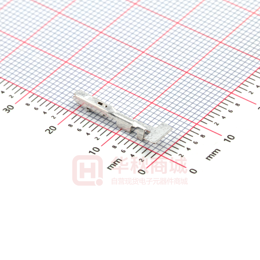

OCS 1.2 SERIES BENEFITS • Cavity compatible with industry standards and/or major OEM cavity preferences • Wide range of crimp sizes with Aptiv proven crimp technology • Meets or exceeds major OEM test protocols and requirements • Contact tongue overstress and nose protection • High performance copper alloy • One-piece terminal construction FEATURES OCS 1.2 Female & Male Terminals • 6+ sigma projected reliability at 150,000 miles (241,401 km) • Robust powertrain contact geometry that is severe vibration capable • Up to 11% less mass than competing product • For use in unsealed & mat sealed 1.2 applications • Independent secondary lock compatible AVAILABLE CONFIGURATIONS Terminal Type Box & Blade Locking Mechanism Tangless / Lanceless Crimp Validated to USCAR-21 Blade Size (mm) 1.2 Wire Gage Range (AWG) 25 - 15 Wire Gage Range (mm²) 0.13 - 1.5 Genders Female, Male Sealing Options Unsealed, matte/block sealed Plating Options Sn, Sn/Ag, Ag, Au/Pd See back page for representative part numbers and packaging dimensions. About Aptiv Aptiv is a global technology company that develops safer, greener and more connected solutions enabling the future of mobility. Headquartered in Dublin, Aptiv has approximately 150,000 employees and operates 14 technical centers, as well as manufacturing sites and customer support centers in 45 countries. Visit aptiv.com aptiv.com | © 2019 Aptiv. All rights reserved TEMPERATURE VIBRATION +125°C 30 G -40°C CONTACT MATING FORCE 1.8 N MAX CURRENT 16.5 A with 1.5 mm² Sealing Gender Plating Wire size range (AWG) Wire size range (mm²) Part number Other available platings Other available configurations Unsealed/Matte Sealed F Sn 21 0.35 - 0.5 35072391 Sn/Ag, Ag, Au/Pd N/A Unsealed/Matte Sealed F Sn 18 0.75 - 0.8 35072392 Sn/Ag, Ag, Au/Pd N/A Unsealed/Matte Sealed F Sn 17 0.8 - 1.0 35072393 Sn/Ag, Ag, Au/Pd N/A Unsealed/Matte Sealed F Sn 25 0.13 - 0.22 35072402 Ag N/A Unsealed/Matte Sealed F Sn 21 0.35 - 0.5 35072403 Ag N/A Unsealed/Matte Sealed F Sn 18 0.75 - 0.8 35072404 Ag N/A Unsealed/Matte Sealed F Sn 17 0.8 - 1.0 35072405 Ag N/A Unsealed/Matte Sealed F Sn 15 1.25 - 1.5 35072406 Ag N/A Unsealed/Matte Sealed M Sn 15 1.25 - 1.5 35091060 Ag N/A Unsealed/Matte Sealed M Sn 18 0.75 - 1.0 35091061 Ag N/A Unsealed/Matte Sealed M Sn 21 0.35 - 0.50 35091062 Ag N/A Unsealed/Matte Sealed M Sn 25 0.13 - 0.22 35091063 Ag N/A Please, contact an Aptiv representative for the full part number list. TEMP RISE CURVE OCS 1.2 Series Female Terminal 80 70 0.13 mm² 0.5 mm2 0.22 mm2 0.8 mm2 0.35 mm 1.0 mm2 Aptiv taxi: Cable range: Crimp method: Contact plating: Test method: Mated to: 13543112 0.13 - 1.5 mm2 Standard CuNiSi Single circuit in free air* OCS 1.2 male terminals * For reference only TEMPERATURE RISE (°C) 2 60 1.5 mm2 50 40 30 The test data was collected from single circuits in a draft free enclosure. This model does not account for all of the variables that would be present in an actual application. 20 10 0 0 2 4 6 8 10 12 14 CURRENT (AMPS) 16 18 20 22 For additional detailed product performance, visit our website at aptiv.com COMPATIBLE WITH OCS 1.2 Sealed Series Housings OCS 1.2 Unsealed Series Housings Part numbers, specifications, dimensions and performance data in this document are for general references only and are subject to change without notice. To verify product information, please contact an Aptiv representative. CS-SP82-OCS-En0519 aptiv.com | © 2019 Aptiv. All rights reserved Mouser Electronics Authorized Distributor Click to View Pricing, Inventory, Delivery & Lifecycle Information: Aptiv: 35072402 35072403 35072404 35072405 35072406 35091060 35091063
