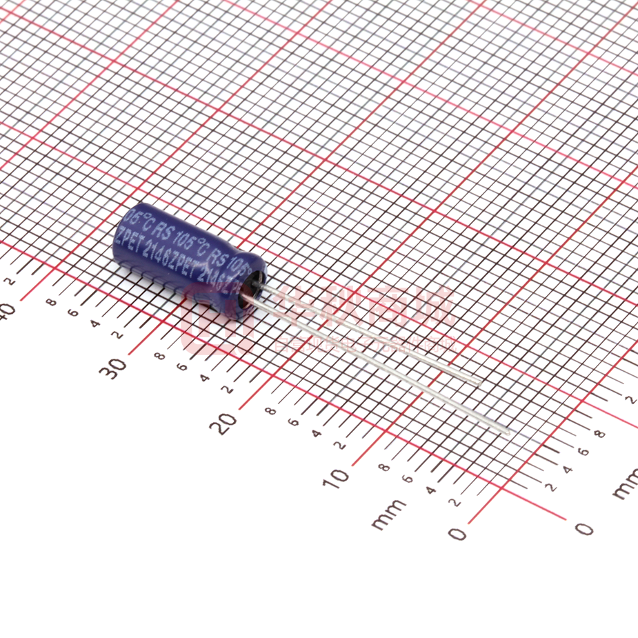

    直插铝电解电容 插件,D5xL11mm 47µF ±20% Ф5.00 x 11.00mm 25V 570mΩ 200mA 5000Hrs@105℃
ERS1EM470D11OT 数据手册
MINIATURE ALUMINUM ELECTROLYTIC CAPACITORS RS series High performance, high reliability Low impedance, high ripple current, long life RS 105 C 1808 Endurance:+105°C 4,000~10,000 hours RoHS Compliant SPECIFICATIONS Items Characteristics Category Temperature Range -40~+105°C Rated Voltage Range 6.3~120 V dc Capacitance Tolerance ±20%(M) Leakage Current I≤0.01CV or 3μA, whichever is greater. Where, I:Max.leakage current (μA),C:Nominal capacitance (μF),V: Rated voltage (V) (at 20°C,120Hz) Rated Voltage(V dc ) Dissipation Factor (tanδ) 6.3 10 16 25 35 0.22 0.19 0.16 0.14 0.12 tanδ (max.) (at 20°C after 2 minutes) 50 63 80 100 120 0.10 0.09 0.08 0.08 0.12 When nominal capacitance exceeds 1,000μF, add 0.02 to the value above for each 1,000μF increase. (at 20°C,120Hz) Low Temperature Characteristics (Max. Impedance Ratio) 6.3 10 Z(-25°C)/Z(+20°C) 4 3 Z(-40°C)/Z(+20°C) 8 6 Rated Voltage(V dc ) 16 25 35 50 4 63 80 100 120 2 3 3 6 (at 120Hz) The specifications listed below shall be met when the capacitors are restored to 20°C after DC voltage plus rated ripple current is applied for a specified period of time at 105 °C. Load life (hours) Dia.(mm) 16~120V 6.3~10V Capacitance Change ≤±20% of the initial value (6.3,10V:≤±30%) ØD≤6.3 4,000 5,000 D.F. (tanδ) ≤200% of the initial specified value ØD=8&10 6,000 7,000 Leakage Current ≤The initial specified value ØD≥12.5 8,000 10,000 Endurance The following specifications shall be satisfied when the capacitors are restored to 20°C after leaving them under no load at 105°C for 1,000 hours. Shelf Life Capacitance Change ≤±20% of the initial value (6.3,10V:≤±30%) D.F. (tanδ) ≤200% of the initial specified value Leakage Current ≤200% of the initial specified value DIMENSIONS[mm] Sleeve(Violet) Ød ØD' F±0.5 L' 4min. 15min. ( Ø 5~ Ø 18) ØD 5 6.3 Ød F ØD' L' 0.5 0.5 2.0 2.5 8 0.5 0.6 3.5 10 12.5 16 18 0.6 0.6 0.8 0.8 5.0 5.0 7.5 7.5 Ø D+0.5max. L+2max. PART NUMBERING SYSTEM E RS 1H M 220 D12 O- - T Sleeve Code: “C” for PVC, “T” for PET Terminal code Size code Capacitance code Capacitance tolerance code Voltage code Series code Category code RATED RIPPLE CURRENT MULTIPLIERS Frequency correction factor for ripple current Freq.(Hz) Cap.(μF) 120 1k 10k 100k Cap.
ERS1EM470D11OT
物料型号:AiSHi RS系列小型铝电解电容器。
器件简介:该系列电容器具有高性能和高可靠性,低阻抗,高纹波电流,长寿命。在105°C的条件下,寿命可达4,000至10,000小时,符合RoHS标准。
引脚分配:文档中未明确提供引脚分配信息,但通常电解电容器有正负两个引脚。
参数特性: - 工作温度范围:-40°C至+105°C。 - 额定电压范围:6.3V直流至120V直流。 - 电容公差:+20%(M),在20°C、120Hz时测量。 - 漏电流:在20°C下2分钟后,取0.01CV或3pA中较大的值,其中I为最大漏电流(A),C为标称电容(F),V为额定电压(V)。
功能详解:电容器在规定的条件下,如105°C和额定纹波电流下,能够保持特定的性能,例如电容变化不超过初始值的+20%,损耗角正切值(tano)不超过初始标称值的200%。
应用信息:适用于需要小型化、高可靠性和长寿命的应用场合。
封装信息:提供了详细的尺寸信息,包括外径(OD)、长度(L)、以及不同尺寸的电容器的标称电容和电压等级。
