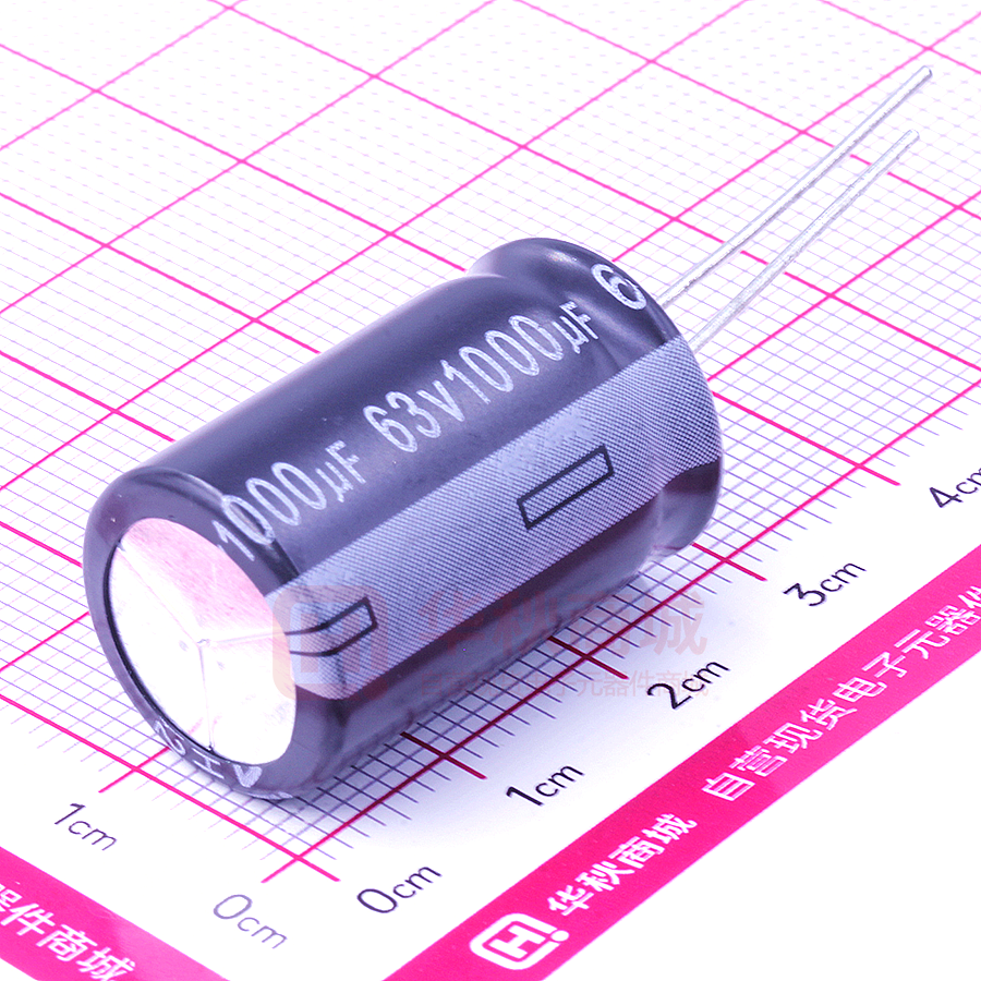

    直插铝电解电容 插件,D16xL25mm 1mF ±20% Ф16.00 x 25.00mm 63V 930mA 2000Hrs@105℃
EWH1JM102L25OT 数据手册
MINIATURE ALUMINUM ELECTROLYTIC CAPACITORS WH series Standard series for general purpose Wide temperature range from -40 °C to +105 °C WH 105 C 1808 Endurance: +105 °C 2,000 hours RoHS Compliant SPECIFICATIONS Items Characteristics Category Temperature Range -40~+105 °C (6.3~400 V dc ) Rated Voltage Range 6.3~500 V dc Capacitance Tolerance ±20%(M) -25~+105°C(450~500 V dc ) (at 20°C,120Hz) 6.3~100 V dc Leakage Current I≤0.03CV or 4μA (at 1 minute) I≤0.01CV or 3μA (at 2 minutes) Whichever is greater Rated Voltage(V dc ) Dissipation Factor (tanδ) Where, I:Max. leakage current (μA), C:Nominal capacitance (μF), CV After 1 minute After 5 minutes V: Rated voltage (V) CV≤1,000 I≤0.1CV+40μA I≤0.03CV+15μA (at 20°C) CV>1,000 I≤0.04CV+100μA I≤0.02CV+25μA 160~500 V dc 6.3 10 16 25 35 0.26 0.19 0.16 0.14 0.12 tanδ (max.) 50 63 100 0.10 0.09 0.08 160~250 350~400 450 0.20 0.24 0.24 500 0.24 When nominal capacitance exceeds 1,000μF, add 0.02 to the value above for each 1,000μF increase. (at 20°C,120Hz) Low Temperature Characteristics (Max. Impedance Ratio) Rated Voltage(V dc ) 6.3 10 16 Z(-25°C)/Z(+20°C) 5 4 3 Z(-40°C)/Z(+20°C) 12 10 8 25 35 50 63 100 160~250 350~400 450 2 5 4 3 500 3 6 6 8 7 10 - - (at 120Hz) The following specifications shall be satisfied when the capacitors are restored to 20°C after DC voltage plus the rated ripple current is applied for 2,000 hours at 105°C. Endurance Capacitance Change ≤±20% of the initial value D.F. (tanδ) ≤200% of the initial specified value Leakage Current ≤The initial specified value The following specifications shall be satisfied when the capacitors are restored to 20°C after exposing them for 1,000 hours at 105°C without voltage applied. Shelf Life Capacitance Change ≤±20% of the initial value D.F. (tanδ) ≤200% of the initial specified value Leakage Current ≤200% of the initial specified value DIMENSIONS[mm] Sleeve(Black) Ød ØD' F±0.5 L' 4min. 15min. ( Ø 5~ Ø 22) ØD 5 6.3 Ød 0.5 0.5 F ØD' L' 2.0 2.5 8 0.5 0.6 3.5 10 12.5 16 18 22 0.6 0.6 0.8 0.8 0.8 5.0 5.0 7.5 7.5 10.0 Ø D+0.5max. L+2max. PART NUMBERING SYSTEM E WH 2E M 2R2 E11 O- - T Sleeve Code: “C” for PVC, “T” for PET Terminal code Size code Capacitance code Capacitance tolerance code Voltage code Series code Category code RATED RIPPLE CURRENT MULTIPLIERS Frequency correction factor for ripple current Freq.(Hz) Cap.(μF) 50 120 300 1k 10k 100k Cap.

物料型号:AiSHi WH系列
器件简介:这是一系列小型铝电解电容器,适用于一般用途,具有较宽的工作温度范围(-40°C至+105°C)和较长的寿命(在+105°C下可达到2,000小时)。
引脚分配:文档中没有提供具体的引脚分配信息,但通常这类电容器会有正负两个引脚。
参数特性: - 额定电压范围:6.3Vdc至500Vdc - 电容公差:+20%(M级) - 漏电流:根据电压等级和电容值有不同的规定 - 耗散因数(tano):随额定电压变化,最大值为0.26(在6.3Vdc时) - 低温特性:在-25°C至+20°C下的最大阻抗比 - 耐久性:在105°C下,电容器在施加额定纹波电流2,000小时后,电容变化应小于初始值的+20%,耗散因数不超过初始值的200%,漏电流不超过初始规定值
功能详解:电容器在电源滤波、能量存储等应用中发挥作用,特别是在需要较长寿命和宽温度范围的场合。
应用信息:适用于一般用途,具体应用场景未在文档中详述。
封装信息:提供了详细的尺寸信息,包括外径(OD)、长度(L)和封套颜色(黑色)。还提供了零件编号系统,包括封套代码、端子代码、电容值代码、电容公差代码、电压代码、系列代码和类别代码。
