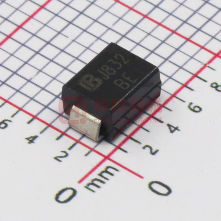

Mechanical Data
Case: JEDEC DO-214AA. Molded plastic over glass passivated junction
Terminal: Tin plated, solderable per MIL-STD-750, Method 2026
Polarity: Color band denotes cathode except bi-directional models
Standard Packaging: 12mm tape (EIA STD RS-481)
Weight: 0.10g

Dimensions (SMB/DO-214AA)
Product:
Symbol
Cathode Band
Millimeters
Inches
Min.
Max.
Min.
Max.
L
4.06
4.57
0.160
0.180
D
3.30
3.94
0.130
0.155
D1
1.95
2.20
0.077
0.086
T
5.21
5.59
0.205
0.220
T1
0.76
1.52
0.030
0.060
d
0.203
0.008
H
2.15
2.65
0.085
0.104
H1
2.13
2.47
0.084
0.097
D1 D
L
H1 H
d
T1
T
2.18mm
Pad:
1.75mm
2.16mm
1.75mm

SMBJ12A
SMBJ12CA
LE
BE
12.0
13.30~14.70
1
19.9
30.2
1
