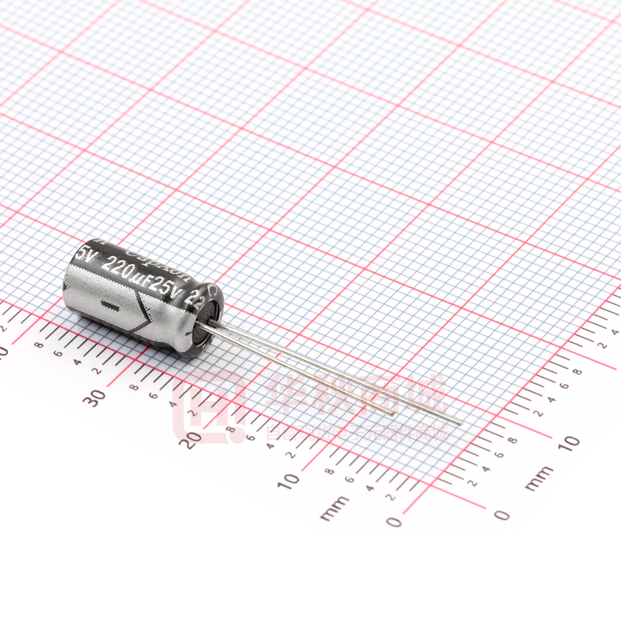

    直插铝电解电容 插件,D6.3xL11mm 220µF ±20% Ф6.30 x 11.00mm 25V 5000Hrs@105℃
GH221M025E110A 数据手册
Updated Series Preliminary Data Sheet GH series *+VHULHV Features ƹLow impedance ƹHigh temperature,long life 5000 to 10000 hours at 105ć ƹAEC-Q200 qualified Specifications Item Operating Temperature Range Rated Voltage Range Capacitance Range Capacitance Tolerance Performance Characteristics -55to +105ć 6.3 to 100 VDC 0.47 to 12000 μF ±20% (120Hz, +20ć) Ḭ0.01CV or 3(uA)(After 2 minute with rated working voltage applied.) Leakage Current (+20ć,max.) Dissipation Factor (tanδˈat 20ćˈ120Hz) Working Voltage(VDC) 6.3 10 16 25 D.F. (%)max. 22 19 16 14 For capacitance>1000uF,add 2% per another 1000uF. 35 12 50 10 63 9 80 9 100 8 Impedance ratio max Working Voltage Low Temperature Characteristics (at 120Hz) Endurance Shelf Life 6.3 10 16 25 35 50 63 80 100 Z-25ćˋZ+20ć 4 3 2 2 1.5 1.5 1.5 1.5 1.5 Z-40ćˋZ+20ć 6 4 3 3 2 2 2 2 2 Z-55ćˋZ+20ć 8 6 5 5 4 4 4 4 4 For capacitance>1000uF,add 0.5 per another 1000uF for -25ć/+20ć add 1 per another 1000uF for -40ć/+20ć add 1.5 per another 1000uF for -55ć/+20ć Test condition Duration time: Dφ 5-6.3φ 8-12φ ̱13φ 5000 hours 7000 hours 10000 hours +105ćLife hours Ambient temperature :+105ć Applied voltage :Rated DC working voltage After test requirement at +20ć Capacitance change :̰±25% of the initial measured value Dissipation factor :̰ 200% of the initial specified value Leakage current :̰ The initial specified value Test conditions Duration time :1000Hrs Ambient temperature :+105ć Applied voltage :None After test requirement at +20ć:Same limits as Endurance. Pre-treatment for measurements shall be conducted after application of DC working voltage for 30 minutes. Multiplier for Ripple Current vs. CAP(uF)ˋFrequency(Hz) CAP̰10 10˘CAP̰100 100˘CAP̰1000 1000˘CAP 120 0.40 0.67 0.75 0.82 400 0.52 0.80 0.84 0.87 1K 0.60 0.83 0.88 0.92 10K 0.92 0.94 0.95 0.95 100K 1.00 1.00 1.00 1.00 Diagram of Dimensions:(unit:mm) Dφ F dφ α 159 5 2.0 8 3.5 6.3 2.5 0.5 D˘18 1.5 10 13 16 5.0 5.0 7.5 L˘20 0.5 Ḻ20 0.6 D=18 L˘35.5 1.5 Ḻ35.5 2.0 0.6 D˚18 2.0 18 7.5 0.8 GH series Case Size Rated Ripple Max ESR( Ω) current at 20ć (Arms/105ć /100kHz /100KHz) WV (Vdc) Cap (uF) Size mm 6.3 6.3 6.3 6.3 6.3 6.3 6.3 6.3 6.3 6.3 6.3 6.3 6.3 6.3 6.3 6.3 6.3 6.3 6.3 6.3 6.3 6.3 6.3 6.3 6.3 6.3 6.3 6.3 6.3 6.3 6.3 6.3 6.3 6.3 6.3 6.3 6.3 6.3 6.3 6.3 6.3 6.3 6.3 6.3 6.3 6.3 6.3 10 10 10 10 10 10 10 10 10 10 10 10 82 100 120 150 180 220 270 330 330 330 390 390 470 470 470 560 560 560 680 680 680 820 820 1000 1000 1000 1200 1200 1500 1500 1500 1800 1800 2200 2200 2700 2700 2700 3300 3300 3900 4700 4700 5600 5600 6800 6800 22 27 33 39 47 56 68 82 100 100 120 120 5×11 5×11 5×11 6.3×11 6.3×11 6.3×11 6.3×11 6.3×11 6.3×15 8×11.5 6.3×15 8×11.5 6.3×15 8×11.5 10×12.5 8×11.5 8×16 10×12.5 8×11.5 8×16 10×12.5 8×11.5 10×12.5 8×16 8×20 10×12.5 8×20 10×16 8×20 10×16 10×20 8×25 10×20 10×20 10×25 10×25 10×30 13×20 10×30 13×20 13×25 13×25 13×30 13×30 16×25 13×30 16×25 5×11 5×11 5×11 5×11 5×11 5×11 5×11 5×11 5×11 6.3×11 5×11 6.3×11 198 210 222 240 282 378 396 396 426 444 462 480 504 534 564 570 600 612 582 618 642 666 720 690 756 708 840 888 1056 1128 1176 1230 1308 1350 1362 1488 1560 1512 1620 1584 1860 1938 1992 1992 2196 2520 2718 66 72 72 120 132 144 162 192 222 240 246 258 10 150 6.3×11 282 Rated Ripple Max ESR( Ω) current at 20ć (Arms/105ć /100kHz /100KHz) WV (Vdc) Cap (uF) Size mm 1.63 1.45 1.28 1.16 1.04 0.89 0.77 0.77 0.68 0.68 0.58 0.52 0.41 0.38 0.38 0.36 0.36 0.36 0.33 0.33 0.33 0.25 0.25 0.22 0.22 0.22 0.18 0.18 0.15 0.12 0.12 0.11 0.11 0.10 0.10 0.09 0.09 0.09 0.085 0.085 0.080 0.075 0.070 0.068 0.068 0.063 0.063 3.08 2.67 2.33 2.02 1.71 1.47 1.30 1.15 1.02 1.02 1.02 1.02 10 10 10 10 10 10 10 10 10 10 10 10 10 10 10 10 10 10 10 10 10 10 10 10 10 10 10 10 10 10 10 10 10 10 10 10 10 10 10 10 10 10 10 10 10 10 10 10 10 10 10 10 10 10 10 10 10 10 10 180 220 220 270 270 330 330 330 390 390 470 470 560 560 560 680 680 680 820 820 820 820 1000 1000 1000 1000 1200 1200 1200 1500 1500 1800 1800 2200 2200 2200 2200 2700 2700 2700 2700 3300 3300 3300 3900 3900 3900 3900 4700 4700 4700 5600 5600 5600 5600 6800 6800 8200 8200 6.3×11 6.3×11 6.3×15 6.3×15 8×11.5 6.3×11 6.3×15 8×11.5 6.3×15 8×11.5 6.3×15 8×11.5 8×11.5 8×16 10×12.5 8×16 8×20 10×12.5 8×16 8×20 10×12.5 10×16 8×16 8×20 10×12.5 10×16 8×20 10×16 10×20 10×20 13×16 10×25 13×20 10×25 10×30 13×20 16×16 10×30 13×20 13×25 18×16 10×30 13×25 16×25 13×25 13×30 16×21 16×25 13×30 13×35 16×25 13×35 16×25 16×31.5 18×21 16×31.5 18×25 16×35.5 18×31.5 318 366 390 414 420 402 462 492 456 516 480 552 588 636 636 660 684 684 732 828 876 936 1020 1122 1032 1140 1248 1272 1368 1536 1620 1650 1704 1776 1860 1872 1926 2076 2028 2124 2241 2232 2268 2316 2304 2376 2362 2544 2484 2568 2634 2640 2473 2736 2460 2964 2866 3350 3392 0.68 0.60 0.58 0.56 0.53 0.50 0.47 0.45 0.42 0.42 0.37 0.30 0.28 0.25 0.25 0.21 0.20 0.20 0.20 0.18 0.16 0.16 0.16 0.14 0.14 0.13 0.13 0.13 0.12 0.106 0.110 0.102 0.098 0.095 0.093 0.093 0.093 0.084 0.084 0.084 0.084 0.070 0.070 0.070 0.065 0.065 0.070 0.065 0.065 0.060 0.057 0.054 0.054 0.050 0.057 0.046 0.052 0.043 0.044 0.95 10 10000 16×41 3850 0.040 160 GH series Case Size WV (Vdc) Cap (uF) Size mm 10 10 16 16 16 16 16 16 16 16 16 16 16 16 16 16 16 16 16 16 16 16 16 16 16 16 16 16 16 16 16 16 16 16 16 16 16 16 16 16 16 16 16 16 16 16 16 16 16 16 16 16 16 16 16 16 16 16 16 16 10000 12000 10 15 22 27 33 39 47 56 68 82 100 100 120 150 150 180 180 220 220 270 270 330 330 330 390 390 390 470 470 470 560 560 560 560 680 680 820 820 820 1000 1000 1200 1200 1500 1500 1500 1800 1800 1800 2200 2200 2200 2700 2700 2700 2700 3300 3300 18×35.5 18×41 5×11 5×11 5×11 5×11 5×11 5×11 5×11 5×11 5×11 6.3×11 5×11 6.3×11 6.3×11 6.3×11 6.3×15 6.3×15 8×11.5 6.3×15 8×11.5 6.3×15 8×11.5 6.3×15 8×11.5 8×16 8×11.5 8×16 10×12.5 8×16 8×20 10×12.5 8×16 8×20 10×12.5 10×16 8×20 10×16 8×20 10×16 10×20 10×16 10×20 10×20 10×25 10×25 13×20 16×16 10×30 13×20 13×25 13×20 13×25 18×16 13×25 13×30 16×21 16×25 13×30 13×35 Rated Ripple Max ESR( Ω) current at 20ć (Arms/105ć /100kHz /100KHz) 3850 4150 36 72 72 132 144 168 186 210 228 264 228 264 312 336 396 420 426 504 540 540 582 588 588 618 612 654 648 846 900 882 864 936 882 960 960 1044 1104 1254 1320 1404 1476 1500 1578 1620 1728 1778 1776 1854 1956 2082 2340 2300 2436 2496 2362 2544 2562 2628 0.041 0.037 3.90 3.32 2.64 2.37 2.00 1.61 1.35 1.24 1.18 1.03 1.10 0.86 0.66 0.58 0.58 0.56 0.54 0.52 0.46 0.42 0.38 0.34 0.37 0.35 0.33 0.33 0.33 0.29 0.28 0.28 0.26 0.24 0.24 0.20 0.20 0.18 0.17 0.15 0.15 0.14 0.12 0.13 0.11 0.096 0.095 0.095 0.097 0.094 0.090 0.090 0.085 0.090 0.076 0.072 0.074 0.072 0.068 0.066 161 WV (Vdc) Cap (uF) Size mm 16 16 16 16 16 16 16 16 16 16 16 16 16 16 25 25 25 25 25 25 25 25 25 25 25 25 25 25 25 25 25 25 25 25 25 25 25 25 25 25 25 25 25 25 25 25 25 25 25 25 25 25 25 25 25 25 25 25 25 25 3300 3900 3900 3900 3900 4700 4700 5600 5600 5600 6800 6800 8200 10000 10 15 22 27 33 39 47 47 56 68 82 100 100 120 120 150 150 180 180 220 220 270 270 270 330 330 470 470 470 560 560 680 680 820 820 1000 1000 1000 1200 1200 1500 1500 1800 1800 1800 2200 16×25 13×35 16×25 16×31.5 18×21 16×31.5 18×25 16×35.5 18×31.5 18×35.5 16×41 18×35.5 18×35.5 18×41 5×11 5×11 5×11 5×11 5×11 5×11 5×11 6.3×11 5×11 6.3×11 6.3×11 6.3×11 8×11.5 6.3×11 6.3×15 6.3×15 8×11.5 6.3×15 8×11.5 8×11.5 8×16 8×11.5 8×16 10×12.5 8×16 10×12.5 8×20 10×12.5 10×16 8×20 10×16 10×20 13×16 10×20 10×25 10×25 13×20 16×16 13×20 18×16 13×20 13×25 13×30 16×21 16×25 13×30 Rated Ripple Max ESR( Ω) current at 20ć (Arms/105ć /100kHz /100KHz) 2700 2664 2736 2856 2721 2886 2844 2968 3084 3168 3252 3252 3750 4150 66 120 144 156 174 174 222 240 264 300 312 360 516 402 462 510 528 546 552 618 642 750 756 816 960 924 1056 1020 1080 1224 1260 1470 1550 1668 1704 1812 1872 1926 2028 2241 2124 2190 2310 2173 2340 2592 0.064 0.050 0.060 0.058 0.060 0.050 0.055 0.046 0.048 0.045 0.040 0.040 0.038 0.036 3.01 2.64 2.30 2.03 1.72 1.50 1.37 1.28 1.25 0.97 0.79 0.68 0.54 0.58 0.56 0.54 0.52 0.51 0.46 0.42 0.40 0.34 0.32 0.32 0.25 0.24 0.23 0.21 0.21 0.17 0.15 0.11 0.10 0.11 0.10 0.093 0.090 0.088 0.082 0.080 0.067 0.065 0.058 0.056 0.058 0.052 GH series Case Size WV (Vdc) Cap (uF) Size mm 25 25 25 25 25 25 25 25 25 25 25 25 25 35 35 35 35 35 35 35 35 35 35 35 35 35 35 35 35 35 35 35 35 35 35 35 35 35 35 35 35 35 35 35 35 35 35 35 35 35 35 35 35 35 35 35 35 35 35 35 2200 2200 2700 2700 2700 3300 3300 3300 3900 3900 4700 4700 5600 10 15 22 27 27 33 33 39 47 47 56 56 68 68 82 82 100 100 100 120 120 150 150 150 180 180 220 220 220 270 270 270 330 330 470 470 470 470 560 560 680 680 680 820 820 1000 1000 16×25 18×21 13×35 16×25 16×31.5 16×31.5 16×35.5 18×25 16×35.5 18×31.5 16×41 18×35.5 18×41 5×11 5×11 5×11 5×11 6.3×11 5×11 6.3×11 6.3×11 5×11 6.3×11 6.3×11 6.3×15 6.3×11 6.3×15 6.3×15 8×11.5 6.3×11 6.3×15 8×11.5 8×11.5 8×16 8×11.5 8×16 10×12.5 8×16 10×12.5 8×16 8×20 10×12.5 8×20 10×12.5 10×16 8×20 10×16 10×20 10×25 13×16 13×20 10×25 13×20 10×25 13×20 16×16 13×20 13×25 10×30 13×25 Rated Ripple Max ESR( Ω) current at 20ć (Arms/105ć /100kHz /100KHz) 2712 2697 2850 2674 2958 3204 3288 3156 3500 3544 3800 3800 4100 84 144 162 174 198 222 240 252 232 264 282 306 312 348 354 384 329 378 414 546 612 618 714 720 792 804 864 936 888 1056 984 1068 1140 1176 1302 1398 1272 1398 1572 1584 1680 1692 1741 1818 1944 2136 2184 0.050 0.052 0.050 0.048 0.046 0.038 0.036 0.041 0.036 0.036 0.034 0.034 0.030 2.65 2.29 1.90 1.58 1.42 1.25 1.25 1.10 0.10 0.92 0.75 0.68 0.62 0.55 0.51 0.47 0.49 0.47 0.45 0.42 0.38 0.38 0.35 0.35 0.32 0.32 0.26 0.24 0.24 0.22 0.24 0.21 0.16 0.15 0.11 0.10 0.11 0.10 0.096 0.096 0.084 0.082 0.080 0.068 0.062 0.060 0.060 162 WV (Vdc) Cap (uF) Size mm 35 35 35 35 35 35 35 35 35 35 35 35 35 35 35 35 35 35 50 50 50 50 50 50 50 50 50 50 50 50 50 50 50 50 50 50 50 50 50 50 50 50 50 50 50 50 50 50 50 50 50 50 50 50 50 50 50 50 50 50 1000 1000 1200 1200 1200 1500 1500 1800 1800 1800 1800 2200 2200 2700 2700 3300 3300 3900 0.47 1 2.2 3.3 4.7 5.6 6.8 8.2 10 15 22 22 27 33 33 39 39 47 47 47 56 56 68 82 82 82 100 100 120 150 150 150 150 180 180 220 220 270 270 270 330 330 13×30 18×16 13×25 16×21 16×25 13×35 16×31.5 13×35 16×25 16×31.5 18×21 16×31.5 18×25 16×35.5 18×31.5 16×41 18×35.5 18×41 5×11 5×11 5×11 5×11 5×11 5×11 5×11 5×11 5×11 5×11 5×11 6.3×11 6.3×11 6.3×11 6.3×15 6.3×11 6.3×15 6.3×11 6.3×15 8×11.5 6.3×11 8×11.5 8×11.5 6.3×15 8×11.5 8×16 8×11.5 8×16 8×16 8×16 8×20 10×12.5 10×16 8×20 10×16 10×16 10×20 10×20 10×25 13×16 10×25 13×20 Rated Ripple Max ESR( Ω) current at 20ć (Arms/105ć /100kHz /100KHz) 2280 2189 2292 2384 2568 2820 2928 2976 2722 3012 2708 3228 3132 3295 3336 3800 3800 4100 12 24 36 48 66 96 96 108 120 150 162 168 192 282 296 306 330 303 348 366 324 378 420 462 492 528 540 576 630 696 756 702 780 864 912 1056 1122 1212 1284 1278 1404 1500 0.058 0.056 0.052 0.052 0.050 0.048 0.048 0.045 0.048 0.045 0.048 0.036 0.036 0.032 0.032 0.029 0.029 0.026 7.23 4.31 3.60 3.50 3.30 3.20 3.00 2.80 2.60 1.87 1.60 1.27 1.02 0.87 0.85 0.72 0.70 0.06 0.55 0.55 0.05 0.47 0.36 0.35 0.32 0.28 0.28 0.25 0.25 0.24 0.24 0.25 0.24 0.24 0.24 0.24 0.20 0.10 0.10 0.10 0.095 0.082 GH series Case Size WV (Vdc) Cap (uF) Size mm 50 50 50 50 50 50 50 50 50 50 50 50 50 50 50 50 50 50 50 50 50 50 50 50 50 63 63 63 63 63 63 63 63 63 63 63 63 63 63 63 63 63 63 63 63 63 63 63 63 63 63 63 63 63 63 63 63 63 63 63 470 470 470 470 560 560 560 680 680 820 820 820 1000 1000 1000 1000 1200 1200 1200 1500 1800 1800 2200 2700 3300 10 15 22 22 27 33 39 47 47 56 68 68 82 82 82 100 100 120 120 120 120 150 150 180 180 180 220 220 220 220 270 270 330 330 330 10×30 13×20 13×25 16×16 13×20 13×25 18×16 13×25 16×25 13×30 16×21 16×31.5 13×40 16×25 16×31.5 18×21 16×31.5 16×35.5 18×25 16×35.5 16×41 18×31.5 18×35.5 18×41 18×41 5×11 5×11 5×11 6.3×11 6.3×11 6.3×11 6.3×11 6.3×11 8×11.5 8×11.5 8×11.5 8×16 8×11.5 8×16 10×12.5 8×16 10×12.5 8×16 8×20 10×12.5 10×16 8×20 10×16 8×25 10×16 10×20 8×25 10×16 10×20 13×16 10×20 13×20 10×25 13×16 13×20 Rated Ripple Max ESR( Ω) current at 20ć (Arms/105ć /100kHz /100KHz) 1750 1776 1860 1827 2094 2172 2314 2304 2376 2412 2085 2484 2750 2676 2736 2662 2952 3048 2854 3216 3550 3368 3550 3790 3810 116 131 151 194 202 228 243 264 313 320 378 477 390 477 481 515 515 512 604 528 639 604 666 742 662 757 789 730 892 911 986 1241 1242 1086 1282 WV (Vdc) Cap (uF) Size mm 63 63 63 63 63 63 63 63 63 63 63 63 63 63 63 63 63 63 63 63 63 63 63 63 63 80 80 80 80 80 80 80 80 80 80 80 80 80 80 80 80 80 80 80 80 80 80 80 80 80 80 80 80 80 80 80 80 80 80 80 330 390 470 470 470 470 560 560 560 680 680 680 820 820 820 1000 1000 1000 1200 1200 1500 1500 1800 1800 2200 10 15 22 27 33 39 47 56 56 68 68 82 82 100 100 100 120 150 150 180 180 180 220 220 270 270 330 330 390 470 470 470 470 560 560 13×25 13×25 13×20 13×25 13×30 16×21 13×25 13×30 16×21 13×30 13×35 16×21 13×40 16×25 18×21 13×45 16×31.5 18×25 16×31.5 18×25 18×31.5 18×35.5 16×41 18×35.5 18×41 5×11 5×11 6.3×11 6.3×11 6.3×11 8×11.5 8×11.5 8×11.5 8×16 8×16 10×12.5 8×16 10×12.5 8×20 10×16 13×16 10×16 10×20 13×16 10×20 10×25 13×16 10×25 13×20 13×20 13×25 13×20 16×21 13×30 13×30 13×35 16×25 18×21 13×40 16×25 0.078 0.078 0.078 0.078 0.075 0.070 0.073 0.057 0.057 0.052 0.054 0.052 0.048 0.050 0.048 0.050 0.045 0.042 0.047 0.038 0.035 0.035 0.032 0.030 0.028 3.02 2.37 1.77 1.39 1.29 1.01 0.89 0.75 0.73 0.70 0.50 0.42 0.47 0.42 0.43 0.36 0.38 0.36 0.32 0.36 0.30 0.32 0.28 0.26 0.28 0.26 0.23 0.23 0.20 0.20 0.16 0.13 0.13 0.15 0.13 163 Rated Ripple Max ESR( Ω) current at 20ć (Arms/105ć /100kHz /100KHz) 1611 1618 1516 1698 1863 1857 1727 1942 1857 2082 2273 1835 2454 2229 2108 2653 2690 2307 2727 2470 2997 3256 3760 3481 3938 100 113 167 174 196 244 265 275 326 380 388 389 388 509 522 634 534 657 665 677 755 721 767 830 890 1019 1060 1253 1427 1533 1711 1432 1471 1685 1479 0.100 0.093 0.093 0.090 0.088 0.082 0.087 0.081 0.082 0.071 0.068 0.084 0.066 0.066 0.073 0.063 0.056 0.071 0.054 0.062 0.051 0.048 0.036 0.042 0.035 4.07 3.20 1.88 1.74 1.37 1.20 1.02 0.95 0.90 0.66 0.66 0.63 0.66 0.45 0.45 0.44 0.43 0.35 0.40 0.33 0.32 0.34 0.31 0.31 0.27 0.25 0.19 0.18 0.15 0.13 0.12 0.16 0.15 0.14 0.15 GH series Case Size WV (Vdc) Cap (uF) Size mm 80 80 80 80 80 80 80 80 80 80 80 80 80 100 100 100 100 100 100 100 100 100 100 100 100 100 100 100 100 100 100 100 100 100 100 100 100 100 100 100 100 100 100 100 100 100 100 100 100 100 100 100 100 100 100 100 100 100 100 100 560 680 680 820 820 1000 1000 1000 1200 1200 1500 1500 1800 4.7 5.6 6.8 8.2 10 10 15 22 22 27 33 39 47 47 47 56 56 56 68 68 82 82 100 100 100 100 100 120 120 120 120 150 150 150 180 180 220 220 220 220 270 270 270 330 330 330 390 18×21 16×31.5 18×25 16×35.5 18×25 16×35.5 16×41 18×31.5 16×41 18×35.5 16×41 18×41 18×41 5×11 5×11 5×11 5×11 6.3×11 8×11.5 6.3×11 6.3×11 8×11.5 8×11.5 8×11.5 8×16 8×16 10×12.5 10×16 8×16 8×20 10×12.5 8×20 10×16 8×20 10×16 8×30 10×16 10×20 13×16 13×20 8×35 10×20 10×25 13×16 10×25 10×30 13×20 13×20 13×25 13×20 13×25 16×16 16×21 10×40 13×30 16×25 13×30 13×35 16×25 13×40 Rated Ripple Max ESR( Ω) current at 20ć (Arms/105ć /100kHz /100KHz) 1471 1757 1582 1929 1699 1929 2151 2041 2378 2315 2461 2641 2657 84 90 96 105 141 180 151 168 228 234 240 282 335 350 357 354 414 364 424 425 474 486 636 522 596 641 750 738 611 702 665 743 834 805 858 963 890 1019 915 1063 1107 1236 1281 1382 1584 1531 1748 0.15 0.13 0.15 0.12 0.13 0.12 0.11 0.11 0.09 0.095 0.084 0.083 0.082 5.75 5.00 4.36 3.68 2.63 2.20 2.31 1.85 1.38 1.31 1.24 1.20 0.85 0.81 0.78 0.76 0.68 0.75 0.65 0.68 0.52 0.52 0.42 0.45 0.42 0.43 0.38 0.36 0.40 0.37 0.40 0.33 0.31 0.33 0.29 0.28 0.27 0.25 0.27 0.25 0.23 0.20 0.20 0.16 0.14 0.14 0.13 164 WV (Vdc) Cap (uF) Size mm 100 100 100 100 100 100 100 100 100 100 100 390 470 470 470 560 560 680 680 820 820 1000 18×25 16×25 16×31.5 18×25 16×35.5 18×31.5 16×35.5 18×35.5 18×35.5 18×41 18×41 Rated Ripple Max ESR( Ω) current at 20ć (Arms/105ć /100kHz /100KHz) 1582 1479 1910 1637 1854 1877 1929 2151 2202 2406 2469 0.15 0.15 0.11 0.14 0.13 0.13 0.12 0.11 0.105 0.100 0.095
