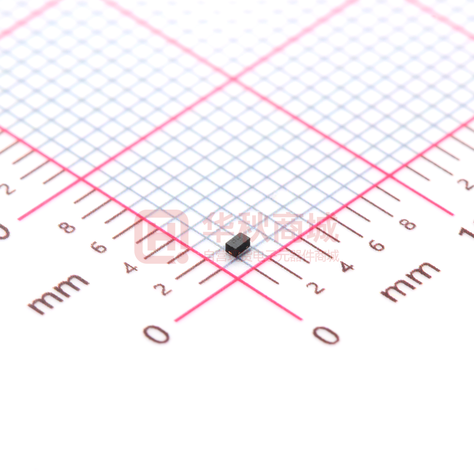

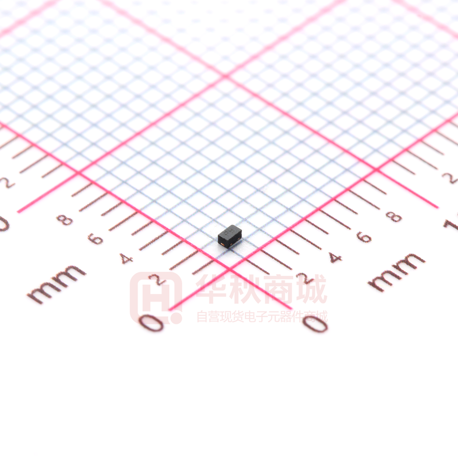

PESD5V0S1BL ESD Protection Diode RoHS Device Halogen Free Features SOD882 - Bi-directional ESD protection. 0.041(1.05) 0.037(0.95) - IEC 61000-4-2 (ESD) ; ±30KV(contact) - Surface mount package. 0.026(0.65) 0.022(0.55) - High component density. - Low clamping voltage. - Low leakage. Mechanical data 0.022(0.55) 0.018(0.45) - Case: SOD882/0402 package, molded plastic. 0.001(0.02) Max. 0.026(0.65) BSC. - Terminals: Gold plated, solderable per MIL-STD-750,method 2026. - Mounting position: Any. 0.022(0.55) 0.018(0.45) - Weight: 0.001 grams(approx.). 0.012(0.30) 0.008(0.20) Circuit Diagram Dimensions in inches and (millimeter) Maximum Rating (at TA=25°C unless otherwise noted) Parameter Conditions Symbol Value Unit Peak pulse power TP = 8/20us PPP 85 W Peak pulse current TP = 8/20us IPP 5 A IEC 61000-4-2(air) ESD ±30 IEC 61000-4-2(contact) ESD ±30 Tj -40~+125 °C TSTG -55~+150 °C ESD capability kV Operation temperature range Storage temperature range Electrical Characteristics (at TA=25°C unless otherwise noted) Parameter Conditions Working peak reverse voltage Symbol Min Typ 5 VRWM Diode breakdown voltage IT = 1mA Reverse current VRWM = 5V IR IPP = 1A, TP = 8/20us VC IPP = 5A, TP = 8/20us VR = 0V, f = 1MHz VBR Max 5.6 Unit V V 0.1 uA 8 11 V VC 13 17 V CJ 6 9 pF Clamping voltage Junction capacitance 1 PESD5V0S1BL ESD Protection Diode RATING AND CHARACTERISTIC CURVES (PESD5V0S1BL) Fig.1- 8/20us Peak Pulse Current Wave Form Acc. IEC61000-4-5 Peak Valur Ipp Percentage Of Ipp 100% 7 Test Waveform parameters tf=8us td=20us Ta=25°C Capacitance Between Terminals, (PF) 120% Fig.2 - Typical Capacitance Between Terminals Characteristics e-t 80% 60% 40% td= t Ipp/2 20% 0% 0 5 10 15 20 25 6 5 4 3 2 1 0 30 0 1 Time, (us) 2 3 4 5 Reverse Voltage, (V) Fig. 4 - Power Rating Derating Curve Fig.3 - Typical Clamping Voltage Vs. Peak Pulse Current 18 Mounting on glass epoxy PCBs 100 Power rating, (%) Clamping Voltage, (V) 15 12 9 6 3 80 60 40 20 0 0 1 2 3 4 5 0 Peak Pulse Current, (A) 25 50 75 100 Ambient Temperature, (°C) 2 125 PESD5V0S1BL ESD Protection Diode Reel Taping Specification d P0 T P1 E Index hole F W B P C A 12 o 0 D2 D1 D W1 Trailer Device ....... ....... End ....... ....... Leader ....... ....... ....... ....... 160mm (min) Start 400mm (min) Direction of Feed SYMBOL A B C d D D1 D2 (mm) 0.75 ± 0.05 1.17 ± 0.05 0.65 ± 0.05 1.50 + 0.10 - 0 178.00 ± 1.00 60.00 ± 0.50 13.50 ± 0.20 (inch) 0.030 ± 0.002 0.046 ± 0.002 0.026 ± 0.002 0.059 + 0.004 - 0 7.008 ± 0.039 2.362 ± 0.020 0.531 ± 0.008 SYMBOL E F P P0 P1 T W W1 (mm) 1.75 ± 0.10 3.50 ± 0.10 4.00 ± 0.10 4.00 ± 0.10 2.00 ± 0.10 0.20 + 0.02 - 0.05 8.00 ± 0.20 12.00 + 0.50 - 0 (inch) 0.069 ± 0.004 0.138 ± 0.004 0.157 ± 0.004 0.157 ± 0.004 0.079 ± 0.004 0.008 + 0.001 - 0.002 0.315 ± 0.008 0.472 + 0.020 - 0 SOD882 SOD882 3 PESD5V0S1BL ESD Protection Diode Suggested PAD Layout SOD882 SIZE (mm) (inch) A 0.70 0.028 B 0.40 0.016 C 0.60 0.024 D 1.10 0.043 E 0.30 0.012 D A E C B Standard Packaging REEL PACK Case Type SOD882 REEL Reel Size ( p cs ) (inch) , 10,000 7 4
