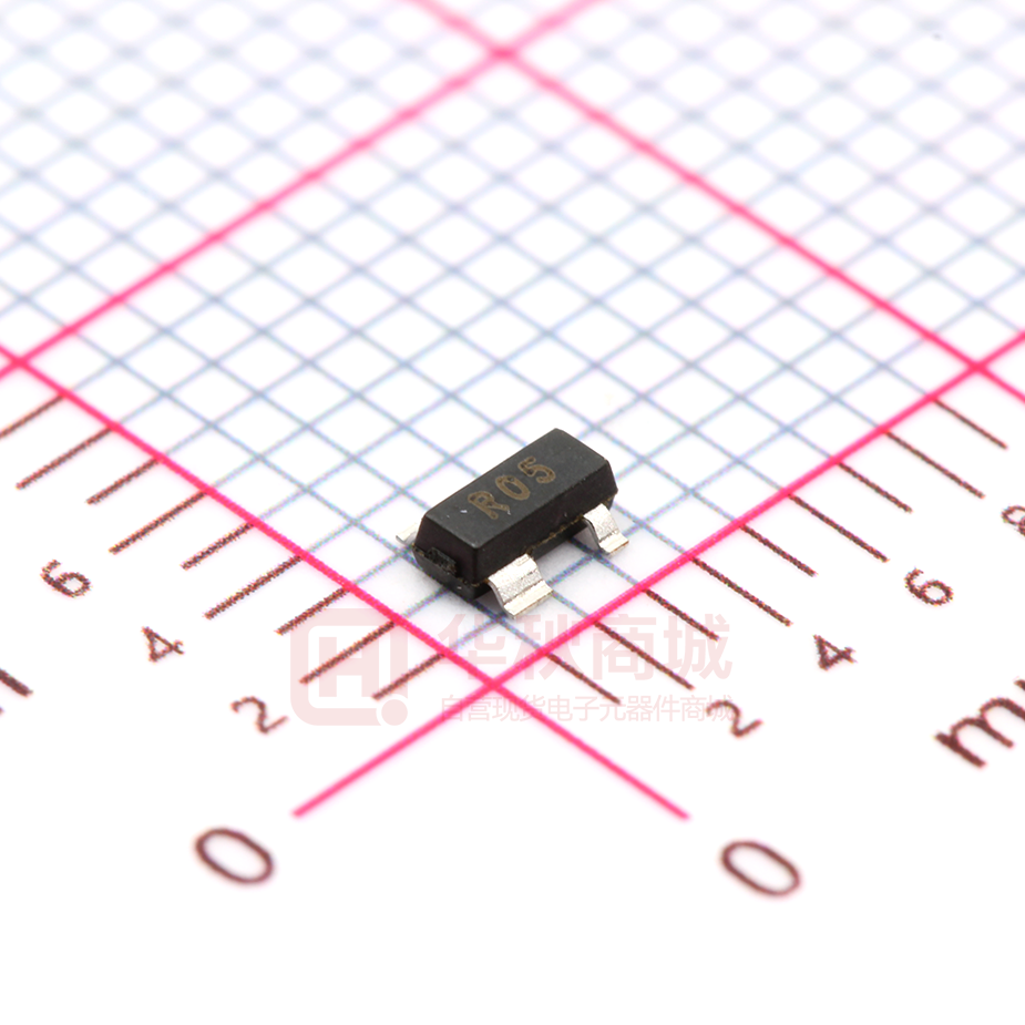

    ESD VRWM=5V VBR(Min)=6V VC=18V IPP=5A Ppp=90W SOT143
PRTR5V0U2X 数据手册
PRTR5V0U2X ESD Protectlon Array Features • Ultra low capacitance: 0.3pF typical • Ultra low leakage: nA level • Low operating voltage: 5V • Low clamping voltage • 4-pin SOT-143 package • Protects two data lines and one power line • Complies with following standards: – IEC 61000-4-2 (ESD) immunity test Air discharge: ±30kV Contact discharge: ±25kV – IEC61000-4-4 (EFT) 40A (5/50ns) RoHS Device Halogen Free – IEC61000-4-5 (Lightning) 5A (8/20µs) • RoHS Compliant Dimensions and Pin Configuration Mechanical Characteristics • Package: SOT-143 • • Lead Finish: Matte Tin Case Material: “Green” Molding Compound. • UL Flammability Classification Rating 94V-0 Moisture Sensitivity: Level 3 per J-STD-020 • 4 1 2 Applications • Cellular Handsets and Accessories • • Notebooks and Handhelds Personal Digital Assistants • • Portable Instrumentation Digital Cameras • Peripherals • • Audio Players, Keypads, Side Keys, LCD USB 2.0 3 Pin Schematic Pin 4 Pin 2 Pin 3 Pin 1 Circuit Diagram 1/4 PRTR5V0U2X ESD Protectlon Array Absolute Maximum Ratings (TA=25°C unless otherwise specified) Parameter Symbol Value Unit Peak Pulse Power (8/20µs) Ppk 90 W Peak Pulse Current (8/20µs) IPP 5 A ESD per IEC 61000−4−2 (Air) ±30 VESD ESD per IEC 61000−4−2 (Contact) Operating Temperature Range Storage Temperature Range ±25 kV TJ −55 to +125 °C Tstg −55 to +150 °C Electrical Characteristics (TA=25°C unless otherwise specified) Parameter Reverse Working Voltage Breakdown Voltage Symbol Min Typ VRWM VBR Max Unit 5 V Any I/O pin to ground V IT = 1mA, any I/O pin to ground VRWM = 5V, any I/O pin to ground 6 Reverse Leakage Current IR 0.5 µA Clamping Voltage VC 15 V Clamping Voltage VC 18 V Junction Capacitance CJ 0.4 pF Junction Capacitance CJ 0.8 pF 0.3 Note 1: I/O pins are pin 2 & 3 2/4 Test Condition IPP = 1A (8 x 20µs pulse), any I/O pin to ground IPP = 5A (8 x 20µs pulse), any I/O pin to ground VR = 0V, f = 1MHz, between I/O pins VR = 0V, f = 1MHz, any I/O pin to ground PRTR5V0U2X ESD Protectlon Array Typical Performance CharacteristicsA(T =25°C unless otherwise Specified) 10 Peak Pulse Power_Ppp (W) Junction Capacitance_Cj (pF) 1 0.8 0.6 0.4 0.2 0 1 0.1 0.01 0 1 2 3 4 Reverse Voltage_VR (V) 5 0.1 10 100 16 120 14 100 % of Rated Power 12 10 8 6 4 80 60 40 20 2 0 0 0 1 2 3 4 5 Peak Pulse Current_Ipp (A) 0 6 Clamping Voltage vs. Peak Pulse Current 25 50 75 100 125 Ambient Temperature_Ta(℃) Power Derating Curve 100 90 % of Peak Pulse Current 1000 Pulse Duration_tp (us) Peak Pulse Power vs. Pulse Time Junction Capacitance vs. Reverse Voltage Clamping Voltage_Vc (V) 1 80 70 60 50 40 30 20 10 0 0 20 40 Time_t(uS) 60 80 ESD Clamping Voltage 8 kV Contact per IEC61000−4−2 8 X 20uS Pulse Waveform 3/4 150 PRTR5V0U2X ESD Protectlon Array SOT-143 Package Outline Drawing D A e H e/2 4 3 GAUGE PLANE SEATING PLANE B C E1 1 c 0 0.25 L L1 E DETAIL A 2 bxN e1 bbb A2 C A B A SIDE VIEW SEE DETAIL A DIM A A1 A2 b b1 c D E E1 e e1 L L1 N 0 aaa bb b ccc DIMENSIONS INCHES MILLIMETERS MIN NOM MAX MIN NOM MAX .03 5 .114 .093 .05 1 .075 .00 8 .01 5 .02 0 (.021) 4 0° .00 6 .00 8 .00 4 .031 .000 .02 9 .011 .029 .003 .11 0 .082 .047 .048 0.80 .006 0.013 .04 2 0.75 0.90 .020 0.30 .037 0.76 .008 0.08 .120 2.80 2.90 .104 2.10 2.37 .055 1.20 1.30 1.92 BSC 0.20 BSC .02 4 0.40 0.50 (0.54) 4 8° 0° 0.15 0.20 0.10 ccc C 4X SEATING PLANE A1 b1 C C A B aaa Suggested Land Pattern X1 X1 SYM C E1 E2 Y Z C E1 G E2 Y X2 X1 4/4 DIMENSIONS MILLIMETERS INCHES 2.20 0.087 1.92 0.076 1.72 0.068 G 0.80 0.031 X1 1.00 0.039 X2 Y Z 1.20 1.40 3.60 0.047 0.055 0.141 1.22 0.15 1.07 0.51 0.94 0.20 3.04 2.64 1.40 0.60 8°
