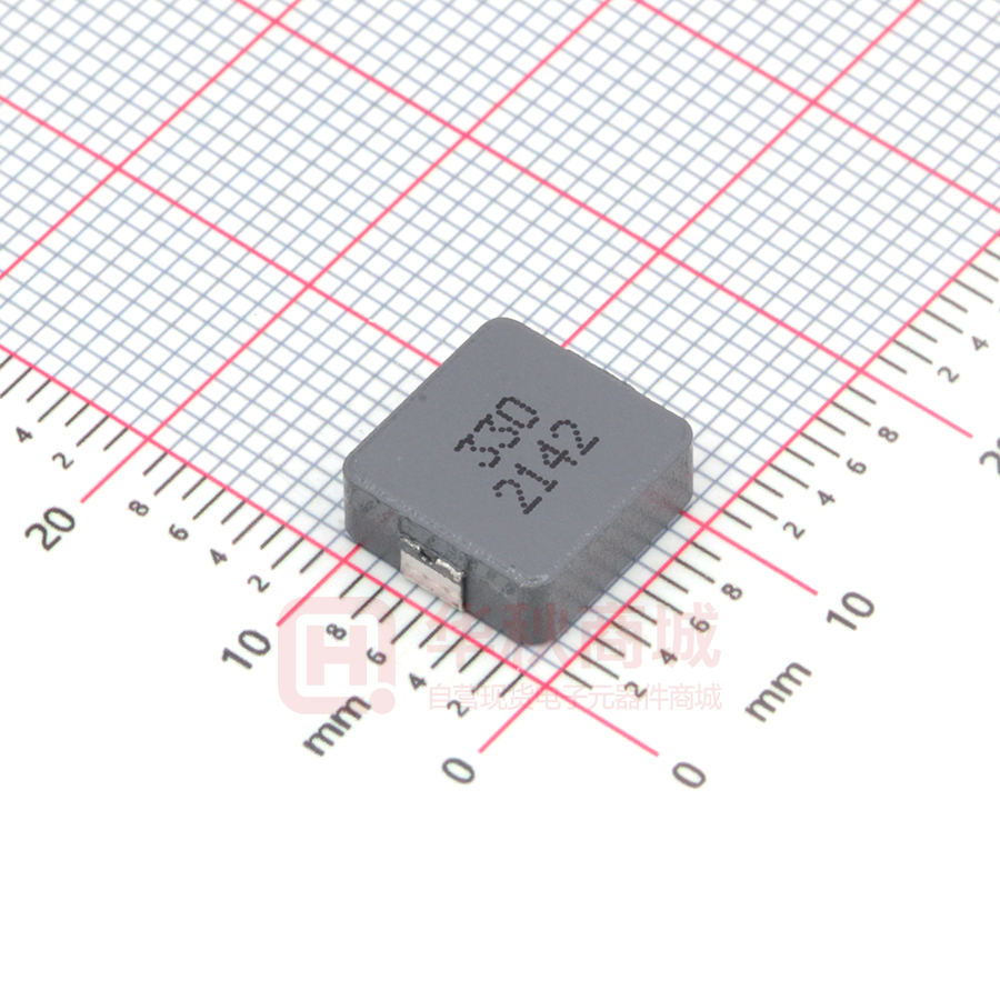

    SMD,11x10mm
    功率电感 33µH ±20% IND_11X10MM_SM 4.00mm 11.00 x 10.00mm 112mΩ 3.5A
TMPC1004H-330MG-D 数据手册
TAI-TECH P1 SMD Power Inductor TMPC1004H-Series(G)-D 1. Features 1. Carbonyl Powder. 2. Compact design. Halogen 3. High current,low DCR,high efficiency. 4. Very low acoustic noise and very low leakage flux noise. Halogen-free 5. High reliability. 6. 100% Lead(Pb)-Free and RoHS compliant. 7. Operating temperature -40~+125℃(Including self - temperature rise) 8. 2. Applications Note PC power system,incl. IMVP-6 DC/DC converter . 3. Dimensions C   100 2019 D E B A leadframe A 1R5 2019 Recommend PC Board Pattern L E H B D C non-leadframe G Series A(mm) B(mm) C(mm) D(mm) E(mm) L(mm) TMPC1004H 11.0±0.5 10.0±0.3 3.8±0.2 2.3±0.3 3.0±0.3 13.6 5.4 3.5 Note: 1. The above PCB layout reference only. 2. Recommend solder paste thickness at 0.15mm and above. 4. Part Numbering TMPC 1004 H A B C A: Series B: Dimension C: Type D: Inductance E: Inductance Tolerance F: Code - 100 MG D E - D F BxC Carbonyl Powder. 100=10.0uH K=±10%,L=±15%,M=±20%,N=±25%,Y=±30%. Marking: Black100 and 2019(20YY,19 WW,follow production date). G(mm) H(mm) TAI-TECH P2 5. Specification Part Number Inductance L0 (uH)±20% I rms ( A ) I sat ( A ) DCR(mΩ) Typ.@25℃ DCR(mΩ) Max.@25℃ Type TMPC1004H-R15YG-D 0.15±30% 43.0 75.0 0.50 0.60 non-leadframe TMPC1004H-R22MG-D 0.22 35.0 60.0 0.80 1.00 non-leadframe TMPC1004H-R33MG-D 0.33 31.0 60.0 1.00 1.20 non-leadframe TMPC1004H-R36MG-D 0.36 31.0 60.0 1.05 1.20 non-leadframe TMPC1004H-R47MG-D 0.47 28.0 43.0 1.30 1.50 non-leadframe TMPC1004H-R56MG-D 0.56 25.0 40.0 1.60 1.80 non-leadframe TMPC1004H-R68MG-D 0.68 22.0 39.0 2.40 2.70 non-leadframe TMPC1004H-1R0MG-D 1.00 18.0 36.0 3.00 3.30 non-leadframe TMPC1004H-1R5MG-D 1.50 16.0 33.0 4.00 4.60 non-leadframe TMPC1004H-2R2MG-D 2.20 12.0 27.0 6.50 7.00 leadframe TMPC1004H-3R3MG-D 3.30 11.0 20.0 10.8 11.8 leadframe TMPC1004H-4R7MG-D 4.70 10.0 17.0 15.0 15.5 leadframe TMPC1004H-5R6MG-D 5.60 9.00 14.0 17.0 19.3 Leadframe TMPC1004H-6R8MG-D 6.80 8.50 13.5 17.5 23.3 leadframe TMPC1004H-8R2MG-D 8.20 8.00 12.5 20.0 22.5 leadframe TMPC1004H-100MG-D 10.0 7.50 12.0 27.0 30.0 leadframe TMPC1004H-150MG-D 15.0 6.25 10.0 40.0 45.0 leadframe TMPC1004H-220MG-D 22.0 5.00 7.00 64.0 74.0 leadframe TMPC1004H-330MG-D 33.0 3.50 5.00 92.0 112 leadframe TMPC1004H-470MG-D 47.0 3.00 4.50 145 167 leadframe Note: 1. Test frequency : Ls : 100KHz /1.0V. 2. All test data referenced to 25℃ ambient. 3. Testing Instrument(or equ) : L: HP4284A,CH11025,CH3302,CH1320,CH1320S LCR METER / Rdc:CH16502,Agilent33420A MICRO OHMMETER. 4. Heat Rated Current (Irms) will cause the coil temperature rise approximately ΔT of 40℃ 5. Saturation Current (Isat) will cause L0 to drop approximately 30%. 6. The part temperature (ambient + temp rise) should not exceed 125℃under worst case operating conditions.Circuit design,component,PCB trace size and thickness,airflow and other cooling provisions all affect the part temperature. Part temperature should be verified in the end application. 7. Special inquiries besides the above common used types can be met on your requirement. TAI-TECH 6. Typical Performance Curves P3 TAI-TECH P4

物料型号:TMPC1004H系列
器件简介:该系列电感器采用碳粉材料,设计紧凑,具有高电流、低直流电阻(DCR)、高效率的特点。同时,它们具有非常低的声学噪声和非常低的漏磁噪声,并且是无卤素、符合RoHS标准的高可靠性产品。
引脚分配:文档中没有明确提供引脚分配信息,但提到了两种不同的框架尺寸,一种是基于2019年的引脚框架,另一种是非引脚框架。
参数特性: - 工作温度范围:-40℃至+125℃(包括自温升) - 尺寸:根据不同型号,尺寸有所不同,表格中列出了具体的尺寸数据 - 推荐PCB布局:提供了推荐的PCB布局尺寸 - 零件编号:列出了不同型号的电感器及其对应的特性,包括电感值、额定电流、饱和电流、典型和最大直流电阻等
功能详解:文档提供了电感器的典型性能曲线图,但未提供详细的功能解释。
应用信息:适用于PC电源系统,包括IMVP-6 DC/DC转换器。
封装信息:提供了不同型号的封装尺寸和推荐PCB布局。
