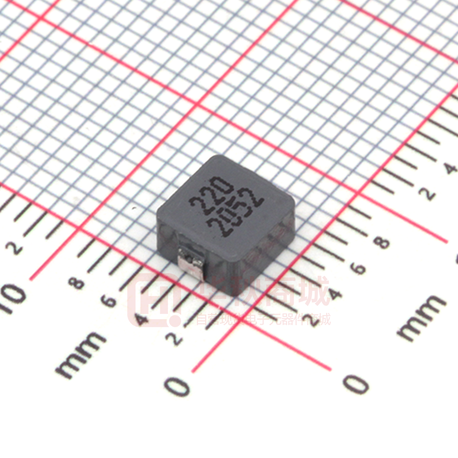

    SMD,5.7x5.2mm
    功率电感 22µH ±20% IND_5.7X5.2MM_SM 3.00mm 5.70 x 5.20mm 250mΩ 1.7A
TMPC0503H-220MG-D 数据手册
TAI-TECH P1 SMD Power Inductor TMPC0503H-Series(G)-D 1. Features 1. Carbonyl Powder. 2. Compact design. Halogen 3. High current,low DCR,high efficiency. 4. Very low acoustic noise and very low leakage flux noise. Halogen-free 5. High reliability. 6. 100% Lead(Pb)-Free and RoHS compliant. 7. Operating temperature -40~+125℃(Including self - temperature rise) 2. Applications Note PC power system,incl. IMVP-6 DC/DC converter . 3. Dimensions A A` Recommend PC Board Pattern C L   1R0 2019 E B H D G Series A(mm) A`(mm) B(mm) C(mm) D(mm) E(mm) TMPC0503H 5.7±0.3 5.1±0.2 5.2±0.2 2.8±0.2 1.1±0.3 1.5±0.2 4. Part Numbering TMPC 0503 H A B C A: Series B: Dimension C: Type D: Inductance E: Inductance Tolerance F: Code - 1R0 MG D E - L(mm) G(mm) H(mm) 6.5 2.5 1.8 Note: 1. The above PCB layout reference only. 2. Recommend solder paste thickness at 0.12mm and above. D F BxC Carbonyl Powder. 1R0=1.00uH M=±20% Y=±30% Marking: Black.1R0 and 2019(20 YY, 19 WW,follow production date). TAI-TECH P2 5. Specification Part Number Inductance L0 (uH)±20% I rms ( A ) I sat ( A ) DCR(mΩ) Typ.@25℃ DCR(mΩ) Max.@25℃ TMPC0503H-R10YG-D 0.10±30% 23.0 27.0 2.5 3.0 TMPC0503H-R22MG-D 0.22 15.5 21.0 3.7 4.4 TMPC0503H-R33MG-D 0.33 14.0 18.0 4.3 5.0 TMPC0503H-R47MG-D 0.47 12.0 16.0 6.4 7.4 TMPC0503H-R68MG-D 0.68 8.50 14.0 10 12 TMPC0503H-1R0MG-D 1.00 7.00 11.0 13 14 TMPC0503H-1R5MG-D 1.50 6.00 10.0 16 25 TMPC0503H-2R2MG-D 2.20 5.50 9.00 25 35 TMPC0503H-3R3MG-D 3.30 5.00 8.00 32 38 TMPC0503H-4R7MG-D 4.70 4.60 6.00 50 53 TMPC0503H-5R6MG-D 5.60 4.25 4.50 55 63 TMPC0503H-6R8MG-D 6.80 4.00 4.30 68 76.2 TMPC0503H-100MG-D 10.0 2.75 3.50 110 128 TMPC0503H-150MG-D 15.0 2.10 2.60 165 190 TMPC0503H-220MG-D 22.0 1.90 1.70 220 250 Note: 1. Test frequency : Ls : 100KHz /1.0V. 2. All test data referenced to 25℃ ambient. 3. Testing Instrument(or equ) : L: HP4284A,CH11025,CH3302,CH1320,CH1320S LCR METER / Rdc:CH16502,Agilent33420A MICRO OHMMETER. 4. Heat Rated Current (Irms) will cause the coil temperature rise approximately ΔT of 40℃ 5. Saturation Current (Isat) will cause L0 to drop approximately 30%. 6. The part temperature (ambient + temp rise) should not exceed 125℃under worst case operating conditions.Circuit design,component,PCB trace size and thickness,airflow and other cooling provisions all affect the part temperature. Part temperature should be verified in the end application. 7. Special inquiries besides the above common used types can be met on your requirement. TAI-TECH 6. Typical Performance Curves P3
