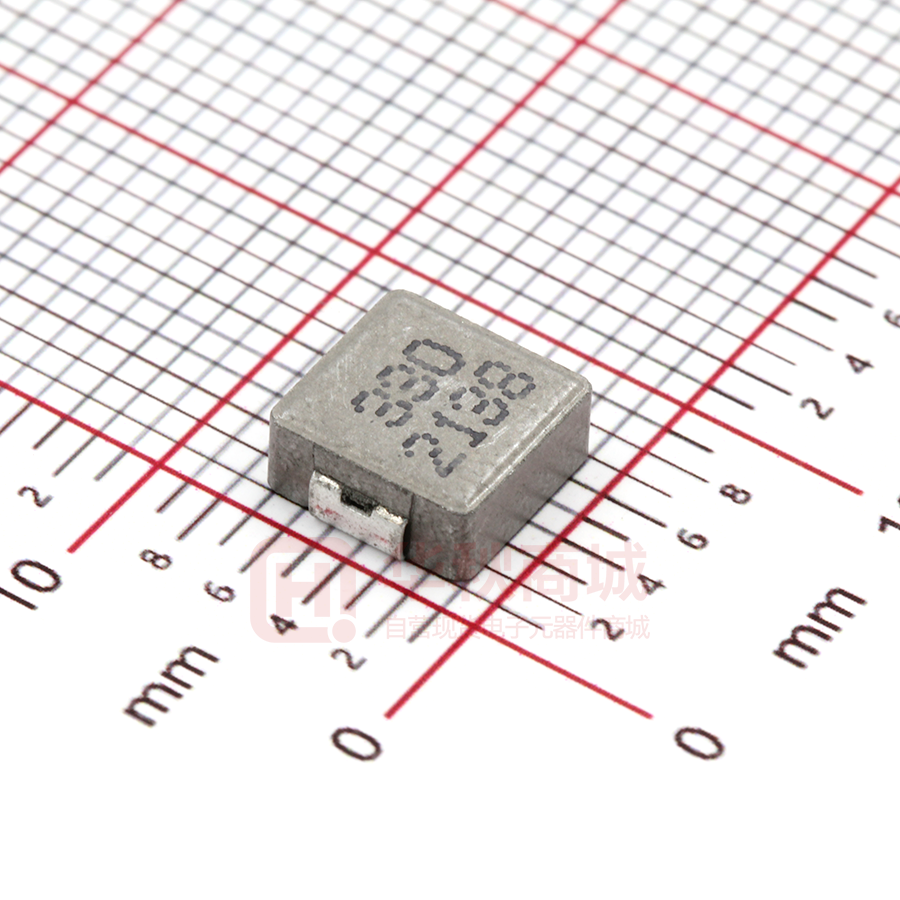

TMPA0603S-330MN-D
TMPA0603S-330MN-D
    TAI-TECH(台庆)
    SMD,7.1x6.6mm
    功率电感 33µH ±20% IND_7.1X6.6MM_SM 3.00mm 7.10 x 6.60mm 258mΩ 2.1A
TMPA0603S-330MN-D 数据手册
TAI-TECH SMD Power Inductor TMPA0603S-330MN-D ECN HISTORY LIST REV DATE DESCRIPTION APPROVED CHECKED DRAWN 1.0 17/08/08 新發行 羅宜春 梁周虎 卜文娟 備 注 TAI-TECH SMD Power Inductor TMPA0603S-330MN-D 1. Features 1. Shielded construction. 2. Capable of corresponding high frequency (5MHz). 3. Low loss realized with low DCR. Halogen Pb Halogen-free Pb-free 4. High performance (Isat) realized by metal dust core. 5. Ultra low buzz noise, due to composite construction. 6. 100% Lead(Pb)-Free and RoHS compliant. 2. Applications 1. DC/DC converters in distributed power systems. 2. DC/DC converter for Field Programmable Gate Array(FPGA). 3. Battery powered devices. 4. Thin type on-board power supply module for exchanger. 5. VRM for server. 6. High current, low profile POL converters. 7. PDA/notebook/desktop/server and battery powered devices. 3. Dimensions C A Recommend PC Board Pattern D L H E B 1R0 330 1526 T Series TMPA0603 G A B C D E T 7.1±0.3 6.6±0.2 2.8±0.2 1.6±0.3 3.0±0.2 0~0.15 L(mm) 4. Part Numbering 0603 S A B C A: Series B: Dimension C: Type D: Inductance E: Inductance Tolerance F: Code - 330 MN D E - H(mm) 8.0 3.7 3.4 Note: 1. The above PCB layout reference only. 2. Recommend solder paste thickness at 0.15mm and above. Unit:mm TMPA G(mm) D F BxC Standard. 330=33.0uh M=±20% Marking: Black.330 and 1526(15 YY, 26 WW,follow production date). 5. Specification Part Number Inductance L0 A(uH) ±20% Heat Rating Current DC Typ ( A ) Irms. Saturation Current DC Typ (A)I sat DCR (mΩ)Typ DCR (mΩ)Max TMPA0603S-330MN-D 33.0 2.1 2.5 215 258 Note: 1. Test frequency : Ls : 100KHz /1.0V. 2. All test data referenced to 25℃ ambient. 3. Testing Instrument(or equ) : L: HP4284A,CH11025,CH3302,CH1320,CH1320S LCR METER / Rdc:CH16502,Agilent33420A MICRO OHMMETER. 4. Heat Rated Current (Irms) will cause the coil temperature rise approximately ΔT of 40℃ 5. Saturation Current (Isat) will cause L0 to drop approximately 30%. 6. The part temperature (ambient + temp rise) should not exceed 125℃under worst case operating conditions.Circuit design,component,PCB trace size and thickness,airflow and other cooling provisions all affect the part temperature. Part temperature should be verified in the end application. 7. Special inquiries besides the above common used types can be met on your requirement. TAI-TECH 6. Material List NO Items 1 Core Alloy Powder . Materials 2 Wire Polyester Wire or equivalent. 3 Clip 100% Pb free solder(Ni+Sn---Plating) 4 Ink Halogen-free ketone 7. Reliability and Test Condition Item Performance Operating temperature -40~+125℃ (Including self - temperature rise) Storage temperature 1. -10~+40℃,50~60%RH (Product without taping) 2. -40~+125℃(on board) Test Condition Electrical Performance Test Inductance Refer to standard electrical characteristics list. DCR HP4284A,CH11025,CH3302,CH1320,CH1320S LCR Meter. CH16502,Agilent33420A Micro-Ohm Meter. Saturation Current (Isat) Approximately △L30% Saturation DC Current (Isat) will cause L0 to drop △L(%) Heat Rated Current (Irms) Approximately △T40℃ Heat Rated Current (Irms) will cause the coil temperature rise △T(℃) without core loss. 1.Applied the allowed DC current. 2.Temperature measured by digital surface thermometer Reliability Test Life Test Load Humidity Moisture Resistance Thermal shock Vibration Appearance:No damage. Inductance:within±10% of initial value Q:Shall not exceed the specification value. RDC:within ±15% of initial value and shall not exceed the specification value Preconditioning: Run through IR reflow for times.( IPC/JEDEC J-STD-020DClassification Reflow Profiles) Temperature: 125±2℃(Inductor) Applied current:rated current Duration:1000±12hrs Measured at room temperature after placing for 24±2 hrs 2 Preconditioning: Run through IR reflow for times.( IPC/JEDEC J-STD-020DClassification Reflow Profiles Humidity:85±2﹪R.H, Temperature:85℃±2℃ Duration:1000hrs Min. with 100% rated current Measured at room temperature after placing for 24±2 hrs 2 Preconditioning: Run through IR reflow for 2 times.( IPC/JEDEC J-STD-020DClassification Reflow Profiles 1. Baked at50℃ for 25hrs, measured at room temperature after placing for 4 hrs. 2. Raise temperature to 65±2℃ 90-100%RH in 2.5hrs, and keep 3 hours, cool down to 25℃ in 2.5hrs. 3. Raise temperature to 65±2℃ 90-100%RH in 2.5hrs, and keep 3 hours, cool down to 25℃ in 2.5hrs,keep at 25℃ for 2 hrs then keep at -10℃ for 3 hrs 4. Keep at 25℃ 80-100%RH for 15min and vibrate at the frequency of 10 to 55 Hz to 10 Hz, measure at room temperature after placing for 1~2 hrs. Preconditioning: Run through IR reflow for times.( IPC/JEDEC J-STD-020DClassification Reflow Profiles Condition for 1 cycle Step1:-40±2℃ 30±5min Step2:25±2℃ ≦0.5min Step3:125±2℃ 30±5min Number of cycles: 500 Measured at room temperature after placing for 24±2 hrs Oscillation Frequency: 10~2K~10Hz for 20 minutes Equipment: Vibration checker Total Amplitude:1.52mm±10% Testing Time : 12 hours(20 minutes, 12 cycles each of 3 orientations)。 2 TAI-TECH Item Performance Bending Shock Solder ability Appearance:No damage. Impedance:within±15% of initial value Inductance:within±10% of initial value Q:Shall not exceed the specification value. RDC:within ±15% of initial value and shall not exceed the specification value More than 95% of the terminal electrode should be covered with solder。 Test Condition Shall be mounted on a FR4 substrate of the following dimensions: >=0805 inch(2012mm):40x100x1.2mm =0805 inch(2012mm):1.2mm 0805:1kg ,
