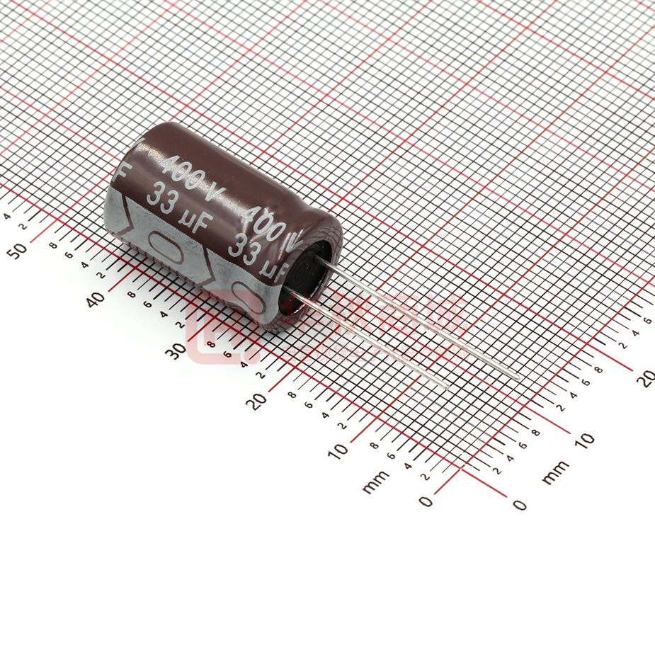

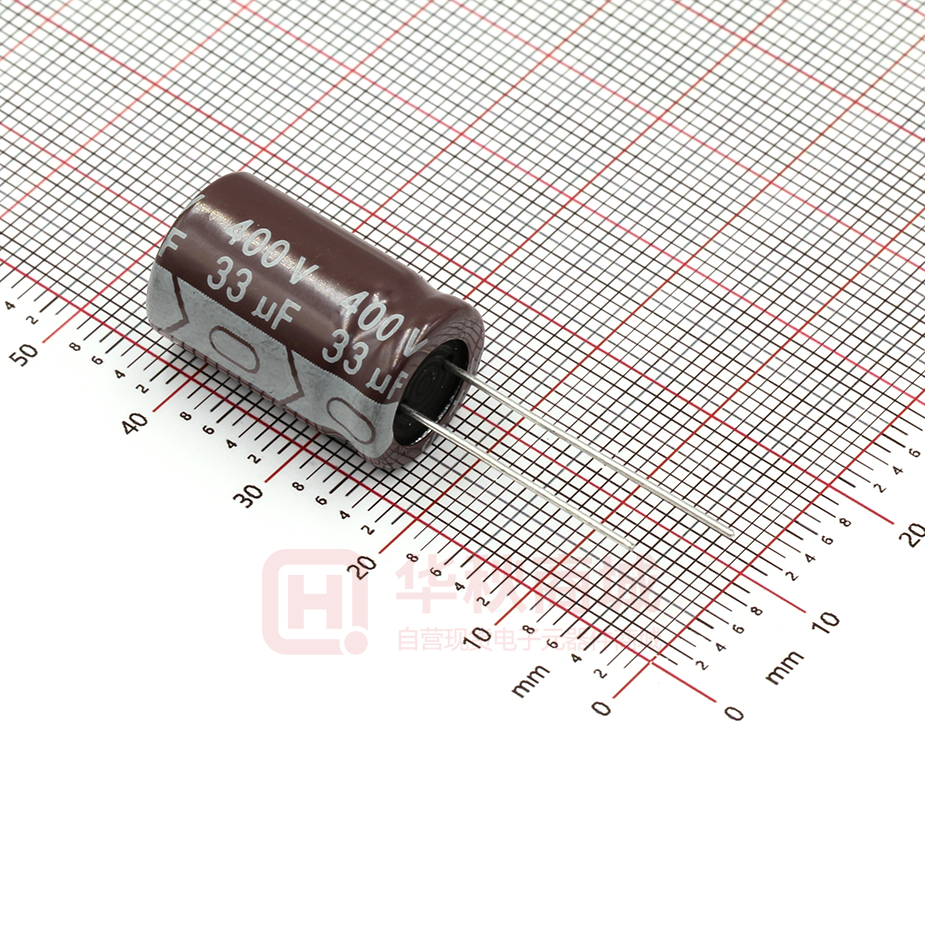

    直插铝电解电容 插件,D13xL21mm 33µF ±20% Ф13.00 x 21.00mm 400V 1.72Ω 620mA 10000Hrs@105℃
01EC1209 数据手册
规格承认书 Specification for approval 客户名称: (Customer Name) 铝电解电容 产品名称: (Product Name) Aluninum Electrolytic Capacitor 客户料号: (Customer part number) 科尼盛料号: 01EC1209 (KNSCHA number) 01EC1209 型号规格: KNSCHA SHG 400V33μF Φ13*21L (Specifications) KNSCHA SHG 400V33μF Φ13*21L 客 户 (Customer) Approval 制 造 (Manufacture) Approval 拟 制 (Fiction) 审 核 (Chief) 核 检 验 准 (Approval) (Inspect) 审 核 (Chief) 东莞市科尼盛电子有限公司 DONG GUAN KNSCHA ELECTRONICS CO.,LTD. No.The 8th Floor, A3 Building, R&D Center (Phase I), Songshan Lake Intelligent Valley, Liaobu Town, Dongguan City. TEL:0769-83698067 81035570 FAX: 0769-83861559 Email:sales@knscha.com Website: http://www.knscha.com 核 准 (Approval) SHG Series Aluminum Electrolytic Capacitors Item Name 01EC1209 Rating SHG400V33μF Case size Φ13*21L SHECLON Lifetime 10000 hours 1. Operating Temp. Range -40℃ ~ + 105℃ 2. Electrical Characteristics See Table 1. 【Table 1】 Rated Voltage VDC Surge Voltage VDC 400 450 Nominal Tolerance Dissipation Leakage Static on Factor Current Capacitance Capacitance(%) (tanδ)max 5min. 20℃ (μF) 20℃ 120Hz 20℃ 120Hz (μA)max -20~+20 33 264 0.15 Permissible Ripple Impedance(Ω) Current 100KHZ 20℃ (mArms)max 105℃100KHz 1.72 620 3. Dimensions Rubber Bung Sleeve Фd=0.05 Tinned copper-ply wire φd Safety Vent φ6.3 or over F±0.5 ФD+αmax 15min. L+βmax. Unit(mm) φD+0.5Max 13 L±1.5Max 21 φD+0.5 4min. F±0.5 5.0 d±0.05 0.6 4. Marking The following items are printed on the Brown sleeve in White Example of Marking 400V 33μF ① Rated voltage & Nominal Capacitance ② Polarity (negative) ③ Trade Mark ④ series ⑤ Symbol of Capacitance Tolerance (M) ⑥ Max Operating Temp. ① ② KNSCHA ③ SHG ④ (M )105℃ ⑤⑥ 5.MULTIPLIER FOR RIPPLE CURRENT ①. Frequency Coefficient Freq.(Hz) 120 60(50) Cap(μF) 0.80 0.75 0.1-47 1K 10K 100K 0.85 0.90 1.00 0.80 0.85 0.90 0.95 1.00 0.85 1000-22000 ②. Temperature Coefficient Ambient 40 Temperature(℃) Coefficient 2.40 0.87 0.89 0.92 1.00 60 70 85 105 2.10 1.78 1.65 1.00 68-680 No,KNS-2003001 (1/5) 6. No. Characteristics Item 1 Leakage Current Performance I= 264.0 μA Test Method (I=0.02CV) I= Max Leakage Current C=Ctatic Capacitor: V=Rated Voltage Protection Resistor : 1000±10Ω Applied Volt : Rated Voltage Mesauring time : 2minutes Measured Frequency : 120Hz±20% 2 Static Capacitance 3 Dissiption Factor (tanδ) 26.4 ~ 39.6 μF Measured Voltage ≤ 0.5Vrms, 1.5 ~ 2.0VDC 0.15 and Under Same as condition of Capacitors 4 High Temp. Load Characteristics Leakage Current Cap. Change Dissipation Factor Appearance ≦the value specified in Table 1 Test Temp. : 105±2℃ Applied voltage: Rated voltage ≦±20% of initial value ≦200% of value specified in Table 1 Test Time :10,000 hours No remarkable abnormality +72, -0 hours 5 High Temp. no load Characteristics Leakage Current Cap. Change Dissipation Factor Appearance ≦the value specified in Table 1 Test Temp. : 105±2℃ No voltage applied ≦±20% of initial value ≦200% of value specified in Table 1 Test Time :1000 hours No remarkable abnormality +24, -0 hurs 6 Terminal Strength Tensile Strength Bending Strength 7 Impedance Ratio 45N {4.5kg} 25N {2.5kg} WV Z-25℃/Z+20℃ Z-40℃/Z+20℃ Keeping time Tensile 1~5sec Bending 30±5sec 400 4 10 8 Temperature Stage Item Charac 2,3 Impedance Ratio teristics 5 Cap, Change Performance Stage Test Temp(℃) 20±2 less than the value mentioned in 5-7, 1 -25±3; ≤±25% against value in stage 4 2 -25±3; 3 20±2 4 105±2 After the capacitor is held at tempereture of each stage 5 20±2 and reaches temperature stability, measure performance. 6 9 Surge Voltage Item Leakage Current Cap, Change Dissipation Factor Appearance Perforemance ≤ the initial specified value ≤ ±15% against value before test ≤ the initial specified value No remakable abnormality Test Temp. 15~35℃ Test volt. Surge Volt.Specified in 2 Voltage apply. 1,000times of chage for 30±5sec, under frequency of 6±0.5sec, and discharge for 5min30sec. No,KNS-2003001 (2/5) 6-2. Characteristics No. Item Performance 10 Vibration Resistance Test Method Stability required Capacitance ≤±5% of the initial specified value Cap. Change Appearance No remarkable abnormality Frequency : 10~55Hz/1min. Width of vibration, 1.5mm Direction and duration X, Y and Z directions, each for 2 hours (Total 9 hours) 11 Solderbility 3/4 area of surrounding directions of surface should be covered with new solder. Solder: Sn-Ag, Sn-Cu Type Soldering Temp : 240±5℃ Dipping degree : 2~2.5mm Flux : Ethanol solution (JIS K8101) or Isopropylalchol (JIS K8839) solution of Rosin (JIS K5902) 12 Resistance to Soldering Leakage Current Cap. Change Dissipation Factor Appearance ≦ Initial specified value ≦±10% of initial value ≦ Initial specified in value No remarkable abnormality Soldering Temp. 280±5℃ Soldering Time . 10±1sec. 13 Resistance to Humidity Leakage Current Cap. Change Dissipation Factor Appearance ≦ Initial specified value ≦±15% of initial value ≦ Initial spesified value No remarkable abnormality Test Temp. : 40±2℃ Humidity 90~95% Test Time : 500 ± 8 hours After the above condition,restored to normal temp, and then measured. 14 Perssure valve moment characterstics There must not be thing ignition, scattering the resolution that that case works safely Dcmethod: impress the reverse voltage and of 1A, I cancel an electric current. 7 Packing method Packaging shape, size, quantity Component size 13*21 Quanity per package 4000pcs. H L W 8 Related Standards JIS C 5141 9 Marking on packing box ① ② ③ ④ ⑤ ⑥ ⑦ Item name Series name Rated Voltage Nominal Static Capacitance Case size Lot No. Quantity No,KNS-2003001 (3/5) 10 Leakage current Connecting the capacitor with a protective resistor (1kΩ±10Ω) in series for 2 minutes, and then, measure leakage current.
