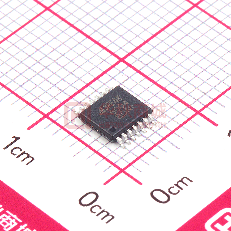

TP6004-TR
TP6004-TR
    3PEAK(思瑞浦)
    TSSOP-14
    1MHz, 80μA, RRIO, Op Amps
TP6004-TR 数据手册
TP6001/TP6002/TP6004 1MHz, 80μA, RRIO, Op Amps Features Description  Supply Voltage: 2.1V to 6.0V The TP600X series are CMOS dual, and quad RRIO op-amps  Low Supply Current: 80μA per channel with low offset, low power and stable high frequency response.  Rail to Rail Input and Output  Bandwidth: 1 MHz  Slew Rate: 0.7V/μs  Excellent EMI Suppress Performance mode voltage range extends 300mV beyond V– and V+, and  Offset Voltage: ±3mV Maximum the outputs swing rail-to-rail. The TP600X family can be used as  Offset Voltage Temperature Drift: 2 μV/°C plug-in replacements for many commercially available op-amps  Low Noise: 27 nV/√Hz at 1kHz to reduce power and improve input/output range and  High Output Capability: 100mA  –40°C to 125°C Operation Temperature Range They incorporate 3PEAK’s proprietary and patented design techniques to achieve very good AC performance with 1MHz bandwidth, 0.6V/μs slew rate and low distortion while drawing only 80μA of quiescent current per amplifier. The input common- performance. The combination of features makes the TP600X ideal choices for motor control and portable audio amplification, sound ports, Applications and other consumer Audio. The TP600X Op-amp is very stable, and it is capable of driving heavy capacitive loads such as those  Active Filters, ASIC Input or Output Amplifier  Sensor Interface outputs enables designers to buffer CMOS DACs, ASICs, or  Smoke/Gas/Environment Sensors other wide output swing devices in single-supply systems.  Portable Instruments and Mobile Device found in LCDs. The ability to swing rail-to-rail at the inputs and Pin Configuration TP6001 Out 1 ﹣Vs 2 + In TP6001U 5-Pin SOT23/SC70 5-Pin SOT23/SC70 -T and -C Suffixes -T and -C Suffixes 5 3 4 ﹢Vs - In +In 1 -VS 2 -In 3 5 4 +VS Out TP6002 TP6004 8-Pin SOIC/TSSOP/MSOP 14-Pin SOIC/TSSOP -S, -T, -TS and -V Suffixes -S and -T Suffixes Out A 1 ﹣In A 2 ﹢In A 3 ﹣Vs 4 A B 8 ﹢Vs Out A 1 7 Out B ﹣In A 2 ﹢In A 3 ﹢Vs ﹢In B 6 ﹣In B 5 ﹢In B 14 Out D 13 ﹣In D 12 ﹢In D 4 11 ﹣Vs 5 10 ﹢In C A B TP6001R 5-Pin SOT23 -T Suffixes Out 1 + Vs 2 + In 3 5 - Vs 4 - In www.3peakic.com.cn 1 / 17 D C ﹣In B 6 9 ﹣In C Out B 7 8 Out C Rev.0.03 TP6001/TP6002/TP6004 1MHz, 80μA, RRIO, Op Amps Table of Contents Features ........................................................................................................................................................................... 1 Applications ..................................................................................................................................................................... 1 Description....................................................................................................................................................................... 1 Pin Configuration ............................................................................................................................................................ 1 Table of Contents ............................................................................................................................................................ 2 Revision History .............................................................................................................................................................. 3 Order Information ............................................................................................................................................................ 3 Absolute Maximum Ratings Note 1 ................................................................................................................................... 4 ESD Rating ....................................................................................................................................................................... 4 Thermal Information ....................................................................................................................................................... 4 Electrical Characteristics ............................................................................................................................................... 5 Typical Performance Characteristics ............................................................................................................................ 6 Application Information .................................................................................................................................................. 9 Low Supply Voltage and Low Power Consumption ...................................................................................................................... 9 Ground Sensing and Rail to Rail Output ...................................................................................................................................... 9 Driving Large Capacitive Load ..................................................................................................................................................... 9 Tape and Reel Information ........................................................................................................................................... 10 Package Outline Dimensions ....................................................................................................................................... 11 SC70-5 /SOT-353 ........................................................................................................................................................................11 SOT23-5 ......................................................................................................................................................................................11 SOP-8 ........................................................................................................................................................................................ 12 TSSOP-8 .................................................................................................................................................................................... 13 MSOP-8 ..................................................................................................................................................................................... 14 SOP-14 ...................................................................................................................................................................................... 15 TSSOP-14 .................................................................................................................................................................................. 16 www.3peakic.com.cn 2 / 17 Rev.0.03 TP6001/TP6002/TP6004 1MHz, 80μA, RRIO, Op Amps Revision History Date Revision Notes 2017/3/1 Rev.Pre Pre-Release Version 2017/8/11 Rev.0 Release Version, confirm spec limit 2017/10/28 Rev.0.01 Correct the max of Common-mode Input Voltage Range in Electrical Characteristics from (V+) 0.1 to (V+) + 0.1. Correct Operating Temperature Range in Maximum Ratings from –45 to 125°C to –40 to 125°C. 2017/12/7 Rev 0.02 Add Package: TP6001U-CR 2018/2/1 Rev 0.03 Correct Pin configuration of TP6001R. Correct the quiescent current per amplifier in “Description” from 500uA to 80uA Order Information Order Number Operating Temperature Range Package Marking Information MSL Transport Media, Quantity TP6001-TR -40 to 125°C 5-Pin SOT23 601XX Note 2 3 Tape and Reel, 3000 TP6001-CR Note 1 -40 to 125°C 5-Pin SC70 601XX Note 2 1 Tape and Reel, 3000 TP6001R-TR -40 to 125°C 5-Pin SOT23 60RXX Note 2 3 Tape and Reel, 3000 TP6001U-TR Note 1 -40 to 125°C 5-Pin SOT23 60UXX Note 2 3 Tape and Reel, 3000 TP6001U-CR -40 to 125°C 5-Pin SC70 60UXX Note 2 1 Tape and Reel, 3000 TP6002-SR -40 to 125°C 8-Pin SOIC 3 Tape and Reel, 4000 TP6002-TSR -40 to 125°C 8-Pin TSSOP 3 Tape and Reel, 3000 TP6002-VR Note 1 -40 to 125°C 8-Pin MSOP 3 Tape and Reel, 3000 TP6004-SR -40 to 125°C 14-Pin SOIC 3 Tape and Reel, 2500 TP6004-TR -40 to 125°C 14-Pin TSSOP 3 Tape and Reel, 3000 6002 XXXX Note 3 6002 XXXX Note 3 6002 XXXX Note 3 6004 XXXX Note 3 6004 XXXX Note 3 Note 1: The sample will be ready in 1 month. Note 2: XX is the date code. Note 3: XXXX is date code. www.3peakic.com.cn 3 / 17 Rev.0.03 TP6001/TP6002/TP6004 1MHz, 80μA, RRIO, Op Amps Absolute Maximum Ratings Note 1 Parameters Rating Supply Voltage, (+VS)– (-VS) 7V Input Voltage (-VS) – 0.3 to (+VS) + 0.3 Differential Input Voltage ±7V Input Current: +IN, –IN ±10mA Note 2 Output Short-Circuit Duration Note 3 Infinite Maximum Junction Temperature 150°C Operating Temperature Range –40 to 125°C Storage Temperature Range –65 to 150°C Lead Temperature (Soldering, 10 sec) 260°C Note 1: Stresses beyond those listed under Absolute Maximum Ratings may cause permanent damage to the device. Exposure to any Absolute Maximum Rating condition for extended periods may affect device reliability and lifetime. Note 2: The inputs are protected by ESD protection diodes to each power supply. If the input extends more than 300mV beyond the power supply, the input current should be limited to less than 10mA. Note 3: A heat sink may be required to keep the junction temperature below the absolute maximum. This depends on the power supply voltage and how many amplifiers are shorted. Thermal resistance varies with the amount of PC board metal connected to the package. The specified values are for short traces connected to the leads. ESD Rating Symbol Parameter Condition Minimum Level Unit HBM Human Body Model ESD MIL-STD-883H Method 3015.8 8 kV CDM Charged Device Model ESD JEDEC-EIA/JESD22-C101E 2 kV Thermal Information Package Type θJA 5-Pin SC70 400 5-Pin SOT23 250 81 °C/W 8-Pin SOIC 158 43 °C/W 8-Pin TSSOP 191 44 °C/W 8-Pin MSOP 210 45 °C/W 14-Pin SOIC 120 36 °C/W 14-Pin TSSOP 180 35 °C/W www.3peakic.com.cn θJC Unit °C/W 4 / 17 Rev.0.03 TP6001/TP6002/TP6004 1MHz, 80μA, RRIO, Op Amps Electrical Characteristics All test condition is VS = 5V, TA = 25°C, RL = 2kΩ, CL =100pF, unless otherwise noted. Symbol Parameter Conditions Min Typ Max Unit 6 V 130 μA Power Supply VS Supply Voltage Range IQ Quiescent Current per Amplifier PSRR Power Supply Rejection Ratio 2.1 80 80 100 -3 0.5 dB Input Characteristics VOS Input Offset Voltage VCM = 0V to 3V VOS TC Input Offset Voltage Drift TA = -40°C to 125°C 2 μV/°C TA = 25 °C 1 pA IB Input Bias Current TA = 85 °C 25 pA 1 pA Differential Mode 8 pF Common Mode 7 pF 110 dB IOS Input Offset Current CIN Input Capacitance Av Open-loop Voltage Gain RLOAD = 10kΩ 85 3 mV Common-mode Input Voltage VCMR (V-) - 0.1 (V+) + 0.1 V Range CMRR Common Mode Rejection Ratio VCM = 0V to 3V Xtalk Channel Separation 70 100 dB f = 1kHz, RL = 2kΩ 110 dB RLOAD = 10kΩ 3 Output Characteristics VOH, VOL Maximum Output Voltage Swing ISC Output Short-Circuit Current 15 mV 100 mA 1 MHz 0.7 V/μs AC Specifications GBW Gain-Bandwidth Product SR Slew Rate AV = 1, VOUT = 1.5V to 3.5V, CLOAD = 60pF, RLOAD = 1kΩ Settling Time, 0.1% AV = 1, 2V Step, CLOAD = 60pF, 3.5 μs Settling Time, 0.01% RLOAD = 1kΩ 4.8 μs PM Phase Margin RLOAD = 1kΩ, CLOAD = 60pF 60 ° GM Gain Margin RLOAD = 1kΩ, CLOAD = 60pF 15 dB tS Noise Performance EN Input Voltage Noise f = 0.1Hz to 10Hz 8 μVPP eN Input Voltage Noise Density f = 1kHz 27 nV/√Hz iN Input Current Noise f = 1kHz 2 fA/√Hz THD+N Total Harmonic Distortion and f = 1kHz, AV =1, RL = 2kΩ, 0.003 % Noise VOUT = 1Vp-p www.3peakic.com.cn 5 / 17 Rev.0.03 TP6001/TP6002/TP6004 1MHz, 80μA, RRIO, Op Amps Typical Performance Characteristics VS = 5V, VCM = 2.5V, RL = Open, unless otherwise specified. 140 1.8 120 200 150 100 1.5 Phase 100 1.3 60 Gain(dB) GBW(MHz) 80 1.0 0.8 50 40 Gain 0 20 0 0.5 Phase (°) 2.0 -50 -20 0.3 -100 -40 -60 0.0 -50 0 50 100 0.1 150 10 1k -150 1000M 10M Frequency (Hz) Temperature(℃) Figure 1. Unity Gain Bandwidth vs. Temperature Figure 2. Open-Loop Gain and Phase 120 140 VCM= 2.5V 80 120 ISOURCE VCM= 5.0V 60 100 Current(mA) 100 Supply current(μA) 100k VCM= 0V ISINK 80 60 40 40 20 20 0 0 -50 -50 0 50 100 0 100 150 Temperature(℃) Temperature(℃) Figure 3. Supply Current vs. Temperature Figure 4. Short Circuit Current vs. Temperature 120 1500 100 1000 Offset voltage Change(μV) Supply current (uA) 50 150 80 60 40 20 500 0 -500 -1000 0 1.5 2 2.5 3 3.5 4 4.5 -1500 5 0 Supply Voltage (V) 1 2 3 4 5 Common-mode voltage(V) Figure 5. Quiescent Current vs. Supply Voltage www.3peakic.com.cn Figure 6. Offset Voltage vs. Common-Mode Voltage 6 / 17 Rev.0.03 TP6001/TP6002/TP6004 1MHz, 80μA, RRIO, Op Amps 160 140 140 120 100 CMRR(dB) CMRR(dB) 120 80 60 100 80 60 40 40 20 20 0 0 1 10 100 1k 10k 100k -50 1M 0 Frequency(Hz) 50 100 150 Temperature(℃) Figure 7. CMRR vs. Frequency Figure 8. CMRR vs. Temperature 120 120 PSRR+ 100 100 PSRR- PSRR(-dB) PSRR(dB) 80 60 40 80 60 40 20 20 0 0 -20 0.1 10 1k -50 100k Frequency(Hz) 0 50 100 150 Temperature(℃) Figure 9. PSRR vs. Frequency Figure 10. PSRR vs. Temperature 100 5μV/div Noise(nV/√Hz) 1000 10 1 1 10 100 1k 10k 100k 1M Frequency(Hz) Time (1s/div) Figure 11. Input Voltage Noise Spectral Density www.3peakic.com.cn Figure 12. 0.1 Hz to 10 Hz Input Voltage Noise 7 / 17 Rev.0.03 TP6001/TP6002/TP6004 1MHz, 80μA, RRIO, Op Amps 90 Gain = 1 RL = 10kΩ 2V/div 80 EMIRR IN+ (dB) 70 60 50 40 30 2V/div 20 10 0 1 10 100 1000 Time (50μs/div) Frequency (MHz) Figure 13. EMIRR IN+ vs. Frequency Figure 14. Large-Scale Step Response Gain = +10 ±V = ±2.5V 2V/div 1V/div 1V/div 2V/div Gain = +10 ±V = ±2.5V Time (50μs/div) Time (50μs/div) Figure 15. Negative Over-Voltage Recovery Figure 16. Positive Over-Voltage Recovery 120 0 25℃ -40℃ 125℃ -20 -40 100 80 Iout(mA) Iout(mA) -60 -80 -100 60 40 25℃ 20 -120 -40℃ 125℃ 0 -140 0 1 2 3 4 0 5 1 2 3 4 5 Vout Dropout (V) Vout Dropout (V) Figure 17. Negative Output Swing vs. Load Current Figure 18. Positive Output Swing vs. Load Current www.3peakic.com.cn 8 / 17 Rev.0.03 Application Information Low Supply Voltage and Low Power Consumption The TP600X family of operational amplifiers can operate with power supply voltages from 2.1 V to 6.0 V. Each amplifier draws only 80 μA quiescent current. The low supply voltage capability and low supply current are ideal for portable applications demanding high capacitive load driving capability and stable wide bandwidth. The TP600X family is optimized for wide bandwidth low power applications. They have an industry leading high GBWP to power ratio and are unity gain stable for any capacitive load. When the load capacitance increases, the increased capacitance at the output pushed the non-dominant pole to lower frequency in the open loop frequency response, lowering the phase and gain margin. Higher gain configurations tend to have better capacitive drive capability than lower gain configurations due to lower closed loop bandwidth and hence higher phase margin. Ground Sensing and Rail to Rail Output The TP600X family has excellent output drive capability, delivering over 100 mA of output drive current. The output stage is a rail-torail topology that is capable of swinging to within 10mV of either rail. Since the inputs can go 300 mV beyond either rail, the op-amp can easily perform ‘true ground’ sensing. The maximum output current is a function of total supply voltage. As the supply voltage to the amplifier increases, the output current capability also increases. Attention must be paid to keep the junction temperature of the IC below 150°C when the output is in continuous short-circuit. The output of the amplifier has reverse-biased ESD diodes connected to each supply. The output should not be forced more than 0.5V beyond either supply, otherwise current will flow through these diodes. Driving Large Capacitive Load The TP600X family of OPA is designed to drive large capacitive loads. Refer to Typical Performance Characteristics for “Phase Margin vs. Load Capacitance”. As always, larger load capacitance decreases overall phase margin in a feedback system where internal frequency compensation is utilized. As the load capacitance increases, the feedback loop’s phase margin decreases, and the closed-loop bandwidth is reduced. This produces gain peaking in the frequency response, with overshoot and ringing in output step response. The unity-gain buffer (G = +1V/V) is the most sensitive to large capacitive loads. When driving large capacitive loads with the TP600X OPA family (e.g., > 200 pF when G = +1V/V), a small series resistor at the output (RISO in Figure 3) improves the feedback loop’s phase margin and stability by making the output load resistive at higher frequencies. Riso Vout Vin Cload TP6001/TP6002/TP6004 1MHz, 80μA, RRIO, Op Amps Tape and Reel Information Order Number Package D1 W1 A0 B0 K0 P0 W0 Pin1 Quadrant TP6001-TR 5-Pin SOT23 180.0 13.1 3.2 3.2 1.4 4.0 8.0 Q3 TP6002-SR 8-Pin SOIC 330.0 17.6 6.4 5.4 2.1 8.0 12.0 Q1 TP6002-VR 8-Pin MSOP 330.0 17.6 5.2 3.3 1.5 8.0 12.0 Q1 TP6002-TSR 8-Pin TSSOP 330.0 17.6 6.8 3.3 1.2 8.0 12.0 Q1 TP6004-SR 14-Pin SOIC 330.0 21.6 6.5 9.0 2.1 8.0 16.0 Q1 TP6004-TR 14-Pin TSSOP 330.0 17.6 6.8 5.4 1.2 8.0 12.0 Q1 www.3peakic.com.cn 10 / 17 Rev.0.03 TP6001/TP6002/TP6004 1MHz, 80μA, RRIO, Op Amps Package Outline Dimensions SC70-5 /SOT-353 Dimensions Dimensions In Millimeters In Inches Min Max Min Max A 0.900 1.100 0.035 0.043 A1 0.000 0.100 0.000 0.004 A2 0.900 1.000 0.035 0.039 b 0.150 0.350 0.006 0.014 C 0.080 0.150 0.003 0.006 D 2.000 2.200 0.079 0.087 E 1.150 1.350 0.045 0.053 E1 2.150 2.450 0.085 0.096 e 0.650TYP 0.026TYP e1 1.200 0.047 L 0.525REF 0.021REF L1 0.260 0.460 0.010 0.018 θ 0° 8° 0° 8° Symbol 1.400 0.055 SOT23-5 Dimensions Dimensions In Millimeters In Inches Min Max Min Max A 1.050 1.250 0.041 0.049 A1 0.000 0.100 0.000 0.004 A2 1.050 1.150 0.041 0.045 b 0.300 0.400 0.012 0.016 C 0.100 0.200 0.004 0.008 D 2.820 3.020 0.111 0.119 E 1.500 1.700 0.059 0.067 E1 2.650 2.950 0.104 0.116 e 0.950TYP 0.037TYP e1 1.800 0.071 L 0.700REF 0.028REF L1 0.300 0.460 0.012 0.024 θ 0° 8° 0° 8° Symbol www.3peakic.com.cn 11 / 17 2.000 0.079 Rev.0.03 TP6001/TP6002/TP6004 1MHz, 80μA, RRIO, Op Amps SOP-8 A2 C θ L1 A1 e E D Symbol E1 b 12 / 17 Dimensions In In Millimeters Inches Min Max Min Max A1 0.100 0.250 0.004 0.010 A2 1.350 1.550 0.053 0.061 b 0.330 0.510 0.013 0.020 C 0.190 0.250 0.007 0.010 D 4.780 5.000 0.188 0.197 E 3.800 4.000 0.150 0.157 E1 5.800 6.300 0.228 0.248 e www.3peakic.com.cn Dimensions 1.270 TYP 0.050 TYP L1 0.400 1.270 0.016 0.050 θ 0° 8° 0° 8° Rev.0.03 TP6001/TP6002/TP6004 1MHz, 80μA, RRIO, Op Amps TSSOP-8 Symbol Dimensions In Millimeters Min Dimensions In Inches Max Min Max D 2.900 3.100 0.114 0.122 E 4.300 4.500 0.169 0.177 b 0.190 0.300 0.007 0.012 c 0.090 0.200 0.004 0.008 E1 6.250 6.550 0.246 0.258 A 1.200 0.047 A2 0.800 1.000 0.031 0.039 A1 0.050 0.150 0.002 0.006 e 0.65(BSC) L 0.500 H 0.25(BSC) θ 1° www.3peakic.com.cn 0.026(BSC) 0.700 0.020 0.028 0.01(BSC) 7° 13 / 17 1° 7° Rev.0.03 TP6001/TP6002/TP6004 1MHz, 80μA, RRIO, Op Amps MSOP-8 Dimensions Dimensions In In Millimeters Inches Min Max Min Max A 0.800 1.200 0.031 0.047 A1 0.000 0.200 0.000 0.008 A2 0.760 0.970 0.030 0.038 b 0.30 TYP 0.012 TYP C 0.15 TYP 0.006 TYP D 2.900 e 0.65 TYP E 2.900 3.100 0.114 0.122 E1 4.700 5.100 0.185 0.201 L1 0.410 0.650 0.016 0.026 θ 0° 6° 0° 6° Symbol E E1 A A2 e b D 3.100 0.114 0.122 0.026 A1 R1 R θ L1 www.3peakic.com.cn L L2 14 / 17 Rev.0.03 TP6001/TP6002/TP6004 1MHz, 80μA, RRIO, Op Amps SOP-14 Dimensions In Millimeters Symbol MIN 1.35 1.60 1.75 A1 0.10 0.15 0.25 A2 1.25 1.45 1.65 A3 0.55 0.65 0.75 b 0.36 b1 0.35 c 0.16 c1 0.15 0.20 0.25 D 8.53 8.63 8.73 E 5.80 6.00 6.20 E1 3.80 3.90 4.00 L 15 / 17 MAX A e www.3peakic.com.cn NOM 0.49 0.40 0.45 0.25 1.27 BSC 0.45 0.60 L1 1.04 REF L2 0.25 BSC 0.80 R 0.07 R1 0.07 h 0.30 θ 0° θ1 6° 8° 10° θ2 6° 8° 10° θ3 5° 7° 9° θ4 5° 7° 9° 0.40 0.50 8° Rev.0.03 TP6001/TP6002/TP6004 1MHz, 80μA, RRIO, Op Amps TSSOP-14 Dimensions In Millimeters E1 E A A2 e Symbol c D MIN TYP MAX A - - 1.20 A1 0.05 - 0.15 A2 0.90 1.00 1.05 b 0.20 - 0.28 c 0.10 - 0.19 D 4.86 4.96 5.06 E 6.20 6.40 6.60 E1 4.30 4.40 4.50 e L A1 R1 R 0.65 BSC 0.45 0.60 L1 1.00 REF L2 0.25 BSC 0.75 R 0.09 - - θ 0° - 8° θ L1 www.3peakic.com.cn L L2 16 / 17 Rev.0.03 TP6001/TP6002/TP6004 1MHz, 80μA, RRIO, Op Amps 3PEAK and the 3PEAK logo are registered trademarks of 3PEAK INCORPORATED. All other trademarks are the property of their respective owners. www.3peakic.com.cn 17 / 17 Rev.0.03
