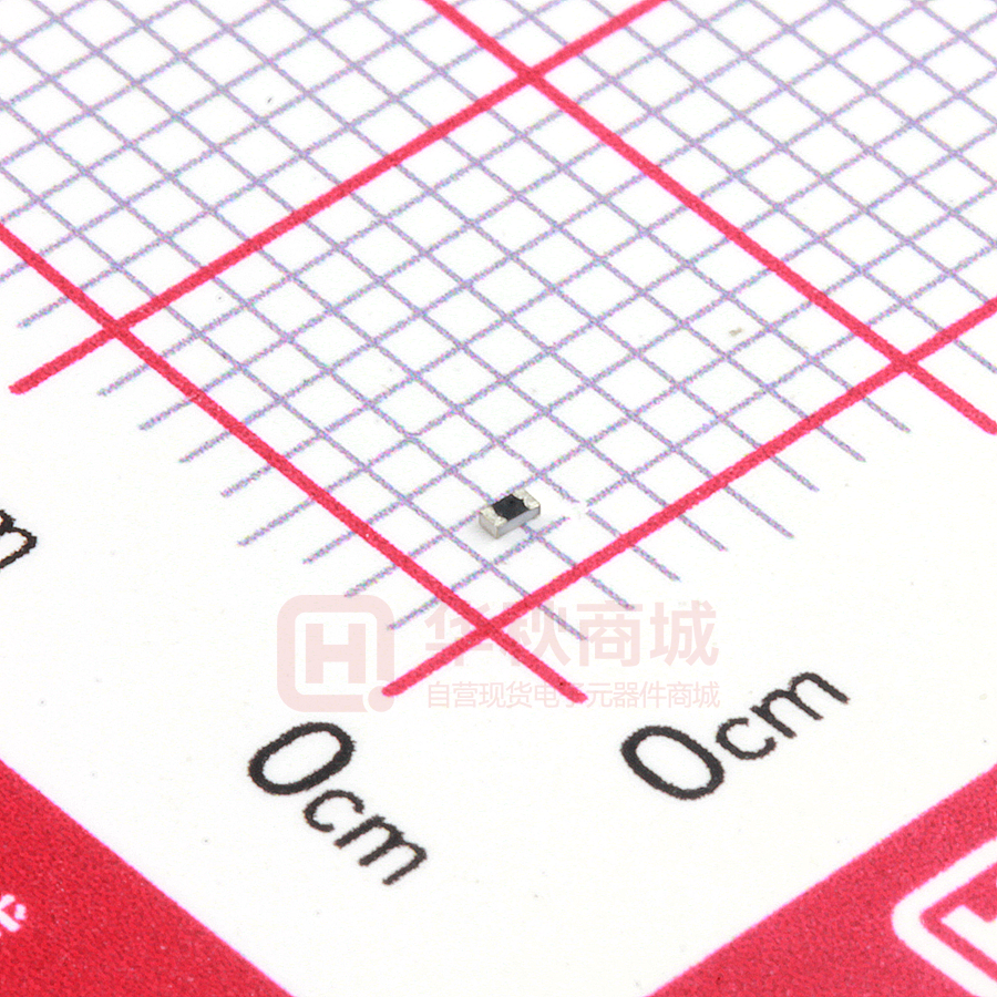

    贴片电阻 0402 1KΩ ±1% 125mW ±200ppm/℃
RC0402FR-7W1KL 数据手册
DATA SHEET GENERAL PURPOSE CHIP RESISTORS RC_L series ±0.1%, ±0.5%, ±1%, ±5% Sizes 0075/0100/0201/0402/0603/0805/ 1206/1210/1218/2010/2512 Product specification – August 02, 2022 V.12 RoHS compliant & Halogen free Product specification Chip Resistor Surface Mount SCOPE This specification describes RC series chip resistors with lead free terminations made by thick film process. RC_L SERIES 2 10 0075 to 2512 ORDERING INFORMATION - GLOBAL PART NUMBER Global part numbers are identified by the series, size, tolerance, packing type, temperature coefficient, taping reel and resistance value. GLOBAL PART NUMBER RC XXXX X X X XX XXXX L (1) APPLICATIONS  All general purpose application (2) (3) (4) (5) (6) (7) (1) SIZE 0075/0100/0201/0402/0603/0805/1206/1210/1218/2010/2512 FEATURES  Halogen Free Epoxy  RoHS compliant  Products with lead free terminations meet RoHS requirements  Pb-glass contained in electrodes, resistors element and glass are exempted by RoHS  Reducing environmentally hazardous wastes  High component and equipment reliability  Saving of PCB space  None forbidden-materials used in products/production (2) TOLERANCE B = ± 0.1% D = ± 0.5% F = ± 1.0% J = ± 5.0% (for jumper ordering, use code of J) (3) PACKAGING TYPE R = Paper taping reel K = Embossed taping reel S = ESD safe reel (0075/0100 only) (4) TEMPERATURE COEFFICIENT OF RESISTANCE - = Based on spec. (5) TAPING REEL & POWER 07 = 7 inch dia. Reel & Standard power 10 = 10 inch dia. Reel 13 = 13 inch dia. Reel 7W = 7 inch dia. Reel & 2 x standard power 7N = 7 inch dia. Reel, ESD safe reel (0075/0100 only) 3W = 13 inch dia. Reel & 2 x standard power (6) RESISTANCE VALUE There are 2~4 digits indicated the resistance value. Letter R/K/M is decimal point Example: 97R6 = 97.6Ω 9K76 = 9760Ω 1M = 1,000,000Ω (7) DEFAULT CODE Letter L is the system default code for ordering only.(Note) ORDERING EXAMPLE The ordering code for a RC0402 0.0625W chip resistor value 100KΩwith ±5% tolerance, supplied in 7-inch tape reel of 10,000 units per reel is: RC0402JR-07100KL. NOTE 1. All our RSMD products meet RoHS compliant and Halogen Free. "LFP" of the internal 2D reel label mentions "Lead Free Process". 2. On customized label, "LFP" or specific symbol can be printed. www.yageo.com Aug. 02, 2022 V.12 Product specification Chip Resistor Surface Mount RC_L SERIES 3 10 0075 to 2512 MARKING RC0075 / RC0100 / RC0201 / RC0402 No Marking ynsc007 Fig. 1 RC0603 0 1%, 0.5%,E24 exception values 10/11/13/15/20/75 of E24 series YNSC037 Fig. 2 240 = 24 × 100 = 24 88 YNSC038 1%, 0.5%, E96 refer to EIA-96 marking method, including values 10/11/13/15/20/75 of E24 series Fig. 3 88A = 806 × 100 = 806 Ω 03 YNSC001 5%, E24 series : 3 digits First two digits for significant figure and 3rd digit for number of zeros Fig. 4 Value = 10 KΩ RC0805 / RC1206 / RC1210 / RC2010 / RC2512 00 YNSC004 1%, 0.5%, E24/E96 series : 4 digits First three digits for significant figure and 4th digit for number of zeros Fig. 5 Value = 10 KΩ 03 YNSC001 5%, E24 series : 3 digits First two digits for significant figure and 3rd digit for number of zeros Fig. 6 Value = 10 KΩ RC1218 YNSC099 E-24 series: 3 digits, ± 5% First two digits for significant figure and 3rd digit for number of zeros Fig. 7 Value = 10 KΩ 00 YNSC103 Both E-24 and E-96 series: 4 digits, ± 1% & ± 0.5% First three digits for significant figure and 4th digit for number of zeros Fig. 8 Value = 10 KΩ For further marking information, please see special data sheet "Chip resistors marking". www.yageo.com Aug. 02, 2022 V.12 Product specification Chip Resistor Surface Mount RC_L 4 10 0075 to 2512 SERIES Outlines CONSTRUCTION The resistor is constructed on top of a high-grade ceramic body. Internal metal electrodes are added on each end to make the contacts to the thick film resistive element. The composition of the resistive element is a noble metal imbedded into a glass and covered by a second glass to prevent environmental influences. The resistor is laser trimmed to the rated resistance value. The resistor is covered with a protective epoxy coat, finally the two external terminations (matte tin on Ni-barrier) are added, as shown in Fig.9. For dimensions, please refer to Table 1 marking layer overcoat primary glass layer resistive layer (Jumper chip is a conductor) inner electrode termination(Ni/matte tin) inner electrode H ceramic substrate I2 overcoat I1 W YNSC086 L 9 Fig. 9 Chip resistor outlines DIMENSION Table 1 TYPE RC0075 L (mm) W (mm) H (mm) I1 (mm) I2 (mm) 0.30±0.01 0.15±0.01 0.13±0.01 0.08±0.03 0.08±0.03 RC0100 0.40±0.02 0.20±0.02 0.13±0.02 0.10±0.03 0.10±0.03 RC0201 0.60±0.03 0.30±0.03 0.23±0.03 0.10±0.05 0.15±0.05 RC0402 1.00±0.05 0.50±0.05 0.35±0.05 0.20±0.10 0.25±0.10 RC0603 1.60±0.10 0.80±0.10 0.45±0.10 0.25±0.15 0.25±0.15 RC0805 2.00±0.10 1.25±0.10 0.50±0.10 0.35±0.20 0.35±0.20 RC1206 3.10±0.10 1.60±0.10 0.55±0.10 0.45±0.20 0.45±0.20 RC1210 3.10±0.10 2.60±0.15 0.55±0.10 0.45±0.15 0.50±0.20 RC1218 3.10±0.10 4.60±0.10 0.55±0.10 0.45±0.20 0.40±0.20 RC2010 5.00±0.10 2.50±0.15 0.55±0.10 0.60±0.20 0.55±0.20 RC2512 6.35±0.10 3.10±0.15 0.55±0.10 0.60±0.20 0.60±0.20 ELECTRICAL CHARACTERISTICS Table 2 CHARACTERISTICS POWER OPERATING TEMPERATURE RANGE -55℃ to 125℃ RC0075 1/50 outlines W Fig. 4 Chip resistor MAXIMUM WORKING VOLTAGE 10V MAXIMUM DIELECTRIC OVERLOAD WITHSTANDING VOLTAGE VOLTAGE 25V 25V RESISTANCE RANGE TEMPERATURE COEFFICIENT JUMPER CRITERIA 5% (E24) 10Ω≦R
RC0402FR-7W1KL
物料型号:RC_L系列,尺寸从0075到2512,公差为±0.1%,±0.5%,±1%,±5%。
器件简介:RC系列芯片电阻器采用厚膜工艺制造,具有无铅端子,符合RoHS标准,无卤素。
引脚分配:文档中没有明确提到引脚分配,但通常这类表面贴装电阻器有两端子用于与电路板连接。
参数特性: - 工作温度范围:RC0402至RC2512为-55℃至+155℃,RC0075至RC0201为-55℃至+125℃。 - 最大工作电压和最大电压值因型号而异,具体数值请参考电气特性表。 - 电阻范围和温度系数也有不同规格,例如5%(E24)、1%(E24/E96)、0.5%(E24/E96)、0.1%(E24/E96)。
功能详解:电阻器构建在高级陶瓷基板上,内部金属电极与厚膜电阻元件接触,电阻元件由嵌入玻璃中的贵金属组成,并通过激光修调至额定电阻值。电阻器覆盖有保护性环氧涂层,并添加了两个外部端子(Ni阻隔层上的亚光锡)。
应用信息:适用于所有通用目的应用,包括节省PCB空间、提高组件和设备可靠性、减少环境有害物质排放。
封装信息:提供多种封装尺寸,从0075到2512,以及不同的包装类型,如纸带卷(R)、压花带卷(K)、防静电安全卷(S)等。
