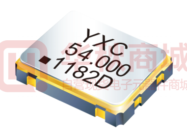

    YSO110TR 50MHZ 1.8V~3.3V ±10PPM -40~85℃ 和老料号OT201650MJBA4SL完全相同
OT7JI-111-50M 数据手册
Suply CRYSTAL OSCILLATOR YSO110TR Wide Voltage Applications Features ‧Consumer Electronics Industrial Control IOT ‧Frequency range:1MHz-54MHz . ‧Ultra Small SMD seam sealed ‧Package Size: 1.6*1.2 , 2.0*1.6 2.5*2.0 , 3.2*2.5 , 5.0*3.2 , 7.0*5.0mm crystal oscillator units. Specifications Frequency Range 1MHz to 54MHz,or specify Supply Voltage 1.8V~3.3V Output Type CMOS Frequency Tolerance(at 25℃) ±10ppm,±20ppm,or specify Output Load 15pF Operating Temperature Range -40~+85℃,-40~+125℃,or specify Storage Temperature Range -55~+125℃ Frequency Versus Temperature Characteristics ± 20ppm, ± 30ppm, ± 50ppm, or specify Voltage Vol ( Max. ) / Vol ( Min. ) VOH = 90%Vdd/VOL = 10%Vdd Duty Cycle 45~55% Start-up Time 3ms Max. Rise Time/Fall Time 4nS Max Supply Current See Below Frequency Aging (at 25℃) ±3 ppm / year Max. Current Consumption Power Dissipation Vcc=1.8~3.3V 15pF only 1.000~40.000MHZ Supply Voltage (V) 7050/5032/3225 1.8V 4mA max 2.5V 3.3V 4.5mA max 5mA max 2520/2016/1612 4mA max Pin Dimension 41.000~54.000MHZ 7050/5032/3225/2520 9mA max 10mA max 12mA max 2016/1612 10mA max Pin Assignments Pin #1 #2 #3 #4 FUNCTION Tri-state GND OUTPUT VDD www.yxc.hk 第1页共4页 CRYSTAL OSCILLATOR YSO110TR Wide Voltage Dimensions and Patterns [unit:mm] Package Size – Dimensions (Unit: mm) Recommended Land Pattern (Unit: mm) 1.6*1.2mm #2 #4 0.80max #1 Bottom View 0.775 0.5 0.775 #2 1.25±0.1 MARKING #1 #3 0.6 0.2 0.6 #3 0.395 0.3 0.395 1.65±0.1 #4 0.08 0.495 0.5 #3 #4 #2 0.1 0.775 0.5 0.775 #3 #2 0.9 0.95 0.9 #4 #2 #3 0.95 0.8±0.1 0.8 0.65 0.8 MARKING #1 #1 0.65 #4 0.68 2.5±0.1 2.0±0.1 2.5*2.0mm #2 #3 0.57±0.1 0.7±0.1 0.80max #1 Bottom View 1.65±0.1 MARKING #1 0.675 0.3 0.675 2.05±0.1 #4 0.475±0.1 0.5±0.1 0.475±0.1 2.0*1.6mm 0.78 0.4 3.2*2.5mm 3.2±0.1 1.1 0.8 1.1 1.0 4 2 3 Bottom View 1.0±0.1 Top View 1.3 2 1 2.5±0.1 MARKING 1 1.3 1.0 1.2 3 4 Side View www.yxc.hk 第2页共4页 CRYSTAL OSCILLATOR YSO110TR Wide Voltage 5.0*3.2mm #2 #1 1.0 MARKING 2.2 3.2±0.1 1.2 #3 #4 #2 #4 #3 1.2 1.2±0.1 #1 1.4 2.54±0.1 5.0±0.2 2.54 7.0*5.0mm 7.00±0.15 #2 2.6±0.1 5.08±0.15 2.0 #4 #3 3.28 1.4±0.1 MARKING #1 #2 5.0±0.1 #3 1.4±0.15 0.6±0.15 2.2 #4 #1 1.8 Notes: 1.A capacitor of value 0.01uf~0.1uf or higher between Vdd and GND is required. Reflow Soldering Profile Pre Heating Temperature Tp1 ~ Tp2 = + 170 °C Heating Temperature TMlt = + 220 °C Peek Temperature TMax. = + 260 °C Temperature +260℃ TMax. +220℃ Tmlt Point of measuring In case of Solder ability Terminal. In case of Resistance to soldering heat Surface. Tp2 Tp1 35s 100s t(time) www.yxc.hk 第3页共4页 CRYSTAL OSCILLATOR YSO110TR Wide Voltage Test Circuit Taping Specification(Unit: mm) Size(OSC) A B C D E F G H SMD-7050 180±2.0 16.0±0.3 7.50±0.1 5.50±0.1 8.0±0.1 2.00±0.1 61.0±1.0 16.0±1.0 SMD-5032 180±2.0 12.0±0.3 5.40±0.1 3.60±0.1 8.0±0.1 1.70±0.1 61.0±1.0 12.0±1.0 SMD-3225 180±2.0 8.0±0.3 3.40±0.1 2.70±0.1 4.0±0.1 1.50±0.1 61.0±1.0 8.0±1.0 SMD-2520 180±2.0 8.0±0.3 2.90±0.1 2.40±0.1 4.0±0.1 1.20±0.1 61.0±1.0 8.0±1.0 SMD-2016 180±2.0 8.0±0.3 2.30±0.1 1.90±0.1 4.0±0.1 0.95±0.1 61.0±1.0 8.0±1.0 SMD-1612 180±2.0 8.0±0.3 1.80±0.1 1.40±0.1 4.0±0.1 0.80±0.1 61.0±1.0 8.0±1.0 www.yxc.hk 第4页共4页

物料型号:YSO110TR WideVoltage YXO
器件简介:YSO110TR WideVoltage YXO是一款超小型SMD密封晶体振荡器,适用于工业控制和物联网应用。
引脚分配: - #1: Tri-state - #2: GND - #3: OUTPUT - #4: VDD
参数特性: - 频率范围:1MHz至54MHz - 供电电压:1.8V至3.3V - 输出类型:CMOS - 频率容差:±10ppm, 20ppm或指定 - 输出负载:15pF - 工作温度范围:-40°C至+85°C或-40°C至+125°C - 存储温度范围:-55°C至+125°C - 频率随温度变化特性:±20ppm, ±30ppm, ±50ppm或指定 - 电压变化最大值/最小值:VOH= 90%Vdd/VOL= 10%Vdd - 占空比:45%至55% - 启动时间:最大3ms - 上升时间/下降时间:最大4ns - 供电电流:见下文表格 - 频率老化(25°C):每年最大±3ppm
功能详解:文档提供了详细的供电电流消耗表格,不同封装尺寸的推荐焊盘图案,以及回流焊接温度曲线。
应用信息:适用于工业控制和物联网。
封装信息:提供了多种封装尺寸的详细尺寸和图案,包括1.61.2mm、2.01.6mm、2.52.0mm、3.22.5mm、5.03.2mm和7.05.0mm。
