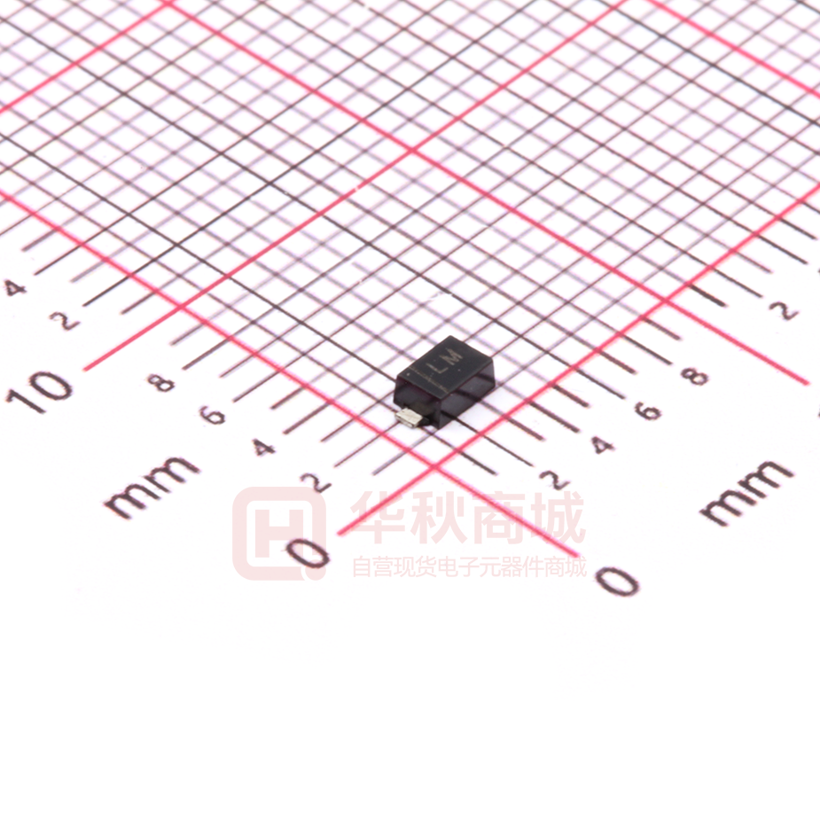

    ESD抑制器/TVS二极管 VRWM=15V VBR(Min)=16.8V VC=26.5V IPP=100A Ppp=4KW SOD123FL
PTVSHC1DF15VU 数据手册
PTVSHC1DF15VU Transient Voltage Suppressor Description The PTVSHC1DF15VU transient voltage suppressor is designed to replace multilayer varistors (MLVs) in portable applications such as cell phones, notebook computers, and PDA’s. They feature large cross-sectional area junctions for conducting high transient currents, offer desirable electrical characteristics for board level protection, such as fast response time, lower operating voltage, lower clamping voltage and no device degradation when compared to MLVs. The PTVSHC1DF15VU protects sensitive semiconductor components from damage or upset due to electrostatic discharge (ESD) and other voltage induced transient events. The PTVSHC1DF15VU is available in a SOD-123FL package with working voltages of 12 volt. It is used to meet the ESD immunity requirements of IEC 61000-4-2, Level 4 (±30kV air, ±30kV contact discharge) Feature Applications  4000W Peak pulse power per line (tP = 8/20μs)  Cell phone handsets and accessories  SOD-123FL package  Personal digital assistants (PDA’s)  Response time is typically < 1 ns  Notebooks, desktops, and servers  Protect one I/O or power line  Portable instrumentation  Low clamping Voltage  Cordless phones  RoHS compliant  Digital cameras  Transient protection for data lines to IEC 61000-4-2(ESD)  Peripherals ±30KV(air), ±30KV(contact); IEC 61000-4-4 (EFT) 40A (5/50ns)  MP3 players Mechanical Characteristics  Lead finish:100% matte Sn(Tin)  Mounting position: Any  Qualified max reflow temperature:260℃  Device meets MSL 1 requirements  Pure tin plating: 7 ~ 17 um  Pin flatness:≤3mil Rev.06.0 1 www.prisemi.com Transient Voltage Suppressor PTVSHC1DF15VU Electronics Parameter I IF Symbol Parameter VRWM Peak Reverse Working Voltage IR Reverse Leakage Current @ VRWM VBR Breakdown Voltage @ IT IT Test Current IPP Maximum Reverse Peak Pulse Current VC Clamping Voltage @ IPP PPP Peak Pulse Power CJ Junction Capacitance IF Forward Current VF Forward Voltage @ IF V VC VBR VRWM IR VF IT IPP Electrical characteristics per line@25℃( unless otherwise specified) Parameter Symbol Conditions Peak Reverse Working Voltage VRWM Breakdown Voltage VBR It =1mA Reverse Leakage Current IR VRWM =15V Clamping Voltage VC IPP=40A tP = 8/20μs Clamping Voltage VC IPP=100A tP = 8/20μs Junction Capacitance Cj VR=0V f = 1MHz Min. Typ. 16.8 650 Max. Units 15 V 17 V 1 μA 22 22.5 V 26 26.5 V 700 750 pF Absolute maximum rating@25℃ Rating Symbol Value Units Peak Pulse Power ( tP = 8/20μS ) Ppp 4000 W Lead Soldering Temperature TL 260 (10 sec) ℃ Operating Temperature TJ -55 to +150 ℃ TSTG -55 to +150 ℃ Storage Temperature Rev.06.0 2 www.prisemi.com Transient Voltage Suppressor PTVSHC1DF15VU Typical Characteristics tf=8μs IPP – Peak Pulse Current - % of IPP 100 100 % Of Rated Power 80 60 tP =20μs(IPP /2) 40 80 60 40 20 20 0 0 0 5 10 15 20 25 0 30 25 50 75 100 125 150 TL – Lead Temperature - ℃ t - Time -μs Fig 1.Pulse Waveform Fig 2.Power Derating Curve 1000 35 Pulse waveform: tp=8/20us f=1MHz 30 800 C-Junction capacitance (pF) VC-Clamping Voltage (V) 25 20 15 10 600 400 200 5 0 0 0 20 40 60 80 100 120 IPP-Peak pulse current (A) 140 0 160 Fig 3. Clamping voltage vs. Peak pulse current 0.5 1.0 1.5 VR-Reverse voltage (V) 2.0 2.5 Fig 4. Capacitance vs. Reveres voltage Peak Pulse Power (W) 10000 1000 100 10 1 10 100 Pulse Duration(us) 1000 Fig 5. Non Repetitive Peak Pulse Power vs. Pulse time Rev.06.0 3 www.prisemi.com Transient Voltage Suppressor PTVSHC1DF15VU Solder Reflow Recommendation Peak Temp=257℃, Ramp Rate=0.802deg. ℃/sec 280 240 200 160 120 80 40 0 0 30 60 90 120 150 180 240 210 270 300 330 360 390 420 450 480 Time (sec) PCB Design For TVS diodes a low-ohmic and low-inductive path to chassis earth is absolutely mandatory in order to achieve good ESD protection. Novices in the area of ESD protection should take following suggestions to heart:  Do not use stubs, but place the cathode of the TVS diode directly on the signal trace.  Do not make false economies and save copper for the ground connection.  Place via holes to ground as close as possible to the anode of the TVS diode.  Use as many via holes as possible for the ground connection.  Keep the length of via holes in mind! The longer the more inductance they will have. Rev.06.0 4 www.prisemi.com Transient Voltage Suppressor PTVSHC1DF15VU Product dimension (SOD-123FL) Unit:mm Ordering information Device Package Shipping PTVSHC1DF15VU SOD-123FL (Pb-Free) 3000 / Tape & Reel Rev.06.0 5 www.prisemi.com Transient Voltage Suppressor PTVSHC1DF15VU IMPORTANT NOTICE and are registered trademarks of Prisemi Electronics Co., Ltd (Prisemi) ,Prisemi reserves the right to make changes without further notice to any products herein. Prisemi makes no warranty, representation or guarantee regarding the suitability of its products for any particular purpose, nor does Prisemi assume any liability arising out of the application or use of any product or circuit, and specifically disclaims any and all liability, including without limitation special, consequential or incidental damages. “Typical” parameters which may be provided in Prisemi data sheets and/or specifications can and do vary in different applications and actual performance may vary over time. All operating parameters, including “Typicals” must be validated for each customer application by customer’s technical experts. Prisemi does not convey any license under its patent rights nor the rights of others. The products listed in this document are designed to be used with ordinary electronic equipment or devices, Should you intend to use these products with equipment or devices which require an extremely high level of reliability and the malfunction of with would directly endanger human life (such as medical instruments, aerospace machinery, nuclear-reactor controllers, fuel controllers and other safety devices), please be sure to consult with our sales representative in advance. Website: http://www.prisemi.com For additional information, please contact your local Sales Representative. ©Copyright 2009, Prisemi Electronics is a registered trademark of Prisemi Electronics. All rights are reserved. Rev.06.0 6 www.prisemi.com
