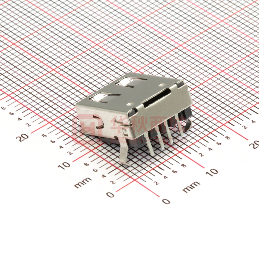

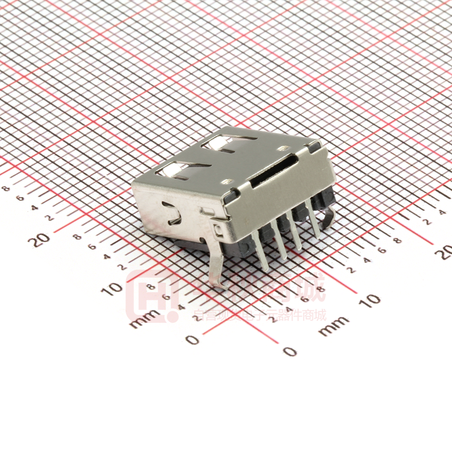

    USB连接器 Type-A 4P 弯插 端口数:1 额定电流:3A 额定电压:30V 工作温度:-25℃~+85℃
USB1130-15-A 数据手册
2.71 H 13.8 7.00 2.00 Ø 92 0. Ø 26 2. G 10.28 Specifications Material Insulator: LCP, E130i, UL94V-0, Black Contact: C2680 Shell: SUS304 PCB Edge 12.50±0.10 Plating Terminal: Contact Area: See Ordering Grid Solder Area: 100-150u" Tin Underplating: 50-100u"Nickel Shell: 50-120u"Nickel Recommended PCB Layout Thickness=1.6mm Tolerance:±0.05mm 14.16 5.72 ref. E 13.14 4.13±0.20 5.12±0.10 13.1 ref. Electrical Current Rating: 3.0 Amp Voltage Rating: 30V Contact Resistance: 30 mΩ max. Insulation Resistance: 1000 MΩ min. Dielectric Withstand Voltage: 500 V AC 6.99 F 1.27 2.29±0.15 C 3.22 D 15.6 1.65 Mechanical & Environmental Operating Temperature: -25°C to +85°C Mating Force: 35N max. Unmating Force: 10N min. Durability: 10000 cycles 2.00 2.71 7.00 12.99±0.20 Ordering Grid 2.85 Min. 8.0 Max. USB1130 B Mating View 3 4 Request Samples and Quotation Packing Options A = Tape & Reel (230pcs/Reel) Part Number Product Description USB1130 USB 2.0 Receptacle, Type A, 4 Pin, Through Hole, Horizontal, Top Mount, Without Flange Drawing Date 6th August 2020 By Detail 2 A Contact Plating 15 = 15u" Gold (standard) GF = Gold Flash 30 = 30u" Gold A 1 XX Revision Date 5 CC Drawing Release A1 15/12/21 Tolerances (Except as Noted) Length Angle X.X ± 0.35 X.XX ± 0.25 X.°± 3° X.X°± 1.5° 6 Units: Metric (mm) C 3rd Angle Projection 7 This drawing is confidential and copyright of Global Connector Technology, Ltd (GCT). This drawing must not be copied or disclosed without written consent. E & OE www.gct.co Not to Scale Drawn By CC 8 Sheet No. 1/2 168mm H 5520mm 168mm 230 cavities with product 7 cavities empty 24.00±0.10 4.00±0.10 2.00±0.10 300mm empty 7 cavities empty 10 +0. 0 Ø 0 -0.0 1.5 32.00 25.5mm G F Elongated Sprocket hold Direction of Unreeling 0.20±0.05 .75 R0 Scale 2:1 32.5mm E Notes: Peeling off force of top tape: 0.1-0.7N Peeling angel: 165° - 180° Peeling speed: 300mm/minute Ø330mm Direction of Unreeling GP Part Number Specification Q'ty Carrier Tape 32.0mm (W) x 5.856m (L) 10 Cover Tape 25.5mm (W) 61.56m Reel Ø330 x 32.5mm 10 Bag 400 x 400 x 400mm, PE 1 Cardboard Triangles 430 x 370x 3mm (L x W x T) 4 Carton 350 x 350 x 410mm (L x W x H) 1 Carrier Tape D Label Green product label C Cover Tape Cardboard Triangles Tape Bag 410mm Reels B 3 230 10 2300 m 0m 35 Part Number Product Description USB1130 USB 2.0 Receptacle, Type A, 4 Pin, Through Hole, Horizontal, Top Mount, Without Flange Drawing Date 6th August 2020 By Detail 2 Pcs./Carton Green product label 35 0m m 1 Reels/Carton Label Carton A Pcs./Reel 4 Revision Date 5 CC Drawing Release A1 15/12/21 Tolerances (Except as Noted) Length Angle - - Units: Metric (mm) C 3rd Angle Projection 6 7 This drawing is confidential and copyright of Global Connector Technology, Ltd (GCT). This drawing must not be copied or disclosed without written consent. E & OE www.gct.co Not to Scale Drawn By CC 8 Sheet No. 2/2 Mouser Electronics Authorized Distributor Click to View Pricing, Inventory, Delivery & Lifecycle Information: Global Connector Technology (GCT): USB1130-15-A
