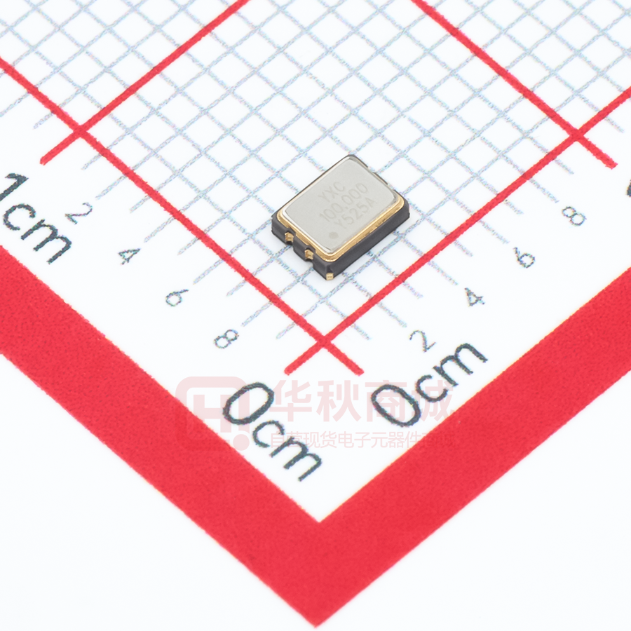

    可编程晶振 3.3V ±20ppm SMD3225_4P
O93225100MEDA4SI-13 数据手册
PROGRAMMABLE CRYSTAL OSCILLATOR YSO690PR Low Jitter Applications Features ‧Any frequency ‧One time programmable ‧Low jitter design with new developed IC ‧PLL circuit provides wide frequency ‧Package Size: 2.0*1.6 , 2.5*2.0 , 3.2*2.5 , 5.0*3.2 , 7.0*5.0mm range application (1-200MHz) Specifications Parameter Frequency Range Supply Voltage Variation (Vdd)10% 1.8V 2.5V 3.3V 1MHz to125MHz 1MHz to 200MHz 1MHz to 200MHz 1.62V~1.98V 2.25V~2.75V 2.97V~3.63V Standby Current 400uA Frequency Tolerance ±20ppm,±25ppm,±50ppm,or specify Output Load 15pF Operating Temperature Range -40~+85℃,or specify Storage Temperature Range -55~+150℃ Voltage Vol ( Max. ) / Vol ( Min. ) VOH = 90%Vdd/VOL = 10%Vdd Duty Cycle 45~55% Period Jitter (@12K-20Mhz) 1.8V=1.5ps 2.5V=1.1ps 3.3V=1ps Start-up Time 7ms Max. Supply Current See Below Frequency Aging (at 25℃) ±3 ppm / year Max. Pin Dimension Pin Symbol Functionality Output Enable 1 OE/ST/NC Standby No Connect Pin Assignments H:specified frequency output L:output is low. Specified frequency output stop. H:specified frequency output L:output is low. Device goes to sleep mode. Supply current reduces to 400uA(Standby Current). Pin 1 = VDD or Pin 1 is Open : Specified frequency output.Pin 1 has no function 2 GNG Power Electrical ground 3 OUT Output Oscillator output 4 VDD Power Power supply voltage Current Consumption Supply Voltage (V) Power Dissipation 1.000~30.000MHZ 31.000~75.000MHZ 76.000~110.000MHZ 111.000~166.000MHZ 167.000~200.000MHZ 1.8V 18mA max 19mA max 20mA max 20mA max 20mA max 2.5V 21mA max 22mA max 23mA max 24mA max 25mA max 3.3V 23mA max 24mA max 25mA max 26mA max 27mA max www.yxc.hk 第1页共4页 PROGRAMMABLE CRYSTAL OSCILLATOR YSO690PR Low Jitter Dimensions and Patterns [unit:mm] Package Size – Dimensions (Unit: mm) Recommended Land Pattern (Unit: mm) #1 #3 #4 0.85max #2 2.5±0.1 2.0±0.1 MARKING #2 0.9 0.95 0.9 0.65 #1 0.68 2.5*2.0mm #3 0.1 0.57±0.1 0.7±0.1 0.775 0.5 0.775 #4 0.8 0.65 0.8 MARKING #1 #2 1.65±0.1 #4 Bottom View 0.675 0.3 0.675 2.05±0.1 0.475±0.1 0.5±0.1 0.475±0.1 2.0*1.6mm #3 0.78 0.8±0.1 0.95 0.4 3.2*2.5mm 3.2±0.15 1.3 1.0 1.3 #2 1.1 0.8 1.1 1.0 MARKING 2.5±0.1 0.65 #1 1.2 0.9 #3 0.9±0.1 #4 5.0*3.2mm 1.4 2.54±0.1 5.0±0.2 #2 2.2 1.0 #3 #4 1.2±0.1 MARKING 3.2±0.1 1.2 #1 1.2 2.54 www.yxc.hk 第2页共4页 PROGRAMMABLE CRYSTAL OSCILLATOR YSO690PR Low Jitter 7.0*5.0mm 7.00±0.15 5.08±0.15 2.0 #3 3.28 1.4±0.1 #4 2.2 2.6±0.1 MARKING #2 5.0±0.1 #1 1.4±0.15 0.6±0.15 1.8 Notes: 1.A capacitor of value 0.01uf~0.1uf or higher between Vdd and GND is required. Reflow Soldering Profile Pre Heating Temperature Tp1 ~ Tp2 = + 170 °C Heating Temperature TMlt = + 220 °C Peek Temperature TMax. = + 260 °C Temperature +260℃ TMax. +220℃ Point of measuring In case of Solder ability Terminal. In case of Resistance to soldering heat Surface. Tmlt Tp2 Tp1 35s 100s t(time) Test Circuit www.yxc.hk 第3页共4页 PROGRAMMABLE CRYSTAL OSCILLATOR YSO690PR Low Jitter Taping Specification(Unit: mm) Size(OSC) A B C D E F G H SMD-7050 180±2.0 16.0±0.3 7.50±0.1 5.50±0.1 8.0±0.1 2.00±0.1 61.0±1.0 16.0±1.0 SMD-5032 180±2.0 12.0±0.3 5.40±0.1 3.60±0.1 8.0±0.1 1.70±0.1 61.0±1.0 12.0±1.0 SMD-3225 180±2.0 8.0±0.3 3.40±0.1 2.70±0.1 4.0±0.1 1.50±0.1 61.0±1.0 8.0±1.0 SMD-2520 180±2.0 8.0±0.3 2.90±0.1 2.40±0.1 4.0±0.1 1.20±0.1 61.0±1.0 8.0±1.0 SMD-2016 180±2.0 8.0±0.3 2.30±0.1 1.90±0.1 4.0±0.1 0.95±0.1 61.0±1.0 8.0±1.0 www.yxc.hk 第4页共4页
O93225100MEDA4SI-13
物料型号:YSO690PR
器件简介:这是一个低抖动设计的可编程晶体振荡器,采用新开发的IC,具有PLL电路,可提供1-200MHz的宽频率范围应用。
引脚分配: - 1号引脚:OE/ST/NC,用于输出使能/待机/无连接。 - 2号引脚:GND,电源地。 - 3号引脚:OUT,振荡器输出。 - 4号引脚:VDD,电源供电电压。
参数特性: - 频率范围:1MHz至125MHz或200MHz,取决于供电电压。 - 供电电压变化:1.62V至1.98V,2.25V至2.75V,或2.97V至3.63V。 - 待机电流:400uA。 - 频率容差:+20ppm, 25ppm, 50ppm或指定值。 - 输出负载:15pF。 - 工作温度范围:-40°C至+85°C或指定值。 - 存储温度范围:-55°C至+150°C。 - 电压变化:VOH=90%Vdd,VOL=10%Vdd。 - 占空比:45%至55%。 - 周期抖动:1.8V时1.5ps,2.5V时1.1ps,3.3V时1ps。 - 启动时间:最大7ms。 - 供电电流:见下文。 - 频率老化:每年最大±3ppm。
功能详解:文档提供了详细的电流消耗数据,不同频率下的供电电压与功耗关系,以及推荐的回流焊接温度曲线。
应用信息:适用于需要低抖动和宽频率范围的应用。
封装信息:提供了多种封装尺寸,包括2.01.6mm、2.52.0mm、3.22.5mm、5.03.2mm和7.05.0mm,并附有推荐的焊盘图案。
