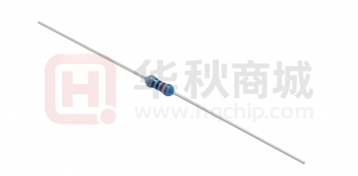

RN1/2W1.6KΩFT/BA1
RN1/2W1.6KΩFT/BA1
    TYOHM(幸亚电阻)
    插件,D3.3xL9.2mm
    插件电阻 1.6KΩ ±1% 500mW ±50ppm/℃
RN1/2W1.6KΩFT/BA1 数据手册
