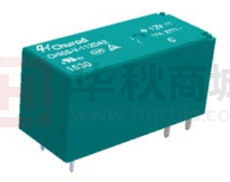

    功率继电器 SPST 12VDC 360Ω 277VAC 17A
CHI03-S-112DA2 数据手册
东莞市中汇瑞德电子股份有限公司 Churod Electronics Co., Ltd. RELAY SPECIFICATION 继电器规格书 (File No.: 001000 / Version: 00 / Issue Date:Sep. 24th, 2020) Product Description(品名) CHI03-S-112DA2 Part Number(编码) Customer(客户) Customer Approval (客户批准) STAMPING AREA (盖章处) Issued(发行) Checked(审核) Approved(承认) Helena.Gong JianXiang Guo Hiroharu Dan Page 1 of 7 东莞市中汇瑞德电子股份有限公司 Churod Electronics Co., Ltd. SAFETY STANDARD 安全标准 UL certificate E341422 UL 证书 TUV certificate R50384623 TUV 证书 CQC certificate CQC17002177358 CQC 证书 COIL CHARACTERISTICS 线圈特性 Coil resistance 360±10% Ω 线圈电阻 Rated voltage 12VDC 额定电压 Max. allowable voltage 130% of rated coil voltage 最大允许电压 Rated power 400mW 额定功率 Operate voltage ≤9.0VDC 吸合电压 Release voltage ≥0.6VDC 释放电压 CONTACT RATINGS 触点规格 Contact configuration 1 Form A (SPST) 触点结构 Contact material Ag Alloy 触点材料 Initial contact resistance ≤100mΩ at 6VDC/1A 初始接触电阻 Rated switching voltage (Normally Open) 277VAC 额定切换电压(常开触点) Rated switching voltage (Normally Close) — 额定切换电压(常闭触点) Rated current (Normally Open) 17A 额定电流(常开触点) Rated current (Normally Close) — 额定电流(常闭触点) Rated switching power (Normally Open) 4,709VA 额定切换功率(常开触点) Rated switching power (Normally Close) — 额定切换功率(常闭触点) Page 2 of 7 东莞市中汇瑞德电子股份有限公司 Churod Electronics Co., Ltd. Minimum applicable load (Normally Open) 5VDC 100mA 最小使用负载(常开触点) Minimum applicable load (Normally Close) — 最小使用负载(常闭触点) Operate time ≤15ms, excluding bounce time 吸合时间 ≤15ms,不含触点抖动时间 Release time ≤8ms, excluding bounce time 释放时间 ≤8ms,不含触点抖动时间 Mechanical endurance 1 Million cycles, 300 cycles/minute 机械寿命 Electrical endurance (Resistive Load) 17A, 277VAC, 100k cycles, 6 cycles/minute 电气寿命(阻性负载) INSULATION PERFORMANCE 绝缘性能 Dielectric strength 1000VAC 1minute, between open contacts 介电强度 1000VAC 1 分钟(断开触点间) 5000VAC 1minute, between coil to contacts 5000VAC 1 分钟(线圈与触点间) Impulse withstand voltage 10KV (1.2/50μs), between coil to contacts 耐浪涌电压 10KV(线圈与触点间) Insulation resistance 1000MΩ at 500VDC, between open contacts and coil 绝缘电阻 to contacts 1000MΩ(断开触点间及线圈与触点间) Insulation systems (UL) 155 (F) 绝缘系统 Insulation type Basic insulation 绝缘类型 基本绝缘 ENVIRONMENT PERFORMANCE 环境性能 Category of protection (IEC61810-1) RT III (Wash tight) 密封类型 防水密封型 Operating temperature -40~105℃ 工作温度 Operating humidity 20~85%RH 工作湿度 Storage temperature -40~85℃ 储藏温度 Storage humidity 20~85%RH 储藏湿度 Vibration resistance (1) Capability to function during vibration 耐振动 No opening or closing of any closed or opened contact circuit respectively exceed 10μs when the Page 3 of 7 东莞市中汇瑞德电子股份有限公司 Churod Electronics Co., Ltd. relay is subjected to vibration of 10~55Hz and 1.5mm dual amplitude in each of three mutually perpendicular axes for 10 minutes respectively, while it is in operate condition and in release condition. 抗误动作能力 动作/释放状态下,继电器在三个轴向耐受频率 10~55Hz及振幅1.5mm的振动各10分钟,触点误动作 不超过10微秒。 (2) Capability to function after vibration No trouble on structure and characteristics after the relay is subjected to vibration of 10~55Hz and 1.5mm dual amplitude in each of three mutually perpendicular axes for 2 hours respectively. 振动耐久能力 继电器在三个轴向耐受振幅1.5mm及频率10~55Hz的 振动各2小时,产品构造和性能无异常发生。 Shock resistance (1) Capability to function during shock 耐冲击 No opening or closing of any closed or opened contact circuit respectively exceed 10μs when the 2 relay is subjected to shock of 98.1m/s for 11ms in both directions of each of three mutually perpendicular axes for 3 times respectively, while it is in operate condition and in release condition. 抗误动作能力 动作/释放状态下,继电器在三轴六方向耐受加速度 2 98.1m/s 及作用时间11毫秒的冲击各3次,触点误动作 不超过10微秒。 (2) Capability to function after shock No trouble on structure and characteristics after the 2 relay is subjected to shock of 981m/s for 6ms in both directions of each of three mutually perpendicular axes for 3 times respectively. 冲击耐久能力 2 继电器在三轴六方向耐受加速度981m/s 及作用时间6 毫秒的冲击各3次,产品构造和性能无异常发生。 Cold resistance No trouble on structure and characteristics after 耐低温 placed at -40℃ for 240 hours and 2 hours recovery in standard atmospheric conditions. -40℃中放置240小时并在标准大气条件中恢复2小时 后继电器构造和特性无异常。 Page 4 of 7 东莞市中汇瑞德电子股份有限公司 Churod Electronics Co., Ltd. Thermal resistance No trouble on structure and characteristics after 耐高温 placed at 85℃ for 240 hours and 2 hours recovery in standard atmospheric conditions. 85℃中放置 240 小时并在标准大气条件中恢复 2 小时 后继电器构造和特性无异常。 Humidity resistance No trouble on structure and characteristics after 耐湿度 placed at 40℃&95%RH for 240 hours and 2 hours recovery in standard atmospheric conditions. 40℃及95%相对湿度中放置240小时并在标准大气条 件中恢复2小时后继电器构造和特性无异常。 Thermal shock resistance No trouble on structure and characteristics after 耐冷热冲击 endure 100 cycles of cyclic temperature and 2 hours recovery in standard atmospheric conditions, which the temperature cycle consists of -40℃ for 0.5 hour and 85℃ for 0.5 hour. -40℃和85℃中各放置0.5小时为一个温度周期,循环 100次,在标准大气条件中恢复2小时后继电器构造和 特性无异常。 Terminal robustness No trouble on structure and characteristics after 引出端强度 endure axial pushing/pulling force of 10N for 10 seconds. 继电器引出端承受 10 牛顿的轴向压入、拨出力,延时 10 秒,构造和性能无异常。 MARKING 产品标识 Position of marking Top of relay cover 标识位置 外壳顶部 Cover color Blue 外壳颜色 蓝色 Ink color Laser 字体颜色 激光 Trade mark 商标 Page 5 of 7 东莞市中汇瑞德电子股份有限公司 Churod Electronics Co., Ltd. MOUNTING INFORMANTION 安装信息 Solderability 260±5℃ for 5±0.5 seconds 可焊性 Resistance to soldering heat 260±5℃ for 10+1 seconds 耐焊接热 350±10℃ for 3.5±0.5 seconds Standard direction Relay PCB terminals downward 标准方向 继电器 PCB 型引出端朝下 Terminals assignment and outline dimensions Refer to APPENDIX 引出端脚位和外形尺寸 请参考附件 ENGINEERING NOTES 注意事项 # Unless otherwise explicitly stated, the standard environment conditions for measurement or testing are listed as followings: # 除非特别申明,测量或试验的标准环境条件如下: (1) Ambient temperature is 23+5℃; 环境温度为 23+5℃; (2) Atmospheric pressure is 96+10% kPa; 大气压力为 96+10% kPa; (3) Relative humidity is 50%+25% RH. 相对湿度为 50%+25% RH. Page 6 of 7 东莞市中汇瑞德电子股份有限公司 Churod Electronics Co., Ltd. Outline dimension 外形尺寸 Wiring diagram (Bottom View) Mounting dimensions(Bottom View) 接线图(底视图) 安装孔位图(底视图) Note:All unspecified tolerance (including outline dimension and PC board dimension) according to following listing 备注:产品外形尺寸未标注尺寸公差及 PC 板未注尺寸公差按下表执行。 产品外形尺寸未注尺寸公差 PC 板未注尺寸公差 Outline dimensions hadn’t specified tolerance PC board dimensions hadn’t specified tolerance 外形尺寸 公差 Outline dimensions Tolerance ≤0.3 ±0.1 ≤1 ±0.2 ≤5 ±0.3 >5 ±0.5 ±0.1 Page 7 of 7
