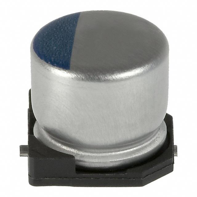

    82 µF 10 V 铝聚合物电容器 径向,Can - SMD 23 毫欧 105°C 时为 1000 小时
APXC100ARA820MF60G 数据手册
CONDUCTIVE POLYMER ALUMINUM SOLID CAPACITORS Surface Mount @Super low ESR, impedance and high heat resistance have been obtained by using conductive polymer as electrolyte. (ESR and rated ripple current values are improved from PXA series.) @Rated voltage range : 2.5 to 16Vdc, Capacitance range : 27 to 470MF @Case size range : F5B5.7L to F8B6.7L @Suitable for DC-DC converters, voltage regulators and decoupling applications used to computer motherboards etc. @RoHS Compliant ?SPECIFICATIONS Items Characteristics Category Temperature Range Rated Voltage Range Capacitance Tolerance Surge Voltage Leakage Current -55 to +105C 2.5 to 16Vdc P20% (M) Rated voltage(V)B1.15 I=0.2CV (max.) I : Max. leakage current (MA), C : Nominal capacitance (MF), V : Rated voltage (Vdc) Dissipation Factor (tane) 0.12 max. Low Temperature Characteristics (Max. Impedance Ratio) Z(-25C)/Z(+20C)[1.15 Z(-55C)/Z(+20C)[1.25 (at 20C, 120Hz) (at 105C) (at 20C after 2 minutes) (at 20C, 120Hz) (at 100kHz) The following specifications shall be satisfied when the capacitors are restored to 20C after the rated voltage is applied for 1,000 hours at 105C. Appearance No significant damage Capacitance change [P20% of the initial value DF (tanE) [150% of the initial specified value ESR [150% of the initial specified value Leakage current [The initial specified value The following specifications shall be satisfied when the capacitors are restored to 20C after subjecting them to the DC rated voltage at 60C, 90 to 95% RH for 500 hours. Appearance No significant damage Capacitance change [P20% of the initial value DF (tanE) [150% of the initial specified value ESR [150% of the initial specified value Leakage current [The initial specified value The capacitors shall be subjected to 1,000 cycles each consisting of charge with the surge voltage specified at 105C for 30 seconds through a protective resistor(R=1kO) and discharge for 5 minutes 30 seconds. Appearance No significant damage Capacitance change [P20% of the initial value DF (tanE) [150% of the initial specified value ESR [150% of the initial specified value Leakage current [The initial specified value 1% per 1,000 hours maximum (Confidence level 60% at 105C) Endurance Bias Humidity Surge Voltage Failure Rate *Note : If any doubt arises, measure the leakage current after following voltage treatment. Voltage treatment : DC rated voltage are applied to the capacitors for 120 minutes at 105C. ?DIMENSIONS [mm] ?MARKING @Terminal Code : A EX) 4V220MF P CP0.2 BP0.2 FDP0.5 W 0.3max. LP0.3 2 3 4 5 6 fD 5 6.3 8 L 5.7 5.7 6.7 A 5.3 6.6 8.3 B 5.3 6.6 8.3 C 5.9 7.2 9.0 W 0.5 to 0.8 0.5 to 0.8 0.7 to 1.1 P 1.4 1.9 3.1 C28M 220 4V AP0.2 ?PART NUMBERING SYSTEM 1 Size code E60 F60 H70 7 8 9 10 11 12 13 14 15 16 17 18 A PXC AAA A RA AAA M AAA G Supplement code Size code Capacitance tolerance code Capacitance code (ex. 27MF:270,100MF:101) Taping code Terminal code Voltage code (ex. 6.3V:6R3,10V:100) Series code Category Please refer to "A guide to global code (conductive polymer type)" (1/2) CAT. No. E1001F CONDUCTIVE POLYMER ALUMINUM SOLID CAPACITORS Surface Mount ?STANDARD RATINGS ESR(momax/20c) WV(Vdc) 2.5 4 6.3 10 16 Cap(mF) 180 270 470 150 220 330 100 180 220 56 82 150 27 39 82 Size code E60 F60 H70 E60 F60 H70 E60 F60 H70 E60 F60 H70 E60 F60 H70 100kHz 300kHz(Ref. value) 30 20 17 30 21 18 35 22 18 40 23 20 45 25 25 22 18 16 22 19 17 26 19 17 31 21 19 35 23 23 (2/2) Rated ripple current (mArms/100k to 300kHz) -55 to +105c 2,000 2,700 3,420 2,000 2,640 3,300 1,780 2,580 3,300 1,660 2,400 3,160 1,570 2,300 2,830 Part No. APXC2R5ARA181ME60G APXC2R5ARA271MF60G APXC2R5ARA471MH70G APXC4R0ARA151ME60G APXC4R0ARA221MF60G APXC4R0ARA331MH70G APXC6R3ARA101ME60G APXC6R3ARA181MF60G APXC6R3ARA221MH70G APXC100ARA560ME60G APXC100ARA820MF60G APXC100ARA151MH70G APXC160ARA270ME60G APXC160ARA390MF60G APXC160ARA820MH70G CAT. No. E1001F
