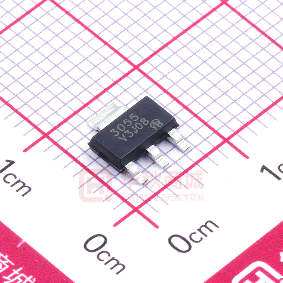

    MOSFETs N-沟道 60V 4.5A SOT-223
NTF3055-100T1G-VB 数据手册
NTF3055-100T1G-VB www.VBsemi.com NTF3055-100T1G-VB Datasheet N-Channel 60-V (D-S) MOSFET FEATURES PRODUCT SUMMARY VDS (V) 60 • Halogen-free ID (A)a RDS(on) (Ω) 0.076 at VGS = 10 V 4.5 0.085 at VGS = 4.5 V 3.5 Qg (Typ.) • Trench Power MOSFET RoHS 10 nC COMPLIANT APPLICATIONS • Load Switches for Portable Devices D SOT-223-3 D G G D S S N-Channel MOSFET ABSOLUTE MAXIMUM RATINGS TA = 25 °C, unless otherwise noted Parameter Drain-Source Voltage Gate-Source Voltage Continuous Drain Current (TJ = 150 °C) Symbol VDS VGS TC = 25 °C TC = 70 °C TA = 25 °C TA = 70 °C Pulsed Drain Current TC = 25 °C TA = 25 °C TC = 25 °C TC = 70 °C Maximum Power Dissipation TA = 25 °C TA = 70 °C Operating Junction and Storage Temperature Range Continuous Source-Drain Diode Current Soldering Recommendations (Peak Temperature)e, f ID IDM IS PD TJ, Tstg Limit 60 ± 20 4.5 3.2 a 2.7 2.3 20 3.2 2.1b, c 4.0 3.0 2.5b, c 1.6b, c - 55 to 150 260 Unit V A W °C THERMAL RESISTANCE RATINGS Parameter Symbol Maximum Unit Typical t≤5s RthJA 40 50 Maximum Junction-to-Ambienta, c, d °C/W RthJF 15 20 Steady State Maximum Junction-to-Foot (Drain) Notes: a. Package limited, TC = 25 °C. b. Surface Mounted on 1" x 1" FR4 board. c. t = 10 s. d. Maximum under Steady State conditions is 95 °C/W. e. See Reliability Manual for profile. The ChipFET is a leadless package. The end of the lead terminal is exposed copper (not plated) as a result of the singulation process in manufacturing. A solder fillet at the exposed copper tip cannot be guaranteed and is not required to ensure adequate bottom side solder interconnection. f. Rework Conditions: manual soldering with a soldering iron is not recommended for leadless components. 服务热线:400-655-8788 1 NTF3055-100T1G-VB www.VBsemi.com SPECIFICATIONS TJ = 25 °C, unless otherwise noted Parameter Symbol Test Conditions Min. VDS VGS = 0 V, ID = 250 µA 60 Typ. Max. Unit Static Drain-Source Breakdown Voltage ΔVDS /TJ VDS Temperature Coefficient VGS(th) Temperature Coefficient ΔVGS(th)/TJ Gate-Source Threshold Voltage ID = 250 µA VGS(th) VDS = VGS , ID = 250 µA Gate-Source Leakage IGSS VDS = 0 V, VGS = ± 12 V Zero Gate Voltage Drain Current IDSS On-State Drain Currenta ID(on) Drain-Source On-State Resistancea Forward Transconductancea RDS(on) gfs V 25 mV/°C - 4.0 1.0 2.5 V ± 100 nA VDS = 60 V, VGS = 0 V 1 VDS = 60 V, VGS = 0 V, TJ = 55 °C 10 VDS ≥ 5 V, VGS = 4.5 V µA A 30 VGS = 10 V , ID = 4.0 A 0.076 VGS = 4.5 V, ID = 3.0 A 0.085 VDS = 10 V, ID = 4.0 A 45 Ω S b Dynamic Input Capacitance Output Capacitance Coss Reverse Transfer Capacitance Crss Total Gate Charge Qg Gate-Source Charge Qgs Gate-Drain Charge Qgd Gate Resistance Turn-on Delay Time Rise Time Turn-Off Delay Time Fall Time Turn-on Delay Time Rise Time Turn-Off Delay Time Fall Time 810 Ciss Rg VDS = 30V , VGS = 0 V, f = 1 MHz VDS = 30 V, VGS = 10 V, ID = 4.0 A VDS = 30 V, VGS = 4.5 V, ID = 3.0 A td(off) pF 22 33 10 15 2.5 f = 1 MHz VDD =30V, , RL = 1.5 Ω ID ≅ 4.0 A, VGEN = 4.5 V, Rg = 1 Ω Ω 2.4 15 25 10 15 35 55 tf 12 20 td(on) 10 15 tr td(off) nC 1.7 td(on) tr 120 100 VDD = 30V , RL = 1.5 Ω ID ≅ 4.0 A, VGEN = 10 V, Rg = 1 Ω tf 12 20 25 40 10 15 ns Drain-Source Body Diode Characteristics Continuous Source-Drain Diode Current IS Pulse Diode Forward Current ISM Body Diode Voltage VSD Body Diode Reverse Recovery Time trr Body Diode Reverse Recovery Charge Qrr Reverse Recovery Fall Time ta Reverse Recovery Rise Time tb 7.2 TC = 25 °C 30 IS = 4.0 A, VGS = 0 V IF = 4.0 A, dI/dt = 100 A/µs, TJ = 25 °C A 0.8 1.2 V 20 40 ns 10 20 nC 10 10 ns Notes: a. Pulse test; pulse width ≤ 300 µs, duty cycle ≤ 2 % b. Guaranteed by design, not subject to production testing. Stresses beyond those listed under “Absolute Maximum Ratings” may cause permanent damage to the device. These are stress ratings only, and functional operation of the device at these or any other conditions beyond those indicated in the operational sections of the specifications is not implied. Exposure to absolute maximum rating conditions for extended periods may affect device reliability. 服务热线:400-655-8788 2 NTF3055-100T1G-VB www.VBsemi.com TYPICAL CHARACTERISTICS 25 °C, unless otherwise noted 20 10 VGS =10thru 5 V TC = - 55 °C 8 I D - Drain Current (A) I D - Drain Current (A) 10 8 VGS = 4V 6 6 TC = 125 °C 4 4 2 TC = 25 °C VGS =2.5 V 0 0.0 0.5 1.0 VGS = 3.5 V 2.0 1.5 2.5 0 0.0 3.0 0.5 1.5 2.0 VGS - Gate-to-Source Voltage (V) VDS - Drain-to-Source Voltage (V) Output Characteristics Transfer Characteristics 1000 0.014 0.013 Ciss 800 0.012 C - Capacitance (pF) RDS(on) - On-Resistance (Ω) 1.0 0.011 0.010 VGS = 4 . 5 V 0.009 0.008 600 400 Coss 200 VGS = 1 0 V 0.007 Crss 0 0 0 6 12 18 24 0 30 15 45 60 VDS - Drain-to-Source Voltage (V) ID - Drain Current (A) Capacitance On-Resistance vs. Drain Current 10 1.6 ID = 6.3 A ID = 6.3 A 8 VGS = 4.5 V, 10 V VDS = 10 V 6 VDS = 16 V 4 2 (Normalized) 1.4 R DS(on) - On-Resistance VGS - Gate-to-Source Voltage (V) 30 1.2 1.0 0.8 0 0 5 10 15 Qg - Total Gate Charge (nC) Gate Charge 20 25 0.6 - 50 - 25 0 25 50 75 100 125 150 TJ - Junction Temperature (°C) On-Resistance vs. Junction Temperature 服务热线:400-655-8788 3 NTF3055-100T1G-VB www.VBsemi.com TYPICAL CHARACTERISTICS 25 °C, unless otherwise noted 0.050 100 ID = 4.0 A TJ = 150 °C R DS(on) - On-Resistance (Ω) I S - Source Current (A) 0.040 TJ = 25 °C 10 1 0.0 0.030 TJ = 125 °C 0.020 TJ = 25 °C 0.010 0.000 0.4 0.2 0.6 0.8 1.0 1.2 0 1 VSD - Source-to-Drain Voltage (V) 4 5 On-Resistance vs. Gate-to-Source Voltage 1.4 50 40 ID = 250 µA Power (W) 1.2 V GS(th) (V) 3 VGS - Gate-to-Source Voltage (V) Source-Drain Diode Forward Voltage 1.0 0.8 30 20 10 0.6 0.4 - 50 2 - 25 0 25 50 75 100 125 0 0.001 150 0.01 0.1 1 10 100 600 Time (s) TJ - Temperature (°C) Single Pulse Power Threshold Voltage 100 10 10 µs Limited by RDS(on)* I D - Drain Current (A) 100 µs 1 ms 1 10 ms 100 ms, DC 0.1 TC = 25 °C Single Pulse 0.01 0.1 BVDSS Limited 1 10 100 VDS - Drain-to-Source Voltage (V) * VGS > minimum VGS at which RDS(on) is specified Single Pulse Power, Junction-to-Case 服务热线:400-655-8788 4 NTF3055-100T1G-VB www.VBsemi.com TYPICAL CHARACTERISTICS 25 °C, unless otherwise noted 18 8 15 Power (W) ID - Drain Current (A) 6 12 9 Package Limited 4 6 2 3 0 0 0 25 50 75 100 TC - Case Temperature (°C) Current Derating* 125 150 25 50 75 100 125 150 TC - Case Temperature (°C) Power Derating * The power dissipation PD is based on TJ(max) = 150 °C, using junction-to-case thermal resistance, and is more useful in settling the upper dissipation limit for cases where additional heatsinking is used. It is used to determine the current rating, when this rating falls below the package limit. 服务热线:400-655-8788 5 NTF3055-100T1G-VB www.VBsemi.com TYPICAL CHARACTERISTICS 25 °C, unless otherwise noted 2 1 Duty Cycle = 0.5 ffecti 0.2 Notes: 0.1 PDM 0.1 0.05 t1 t2 1. Duty Cycle, D = t1 t2 2. Per Unit Base = RthJA = 80 °C/W 0.02 3. TJM - TA = PDMZthJA(t) Single Pulse 4. Surface Mounted 0.01 10-4 10-3 10-2 10-1 1 Square Wave Pulse Duration (s) 10 100 600 Normalized Thermal Transient Impedance, Junction-to-Ambient 2 Normalized Effective Transient Thermal Impedance 1 Duty Cycle = 0.5 0.2 0.1 0.1 0.05 0.02 Single Pulse 0.01 10-4 10-3 10-2 10-1 Square Wave Pulse Duration (s) 1 10 Normalized Thermal Transient Impedance, Junction-to-Foot 服务热线:400-655-8788 6 NTF3055-100T1G-VB www.VBsemi.com SOT-223 (HIGH VOLTAGE) B D A 3 0.08 (0.003) B1 C 0.10 (0.004) M C B M A 4 3 H E 0.20 (0.008) M C A M L1 1 2 3 4xL 3xB e θ 0.10 (0.004) M C B M e1 4xC MILLIMETERS INCHES DIM. MIN. MAX. MIN. MAX. A 1.55 1.80 0.061 0.071 B 0.65 0.85 0.026 0.033 B1 2.95 3.15 0.116 0.124 C 0.25 0.35 0.010 0.014 D 6.30 6.70 0.248 0.264 E 3.30 3.70 0.130 e 2.30 BSC e1 4.60 BSC 0.181 BSC H 6.71 7.29 0.264 L 0.91 - 0.036 L1 θ 0.061 BSC - 0.146 0.0905 BSC 0.287 0.0024 BSC 10' - 10' ECN: S-82109-Rev. A, 15-Sep-08 DWG: 5969 Notes 1. Dimensioning and tolerancing per ASME Y14.5M-1994. 2. Dimensions are shown in millimeters (inches). 3. Dimension do not include mold flash. 4. Outline conforms to JEDEC outline TO-261AA. 服务热线:400-655-8788 7 NTF3055-100T1G-VB www.VBsemi.com Disclaimer All products due to improve reliability, function or design or for other reasons, product specifications and data are subject to change without notice. Taiwan VBsemi Electronics Co., Ltd., branches, agents, employees, and all persons acting on its or their representatives (collectively, the "Taiwan VBsemi"), assumes no responsibility for any errors, inaccuracies or incomplete data contained in the table or any other any disclosure of any information related to the product.(www.VBsemi.com) Taiwan VBsemi makes no guarantee, representation or warranty on the product for any particular purpose of any goods or continuous production. To the maximum extent permitted by applicable law on Taiwan VBsemi relinquished: (1) any application and all liability arising out of or use of any products; (2) any and all liability, including but not limited to special, consequential damages or incidental ; (3) any and all implied warranties, including a particular purpose, non-infringement and merchantability guarantee. Statement on certain types of applications are based on knowledge of the product is often used in a typical application of the general product VBsemi Taiwan demand that the Taiwan VBsemi of. Statement on whether the product is suitable for a particular application is non-binding. It is the customer's responsibility to verify specific product features in the products described in the specification is appropriate for use in a particular application. Parameter data sheets and technical specifications can be provided may vary depending on the application and performance over time. All operating parameters, including typical parameters must be made by customer's technical experts validated for each customer application. Product specifications do not expand or modify Taiwan VBsemi purchasing terms and conditions, including but not limited to warranty herein. Unless expressly stated in writing, Taiwan VBsemi products are not intended for use in medical, life saving, or life sustaining applications or any other application. Wherein VBsemi product failure could lead to personal injury or death, use or sale of products used in Taiwan VBsemi such applications using client did not express their own risk. Contact your authorized Taiwan VBsemi people who are related to product design applications and other terms and conditions in writing. The information provided in this document and the company's products without a license, express or implied, by estoppel or otherwise, to any intellectual property rights granted to the VBsemi act or document. Product names and trademarks referred to herein are trademarks of their respective representatives will be all. Material Category Policy Taiwan VBsemi Electronics Co., Ltd., hereby certify that all of the products are determined to be RoHS compliant and meets the definition of restrictions under Directive of the European Parliament 2011/65 / EU, 2011 Nian. 6. 8 Ri Yue restrict the use of certain hazardous substances in electrical and electronic equipment (EEE) - modification, unless otherwise specified as inconsistent.(www.VBsemi.com) Please note that some documents may still refer to Taiwan VBsemi RoHS Directive 2002/95 / EC. We confirm that all products identified as consistent with the Directive 2002/95 / EC European Directive 2011/65 /. Taiwan VBsemi Electronics Co., Ltd. hereby certify that all of its products comply identified as halogen-free halogen-free standards required by the JEDEC JS709A. Please note that some Taiwanese VBsemi documents still refer to the definition of IEC 61249-2-21, and we are sure that all products conform to confirm compliance with IEC 61249-2-21 standard level JS709A.
