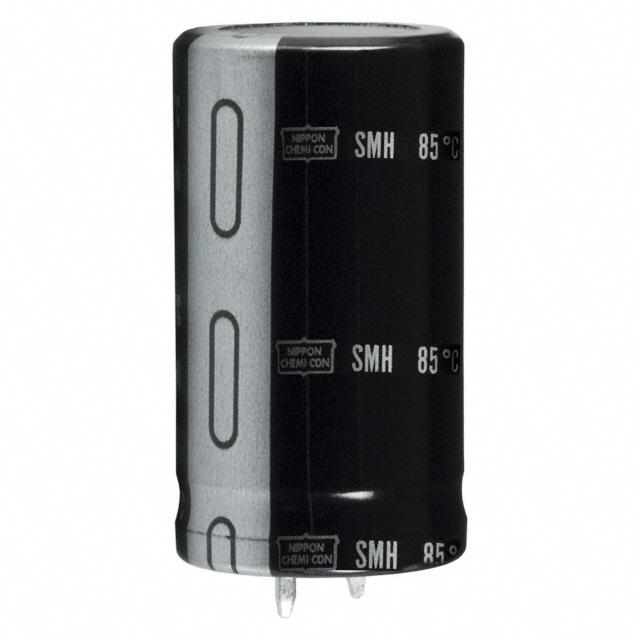

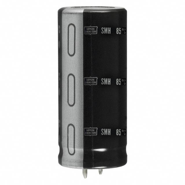

    1800 µF 100 V 铝电解电容器 径向,Can - 卡入式 138 毫欧 @ 120Hz 85°C 时为 2000 小时
ESMH101VSN182MP40T 数据手册
SMH SERIES Engineering Bulletin Mar 07 SMH Series  The SMH series capacitors are the standard 85C, large capacitance, snap-in capacitors from United Chemi-Con. The load life for the SMH series is 2,000 hours at 85C with the rated ripple current applied. The very high CV values and ripple current capabilities make these capacitors ideal for use in power supply filter circuits. The SMH capacitors are available in 2 or 4-pin snap-in styles and 4 or 5-pin straight terminals. The SMH series is RoHS compliant offering Pb-free construction. The standard SMH series capacitors are not solvent proof. Refer to guidelines and precautions on the website for usage and installation conditions recommended for United Chemi-Con products. Summary of Specifications  PC board 2 or 4-pin snap-in; optional 4 or 5-pin straight terminals.  Capacitance range: 56 to 270,000µF.  Voltage range: 6.3 to 450VDC.  Category temperature range: 40C to 85C for 6.3 to 100V; 25C to 85C for 160 to 450V.  Leakage current: 0.02CV(µA) or 3mA, whichever is smaller, after 5 minutes at 20C.  Standard capacitance tolerance: 20%  Nominal case size (DL): 2220mm to 4080mm.  Rated lifetime: 2,000 hours at 85C with the rated ripple current applied. United Chemi-Con, Inc. 9801 W. Higgins Road, Rosemont, IL 60018 Tel 847-696-2000 Fax 847-696-9278 www.chemi-con.com 1/ 15 SMH SNAP MOUNT 85C Snap Mount  Large Capacitance  High CV  High Ripple  RoHS Compliant  85C Maximum Temperature Engineering Bulletin Mar 07 SMH Series SMH Specifications - Snap Mount Item Characteristics Category Temperature Range 40 to 85C for 6.3 to 100VDC; 25 to 85C for 160 to 450VDC Rated Voltage Range 6.3 to 450VDC Capacitance Range 56 to 270,000F Capacitance Tolerance 20% ( M ) at 20C, 120Hz Leakage Current I  0.02CV (A ) or 3mA, whichever is smaller, after 5 minutes at 20C. Where I = Max. leakage current (A ), C = Nominal capacitance (F ) and V = Rated voltage ( V ) Dissipation Factor ( Tan ) At 20C, 120Hz Rated Voltage ( V ) 6.3 10 16 25 35 50 63 -100 160 - 250 315 - 450 Tan  ( DF ) Max.† 0.60 0.50 0.40 0.30 0.25 0.20 0.15 * 0.10 * 0.15 * 0.15 maximum for 35mm and 40mm diameter. † For rated voltages ≤ 63V, values are not valid for case sizes >35mm in diameter or >50mm in length. Low Temperature Characteristics At 120Hz, impedance ( Z ) ratio between the 25C or 40C value and 20C value shall not exceed the values given below. Rated Voltage ( V ) SMH SNAP MOUNT 85C Rated Ripple Current Multipliers 6.3 -16 25 35 50, 63 80, 100 160 - 400 Z (25C ) / Z (20C ) 4 3 3 2 2 4 450 8 Z (40C ) / Z (20C ) 15 10 8 6 5 — — Ambient Temperature (C ) 45C 60C 70C 85C 1.73 1.50 1.32 1.00 Frequency (Hz ) Endurance (Load Life) DC Rated Voltage 50Hz 120Hz 300Hz 1kHz 10kHz 100kHz 6.3 -50V 0.95 1.00 1.03 1.05 1.08 1.08 63 -100V 0.92 1.00 1.07 1.13 1.19 1.20 160 - 250V 0.81 1.00 1.17 1.32 1.45 1.50 315 - 450V 0.77 1.00 1.16 1.30 1.41 1.43 The following specifications shall be satisfied when the capacitors are restored to 20C after subjecting them to DC voltage for 2,000 hours at 85C with the rated ripple current applied. The sum of the DC voltage and peak AC voltage must not exceed the full rated voltage of the capacitors. Capacitance change: ≤ 20% of initial measured value Tan  ( DF ) : ≤ 200% of initial specified value Leakage current : ≤ initial specified value Shelf Life The following specifications shall be satisfied when the capacitors are restored to 20C after exposing them for 1,000 hours at 85C without voltage applied. The rated voltage shall be applied to the capacitors for a minimum of 30 minutes, at least 24 hours and not more than 48 hours before the measurements. Capacitance change: ≤ 20% of initial measured value Tan  ( DF ) : ≤ 150% of initial specified value Leakage current : ≤ initial specified value 2 / 15 United Chemi-Con, Inc. 9801 W. Higgins Road, Rosemont, IL 60018 Tel 847-696-2000 Fax 847-696-9278 www.chemi-con.com Engineering Bulletin Mar 07 SMH Series Diagram of Dimensions - Snap Mount Unit: mm Snap Mount Types VSN & VNN Ø 22~ Ø 35 Type VRD Ø 35 See Pin Detail Pb-free PVC Sleeve See Pin Detail Pb-free PVC Sleeve PC board pin-out C* A* D 1 PC board pin-out B 30° D35 1 10 2-2x ** Vent ** Vent L 2 Type VND Ø 35 & Ø 40 PC board pin-out B 22.5 2-4x L 2 C* 30° D35 1 ** Vent 22.5 2-4x L 2 Type VQT Ø 40 P See Pin Detail Pb-free PVC Sleeve W1 PC board pin-out C 360° 6 D* B* Edge of can 25 D40 1 A* W ** Vent Type VSN Ø 22 - Ø 30 VSN Ø 35 VNN Ø 22 - Ø 35 VND Ø 35 - Ø 40 P 4.00.5 3.50.5 5.81.0 5.81.0 W W1 W2 1.50.2 1.0 1.0 2-5x L 2 VR & VQ Pin Dimensions VR Straight Pin W1 VQ Standoff Pin P CAUTION: * Use the blank terminals for mechanical support only. The blank terminals must not be connected to a solder trace on the PC board, but be electrically isolated from the negative or positive terminal. ** Vent may be located either on the bottom or side of the can. W1 W W P Edge of can Edge of can P1 Type Straight Pin (VR) Standoff Pin (VQ) P 5.501.0 3.751.0 P1 — 2.0 max. W W1 1.50.1 0.7 United Chemi-Con, Inc. 9801 W. Higgins Road, Rosemont, IL 60018 Tel 847-696-2000 Fax 847-696-9278 www.chemi-con.com 3 / 15 SMH SNAP MOUNT 85C VS & VN Pin Dimensions PC board pin-out B A* 30° D35 1 W2 See Pin Detail Pb-free PVC Sleeve C* A* ** Vent 2-4x L 2 Type VQD Ø 35 See Pin Detail Pb-free PVC Sleeve 22.5 Engineering Bulletin Mar 07 SMH Series Part Numbering System for SMH Series When ordering, always specify complete 18-field global part number. 18 Fields 1 2 3 4 5 6 7 8 9 10 11 12 13 14 15 16 17 18 E S MH 2 0 1 V S N 4 7 1 M P 3 5 T 9 7 SNAP MOUNT 85C SMH 8 6 5 4 3 2 1 4 / 15 Supplement Code. Field 18. All construction options listed have Sn100% terminal plating. S = PET sleeve without end disk. W = PET sleeve with end disk. M = Pb-free PVC sleeve without end disk. T = Pb-free PVC sleeve with end disk. Case Size. Fields 15, 16 and 17. The single letter diameter code is inserted in field 15. P = Ø 22mm Q = Ø 25.4mm R = Ø 30mm A = Ø 35mm B = Ø 40mm The double digit length code is inserted in fields 16 and 17. 20 = 20mm 25 = 25mm 30 = 30mm 35 = 35mm 40 = 40mm 45 = 45mm 50 = 50mm 63 = 63mm 80 = 80mm Capacitance Tolerance. Field 14. M = 20% Capacitance. Fields 11, 12 and 13. Expressed in Microfarads. The first two digits are significant figures inserted in fields 11 and 12, and the third digit inserted in field 13 indicates the number of zeros for capacitance of 10F or more. R indicates the decimal point for capacitance less than 10F (e.g. 4R7 = 4.7F; 470 = 47F; 471 = 470F; 472 = 4,700F; 473 = 47,000F ). Dummy Terminals. Field 10. N = No dummy terminals. D = 2 dummy terminals. T = 3 dummy terminals. Terminal Type. Fields 8 and 9. VS = Snap-in pins, 4.0mm in length, 3.5mm for Ø35 only. VN = Snap-in pins, 5.8mm in length. VR = Straight pins. VQ = Straight standoff pins. DC Rated Voltage. Fields 5, 6 and 7. Expressed in Volts. The first two digits are significant figures inserted in fields 5 and 6, and the third digit inserted in field 7 indicates the number of zeros for rated voltage of 10VDC or more. R indicates the decimal point for rated voltage less than 10VDC (e.g. 2R0 = 2.0VDC; 200 = 20VDC; 201 = 200VDC). Rule Exception: Coding for rated voltage 315VDC = 3B1. Series Name. Fields 2, 3 and 4. Enter the 3-letter/digit series name in fields 2, 3 and 4. If the series name is only 2 letters/digits, place a dash in field 4. For a series name with more than 3 letters/digits, refer to the individual series for the appropriate 3-field series name. Capacitor Type. Field 1. Aluminum Electrolytic Capacitor (Polar). United Chemi-Con, Inc. 9801 W. Higgins Road, Rosemont, IL 60018 Tel 847-696-2000 Fax 847-696-9278 www.chemi-con.com Engineering Bulletin Mar 07 SMH Series Standard Voltage Ratings - Snap Mount Rated Voltage (WVDC) 6.3 Volts 8 Volts Surge 15,000 18,000 22,000 27,000 33,000 39,000 18,000 22,000 27,000 33,000 39,000 47,000 56,000 27,000 33,000 39,000 47,000 56,000 68,000 82,000 39,000 47,000 56,000 68,000 82,000 100,000 150,000 180,000 56,000 82,000 100,000 120,000 150,000 220,000 270,000 ESMH6R3VSN153MP25T ESMH6R3VSN183MP30T ESMH6R3VSN223MP30T ESMH6R3VSN273MP35T ESMH6R3VSN333MP40T ESMH6R3VSN393MP50T ESMH6R3VSN183MQ25T ESMH6R3VSN223MQ25T ESMH6R3VSN273MQ30T ESMH6R3VSN333MQ35T ESMH6R3VSN393MQ40T ESMH6R3VSN473MQ45T ESMH6R3VSN563MQ50T ESMH6R3VSN273MR25T ESMH6R3VSN333MR25T ESMH6R3VSN393MR30T ESMH6R3VSN473MR35T ESMH6R3VSN563MR40T ESMH6R3VSN683MR45T ESMH6R3VSN823MR50T ESMH6R3VSN393MA25T ESMH6R3VSN473MA30T ESMH6R3VSN563MA30T ESMH6R3VSN683MA35T ESMH6R3VSN823MA40T ESMH6R3VSN104MA45T ESMH6R3VSN154MA63T ESMH6R3VSN184MA80T ESMH6R3VQT563MB25T ESMH6R3VQT823MB30T ESMH6R3VQT104MB35T ESMH6R3VQT124MB40T ESMH6R3VQT154MB50T ESMH6R3VQT224MB63T ESMH6R3VQT274MB80T 12,000 15,000 18,000 22,000 27,000 33,000 15,000 18,000 22,000 27,000 33,000 39,000 47,000 22,000 27,000 33,000 39,000 47,000 56,000 27,000 33,000 39,000 47,000 56,000 ESMH100VSN123MP25T ESMH100VSN153MP30T ESMH100VSN183MP35T ESMH100VSN223MP40T ESMH100VSN273MP45T ESMH100VSN333MP50T ESMH100VSN153MQ25T ESMH100VSN183MQ25T ESMH100VSN223MQ30T ESMH100VSN273MQ35T ESMH100VSN333MQ40T ESMH100VSN393MQ45T ESMH100VSN473MQ50T ESMH100VSN223MR25T ESMH100VSN273MR30T ESMH100VSN333MR30T ESMH100VSN393MR35T ESMH100VSN473MR40T ESMH100VSN563MR45T ESMH100VSN273MA25T ESMH100VSN333MA25T ESMH100VSN393MA30T ESMH100VSN473MA30T ESMH100VSN563MA35T Case Size Code Maximum ESR ( Ω ) at 20C, 120Hz Rated Ripple Current (A rms) at 85C, 120Hz 22  25 22  30 22  30 22  35 22  40 22  50 25.4  25 25.4  25 25.4  30 25.4  35 25.4  40 25.4  45 25.4  50 30  25 30  25 30  30 30  35 30  40 30  45 30  50 35  25 35  30 35  30 35  35 35  40 35  45 35  63 35  80 40  25 40  30 40  35 40  40 40  50 40  63 40  80 P25 P30 P30 P35 P40 P50 Q25 Q25 Q30 Q35 Q40 Q45 Q50 R25 R25 R30 R35 R40 R45 R50 A25 A30 A30 A35 A40 A45 A63 A80 B25 B30 B35 B40 B50 B63 B80 0.066 0.055 0.045 0.037 0.03 0.026 0.055 0.045 0.037 0.03 0.026 0.021 0.018 0.037 0.03 0.026 0.021 0.018 0.015 0.012 0.026 0.021 0.018 0.015 0.012 0.01 0.01 0.009 0.027 0.02 0.017 0.014 0.012 0.009 0.008 2.44 2.67 3.06 3.49 3.97 4.55 2.7 3.07 3.52 4.02 4.5 5.09 5.71 3.57 3.95 4.45 5.06 5.7 6.48 7.32 4.51 5.01 5.77 6.42 7.29 8.31 10.91 12.78 5.48 6.94 7.95 8.97 10.66 13.79 16.62 22  25 22  30 22  35 22  40 22  45 22  50 25.4  25 25.4  25 25.4  30 25.4  35 25.4  40 25.4  45 25.4  50 30  25 30  30 30  30 30  35 30  40 30  45 35  25 35  25 35  30 35  30 35  35 P25 P30 P35 P40 P45 P50 Q25 Q25 Q30 Q35 Q40 Q45 Q50 R25 R30 R30 R35 R40 R45 A25 A25 A30 A30 A35 0.069 0.055 0.046 0.038 0.031 0.025 0.055 0.046 0.038 0.031 0.025 0.021 0.018 0.038 0.031 0.025 0.021 0.018 0.015 0.031 0.025 0.021 0.018 0.015 2.39 2.76 3.12 3.55 4.04 4.58 2.77 3.04 3.48 3.98 4.54 5.08 5.73 3.53 3.73 4.13 5.05 5.72 6.44 3.73 4.13 4.8 5.27 6.38 Nominal Case Size* DL ( mm ) † For terminal and construction options, refer to the part numbering system for descriptions and codes. * Refer to diagram of dimensions for detailed case size specifications. United Chemi-Con, Inc. 9801 W. Higgins Road, Rosemont, IL 60018 Tel 847-696-2000 Fax 847-696-9278 www.chemi-con.com 5 / 15 SMH Global Part Number† SNAP MOUNT 85C 10 Volts 13 Volts Surge Capacitance (µF ) Engineering Bulletin Mar 07 SMH Series Standard Voltage Ratings - Snap Mount Rated Voltage (WVDC) 10 Volts SMH SNAP MOUNT 85C 13 Volts Surge 16 Volts 20 Volts Surge 25 Volts 32 Volts Surge Capacitance (µF ) Global Part Number† Nominal Case Size* DL ( mm ) Case Size Code Maximum ESR ( Ω ) at 20C, 120Hz Rated Ripple Current (A rms) at 85C, 120Hz 68,000 82,000 100,000 150,000 47,000 56,000 68,000 82,000 120,000 150,000 220,000 ESMH100VSN683MA40T ESMH100VSN823MA50T ESMH100VSN104MA63T ESMH100VSN154MA80T ESMH100VQT473MB25T ESMH100VQT563MB30T ESMH100VQT683MB35T ESMH100VQT823MB40T ESMH100VQT124MB50T ESMH100VQT154MB63T ESMH100VQT224MB80T 35  40 35  50 35  63 35  80 40  25 40  30 40  35 40  40 40  50 40  63 40  80 A40 A50 A63 A80 B25 B30 B35 B40 B50 B63 B80 0.012 0.01 0.01 0.009 0.026 0.021 0.018 0.015 0.012 0.01 0.008 7.27 8.49 8.91 11.67 5.02 5.74 6.56 7.42 9.54 11.39 15.0 8,200 10,000 12,000 15,000 18,000 22,000 12,000 15,000 18,000 22,000 27,000 33,000 15,000 18,000 22,000 27,000 33,000 39,000 47,000 22,000 27,000 33,000 39,000 47,000 56,000 68,000 82,000 100,000 33,000 39,000 47,000 68,000 82,000 100,000 150,000 ESMH160VSN822MP25T ESMH160VSN103MP25T ESMH160VSN123MP30T ESMH160VSN153MP35T ESMH160VSN183MP40T ESMH160VSN223MP50T ESMH160VSN123MQ25T ESMH160VSN153MQ30T ESMH160VSN183MQ35T ESMH160VSN223MQ40T ESMH160VSN273MQ45T ESMH160VSN333MQ50T ESMH160VSN153MR25T ESMH160VSN183MR25T ESMH160VSN223MR30T ESMH160VSN273MR35T ESMH160VSN333MR40T ESMH160VSN393MR45T ESMH160VSN473MR50T ESMH160VSN223MA25T ESMH160VSN273MA30T ESMH160VSN333MA30T ESMH160VSN393MA35T ESMH160VSN473MA40T ESMH160VSN563MA45T ESMH160VSN683MA50T ESMH160VSN823MA63T ESMH160VSN104MA80T ESMH160VQT333MB25T ESMH160VQT393MB30T ESMH160VQT473MB35T ESMH160VQT683MB40T ESMH160VQT823MB50T ESMH160VQT104MB63T ESMH160VQT154MB80T 22  25 22  25 22  30 22  35 22  40 22  50 25.4  25 25.4  30 25.4  35 25.4  40 25.4  45 25.4  50 30  25 30  25 30  30 30  35 30  40 30  45 30  50 35  25 35  30 35  30 35  35 35  40 35  45 35  50 35  63 35  80 40  25 40  30 40  35 40  40 40  50 40  63 40  80 P25 P25 P30 P35 P40 P50 Q25 Q30 Q35 Q40 Q45 Q50 R25 R25 R30 R35 R40 R45 R50 A25 A30 A30 A35 A40 A45 A50 A63 A80 B25 B30 B35 B40 B50 B63 B80 0.081 0.066 0.055 0.044 0.037 0.03 0.055 0.044 0.037 0.03 0.025 0.02 0.044 0.037 0.03 0.025 0.02 0.017 0.014 0.03 0.025 0.02 0.017 0.014 0.012 0.01 0.011 0.009 0.027 0.022 0.019 0.015 0.012 0.01 0.008 2.51 2.77 2.86 3.29 3.72 4.37 2.95 3.46 3.98 4.26 4.72 5.33 3.66 4.0 4.21 4.82 5.36 6.01 6.79 4.15 4.65 5.15 5.95 6.76 7.62 8.63 9.88 11.67 5.15 5.86 6.68 8.27 9.66 11.39 15.17 5,600 6,800 8,200 10,000 12,000 15,000 6,800 8,200 10,000 12,000 15,000 18,000 ESMH250VSN562MP25T ESMH250VSN682MP30T ESMH250VSN822MP35T ESMH250VSN103MP40T ESMH250VSN123MP45T ESMH250VSN153MP50T ESMH250VSN682MQ25T ESMH250VSN822MQ25T ESMH250VSN103MQ30T ESMH250VSN123MQ35T ESMH250VSN153MQ40T ESMH250VSN183MQ45T 22  25 22  30 22  35 22  40 22  45 22  50 25.4  25 25.4  25 25.4  30 25.4  35 25.4  40 25.4  45 P25 P30 P35 P40 P45 P50 Q25 Q25 Q30 Q35 Q40 Q45 0.089 0.073 0.061 0.05 0.041 0.033 0.073 0.061 0.05 0.041 0.033 0.028 2.21 2.4 2.72 3.09 3.48 4.0 2.56 2.8 3.12 3.43 3.95 4.45 † For terminal and construction options, refer to the part numbering system for descriptions and codes. * Refer to diagram of dimensions for detailed case size specifications. 6 / 15 United Chemi-Con, Inc. 9801 W. Higgins Road, Rosemont, IL 60018 Tel 847-696-2000 Fax 847-696-9278 www.chemi-con.com Engineering Bulletin Mar 07 SMH Series Standard Voltage Ratings - Snap Mount Rated Voltage (WVDC) 25 Volts 32 Volts Surge Nominal Case Size* DL ( mm ) Case Size Code Maximum ESR ( Ω ) at 20C, 120Hz Rated Ripple Current (A rms) at 85C, 120Hz 10,000 12,000 15,000 18,000 22,000 27,000 12,000 15,000 18,000 22,000 27,000 33,000 39,000 47,000 68,000 22,000 27,000 33,000 39,000 56,000 68,000 100,000 ESMH250VSN103MR25T ESMH250VSN123MR30T ESMH250VSN153MR30T ESMH250VSN183MR35T ESMH250VSN223MR45T ESMH250VSN273MR50T ESMH250VSN123MA25T ESMH250VSN153MA25T ESMH250VSN183MA30T ESMH250VSN223MA35T ESMH250VSN273MA40T ESMH250VSN333MA45T ESMH250VSN393MA50T ESMH250VSN473MA63T ESMH250VSN683MA80T ESMH250VQT223MB25T ESMH250VQT273MB30T ESMH250VQT333MB35T ESMH250VQT393MB40T ESMH250VQT563MB50T ESMH250VQT683MB63T ESMH250VQT104MB80T 30  25 30  30 30  30 30  35 30  45 30  50 35  25 35  25 35  30 35  35 35  40 35  45 35  50 35  63 35  80 40  25 40  30 40  35 40  40 40  50 40  63 40  80 R25 R30 R30 R35 R45 R50 A25 A25 A30 A35 A40 A45 A50 A63 A80 B25 B30 B35 B40 B50 B63 B80 0.05 0.041 0.033 0.028 0.023 0.018 0.041 0.033 0.028 0.023 0.018 0.015 0.013 0.012 0.009 0.027 0.021 0.018 0.015 0.012 0.01 0.008 3.21 3.86 4.0 4.46 5.21 5.94 3.54 3.95 4.63 5.16 5.92 6.75 7.56 8.63 11.11 4.86 5.63 6.46 7.24 9.21 10.84 14.31 3,900 4,700 5,600 6,800 8,200 10,000 4,700 5,600 6,800 8,200 10,000 12,000 15,000 6,800 8,200 10,000 12,000 15,000 18,000 22,000 8,200 10,000 12,000 15,000 18,000 22,000 27,000 33,000 47,000 15,000 18,000 22,000 27,000 39,000 47,000 68,000 ESMH350VSN392MP25T ESMH350VSN472MP30T ESMH350VSN562MP35T ESMH350VSN682MP40T ESMH350VSN822MP45T ESMH350VSN103MP50T ESMH350VSN472MQ25T ESMH350VSN562MQ25T ESMH350VSN682MQ30T ESMH350VSN822MQ35T ESMH350VSN103MQ40T ESMH350VSN123MQ45T ESMH350VSN153MQ50T ESMH350VSN682MR25T ESMH350VSN822MR30T ESMH350VSN103MR30T ESMH350VSN123MR35T ESMH350VSN153MR40T ESMH350VSN183MR45T ESMH350VSN223MR50T ESMH350VSN822MA25T ESMH350VSN103MA25T ESMH350VSN123MA30T ESMH350VSN153MA35T ESMH350VSN183MA40T ESMH350VSN223MA45T ESMH350VSN273MA50T ESMH350VSN333MA63T ESMH350VSN473MA80T ESMH350VQT153MB25T ESMH350VQT183MB30T ESMH350VQT223MB35T ESMH350VQT273MB40T ESMH350VQT393MB50T ESMH350VQT473MB63T ESMH350VQT683MB80T 22  25 22  30 22  35 22  40 22  45 22  50 25.4  25 25.4  25 25.4  30 25.4  35 25.4  40 25.4  45 25.4  50 30  25 30  30 30  30 30  35 30  40 30  45 30  50 35  25 35  25 35  30 35  35 35  40 35  45 35  50 35  63 35  80 40  25 40  30 40  35 40  40 40  50 40  63 40  80 P25 P30 P35 P40 P45 P50 Q25 Q25 Q30 Q35 Q40 Q45 Q50 R25 R30 R30 R35 R40 R45 R50 A25 A25 A30 A35 A40 A45 A50 A63 A80 B25 B30 B35 B40 B50 B63 B80 0.106 0.088 0.074 0.061 0.051 0.041 0.088 0.074 0.061 0.051 0.041 0.035 0.028 0.061 0.051 0.041 0.035 0.028 0.023 0.019 0.051 0.041 0.035 0.028 0.023 0.019 0.015 0.012 0.01 0.028 0.023 0.019 0.016 0.012 0.01 0.008 2.22 2.41 2.75 2.8 3.47 3.57 2.42 2.64 2.74 3.1 3.53 3.98 4.54 2.97 3.13 3.46 4.01 4.52 4.71 5.33 2.73 3.02 4.42 5.01 5.54 6.04 6.89 7.93 10.12 4.39 5.04 5.78 6.59 8.42 9.88 12.92 † For terminal and construction options, refer to the part numbering system for descriptions and codes. * Refer to diagram of dimensions for detailed case size specifications. United Chemi-Con, Inc. 9801 W. Higgins Road, Rosemont, IL 60018 Tel 847-696-2000 Fax 847-696-9278 www.chemi-con.com 7/ 15 SMH Global Part Number† SNAP MOUNT 85C 35 Volts 44 Volts Surge Capacitance (µF ) Engineering Bulletin Mar 07 SMH Series Standard Voltage Ratings - Snap Mount Rated Voltage (WVDC) 50 Volts SMH SNAP MOUNT 85C 63 Volts Surge 63 Volts 79 Volts Surge Capacitance (µF ) Global Part Number† 2,200 3,300 3,900 4,700 5,600 6,800 3,300 3,900 4,700 5,600 6,800 8,200 3,900 4,700 5,600 6,800 8,200 10,000 12,000 5,600 6,800 8,200 10,000 12,000 15,000 18,000 22,000 27,000 8,200 12,000 15,000 18,000 22,000 33,000 39,000 ESMH500VSN222MP25T ESMH500VSN332MP30T ESMH500VSN392MP35T ESMH500VSN472MP40T ESMH500VSN562MP45T ESMH500VSN682MP50T ESMH500VSN332MQ25T ESMH500VSN392MQ30T ESMH500VSN472MQ35T ESMH500VSN562MQ35T ESMH500VSN682MQ40T ESMH500VSN822MQ50T ESMH500VSN392MR25T ESMH500VSN472MR25T ESMH500VSN562MR30T ESMH500VSN682MR35T ESMH500VSN822MR40T ESMH500VSN103MR45T ESMH500VSN123MR50T ESMH500VSN562MA25T ESMH500VSN682MA30T ESMH500VSN822MA30T ESMH500VSN103MA35T ESMH500VSN123MA40T ESMH500VSN153MA45T ESMH500VSN183MA50T ESMH500VSN223MA63T ESMH500VSN273MA80T ESMH500VQT822MB25T ESMH500VQT123MB30T ESMH500VQT153MB35T ESMH500VQT183MB40T ESMH500VQT223MB50T ESMH500VQT333MB63T ESMH500VQT393MB80T 1,800 2,200 2,700 3,300 3,900 4,700 2,200 2,700 3,300 3,900 4,700 5,600 6,800 3,300 3,900 4,700 5,600 6,800 8,200 10,000 3,900 4,700 5,600 6,800 ESMH630VSN182MP25T ESMH630VSN222MP30T ESMH630VSN272MP35T ESMH630VSN332MP35T ESMH630VSN392MP40T ESMH630VSN472MP50T ESMH630VSN222MQ25T ESMH630VSN272MQ25T ESMH630VSN332MQ30T ESMH630VSN392MQ35T ESMH630VSN472MQ40T ESMH630VSN562MQ45T ESMH630VSN682MQ50T ESMH630VSN332MR25T ESMH630VSN392MR30T ESMH630VSN472MR30T ESMH630VSN562MR35T ESMH630VSN682MR40T ESMH630VSN822MR45T ESMH630VSN103MR50T ESMH630VSN392MA25T ESMH630VSN472MA25T ESMH630VSN562MA30T ESMH630VSN682MA30T Case Size Code Maximum ESR ( Ω ) at 20C, 120Hz Rated Ripple Current (A rms) at 85C, 120Hz 22  25 22  30 22  35 22  40 22  45 22  50 25.4  25 25.4  30 25.4  35 25.4  35 25.4  40 25.4  50 30  25 30  25 30  30 30  35 30  40 30  45 30  50 35  25 35  30 35  30 35  35 35  40 35  45 35  50 35  63 35  80 40  25 40  30 40  35 40  40 40  50 40  63 40  80 P25 P30 P35 P40 P45 P50 Q25 Q30 Q35 Q35 Q40 Q50 R25 R25 R30 R35 R40 R45 R50 A25 A30 A30 A35 A40 A45 A50 A63 A80 B25 B30 B35 B40 B50 B63 B80 0.151 0.10 0.085 0.071 0.059 0.049 0.10 0.085 0.071 0.059 0.049 0.04 0.085 0.071 0.059 0.049 0.04 0.033 0.028 0.059 0.049 0.04 0.033 0.028 0.022 0.018 0.013 0.011 0.033 0.024 0.02 0.017 0.014 0.011 0.009 1.91 2.37 2.65 2.99 3.36 3.81 2.38 2.68 3.03 3.31 3.81 4.37 2.55 2.81 3.37 3.85 4.36 4.97 5.6 3.42 3.85 4.41 4.92 5.58 6.44 6.71 7.23 8.57 3.63 4.6 5.33 6.02 7.07 9.25 10.94 22  25 22  30 22  35 22  35 22  40 22  50 25.4  25 25.4  25 25.4  30 25.4  35 25.4  40 25.4  45 25.4  50 30  25 30  30 30  30 30  35 30  40 30  45 30  50 35  25 35  25 35  30 35  30 P25 P30 P35 P35 P40 P50 Q25 Q25 Q30 Q35 Q40 Q45 Q50 R25 R30 R30 R35 R40 R45 R50 A25 A25 A30 A30 0.138 0.113 0.092 0.075 0.064 0.053 0.113 0.092 0.075 0.064 0.053 0.044 0.037 0.075 0.064 0.053 0.044 0.037 0.03 0.025 0.064 0.053 0.044 0.037 1.82 2.31 2.4 2.62 2.93 3.39 2.3 2.4 2.64 2.97 3.36 3.77 4.27 2.78 3.0 3.32 3.75 4.27 4.83 5.49 3.0 3.36 3.76 4.15 Nominal Case Size* DL ( mm ) † For terminal and construction options, refer to the part numbering system for descriptions and codes. * Refer to diagram of dimensions for detailed case size specifications. 8 / 15 United Chemi-Con, Inc. 9801 W. Higgins Road, Rosemont, IL 60018 Tel 847-696-2000 Fax 847-696-9278 www.chemi-con.com Engineering Bulletin Mar 07 SMH Series Standard Voltage Ratings - Snap Mount Rated Voltage (WVDC) 63 Volts 79 Volts Surge Nominal Case Size* DL ( mm ) Case Size Code Maximum ESR ( Ω ) at 20C, 120Hz Rated Ripple Current (A rms) at 85C, 120Hz 8,200 10,000 12,000 15,000 22,000 6,800 8,200 10,000 12,000 18,000 22,000 33,000 ESMH630VSN822MA35T ESMH630VSN103MA40T ESMH630VSN123MA45T ESMH630VSN153MA63T ESMH630VSN223MA80T ESMH630VQT682MB25T ESMH630VQT822MB30T ESMH630VQT103MB35T ESMH630VQT123MB40T ESMH630VQT183MB50T ESMH630VQT223MB63T ESMH630VQT333MB80T 35  35 35  40 35  45 35  63 35  80 40  25 40  30 40  35 40  40 40  50 40  63 40  80 A35 A40 A45 A63 A80 B25 B30 B35 B40 B50 B63 B80 0.03 0.025 0.021 0.015 0.011 0.036 0.029 0.024 0.02 0.015 0.013 0.01 4.79 5.47 6.19 6.9 8.94 3.82 4.39 5.03 5.68 7.39 8.72 11.62 1,200 1,500 1,800 2,200 2,700 3,300 3,900 1,800 2,200 2,700 3,300 3,900 4,700 2,200 2,700 3,300 3,900 4,700 5,600 6,800 3,300 3,900 4,700 5,600 6,800 8,200 10,000 12,000 15,000 4,700 5,600 6,800 8,200 12,000 15,000 22,000 ESMH800VSN122MP25T ESMH800VSN182MP25T ESMH800VSN182MP30T ESMH800VSN222MP35T ESMH800VSN272MP40T ESMH800VSN332MP45T ESMH800VSN392MP50T ESMH800VSN182MQ25T ESMH800VSN222MQ30T ESMH800VSN272MQ35T ESMH800VSN332MQ40T ESMH800VSN392MQ45T ESMH800VSN472MQ50T ESMH800VSN222MR25T ESMH800VSN272MR25T ESMH800VSN332MR30T ESMH800VSN392MR35T ESMH800VSN472MR40T ESMH800VSN562MR45T ESMH800VSN682MR50T ESMH800VSN332MA25T ESMH800VSN392MA25T ESMH800VSN472MA30T ESMH800VSN562MA35T ESMH800VSN682MA40T ESMH800VSN822MA45T ESMH800VSN103MA50T ESMH800VSN123MA63T ESMH800VSN153MA80T ESMH800VQT472MB25T ESMH800VQT562MB30T ESMH800VQT682MB35T ESMH800VQT822MB40T ESMH800VQT123MB50T ESMH800VQT153MB63T ESMH800VQT223MB80T 22  25 22  25 22  30 22  35 22  40 22  45 22  50 25.4  25 25.4  30 25.4  35 25.4  40 25.4  45 25.4  50 30  25 30  25 30  30 30  35 30  40 30  45 30  50 35  25 35  25 35  30 35  35 35  40 35  45 35  50 35  63 35  80 40  25 40  30 40  35 40  40 40  50 40  63 40  80 P25 P25 P30 P35 P40 P45 P50 Q25 Q30 Q35 Q40 Q45 Q50 R25 R25 R30 R35 R40 R45 R50 A25 A25 A30 A35 A40 A45 A50 A63 A80 B25 B30 B35 B40 B50 B63 B80 0.207 0.138 0.138 0.113 0.092 0.075 0.064 0.138 0.113 0.092 0.075 0.064 0.053 0.113 0.092 0.075 0.064 0.053 0.044 0.037 0.075 0.064 0.053 0.044 0.037 0.03 0.025 0.021 0.017 0.053 0.044 0.037 0.03 0.021 0.017 0.011 1.69 1.88 2.14 2.44 2.78 3.16 3.52 2.26 2.46 2.81 3.21 3.59 4.05 2.49 2.75 3.17 3.57 4.05 4.55 5.16 3.21 3.5 4.09 4.51 5.14 5.83 6.63 6.9 9.04 3.89 4.44 5.08 5.75 7.39 8.82 11.62 820 1,200 1,500 1,800 2,200 2,700 1,200 1,500 1,800 2,200 ESMH101VSN821MP25T ESMH101VSN122MP30T ESMH101VSN152MP35T ESMH101VSN182MP40T ESMH101VSN222MP45T ESMH101VSN272MP50T ESMH101VSN122MQ25T ESMH101VSN152MQ30T ESMH101VSN182MQ35T ESMH101VSN222MQ40T 22  25 22  30 22  35 22  40 22  45 22  50 25.4  25 25.4  30 25.4  35 25.4  40 P25 P30 P35 P40 P45 P50 Q25 Q30 Q35 Q40 0.303 0.207 0.166 0.138 0.113 0.092 0.207 0.166 0.138 0.113 1.86 2.09 2.41 2.71 3.08 3.53 2.1 2.43 2.75 3.13 † For terminal and construction options, refer to the part numbering system for descriptions and codes. * Refer to diagram of dimensions for detailed case size specifications. United Chemi-Con, Inc. 9801 W. Higgins Road, Rosemont, IL 60018 Tel 847-696-2000 Fax 847-696-9278 www.chemi-con.com 9 / 15 SMH 100 Volts 125 Volts Surge Global Part Number† SNAP MOUNT 85C 80 Volts 100 Volts Surge Capacitance (µF ) Engineering Bulletin Mar 07 SMH Series Standard Voltage Ratings - Snap Mount Rated Voltage (WVDC) 100 Volts SMH SNAP MOUNT 85C 125 Volts Surge 160 Volts 200 Volts Surge Capacitance (µF ) Global Part Number† 2,700 3,300 1,500 1,800 2,200 2,700 3,300 3,900 4,700 2,200 2,700 3,300 3,900 4,700 5,600 6,800 8,200 2,700 3,300 3,900 4,700 6,800 8,200 12,000 ESMH101VSN272MQ45T ESMH101VSN332MQ50T ESMH101VSN152MR25T ESMH101VSN182MR25T ESMH101VSN222MR30T ESMH101VSN272MR35T ESMH101VSN332MR40T ESMH101VSN392MR45T ESMH101VSN472MR50T ESMH101VSN222MA25T ESMH101VSN272MA30T ESMH101VSN332MA30T ESMH101VSN392MA35T ESMH101VSN472MA40T ESMH101VSN562MA45T ESMH101VSN682MA50T ESMH101VSN822MA80T ESMH101VQT272MB25T ESMH101VQT332MB30T ESMH101VQT392MB35T ESMH101VQT472MB40T ESMH101VQT682MB50T ESMH101VQT822MB63T ESMH101VQT123MB80T 270 330 470 560 680 820 1,000 330 470 560 680 820 1,000 1,200 1,500 470 680 820 1,000 1,200 1,500 1,800 680 820 1,000 1,200 1,500 1,800 2,200 2,700 3,300 4,700 1,500 1,800 ESMH161VSN271MP20T ESMH161VSN331MP25T ESMH161VSN471MP30T ESMH161VSN561MP35T ESMH161VSN681MP40T ESMH161VSN821MP45T ESMH161VSN102MP50T ESMH161VSN331MQ20T ESMH161VSN471MQ25T ESMH161VSN561MQ25T ESMH161VSN681MQ30T ESMH161VSN821MQ35T ESMH161VSN102MQ40T ESMH161VSN122MQ45T ESMH161VSN152MQ50T ESMH161VSN471MR20T ESMH161VSN681MR25T ESMH161VSN821MR30T ESMH161VSN102MR30T ESMH161VSN122MR35T ESMH161VSN152MR45T ESMH161VSN182MR50T ESMH161VSN681MA20T ESMH161VSN821MA25T ESMH161VSN102MA25T ESMH161VSN122MA30T ESMH161VSN152MA35T ESMH161VSN182MA40T ESMH161VSN222MA45T ESMH161VSN272MA50T ESMH161VSN332MA63T ESMH161VSN472MA80T ESMH161VQT152MB25T ESMH161VQT182MB30T Case Size Code Maximum ESR ( Ω ) at 20C, 120Hz Rated Ripple Current (A rms) at 85C, 120Hz 25.4  45 25.4  50 30  25 30  25 30  30 30  35 30  40 30  45 30  50 35  25 35  30 35  30 35  35 35  40 35  45 35  50 35  80 40  25 40  30 40  35 40  40 40  50 40  63 40  80 Q45 Q50 R25 R25 R30 R35 R40 R45 R50 A25 A30 A30 A35 A40 A45 A50 A80 B25 B30 B35 B40 B50 B63 B80 0.092 0.075 0.166 0.138 0.113 0.092 0.075 0.064 0.053 0.113 0.092 0.075 0.064 0.053 0.044 0.037 0.03 0.092 0.075 0.064 0.053 0.037 0.03 0.021 3.57 4.06 2.46 2.72 3.09 3.55 4.05 4.54 5.13 3.14 3.71 4.05 4.49 5.11 5.75 6.50 7.47 3.29 3.81 4.3 4.86 6.22 7.29 9.6 22  20 22  25 22  30 22  35 22  40 22  45 22  50 25.4  20 25.4  25 25.4  25 25.4  30 25.4  35 25.4  40 25.4  45 25.4  50 30  20 30  25 30  30 30  30 30  35 30  45 30  50 35  20 35  25 35  25 35  30 35  35 35  40 35  45 35  50 35  63 35  80 40  25 40  30 P20 P25 P30 P35 P40 P45 P50 Q20 Q25 Q25 Q30 Q35 Q40 Q45 Q50 R20 R25 R30 R30 R35 R45 R50 A20 A25 A25 A30 A35 A40 A45 A50 A63 A80 B25 B30 0.614 0.502 0.353 0.296 0.244 0.202 0.166 0.502 0.353 0.296 0.244 0.202 0.166 0.138 0.111 0.353 0.244 0.202 0.166 0.138 0.111 0.092 0.366 0.303 0.249 0.207 0.166 0.138 0.113 0.092 0.075 0.053 0.166 0.138 1.18 1.4 1.73 1.95 2.21 2.49 2.82 1.35 1.74 1.95 2.16 2.45 2.79 3.15 3.72 1.7 2.19 2.5 2.8 3.13 3.73 4.2 2.14 2.5 2.8 3.27 3.69 4.18 4.78 5.45 5.6 7.15 3.11 3.56 Nominal Case Size* DL ( mm ) † For terminal and construction options, refer to the part numbering system for descriptions and codes. * Refer to diagram of dimensions for detailed case size specifications. 10 / 15 United Chemi-Con, Inc. 9801 W. Higgins Road, Rosemont, IL 60018 Tel 847-696-2000 Fax 847-696-9278 www.chemi-con.com Engineering Bulletin Mar 07 SMH Series Standard Voltage Ratings - Snap Mount Rated Voltage (WVDC) 160 Volts 200 Volts Surge Case Size Code Maximum ESR ( Ω ) at 20C, 120Hz Rated Ripple Current (A rms) at 85C, 120Hz 2,200 2,700 3,900 4,700 6,800 ESMH161VQT222MB35T ESMH161VQT272MB40T ESMH161VQT392MB50T ESMH161VQT472MB63T ESMH161VQT682MB80T 40  35 40  40 40  50 40  63 40  80 B35 B40 B50 B63 B80 0.113 0.092 0.064 0.053 0.037 4.09 4.66 5.96 6.98 9.14 220 270 390 470 560 680 820 270 390 560 680 820 1,000 390 560 820 1,000 1,200 1,500 560 820 1,000 1,200 1,500 1,800 2,200 2,700 3,900 1,200 1,500 1,800 2,200 3,300 3,900 5,600 ESMH181VSN221MP20T ESMH181VSN221MP25T ESMH181VSN221MP30T ESMH181VSN221MP35T ESMH181VSN221MP40T ESMH181VSN221MP45T ESMH181VSN221MP50T ESMH181VSN271MQ20T ESMH181VSN391MQ25T ESMH181VSN561MQ30T ESMH181VSN681MQ35T ESMH181VSN821MQ40T ESMH181VSN102MQ45T ESMH181VSN391MR20T ESMH181VSN561MR25T ESMH181VSN821MR30T ESMH181VSN102MR35T ESMH181VSN122MR40T ESMH181VSN152MR50T ESMH181VSN561MA20T ESMH181VSN821MA25T ESMH181VSN102MA30T ESMH181VSN122MA35T ESMH181VSN152MA40T ESMH181VSN182MA45T ESMH181VSN222MA50T ESMH181VSN272MA63T ESMH181VSN392MA80T ESMH181VQT122MB25T ESMH181VQT152MB30T ESMH181VQT182MB35T ESMH181VQT222MB40T ESMH181VQT332MB50T ESMH181VQT392MB63T ESMH181VQT562MB80T 22  20 22  25 22  30 22  35 22  40 22  45 22  50 25.4  20 25.4  25 25.4  30 25.4  35 25.4  40 25.4  45 30  20 30  25 30  30 30  35 30  40 30  50 35  20 35  25 35  30 35  35 35  40 35  45 35  50 35  63 35  80 40  25 40  30 40  35 40  40 40  50 40  63 40  80 P20 P25 P30 P35 P40 P45 P50 Q20 Q25 Q30 Q35 Q40 Q45 R20 R25 R30 R35 R40 R50 A20 A25 A30 A35 A40 A45 A50 A63 A80 B25 B30 B35 B40 B50 B63 B80 0.753 0.614 0.425 0.353 0.296 0.244 0.202 0.614 0.425 0.296 0.244 0.202 0.166 0.425 0.296 0.202 0.166 0.138 0.111 0.444 0.303 0.249 0.207 0.166 0.138 0.113 0.092 0.064 0.207 0.166 0.138 0.113 0.075 0.064 0.044 1.06 1.27 1.58 1.79 2.0 2.27 2.55 1.22 1.58 1.96 2.23 2.53 2.87 1.55 1.99 2.7 2.86 3.23 3.83 1.94 2.53 2.99 3.31 3.82 4.32 4.92 5.67 7.29 3.11 3.64 4.13 4.71 6.13 7.11 9.27 180 270 330 390 470 560 680 270 330 390 470 560 680 820 1,000 390 470 560 ESMH201VSN181MP20T ESMH201VSN271MP25T ESMH201VSN331MP30T ESMH201VSN391MP30T ESMH201VSN471MP35T ESMH201VSN561MP40T ESMH201VSN681MP50T ESMH201VSN271MQ20T ESMH201VSN331MQ25T ESMH201VSN391MQ25T ESMH201VSN471MQ30T ESMH201VSN561MQ35T ESMH201VSN681MQ40T ESMH201VSN821MQ45T ESMH201VSN102MQ50T ESMH201VSN391MR20T ESMH201VSN471MR25T ESMH201VSN561MR25T 22  20 22  25 22  30 22  30 22  35 22  40 22  50 25.4  20 25.4  25 25.4  25 25.4  30 25.4  35 25.4  40 25.4  45 25.4  50 30  20 30  25 30  25 P20 P25 P30 P30 P35 P40 P50 Q20 Q25 Q25 Q30 Q35 Q40 Q45 Q50 R20 R25 R25 0.921 0.614 0.502 0.425 0.353 0.296 0.244 0.614 0.502 0.425 0.353 0.296 0.244 0.202 0.166 0.425 0.353 0.296 0.96 1.27 1.45 1.58 1.78 2.0 2.33 1.22 1.45 1.58 1.8 2.03 2.3 2.6 2.95 1.55 1.8 2.0 † For terminal and construction options, refer to the part numbering system for descriptions and codes. * Refer to diagram of dimensions for detailed case size specifications. United Chemi-Con, Inc. 9801 W. Higgins Road, Rosemont, IL 60018 Tel 847-696-2000 Fax 847-696-9278 www.chemi-con.com 11/ 15 SMH 200 Volts 250 Volts Surge Nominal Case Size* DL ( mm ) SNAP MOUNT 85C 180 Volts 225 Volts Surge Global Part Number† Capacitance (µF ) Engineering Bulletin Mar 07 SMH Series Standard Voltage Ratings - Snap Mount Rated Voltage (WVDC) 200 Volts SMH SNAP MOUNT 85C 250 Volts Surge 250 Volts 300 Volts Surge Global Part Number† Nominal Case Size* DL ( mm ) Case Size Code Maximum ESR ( Ω ) at 20C, 120Hz Rated Ripple Current (A rms) at 85C, 120Hz 680 820 1,000 1,200 1,500 560 680 820 1,000 1,200 1,500 1,800 2,200 2,700 3,300 1,000 1,500 1,800 2,200 2,700 3,900 4,700 ESMH201VSN681MR30T ESMH201VSN821MR35T ESMH201VSN102MR40T ESMH201VSN122MR45T ESMH201VSN152MR50T ESMH201VSN561MA20T ESMH201VSN681MA25T ESMH201VSN821MA25T ESMH201VSN102MA30T ESMH201VSN122MA35T ESMH201VSN152MA40T ESMH201VSN182MA45T ESMH201VSN222MA50T ESMH201VSN272MA63T ESMH201VSN332MA80T ESMH201VQT102MB25T ESMH201VQT152MB30T ESMH201VQT182MB35T ESMH201VQT222MB40T ESMH201VQT272MB50T ESMH201VQT392MB63T ESMH201VQT472MB80T 30  30 30  35 30  40 30  45 30  50 35  20 35  25 35  25 35  30 35  35 35  40 35  45 35  50 35  63 35  80 40  25 40  30 40  35 40  40 40  50 40  63 40  80 R30 R35 R40 R45 R50 A20 A25 A25 A30 A35 A40 A45 A50 A63 A80 B25 B30 B35 B40 B50 B63 B80 0.244 0.202 0.166 0.138 0.111 0.444 0.366 0.303 0.249 0.207 0.166 0.138 0.113 0.092 0.075 0.249 0.166 0.138 0.113 0.092 0.064 0.053 2.28 2.59 2.95 3.31 3.82 1.94 2.31 2.6 2.95 3.31 3.82 4.32 4.92 5.67 6.7 2.84 3.64 4.13 4.71 5.54 7.11 8.49 120 180 220 270 330 390 470 560 180 270 330 390 470 560 680 270 330 390 470 560 680 820 1,000 390 470 560 680 820 1,000 1,200 1,500 1,800 2,200 680 1,000 1,200 ESMH251VSN121MP20T ESMH251VSN181MP25T ESMH251VSN221MP25T ESMH251VSN271MP30T ESMH251VSN331MP35T ESMH251VSN391MP40T ESMH251VSN471MP45T ESMH251VSN561MP50T ESMH251VSN181MQ20T ESMH251VSN271MQ25T ESMH251VSN331MQ30T ESMH251VSN391MQ30T ESMH251VSN471MQ35T ESMH251VSN561MQ40T ESMH251VSN681MQ50T ESMH251VSN271MR20T ESMH251VSN331MR25T ESMH251VSN391MR25T ESMH251VSN471MR30T ESMH251VSN561MR35T ESMH251VSN681MR40T ESMH251VSN821MR45T ESMH251VSN102MR50T ESMH251VSN391MA20T ESMH251VSN471MA25T ESMH251VSN561MA25T ESMH251VSN681MA30T ESMH251VSN821MA35T ESMH251VSN102MA40T ESMH251VSN122MA45T ESMH251VSN152MA50T ESMH251VSN182MA63T ESMH251VSN222MA80T ESMH251VQT681MB25T ESMH251VQT102MB30T ESMH251VQT122MB35T 22  20 22  25 22  25 22  30 22  35 22  40 22  45 22  50 25.4  20 25.4  25 25.4  30 25.4  30 25.4  35 25.4  40 25.4  50 30  20 30  25 30  25 30  30 30  35 30  40 30  45 30  50 35  20 35  25 35  25 35  30 35  35 35  40 35  45 35  50 35  63 35  80 40  25 40  30 40  35 P20 P25 P25 P30 P35 P40 P45 P50 Q20 Q25 Q30 Q30 Q35 Q40 Q50 R20 R25 R25 R30 R35 R40 R45 R50 A20 A25 A25 A30 A35 A40 A45 A50 A63 A80 B25 B30 B35 1.381 0.921 0.753 0.614 0.502 0.425 0.353 0.296 0.921 0.614 0.502 0.425 0.353 0.296 0.244 0.614 0.502 0.425 0.353 0.296 0.244 0.202 0.166 0.638 0.529 0.444 0.366 0.303 0.249 0.207 0.166 0.138 0.113 0.366 0.249 0.207 0.78 1.04 1.15 1.31 1.49 1.67 1.88 2.1 1.0 1.32 1.51 1.66 1.86 2.09 2.44 1.29 1.52 1.66 1.89 2.14 2.43 2.75 3.31 1.62 1.88 2.06 2.46 2.77 3.32 3.53 4.04 4.63 5.47 2.34 2.97 3.37 Capacitance (µF ) † For terminal and construction options, refer to the part numbering system for descriptions and codes. * Refer to diagram of dimensions for detailed case size specifications. 12 / 15 United Chemi-Con, Inc. 9801 W. Higgins Road, Rosemont, IL 60018 Tel 847-696-2000 Fax 847-696-9278 www.chemi-con.com Engineering Bulletin Mar 07 SMH Series Standard Voltage Ratings - Snap Mount Rated Voltage (WVDC) 250 Volts 300 Volts Surge Case Size Code Maximum ESR ( Ω ) at 20C, 120Hz Rated Ripple Current (A rms) at 85C, 120Hz 1,500 1,800 2,200 3,300 ESMH251VQT152MB40T ESMH251VQT182MB50T ESMH251VQT222MB63T ESMH251VQT332MB80T 40  40 40  50 40  63 40  80 B40 B50 B63 B80 0.166 0.138 0.113 0.075 3.89 4.52 5.34 7.12 82 120 150 180 220 270 330 100 150 180 220 270 330 390 470 150 220 270 330 390 470 560 680 220 270 330 390 470 560 680 820 1,000 1,200 1,500 390 560 680 820 1,200 1,500 2,200 ESMH3B1VSN820MP20T ESMH3B1VSN121MP25T ESMH3B1VSN151MP30T ESMH3B1VSN181MP35T ESMH3B1VSN221MP40T ESMH3B1VSN271MP45T ESMH3B1VSN331MP50T ESMH3B1VSN101MQ20T ESMH3B1VSN151MQ25T ESMH3B1VSN181MQ25T ESMH3B1VSN221MQ30T ESMH3B1VSN271MQ35T ESMH3B1VSN331MQ40T ESMH3B1VSN391MQ45T ESMH3B1VSN471MQ45T ESMH3B1VSN151MR20T ESMH3B1VSN221MR25T ESMH3B1VSN271MR30T ESMH3B1VSN331MR30T ESMH3B1VSN391MR35T ESMH3B1VSN471MR40T ESMH3B1VSN561MR45T ESMH3B1VSN681MR50T ESMH3B1VSN221MA20T ESMH3B1VSN271MA25T ESMH3B1VSN331MA25T ESMH3B1VSN391MA30T ESMH3B1VSN471MA30T ESMH3B1VSN561MA35T ESMH3B1VSN681MA40T ESMH3B1VSN821MA45T ESMH3B1VSN102MA50T ESMH3B1VSN122MA63T ESMH3B1VSN152MA80T ESMH3B1VQT391MB25T ESMH3B1VQT561MB30T ESMH3B1VQT681MB35T ESMH3B1VQT821MB40T ESMH3B1VQT122MB50T ESMH3B1VQT152MB63T ESMH3B1VQT222MB80T 22  20 22  25 22  30 22  35 22  40 22  45 22  50 25.4  20 25.4  25 25.4  25 25.4  30 25.4  35 25.4  40 25.4  45 25.4  45 30  20 30  25 30  30 30  30 30  35 30  40 30  45 30  50 35  20 35  25 35  25 35  30 35  30 35  35 35  40 35  45 35  50 35  63 35  80 40  25 40  30 40  35 40  40 40  50 40  63 40  80 P20 P25 P30 P35 P40 P45 P50 Q20 Q25 Q25 Q30 Q35 Q40 Q45 Q45 R20 R25 R30 R30 R35 R40 R45 R50 A20 A25 A25 A30 A30 A35 A40 A45 A50 A63 A80 B25 B30 B35 B40 B50 B63 B80 3.032 2.072 1.658 1.381 1.13 0.921 0.753 2.486 1.658 1.381 1.13 0.921 0.753 0.638 0.529 1.658 1.13 0.921 0.753 0.638 0.529 0.444 0.366 1.13 0.921 0.753 0.638 0.529 0.444 0.366 0.303 0.249 0.207 0.166 0.638 0.444 0.366 0.303 0.207 0.166 0.113 0.65 0.94 1.11 1.2 1.41 1.6 1.82 0.74 1.1 1.2 1.38 1.59 1.8 2.01 2.2 0.96 1.4 1.59 1.8 1.99 2.27 2.56 2.88 1.22 1.59 1.8 2.0 2.23 2.49 2.87 3.25 3.69 4.36 5.22 2.04 2.57 2.93 3.32 4.27 5.09 6.71 68 100 120 150 180 220 270 82 120 150 180 220 ESMH351VSN680MP20T ESMH351VSN101MP25T ESMH351VSN121MP30T ESMH351VSN151MP35T ESMH351VSN181MP40T ESMH351VSN221MP45T ESMH351VSN271MP50T ESMH351VSN820MQ20T ESMH351VSN121MQ25T ESMH351VSN151MQ25T ESMH351VSN181MQ30T ESMH351VSN221MQ35T 22  20 22  25 22  30 22  35 22  40 22  45 22  50 25.4  20 25.4  25 25.4  25 25.4  30 25.4  35 P20 P25 P30 P35 P40 P45 P50 Q20 Q25 Q25 Q30 Q35 3.656 2.486 2.072 1.658 1.381 1.13 0.921 3.032 2.072 1.658 1.381 1.13 0.59 0.86 0.99 1.14 1.28 1.44 1.64 0.67 0.99 1.1 1.24 1.44 † For terminal and construction options, refer to the part numbering system for descriptions and codes. * Refer to diagram of dimensions for detailed case size specifications. United Chemi-Con, Inc. 9801 W. Higgins Road, Rosemont, IL 60018 Tel 847-696-2000 Fax 847-696-9278 www.chemi-con.com 13 / 15 SMH 350 Volts 400 Volts Surge Nominal Case Size* DL ( mm ) SNAP MOUNT 85C 315 Volts 365 Volts Surge Global Part Number† Capacitance (µF ) Engineering Bulletin Mar 07 SMH Series Standard Voltage Ratings - Snap Mount Rated Voltage (WVDC) 350 Volts SMH SNAP MOUNT 85C 400 Volts Surge 400 Volts 450 Volts Surge Capacitance (µF ) Global Part Number† Nominal Case Size* DL ( mm ) Case Size Code Maximum ESR ( Ω ) at 20C, 120Hz Rated Ripple Current (A rms) at 85C, 120Hz 270 330 120 180 220 270 330 390 470 180 220 270 330 390 470 560 680 820 1,000 1,200 330 470 560 680 1,000 1,500 1,800 ESMH351VSN271MQ40T ESMH351VSN331MQ50T ESMH351VSN121MR20T ESMH351VSN181MR25T ESMH351VSN221MR30T ESMH351VSN271MR35T ESMH351VSN331MR35T ESMH351VSN391MR40T ESMH351VSN471MR50T ESMH351VSN181MA20T ESMH351VSN221MA25T ESMH351VSN271MA25T ESMH351VSN331MA30T ESMH351VSN391MA30T ESMH351VSN471MA35T ESMH351VSN561MA40T ESMH351VSN681MA45T ESMH351VSN821MA50T ESMH351VSN102MA63T ESMH351VSN122MA80T ESMH351VQT331MB25T ESMH351VQT471MB30T ESMH351VQT561MB35T ESMH351VQT681MB40T ESMH351VQT102MB50T ESMH351VQT152MB63T ESMH351VQT182MB80T 25.4  40 25.4  50 30  20 30  25 30  30 30  35 30  35 30  40 30  50 35  20 35  25 35  25 35  30 35  30 35  35 35  40 35  45 35  50 35  63 35  80 40  25 40  30 40  35 40  40 40  50 40  63 40  80 Q40 Q50 R20 R25 R30 R35 R35 R40 R50 A20 A25 A25 A30 A30 A35 A40 A45 A50 A63 A80 B25 B30 B35 B40 B50 B63 B80 0.921 0.753 2.072 1.381 1.13 0.921 0.753 0.638 0.529 1.381 1.13 0.921 0.753 0.638 0.529 0.444 0.366 0.303 0.249 0.207 0.753 0.529 0.444 0.366 0.249 0.166 0.138 1.63 1.88 0.86 1.27 1.44 1.66 1.83 2.06 2.4 1.1 1.44 1.63 1.87 2.03 2.33 2.6 2.96 3.04 3.98 4.67 1.88 2.35 2.66 3.02 3.89 5.09 6.07 56 82 100 120 150 180 220 270 68 100 120 150 180 220 270 330 100 150 180 220 270 330 390 470 150 180 220 270 330 390 470 560 ESMH401VSN560MP20T ESMH401VSN820MP25T ESMH401VSN101MP30T ESMH401VSN121MP35T ESMH401VSN151MP40T ESMH401VSN181MP45T ESMH401VSN221MP50T ESMH401VSN271MP50T ESMH401VSN680MQ20T ESMH401VSN101MQ25T ESMH401VSN121MQ25T ESMH401VSN151MQ30T ESMH401VSN181MQ35T ESMH401VSN221MQ40T ESMH401VSN271MQ45T ESMH401VSN331MQ50T ESMH401VSN101MR20T ESMH401VSN151MR25T ESMH401VSN181MR30T ESMH401VSN221MR30T ESMH401VSN271MR35T ESMH401VSN331MR40T ESMH401VSN391MR45T ESMH401VSN471MR50T ESMH401VSN151MA20T ESMH401VSN181MA25T ESMH401VSN221MA25T ESMH401VSN271MA30T ESMH401VSN331MA30T ESMH401VSN391MA35T ESMH401VSN471MA40T ESMH401VSN561MA45T 22  20 22  25 22  30 22  35 22  40 22  45 22  50 22  50 25.4  20 25.4  25 25.4  25 25.4  30 25.4  35 25.4  40 25.4  45 25.4  50 30  20 30  25 30  30 30  30 30  35 30  40 30  45 30  50 35  20 35  25 35  25 35  30 35  30 35  35 35  40 35  45 P20 P25 P30 P35 P40 P45 P50 P50 Q20 Q25 Q25 Q30 Q35 Q40 Q45 Q50 R20 R25 R30 R30 R35 R40 R45 R50 A20 A25 A25 A30 A30 A35 A40 A45 4.44 3.032 2.486 2.072 1.658 1.381 1.13 0.921 3.656 2.486 2.072 1.658 1.381 1.13 0.921 0.753 2.486 1.658 1.381 1.13 0.921 0.753 0.638 0.529 1.658 1.381 1.13 0.921 0.753 0.638 0.529 0.444 0.53 0.78 0.9 1.02 1.16 1.31 1.49 1.64 0.61 0.9 0.98 1.14 1.30 1.47 1.67 1.88 0.78 1.16 1.44 1.47 1.66 1.9 2.13 2.4 1.0 1.32 1.47 1.69 1.87 2.08 2.39 2.69 † For terminal and construction options, refer to the part numbering system for descriptions and codes. * Refer to diagram of dimensions for detailed case size specifications. 14 / 15 United Chemi-Con, Inc. 9801 W. Higgins Road, Rosemont, IL 60018 Tel 847-696-2000 Fax 847-696-9278 www.chemi-con.com Engineering Bulletin Mar 07 SMH Series Standard Voltage Ratings - Snap Mount Rated Voltage (WVDC) 400 Volts 450 Volts Surge Case Size Code Maximum ESR ( Ω ) at 20C, 120Hz Rated Ripple Current (A rms) at 85C, 120Hz 680 820 1,200 270 390 560 680 820 1,200 1,500 ESMH401VSN681MA50T ESMH401VSN821MA63T ESMH401VSN122MA80T ESMH401VQT271MB25T ESMH401VQT391MB30T ESMH401VQT561MB35T ESMH401VQT681MB40T ESMH401VQT821MB50T ESMH401VQT122MB63T ESMH401VQT152MB80T 35  50 35  63 35  80 40  25 40  30 40  35 40  40 40  50 40  63 40  80 A50 A63 A80 B25 B30 B35 B40 B50 B63 B80 0.366 0.303 0.207 0.921 0.638 0.444 0.366 0.303 0.207 0.166 3.04 3.61 4.67 1.7 2.14 2.66 3.02 3.53 4.56 5.54 56 68 82 100 120 150 180 82 100 120 150 180 220 120 150 180 220 270 330 150 180 220 270 330 390 470 560 820 220 270 390 470 680 820 1,200 ESMH451VSN560MP25T ESMH451VSN680MP25T ESMH451VSN820MP30T ESMH451VSN101MP35T ESMH451VSN121MP40T ESMH451VSN151MP45T ESMH451VSN181MP50T ESMH451VSN820MQ25T ESMH451VSN101MQ25T ESMH451VSN121MQ30T ESMH451VSN151MQ35T ESMH451VSN181MQ40T ESMH451VSN221MQ50T ESMH451VSN121MR25T ESMH451VSN151MR30T ESMH451VSN181MR35T ESMH451VSN221MR40T ESMH451VSN271MR45T ESMH451VSN331MR50T ESMH451VSN151MA25T ESMH451VSN181MA25T ESMH451VSN221MA30T ESMH451VSN271MA35T ESMH451VSN331MA40T ESMH451VSN391MA45T ESMH451VSN471MA50T ESMH451VSN561MA63T ESMH451VSN821MA80T ESMH451VQT221MB25T ESMH451VQT271MB30T ESMH451VQT391MB35T ESMH451VQT471MB40T ESMH451VQT681MB50T ESMH451VQT821MB63T ESMH451VQT122MB80T 22  25 22  25 22  30 22  35 22  40 22  45 22  50 25.4  25 25.4  25 25.4  30 25.4  35 25.4  40 25.4  50 30  25 30  30 30  35 30  40 30  45 30  50 35  25 35  25 35  30 35  35 35  40 35  45 35  50 35  63 35  80 40  25 40  30 40  35 40  40 40  50 40  63 40  80 P25 P25 P30 P35 P40 P45 P50 Q25 Q25 Q30 Q35 Q40 Q50 R25 R30 R35 R40 R45 R50 A25 A25 A30 A35 A40 A45 A50 A63 A80 B25 B30 B35 B40 B50 B63 B80 4.44 3.656 3.032 2.486 2.072 1.658 1.381 3.032 2.486 2.072 1.658 1.381 1.13 2.072 1.658 1.381 1.13 0.921 0.753 1.658 1.381 1.13 0.921 0.753 0.638 0.529 0.444 0.303 1.13 0.921 0.638 0.529 0.366 0.303 0.207 0.65 0.71 0.82 0.93 1.04 1.19 1.34 0.82 0.9 1.02 1.19 1.33 1.54 1.03 1.19 1.35 1.55 1.78 2.01 1.19 1.33 1.53 1.73 2.0 2.24 2.53 2.98 3.86 1.54 1.78 2.22 2.51 3.21 3.77 4.96 † For terminal and construction options, refer to the part numbering system for descriptions and codes. * Refer to diagram of dimensions for detailed case size specifications. United Chemi-Con, Inc. 9801 W. Higgins Road, Rosemont, IL 60018 Tel 847-696-2000 Fax 847-696-9278 www.chemi-con.com 15 / 15 SMH Nominal Case Size* DL ( mm ) SNAP MOUNT 85C 450 Volts 500 Volts Surge Global Part Number† Capacitance (µF )
ESMH101VSN182MP40T
物料型号:SMH系列电容器
器件简介:SMH系列电容器是由United Chemi-Con生产的,符合RoHS标准的、大容量、耐高纹波电流的电容器。这些电容器设计用于85°C的工作环境下,具有高CV值和高纹波电流能力,非常适合用于电源滤波电路。
引脚分配:SMH系列电容器有2或4引脚的卡入式安装方式,以及4或5引脚的直插式端子。
参数特性: - 电容范围:56μF至270,000μF - 电压范围:6.3VDC至450VDC - 工作温度范围:6.3至100VDC时为-40°C至85°C;160至450VDC时为-25°C至85°C - 漏电流:在20°C下5分钟后,0.02CV(μA)或3mA,取较小值 - 标准电容公差:±20% - 额定寿命:在85°C下,额定纹波电流下2,000小时
功能详解:SMH系列电容器设计用于承受高纹波电流,具有长寿命和高稳定性,适用于电源滤波等应用。
应用信息:适用于电源滤波电路,不适用于溶剂环境中。安装时需遵循United Chemi-Con推荐的使用和安装条件。
封装信息:提供多种尺寸和引脚配置,以满足不同应用需求。封装尺寸从2220mm至4080mm不等。
